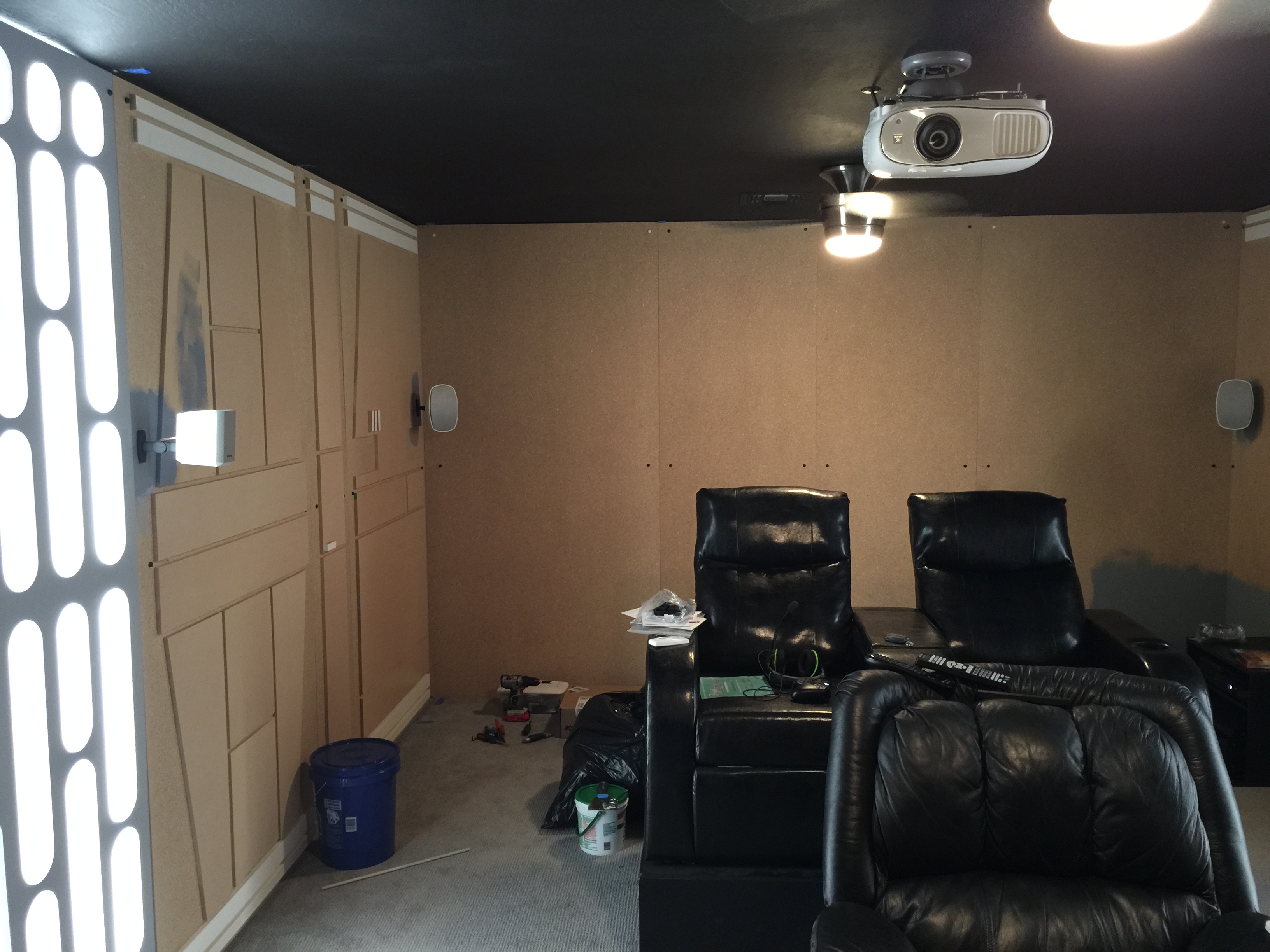

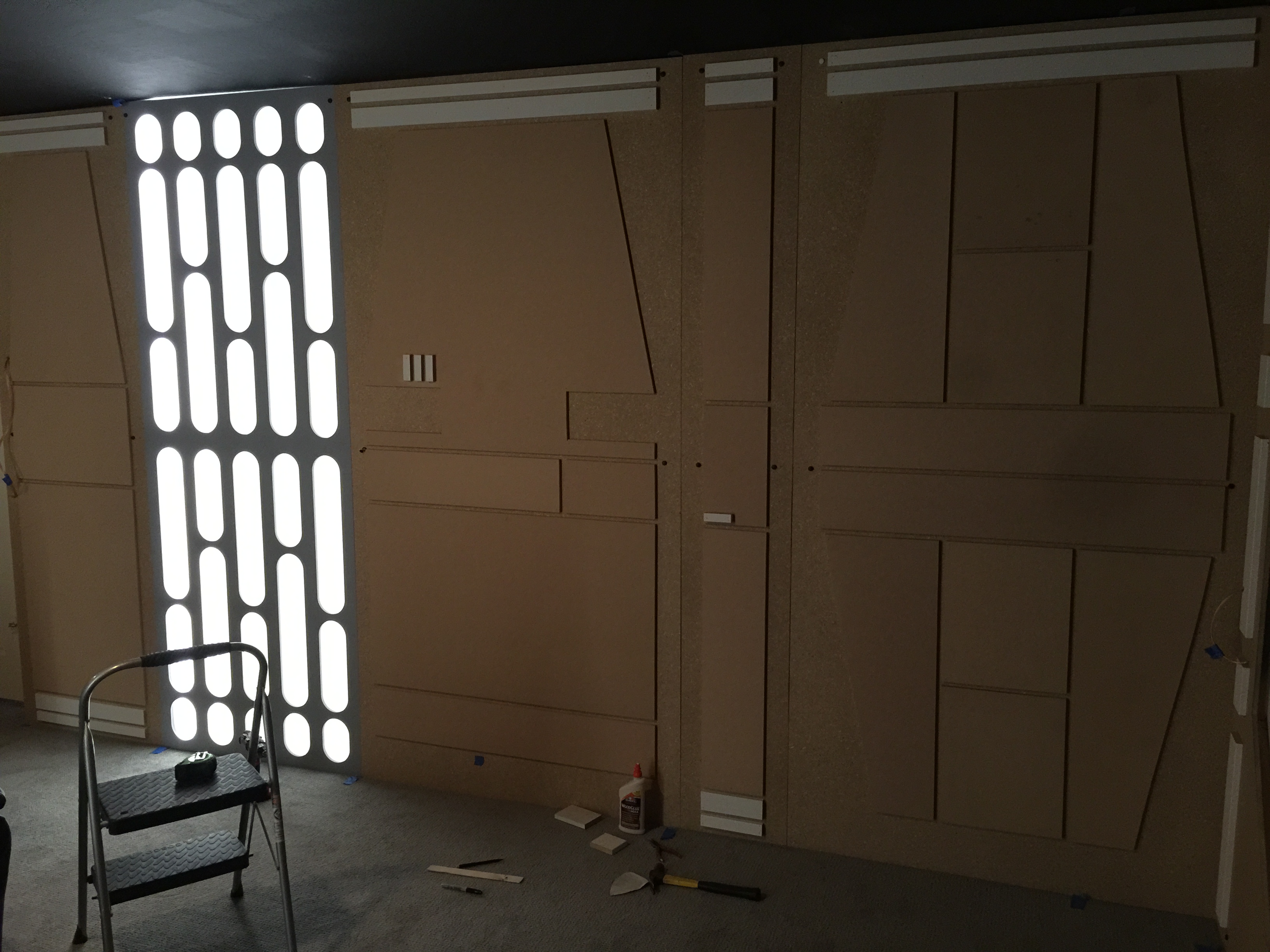

A little more progress, just about done with the walls and details. I once again had to take several design liberties. I want to get the speakers mounted today if possible so I can use the room despite still needing to paint.

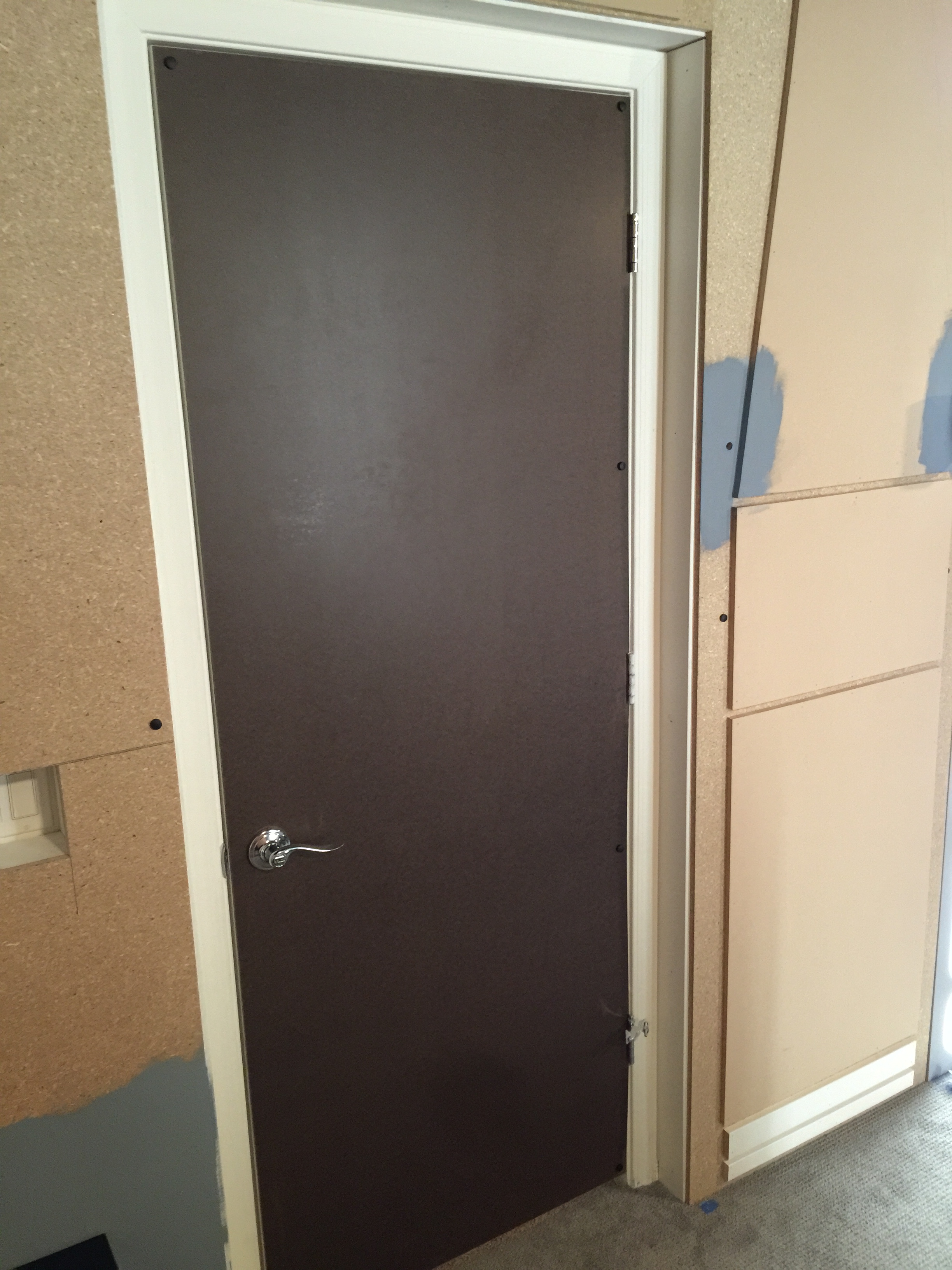

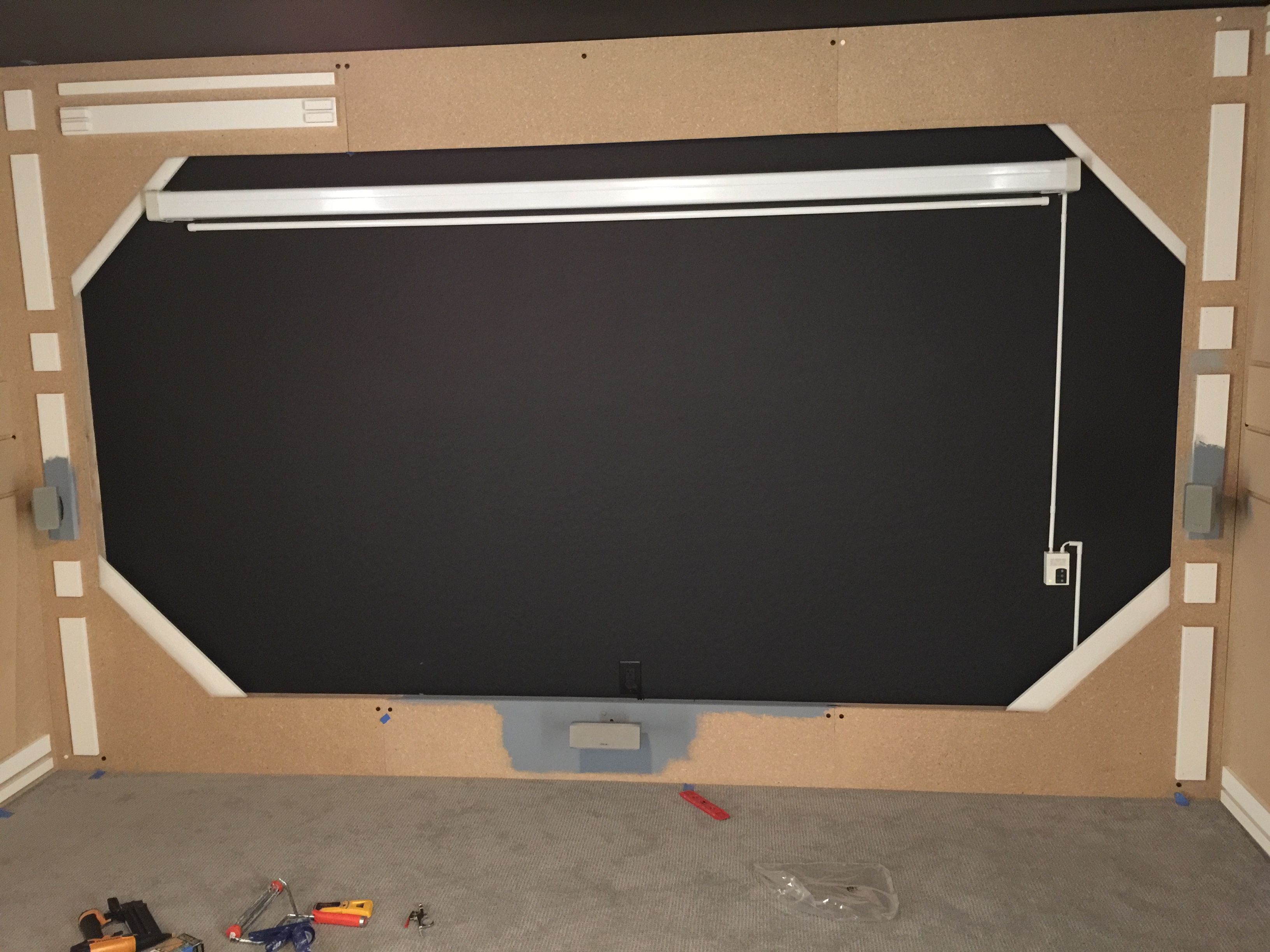

Not a lot got done today. I did get some 1/8" paneling and decided to cover the inside door. Having a traditional two panel door just doesn't fit the room. I was thinking it would be cool to have one of those door size posters but make it look like a Death Star corridor!
I'll paint it gray for now then figure out what to do with it later.

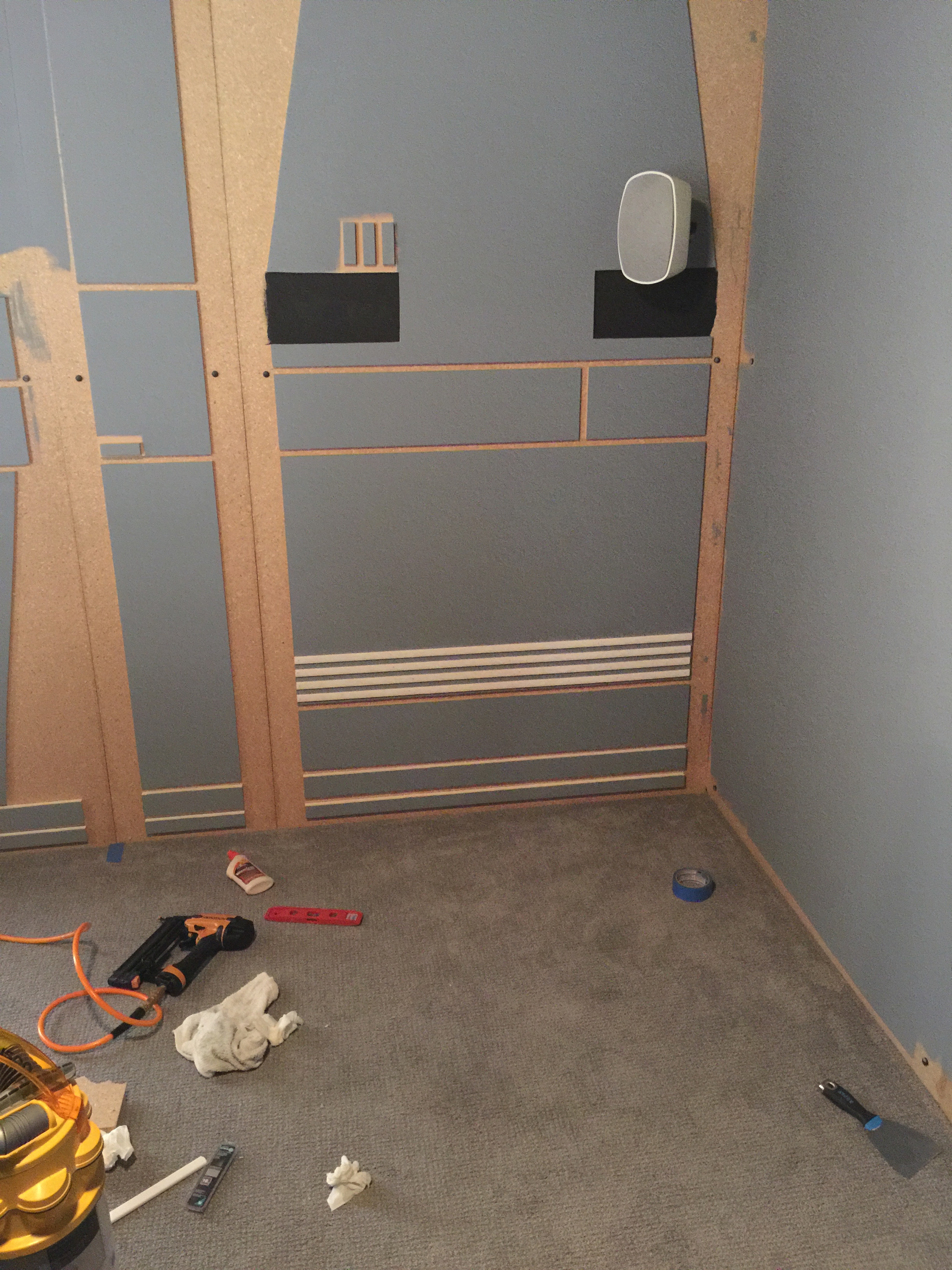

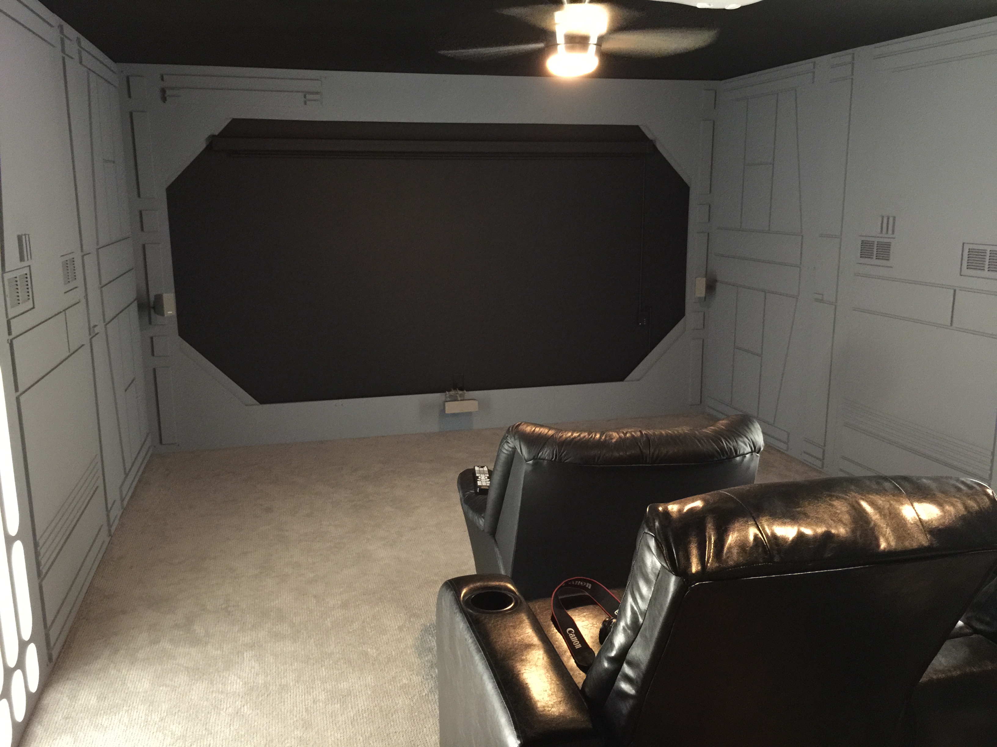

I was able to mount all 7 speakers and test some new paint. I wanted to go a little darker than what I initially had, I'm glad I did, color looks great.

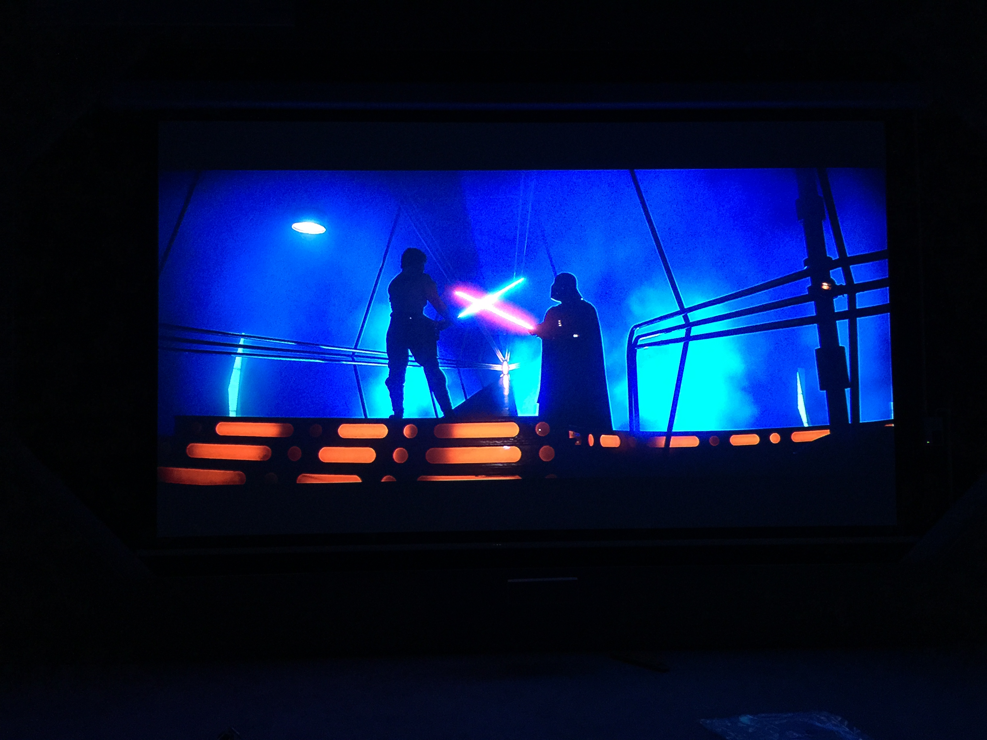

I have some minor finishing work left, then I can get the painting done. But before that, I couldn't resist watching ESB!

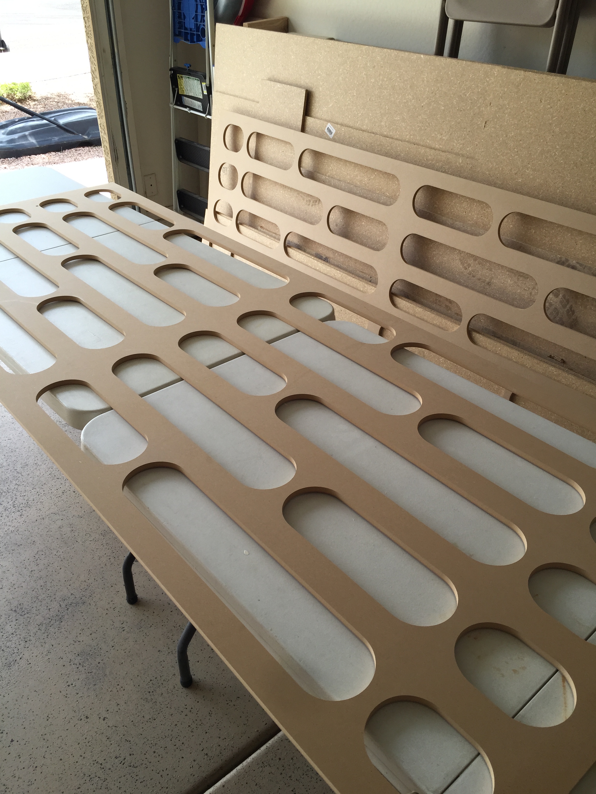

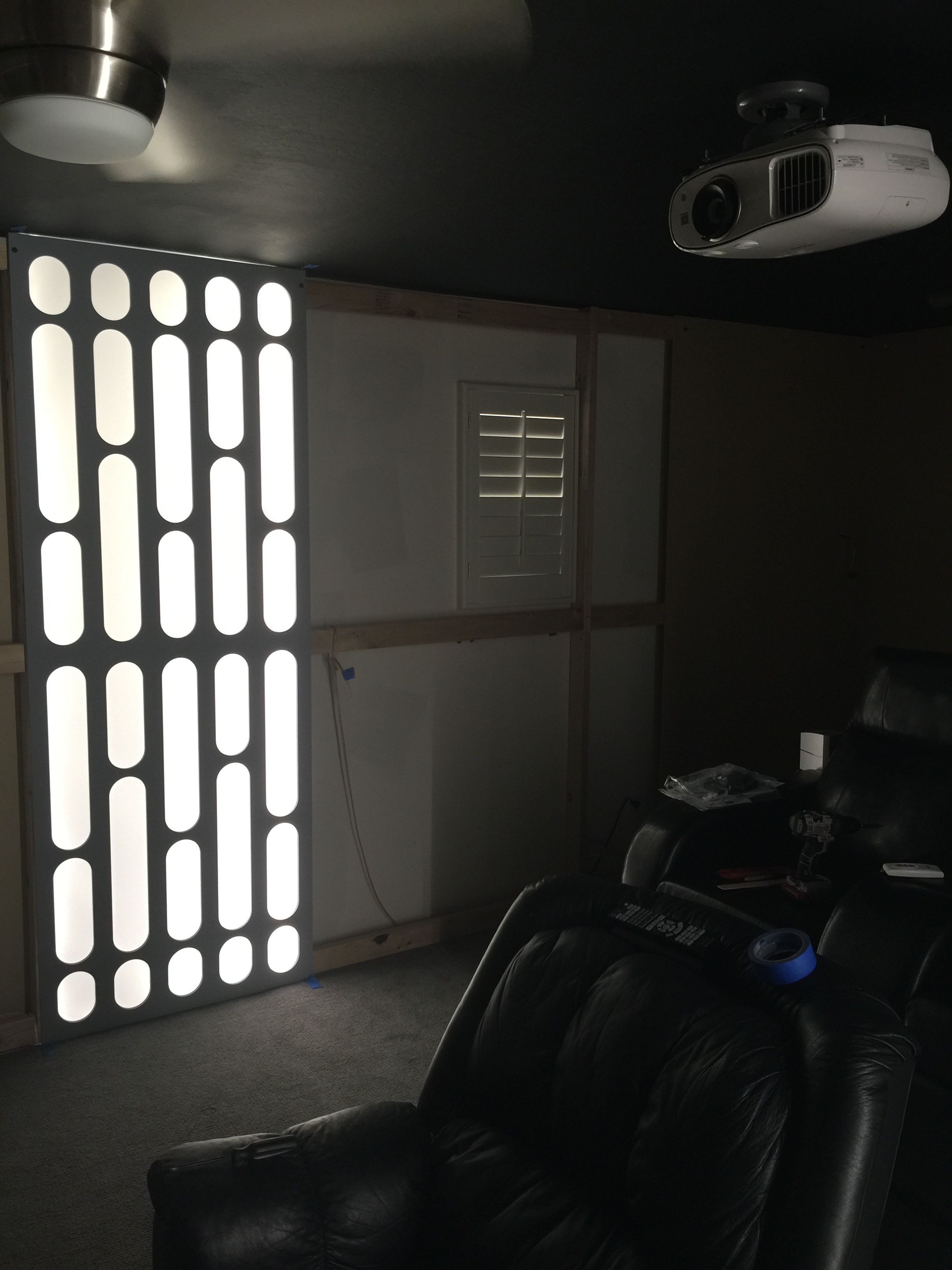

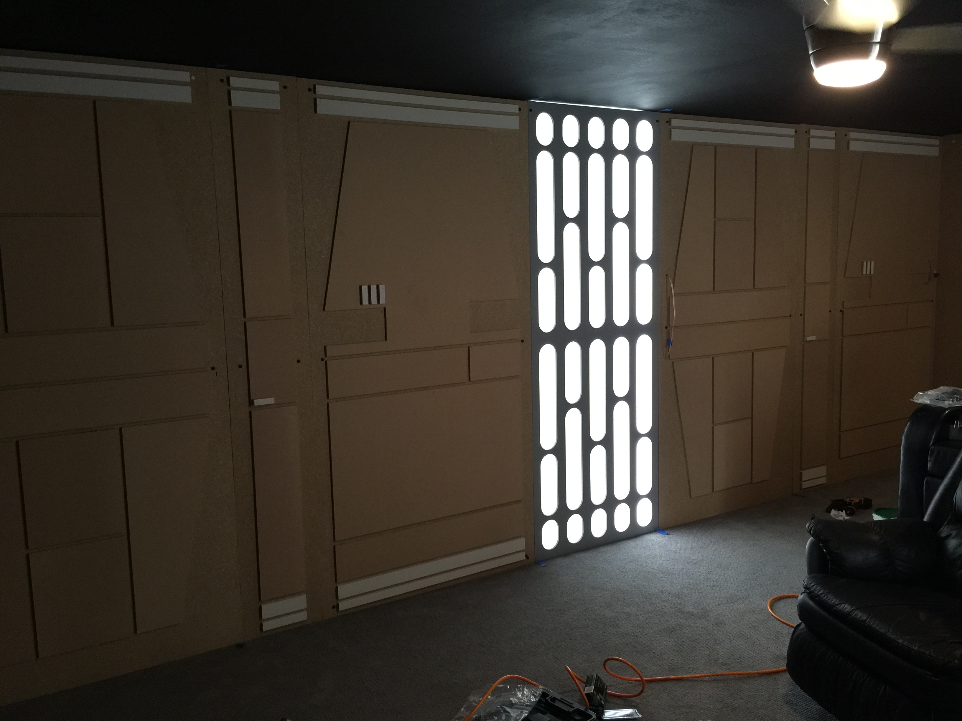

I also worked on the two slotted wall pieces that will be back lit. I used 1/2" MDF for those.

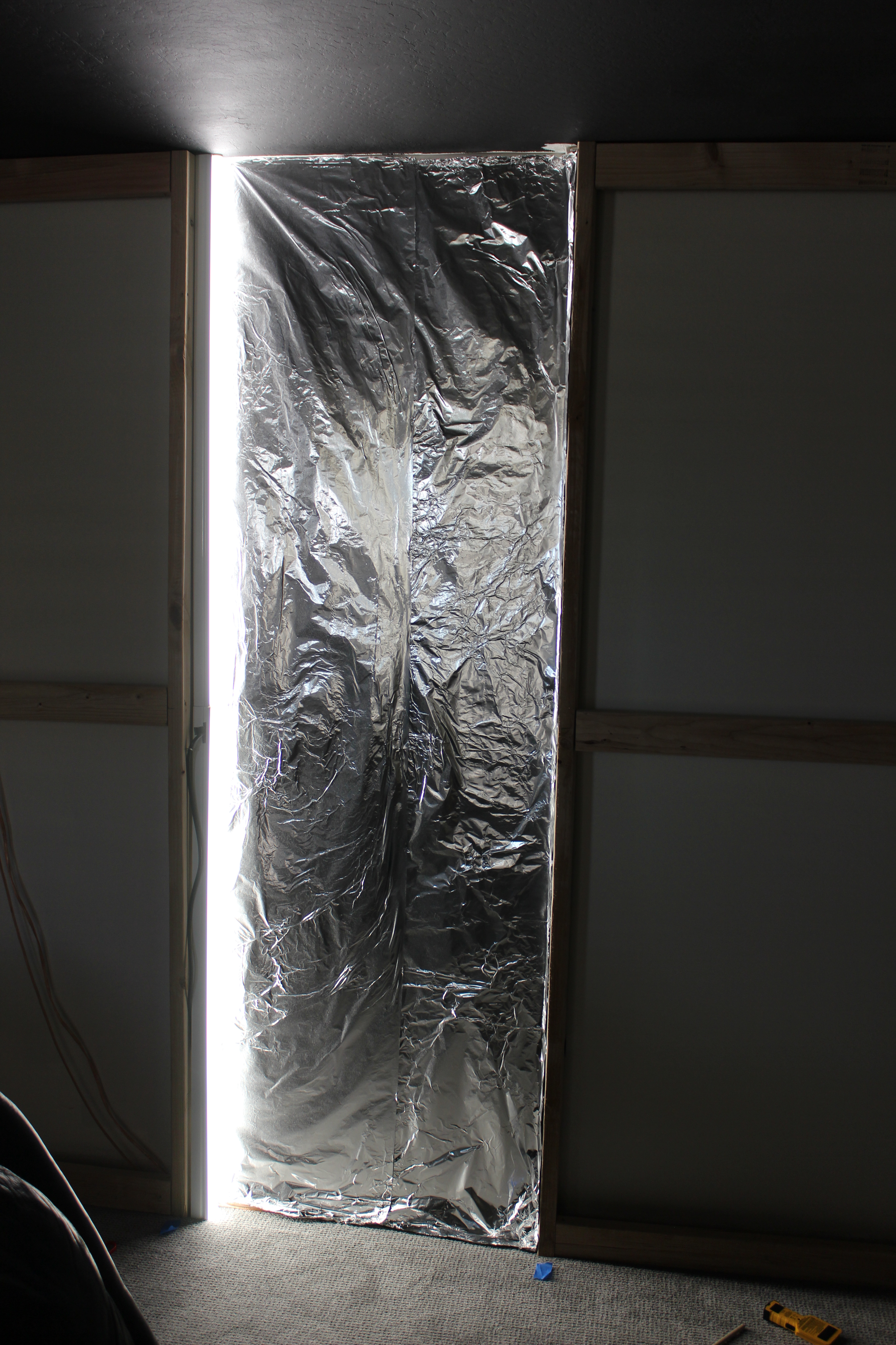

To illuminate these I am using two, 4' LED light strips. Lowe's sells these but they aren't cheap, $40 per strip. I wanted to use 4 strips per panel, but just wasn't going to spend that kind of money. There may be other alternatives to this type of lighting, I just went with what was available locally. I also wanted LEDs so I didn't have to change bulbs and to reduce the heat.
Since I am only using two lights per panel, I decided to cover the wall area with aluminum foil to help with light reflection. I tested the panel against a white wall and with the foil and the foil did help reflect the light once the panel was installed. The lights run off a light switch so that I can turn them on as soon as I enter the room. The good thing about putting this theater room upstairs was that I had easy access to the attic. So I was able to run an extension cord through the ceiling to power both panels with one switch. I was able to completely hide all wires, so I am happy with how it came out.

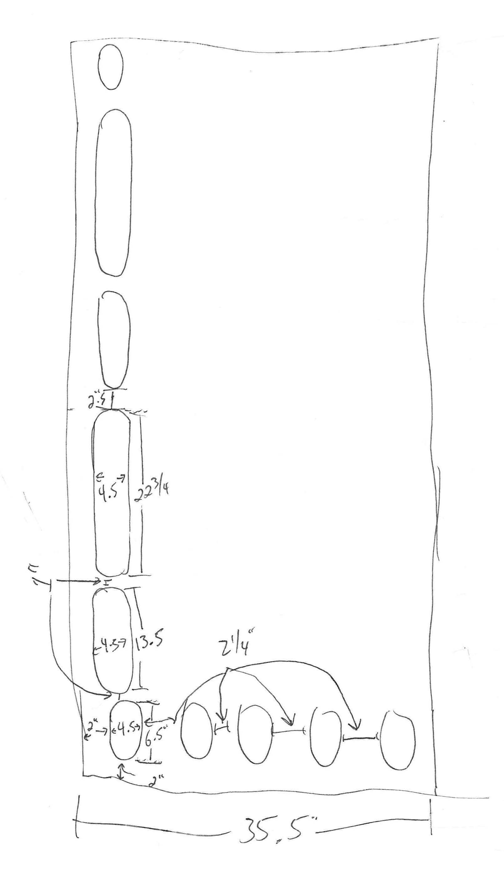

Would you possibly have some exact measurements or files for those panels? I am thinking about creating a custom light/wall decoration for a large wall I have at home, and this came to mind.
I wouldn't need exact numbers (because I'm sizing things according to what I need) but more so the relationship of sizes of the different holes.
I figure you start with a pattern of circles first and connect 2 or 3 of them? But what spacing? I tried to mock it up in Photoshop but I can't get the pattern to look quite right.

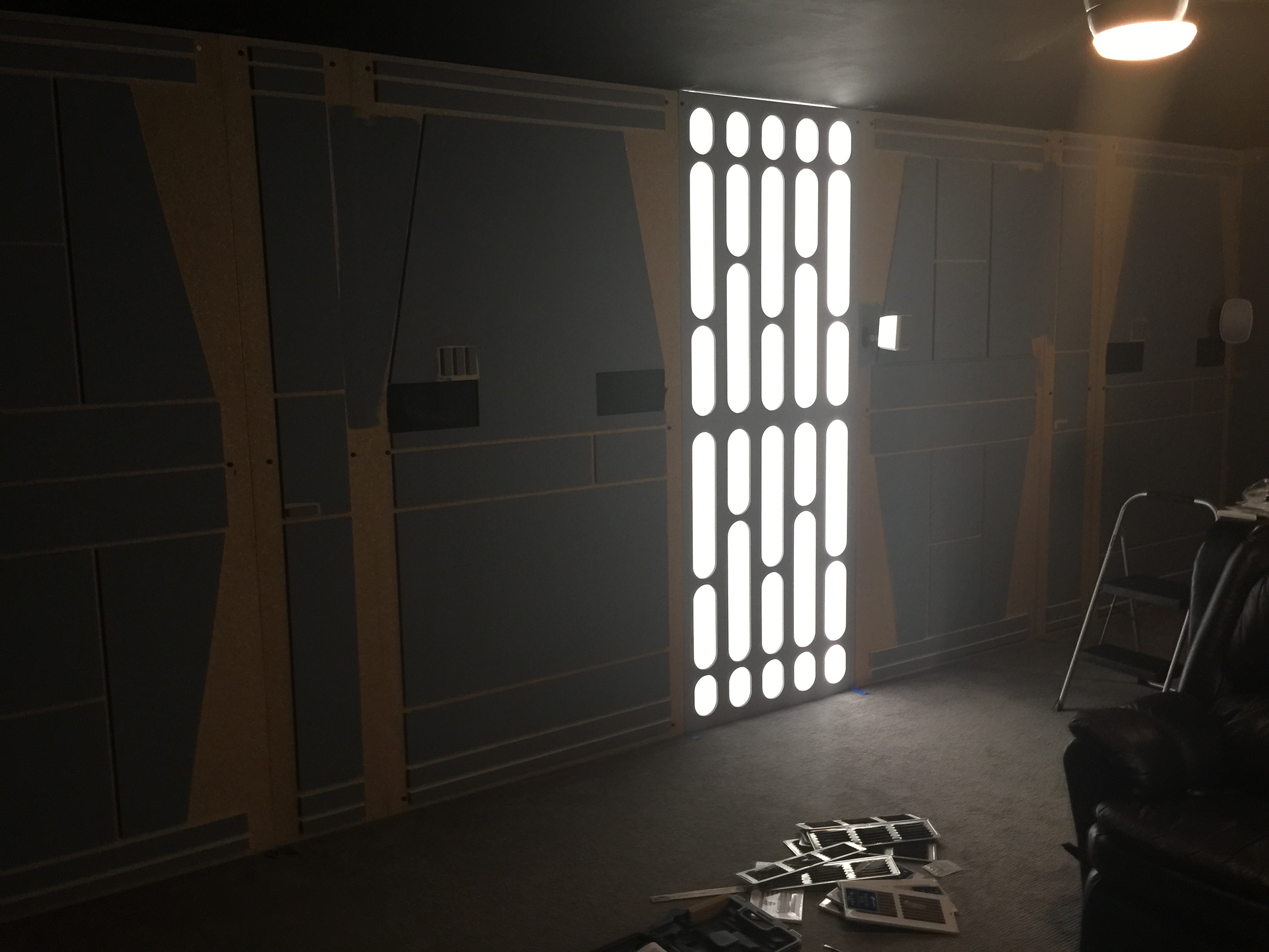

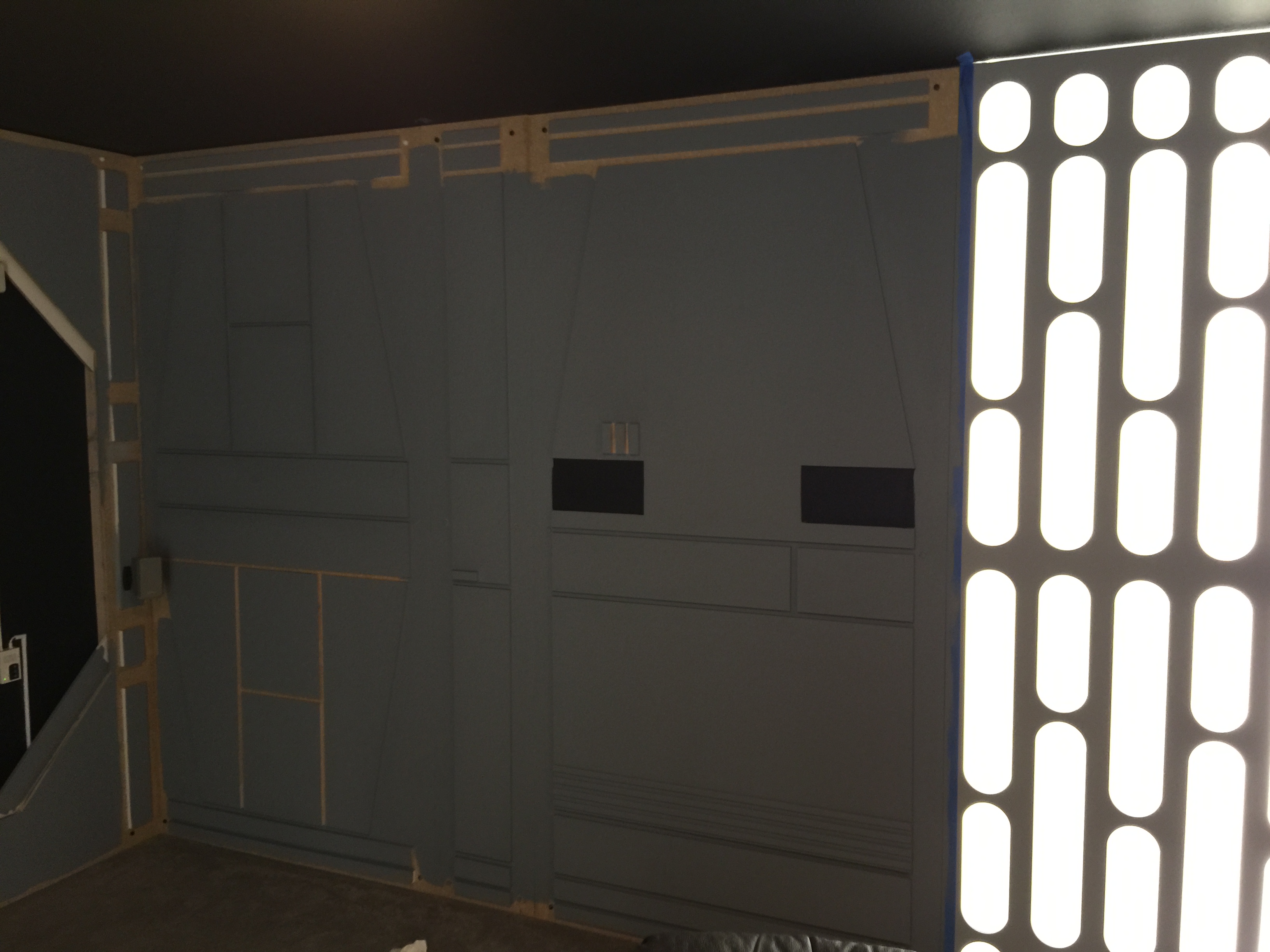

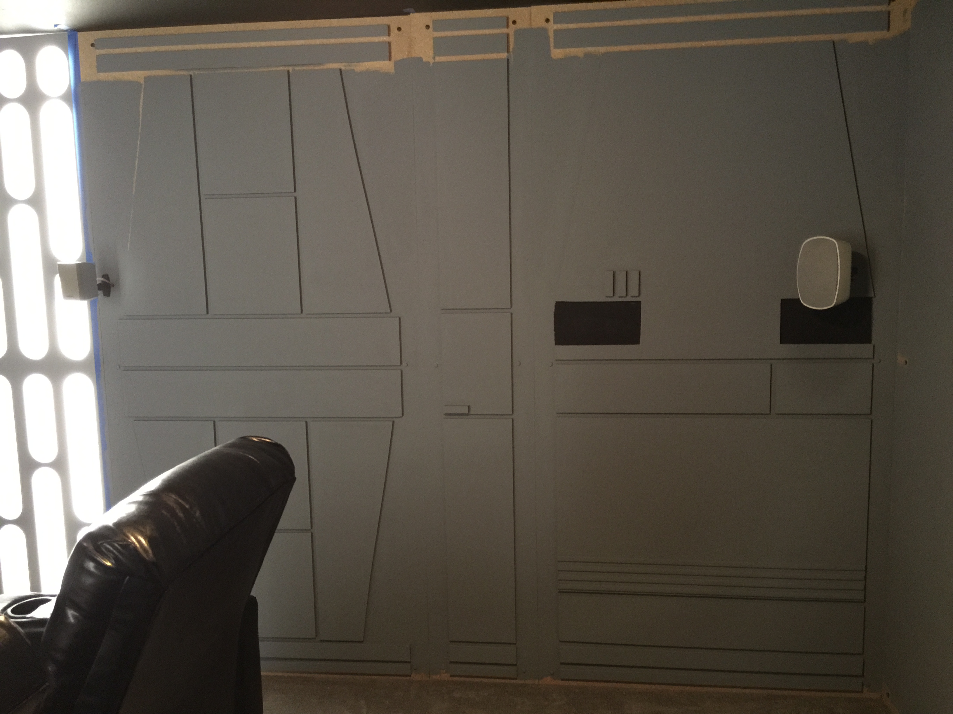

I took a little time off to hit Phoenix ComiCon, but I was able to start painting the walls. Sorry for the crappy photos, was in a hurry.
It says Docking Bay 94 on the entry door!
"Thats no moon . . . Its Azheat's KICK ASS HOME THEATER!!!!!" Awesome work!
Ha, thanks guys! Been hard at work on this, I can finally see the light at the end of the tunnel!!!
In addition to painting today I wanted to add some thin strips to the bottom of 3 of the panels. I found these at Lowes and they look great. The paint looks awesome, really ties everything together.
I really hope to have all the painting done tomorrow.

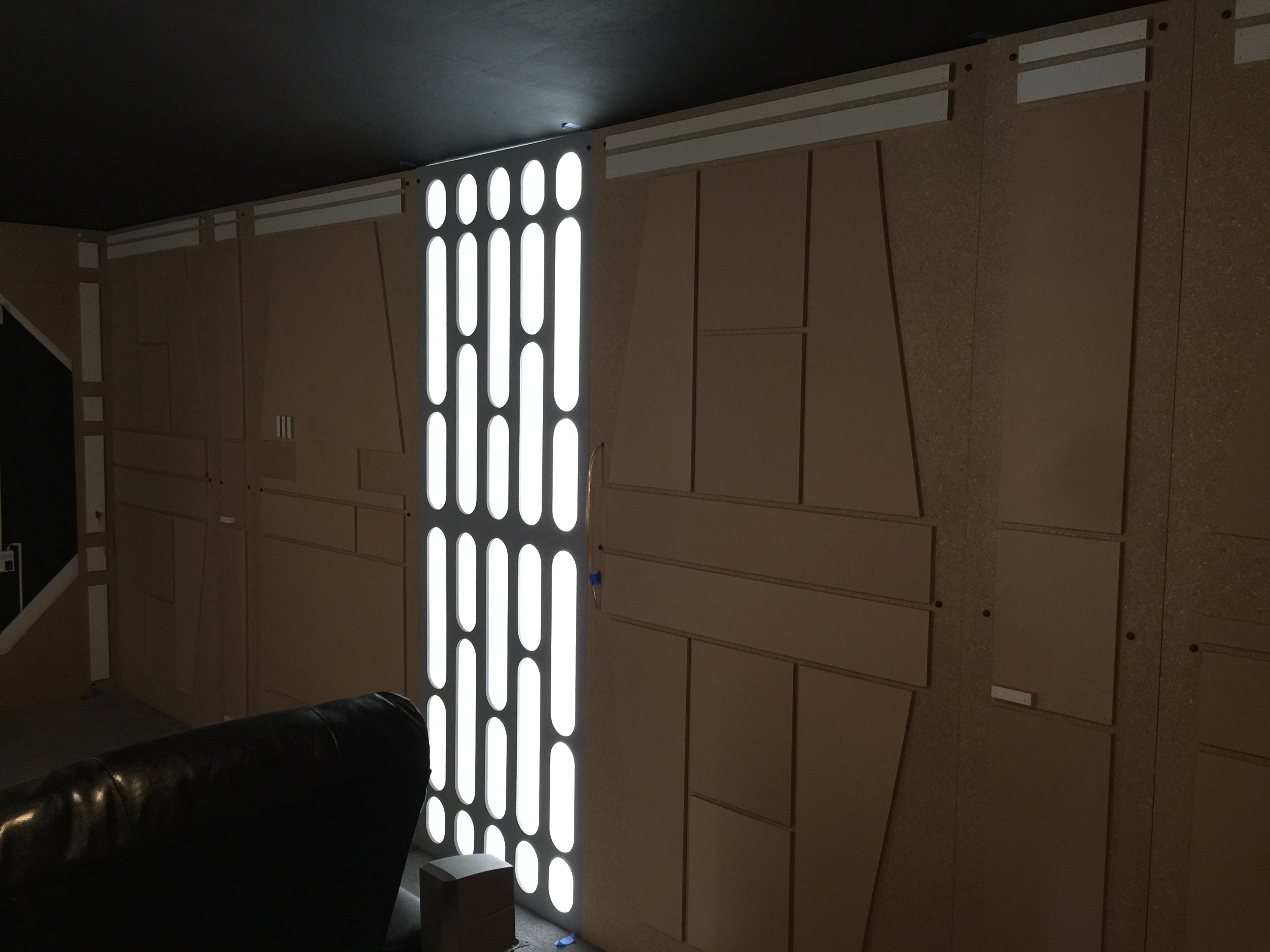

I also had a hard time finding anything so I had to wing it. I looked at a bunch of photos and came up with what you see below. My light panels are 35.5" wide by 8' tall. I think they came out great, but well after I was in to this I realized two things that bothered me:
1) I made the middle dividing line too small
2) I made the line above the bottom holes and the line below the top holes too small
Seeing this now, I would have made those 3 lines larger and reduced the size of the holes by a few inches. It was my first attempt though, so I can live with these results.
Hope the image below helps.

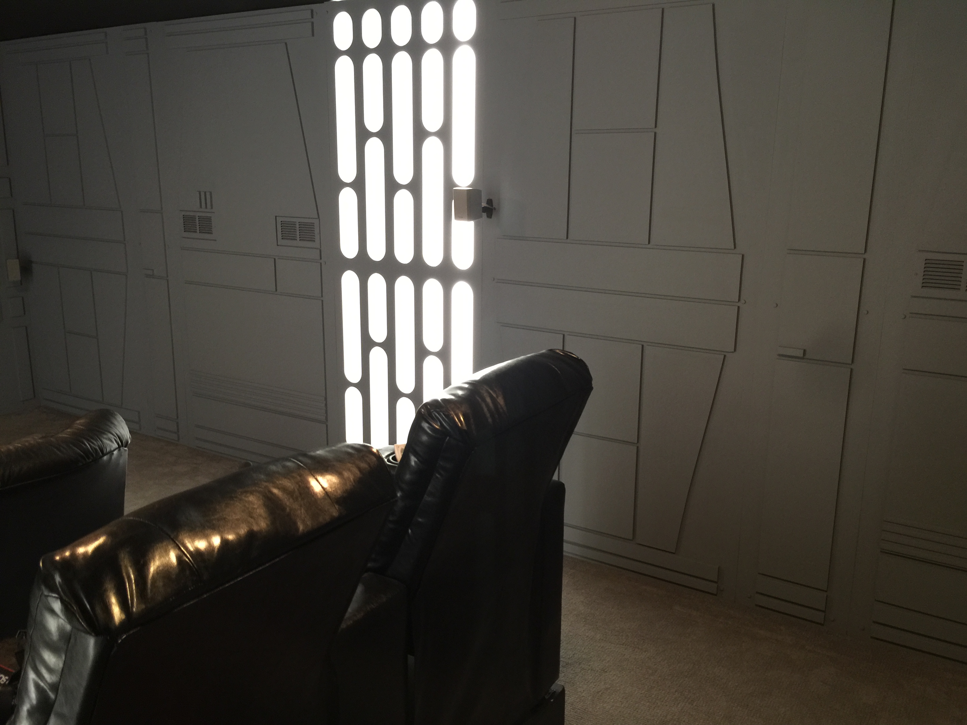

I was finally able to get all the painting done, what a relief! I installed all the vent covers and painted the screen housing, cord hiders, and control panel black. This looks so much better than I imagined. I still have a few things left before this project is done, got some ideas for the front wall, a DVD cabinet, and some pipes I want to run across the ceiling. The best thing about getting to this point is I can FINALLY use it to watch movies, play XBOX, and start moving all my lifesized figures, cabinets, and collectibles up.
