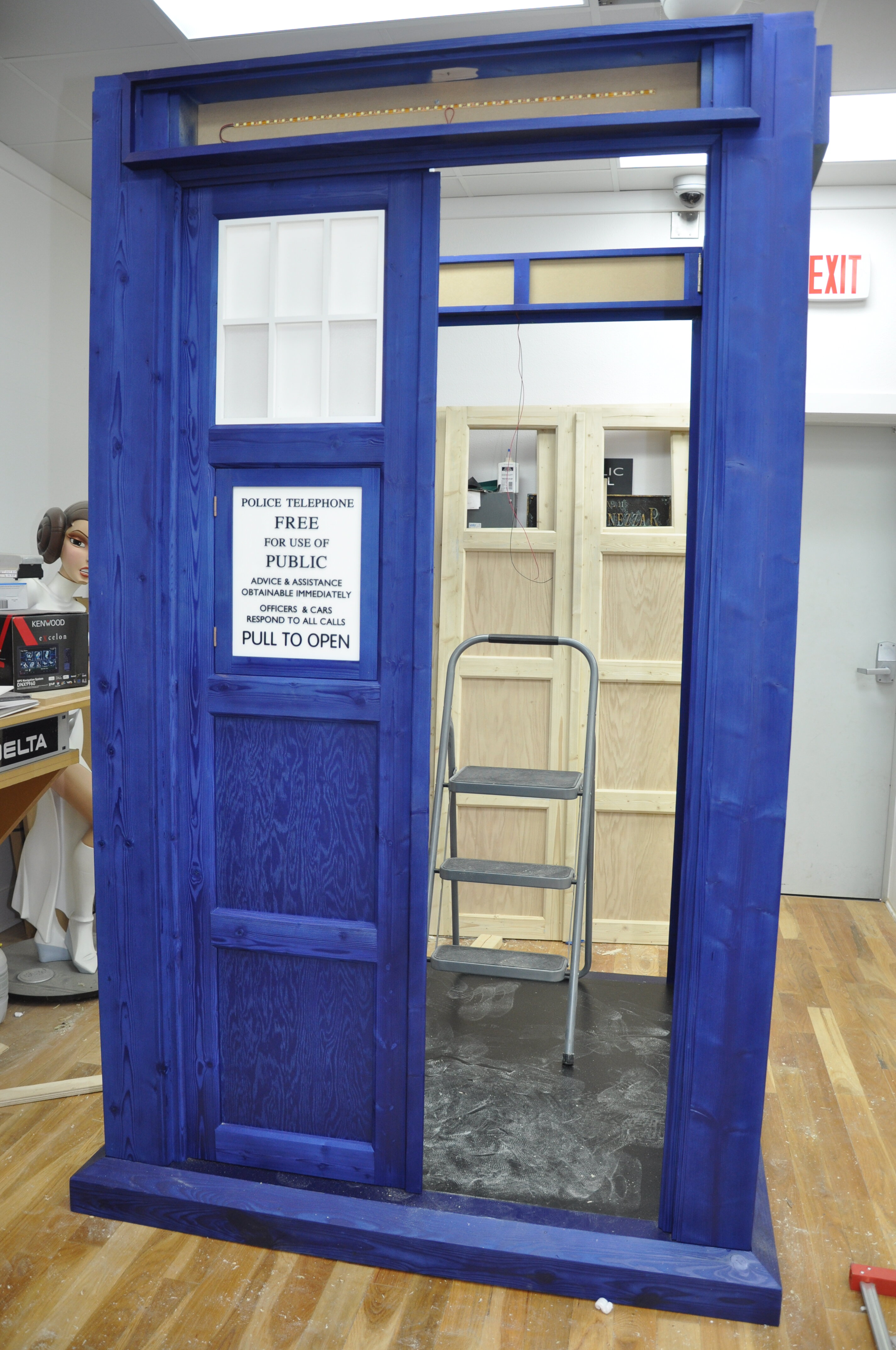

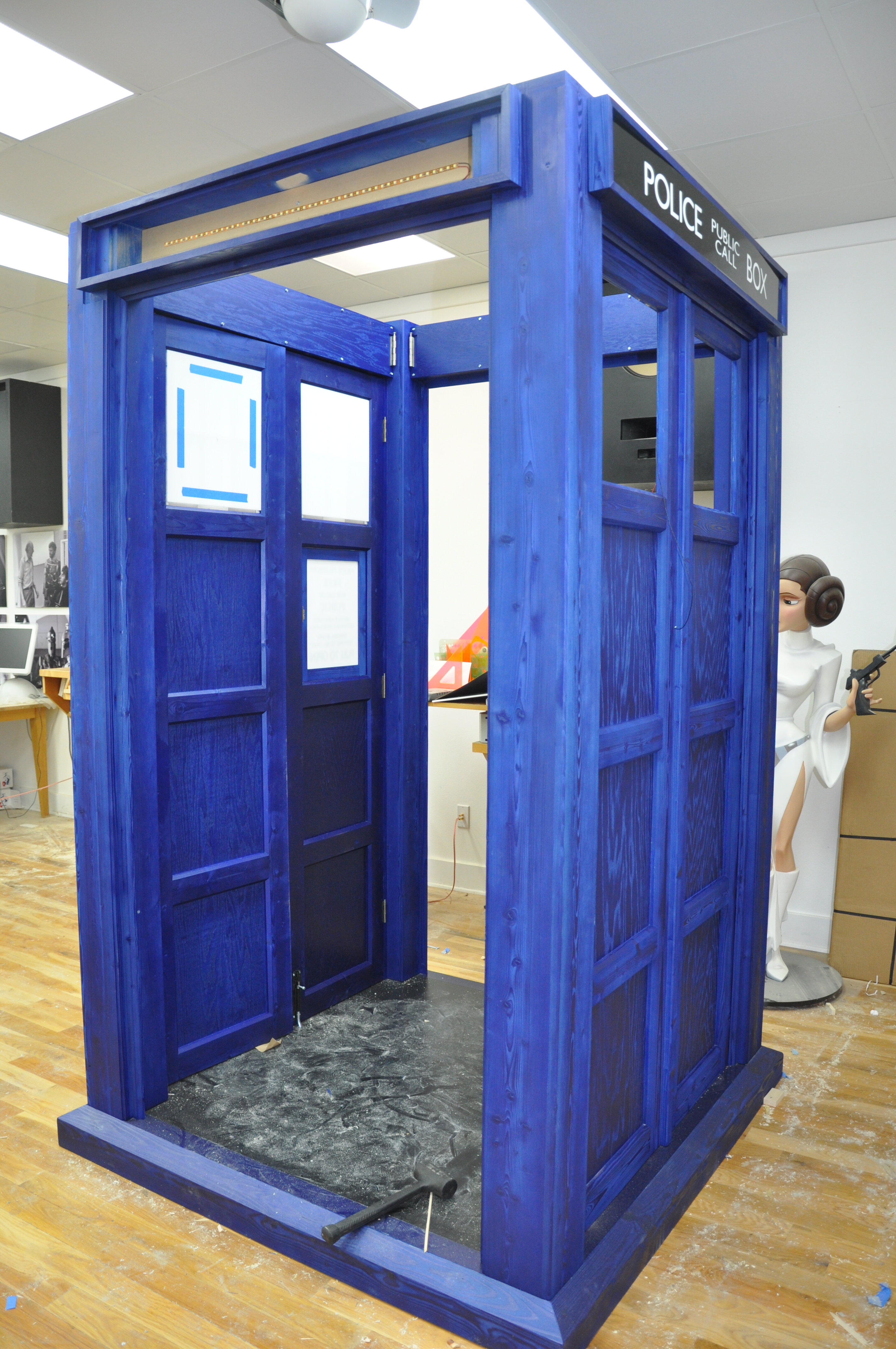

I have finished painting the left hand door, and assembled the PTO door. I decided to go ahead and paint the inside of the door blue as well. I also placed the window in the opening, but discovered an issue with it. The location of the slot I placed in the window assemblies is covered up on the inside of the doors because of the raised panel overlay that's on the doors, but not on the walls. I had thought I could still get to the slot on the doors but I can't. Which means I'll have to either build two new windows with more room or see if I can modify the white acrylic to allow access, but still not see it from the outside. I have three extra waterjet cut window frames, so I'm good to build new ones if necessary.

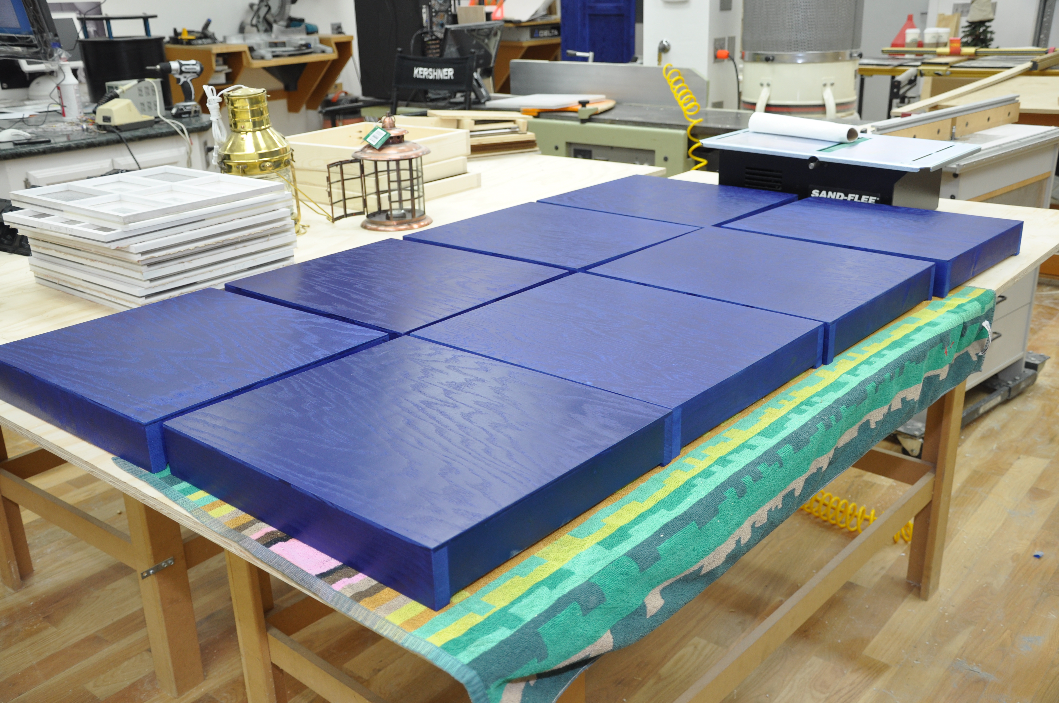

I caught up with a couple of nagging details today as well. I cut the news sign box back covers and painted them.
And I cut in the access slots in the bottom and top of the windows backlight boxes and began painting them as well. The slots will allow the inserts to be put into the window assemblies to change their color (as mentioned earlier)

Not much work today and I forgot to add a photo, but I cut off 3/8" of the bottom of the door window backlight acrylic to see if that gives me enough access to the window slot. I think it does, but I'll have to use card stock that's thinner than matte board I was planning to use. But at least I don't have to rebuild the windows and worry about them looking slightly different than the others.
I also got the sign box back panels installed.

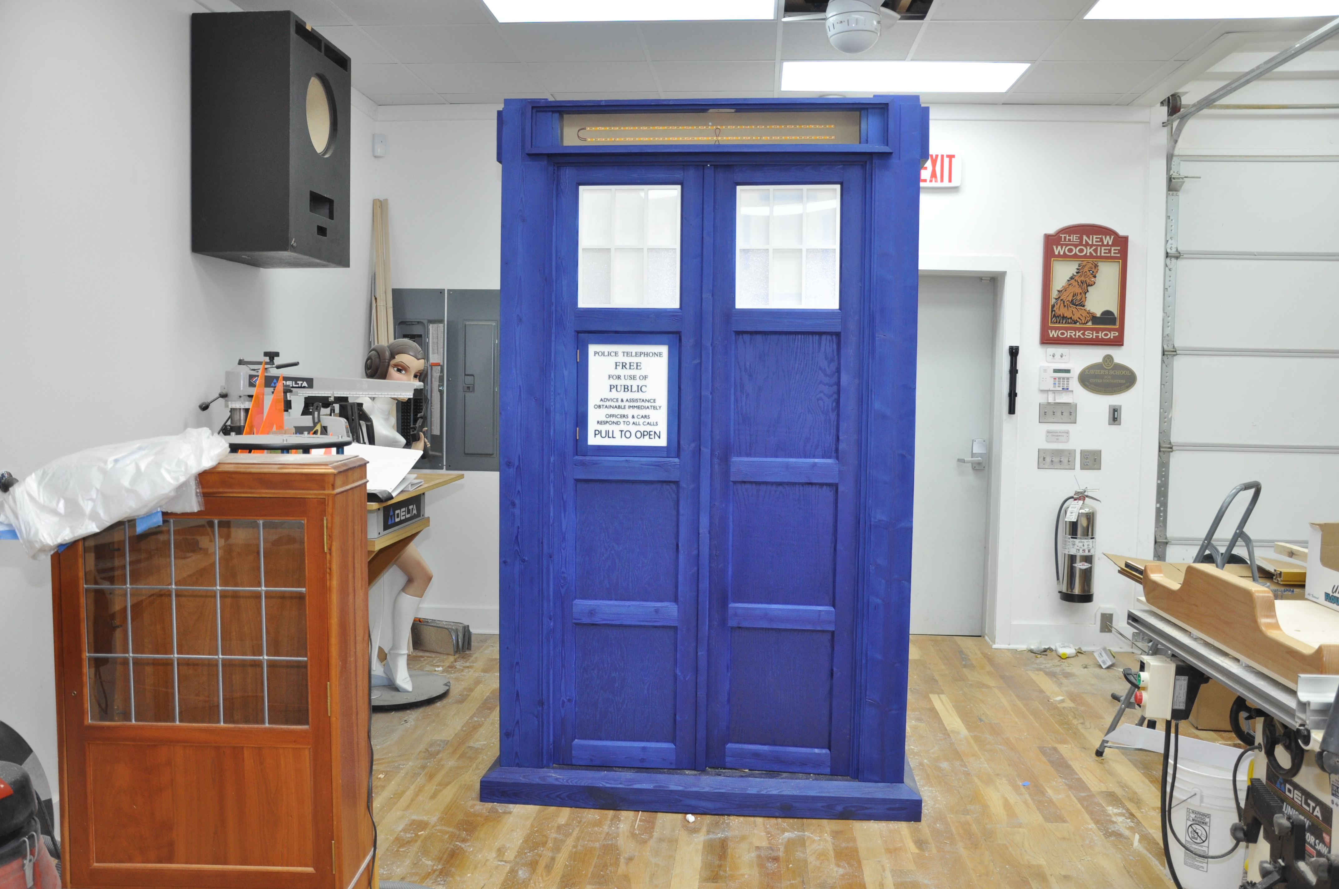

A couple closer door photos. I haven't received my chrome door pulls, and if they don't arrive soon, I'll fall back to my original plan to nickel plate the original brass ones I have. I'm still using antique brass PTO door hinges, but I have polished brass ones that I'll nickel plate as well.

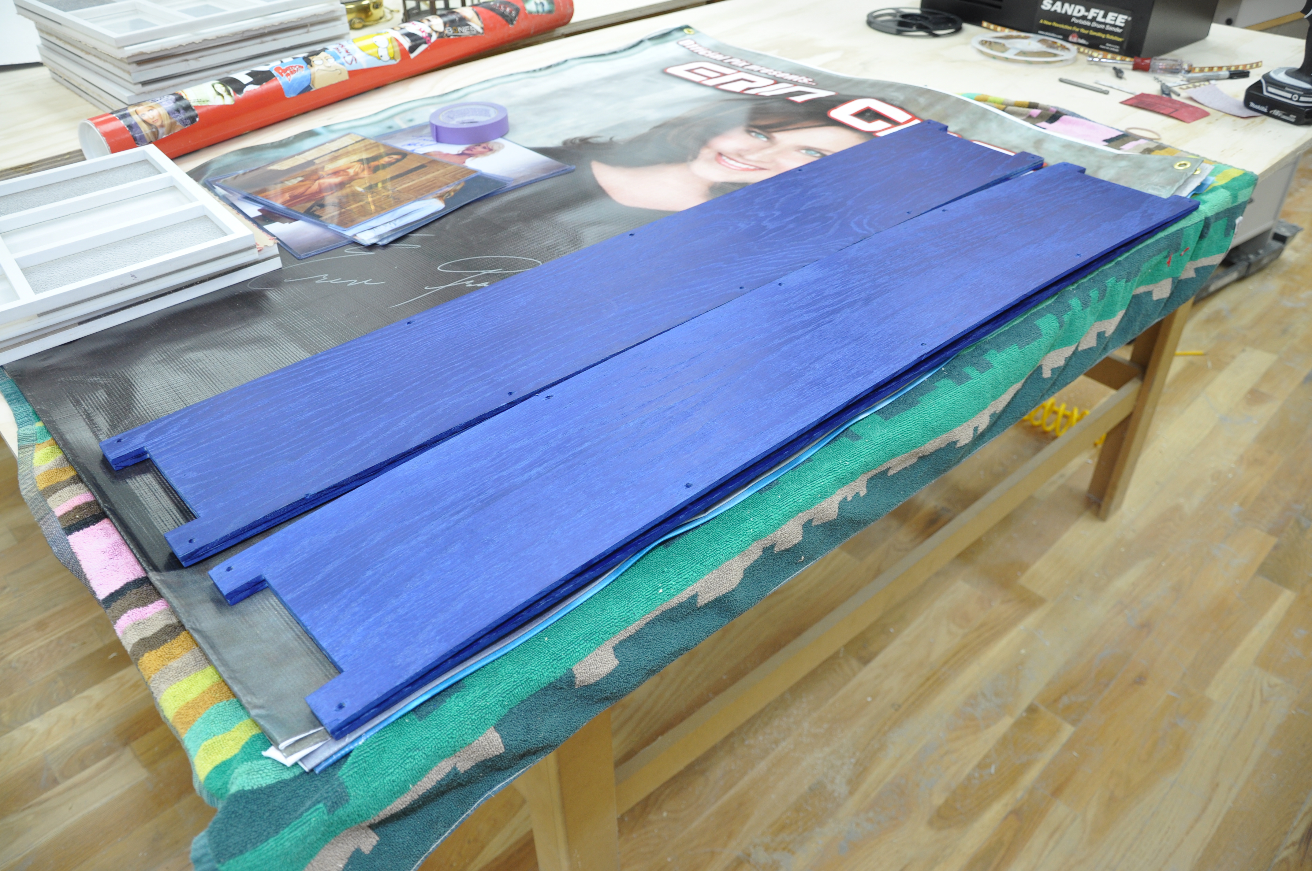

I finished up painting the outside of all the window backlight boxes and started on the right hand door.

More painting today. Have finished the right hand door and the back panel.
It looks like I *may* run out of blue paint before I'm done, which surprises me. Though I did paint the back side of the doors, window backlight boxes, the inside of the posts and sign boxes, which I had originally planned to paint black.

Soo awesome. Curious, is the bottom of the right door warped or did you not have it totally shut? I had issues with my doors warping a little.
Neither door was perfectly straight when done but the right door just isn't closed all the way there. I used a combination of the left hand door bolt, adjustment of the hinges and plan to use the era lock when I install it to hold it all together in the best compromise I could make.
