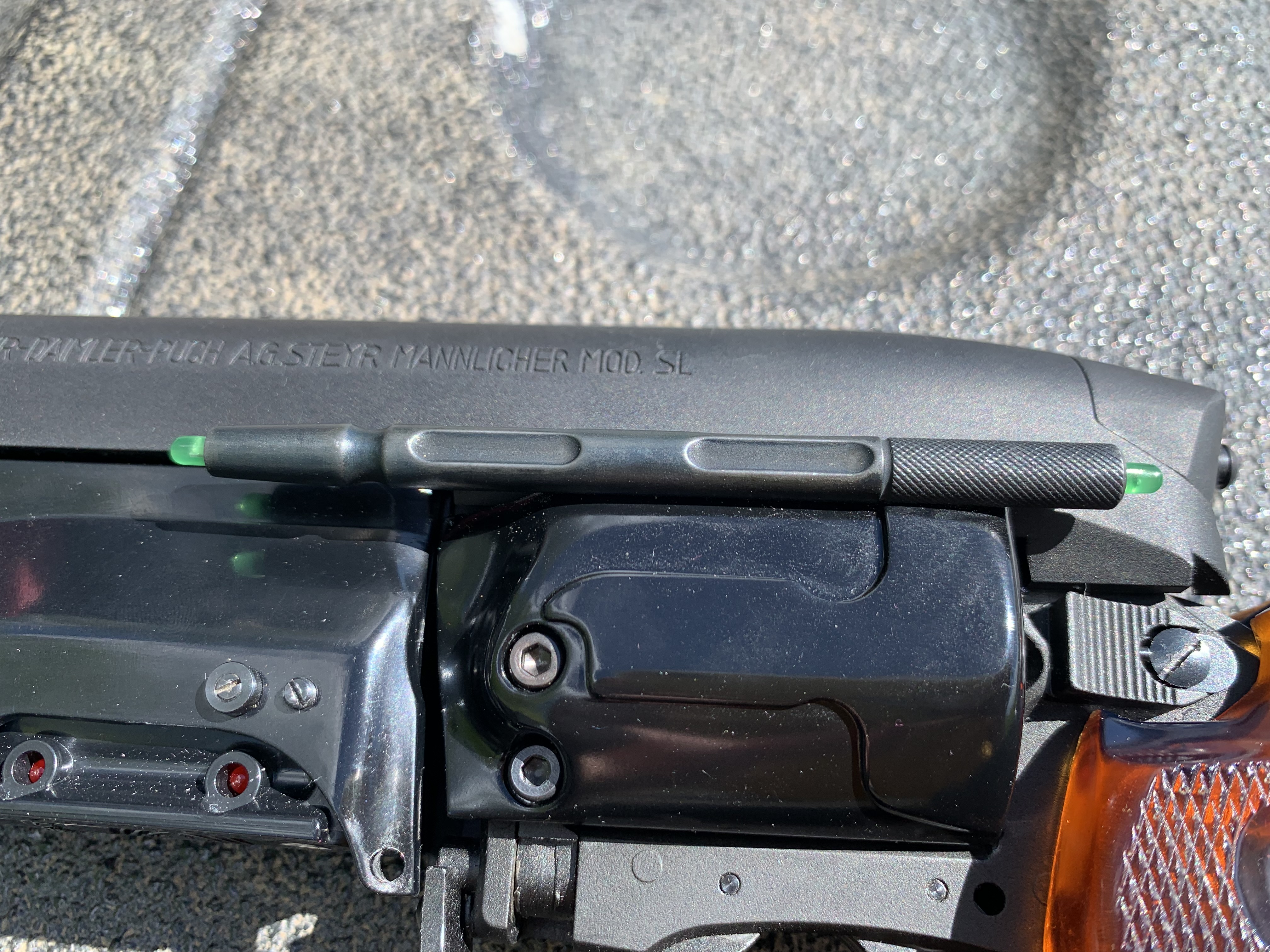

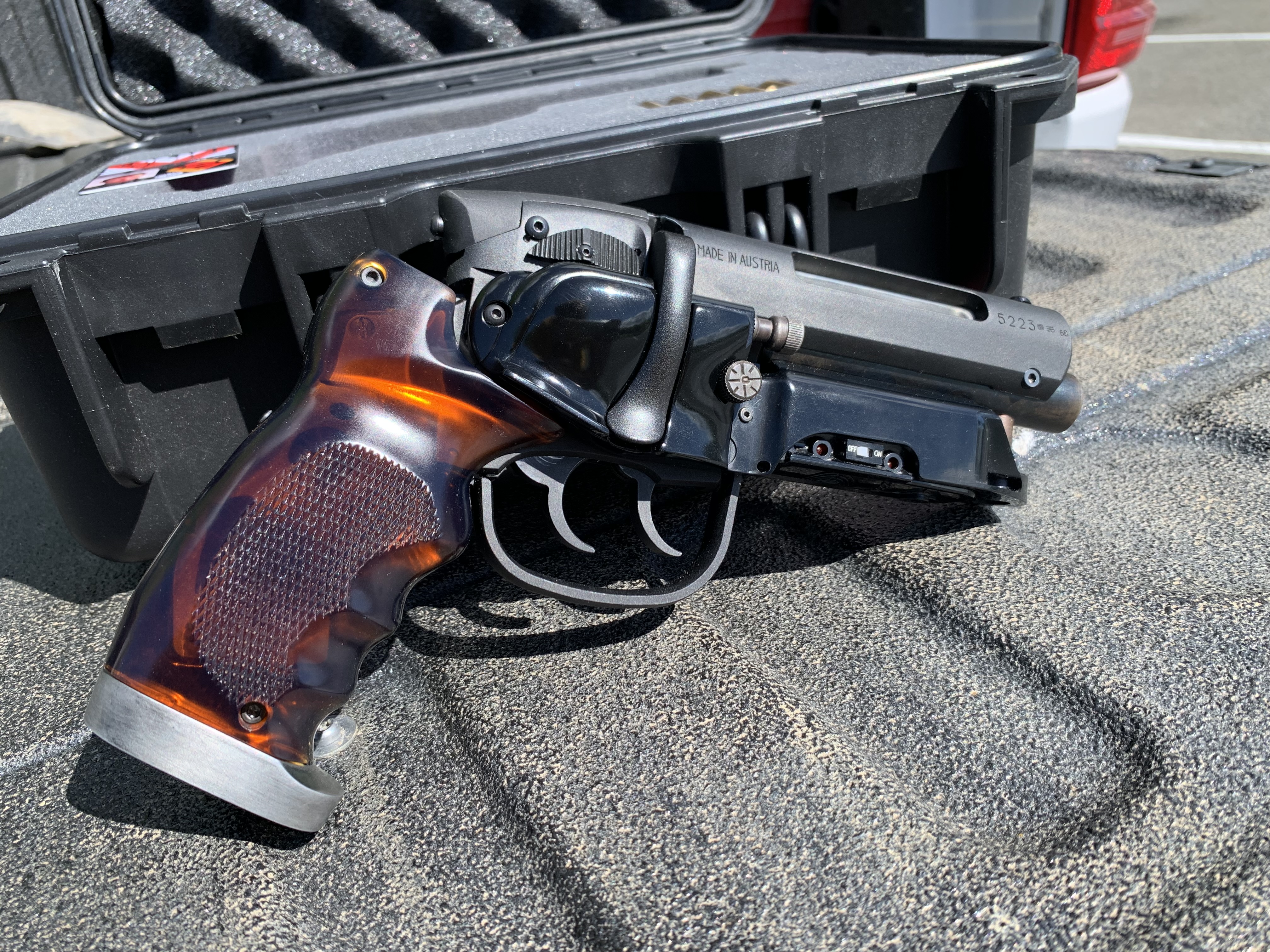

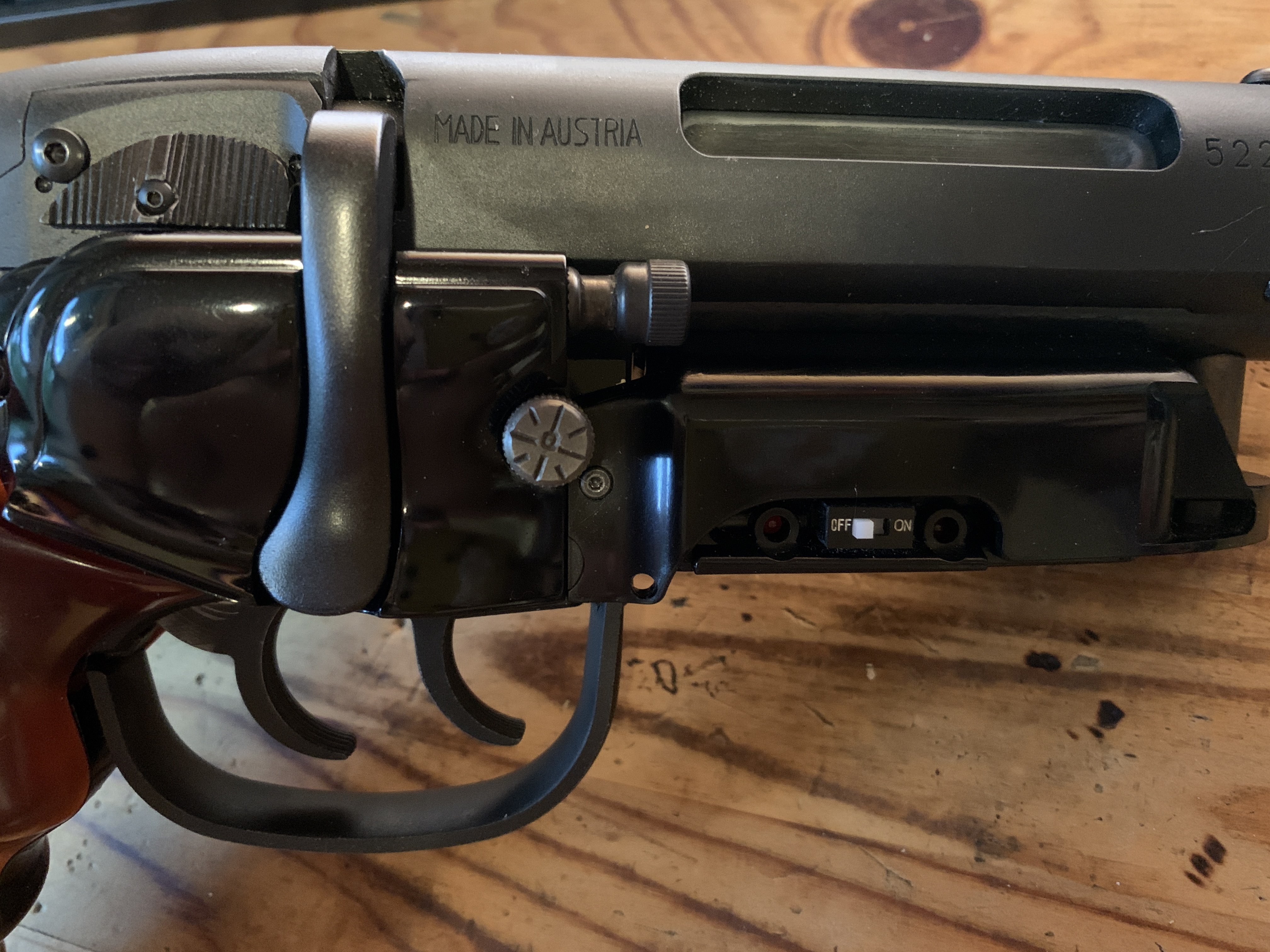

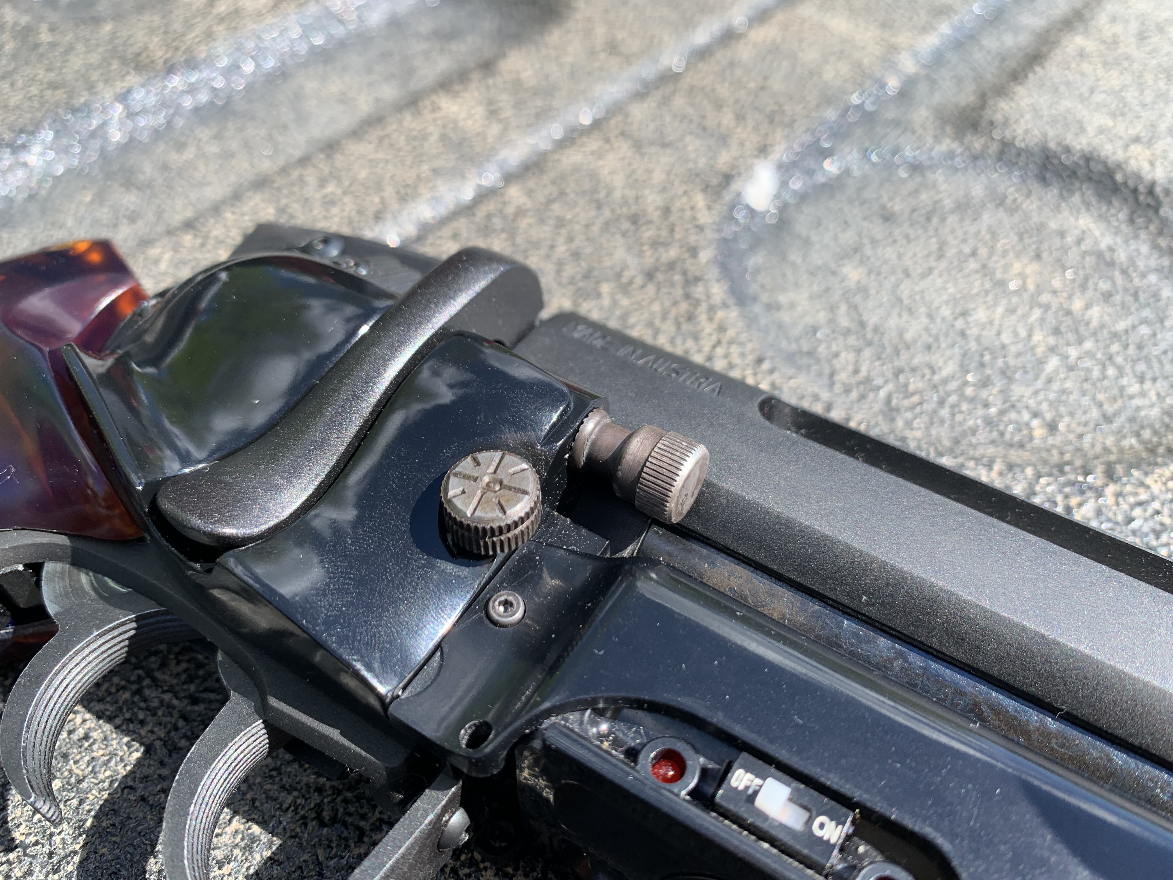

For the blaster itself I wanted to personalize it to how Id want it to look which is a darker more aggressive finish. I wanted to get as many real parts on it so there is an original binding post from an ee-8 field radio, and an original scope knob from a Weaver scope. I also added a steel barrel, darker amber grips, and a home made front post which I milled to fit the contour of the barrel. I also modified some of the base parts like darkening the base plate, and stripping the paint of the sight rod and darkening it with Birchwood Casey's aluminum black.
(close up of binding post and scope knob)
(close up of re-colored sight rod)

Overall this project was really daunting as the Tomenosuke is an expensive piece of hardware to begin with but I'm really happy with how it turned out. I also made a few mistakes along the way which luckily enough ended up giving the gun a bit more character such as screwing up the blueing on the barrel which ended up making it look heat worn. My philosophy for the whole build is I wanted every part to be identifiable as its own piece with a different finish and level of wear to give the gun a look of complexity. I don't think I'll ever be truly finished with it but it finally looks the way I envisioned it and I'm very happy with where its at.

-May I ask where you acquired the binding post and weaver knob? I've done a quick ebay/internet search for the post and I've struck out so far. The Tomenosuke parts are a bit too clean for my taste, and I'd prefer the slightly grungier look of the authentic parts for my weathered blaster.

Thanks for the praise, for the binding post I ended up just buying an entire EE-8 radio (Ill send you some links in a direct message), and for the contoured front post id feel guilty charging you for it as its just some hardware I found at my local Ace and a drill press. The whole front post cost maybe $2 but if I include the entire bottle of brass black its probably $13, id be happy to whip some up if you don't have the facilities for it (I used my colleges wood shop for most of this project when I wasn't able to use my shop at home)
Quick addition, I decided to darken the binding post to match the weaver knob, I think it turned out pretty nice. My last few goals are to install a metal cylinder once I'm able to get my hands on one, fix some wobble, perfect some finishes, and create a good display.
