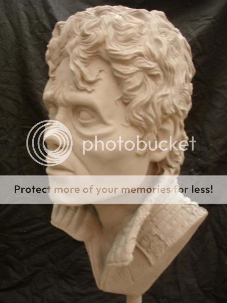

My Michael Jackson Thriller Zombie Bust WIP
Looks fantastic! When are they going to be ready?

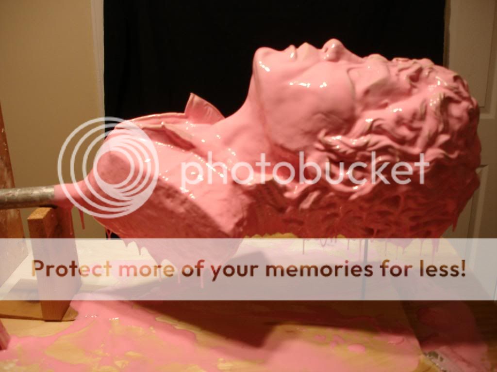

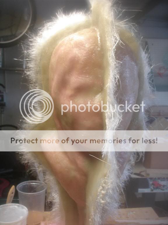

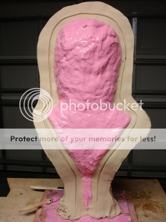

I started the mold tonight and will post pics of the process soon. The front of the collar had to be cut off for molding purposes( too big an undercut). And will be reattached when cast. Other than that the mold should be fairly easy, basic sock mold with a split down the back and two part mother mold. I look to be done molding over the weekend.

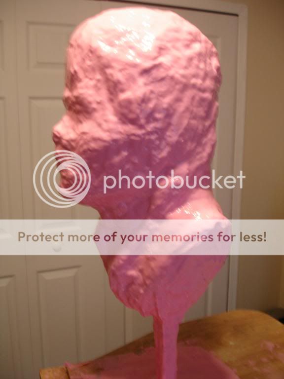

Progress pics of molding. Print coat silicone applied. The collar was removed to mold seperately.

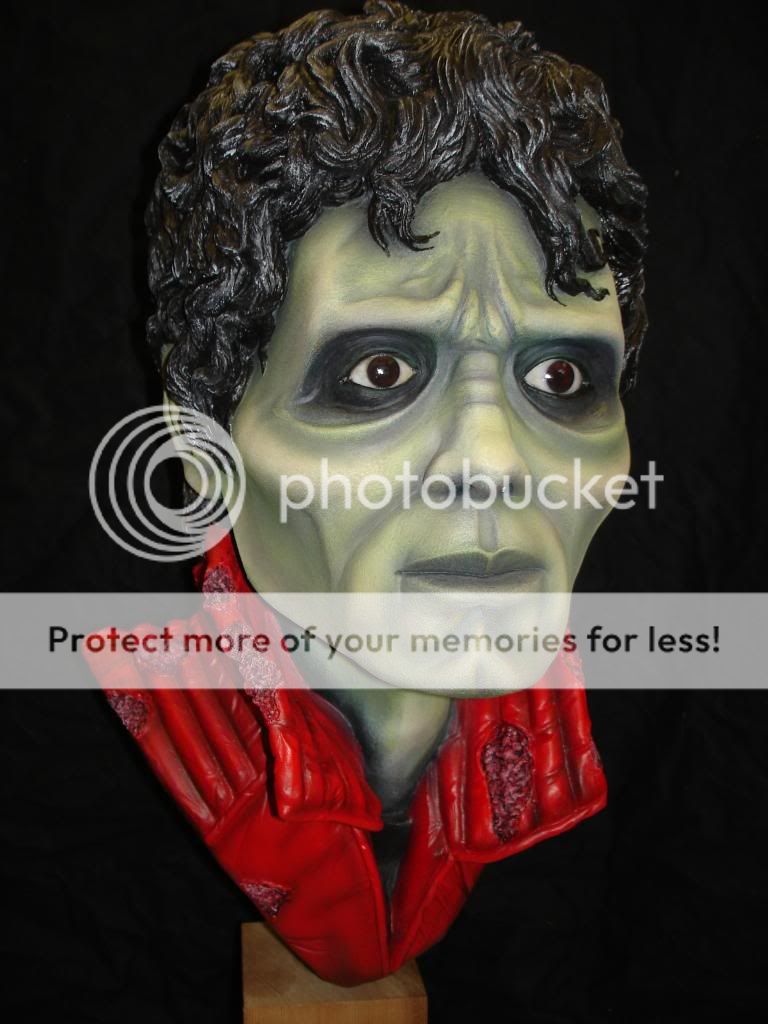

Mold complete, looks good. Will order casting materials and hope to have the first casting done this weekend!:)Anyone interested please PM me. I will offer these for $200 plus shipping for raw castings and $400 all painted up plus shipping. When I have pics of the castings and finished piece I'll post in the junkyard for the run. Thanks for all the comments!

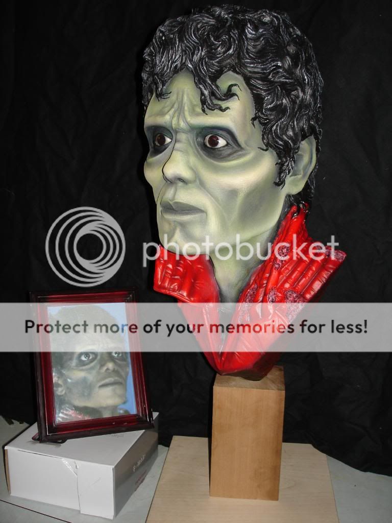

My first casting. Primed and ready to paint. Collar has been reattached. I'll post this in the junkyard if anyone is interested, PM me.
