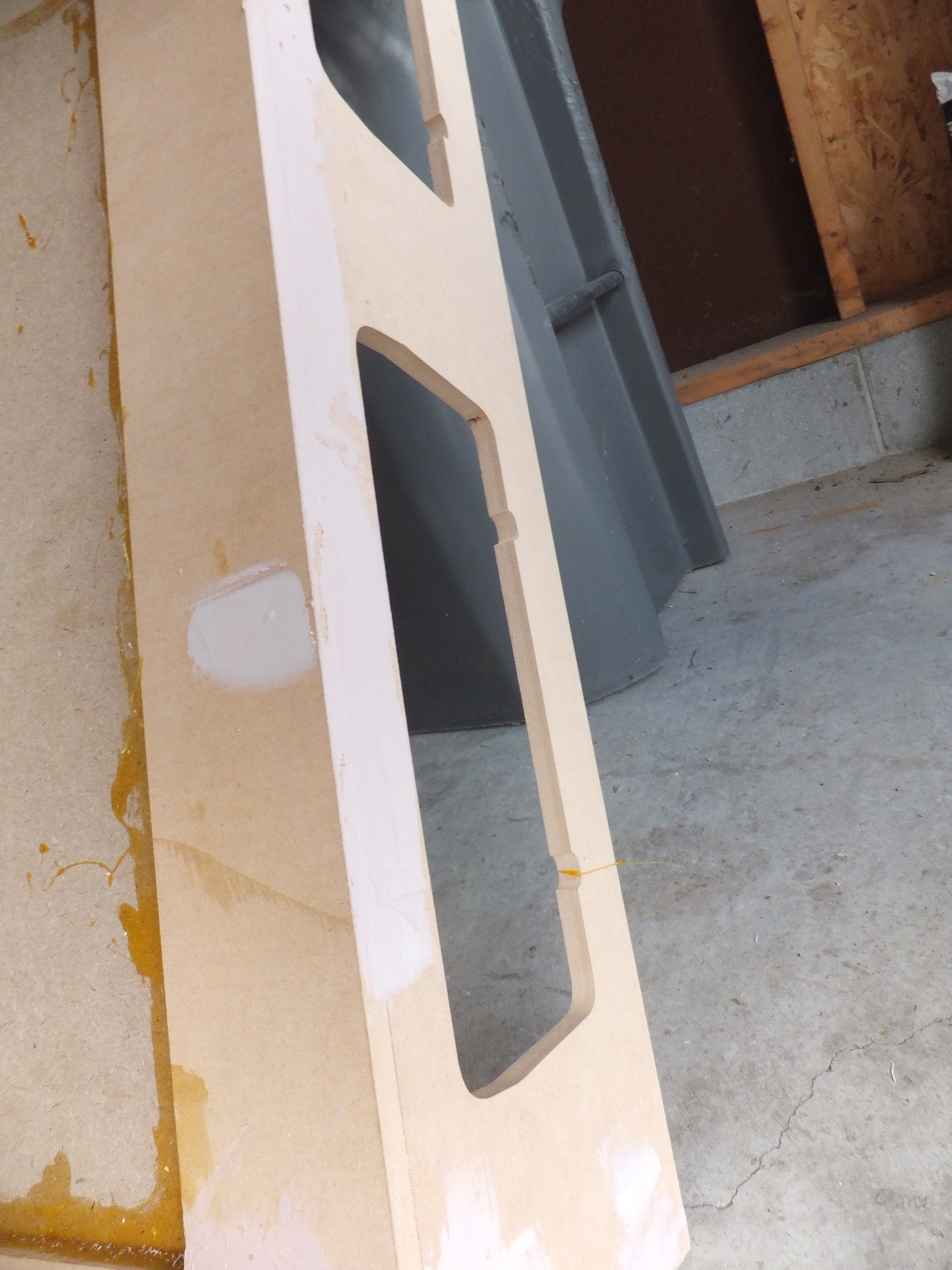

So far ive got about 4 hours into it, and ive got the main box put together, with the first of the backing panels for the front glued into place, this Zenix kit is a piece of cake to work with, i cant even imagine trying to cut/build it all by hand, everything fits together perfectly,
I used 2x4 blocks in each corner, to anchor the mdf to, as well as 1x1 blocks along the sides, just under the top edge, to keep them from bowing inwards, and then i had to shim the front border a bit to keep it from bowing inwards.
im headed back over today to glue another front panel on. Once i get all of the front panels glued, ill most likely start bondo-ing and sanding everything down and get the box finished before i attach the han parts.
ive never worked with bondo before, does anyone know if i should route the edges down BEFORE i bondo? or can bondo be routed over without breaking off in huge chunks?

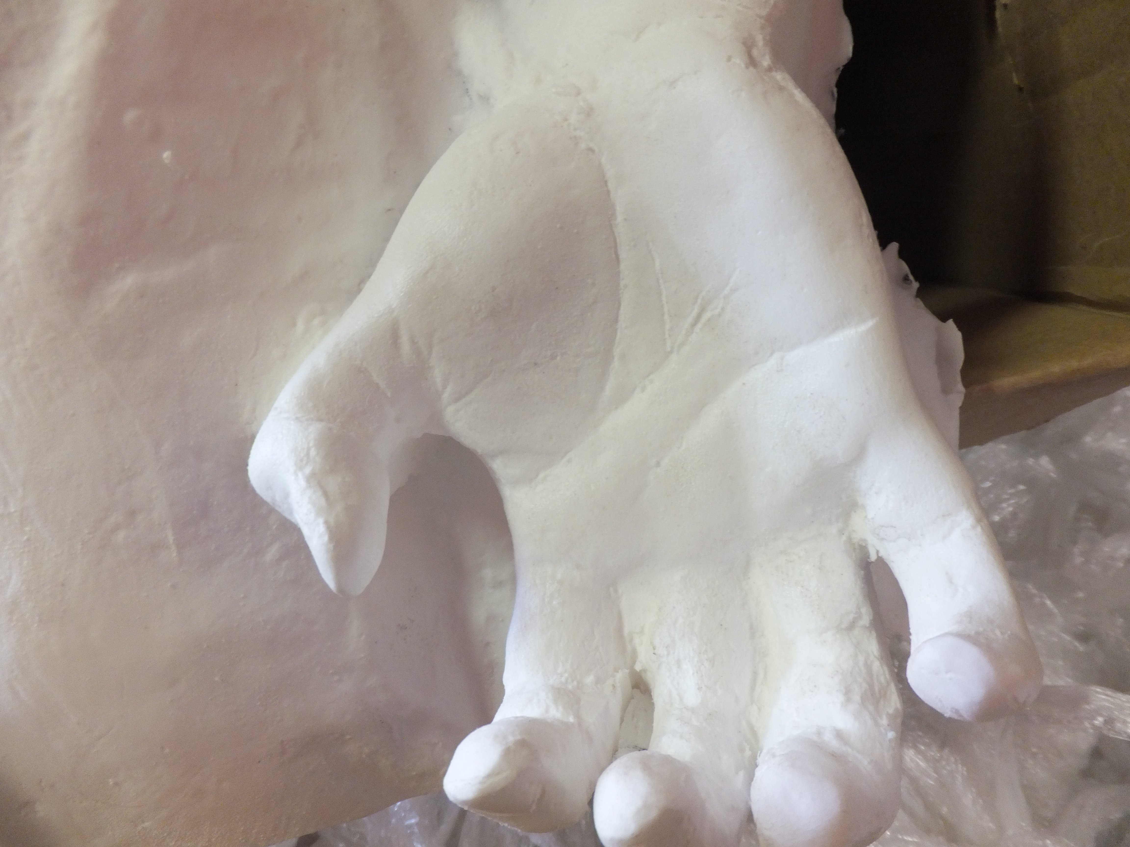

i also took a dremel to the hands, as there was a chunk of resin in between a few fingers that shouldnt be there, as well as sharpened up a few of the lines/creases in the hands,

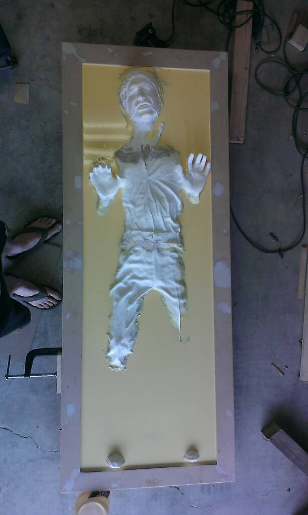

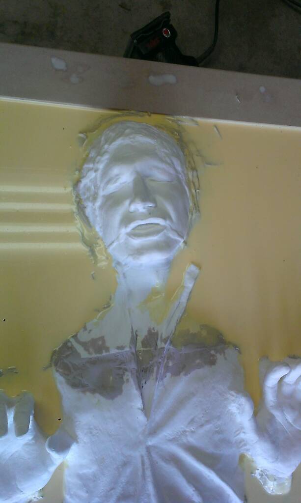

Trying to texture the glue is becoming a huge pain in the ass, after waiting several hours, and messing with the top, its just smoothed its way back out after another half hour or so, leaving almost no texture at all behind.. I've poured the rest of the bottle of wood glue over the top of the old, since it had already formed a skin. And swirled that around a bit so it dosent look so obviously like glue pours,and ill be letting it dry for the rest of the night. I'm thinking tomorrow ill come back and rough up the surface of the glue, and go back over it with bondo for the texture, instead of fighting with this glue forever. uploadfromtaptalk1399494600932.jpg
dino8836
Member
Some people might think im crazy but I had success with plasterers stud glue as it was left over from construction. I set like rock, but had a good set time enough to shape it the way I wanted (a lot thicker than the PVA glue).
By the way I tried the PVS and it took weeks to cure as the skin then enabled the glue underneath to stay liquid longer.

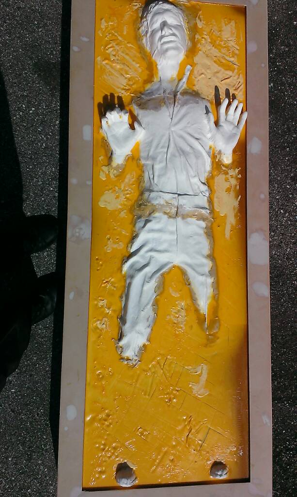

And that's where I'm stuck at for the moment. I came back today after work to check on it, and its formed a nice thick skin on top, but most of its all liquid underneath. So I cut a bunch of slits in a criss cross pattern and squeezed as much out as I could, spread that out across the top, and drug it out of the garage into the sun to bake. uploadfromtaptalk1399582486007.jpg uploadfromtaptalk1399582502799.jpg

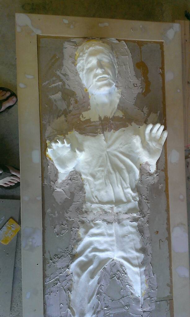

Went back today and the glue was mostly dry, still some spots that hadn't fully dried underneath yet. I scored the crap out of the glue to give the bondo something to stick to, hopefully it works. I started bondoing on top of the glue, on the bottom corner where the glue has fully dried, ran through the rest of my little can of bondo pretty quick, so I'm done for the day. Ill swing by home depot and grab some more bondo after work tomorrow and continue
The Schlitzie
I'm at the exact same stage in my HIC build. Crap, I wish I had spotted this thread before you poured the glue. I learned that with the wood glue you have to do multiple thin layers. That way it dries much faster and has a really nice layered texture.
