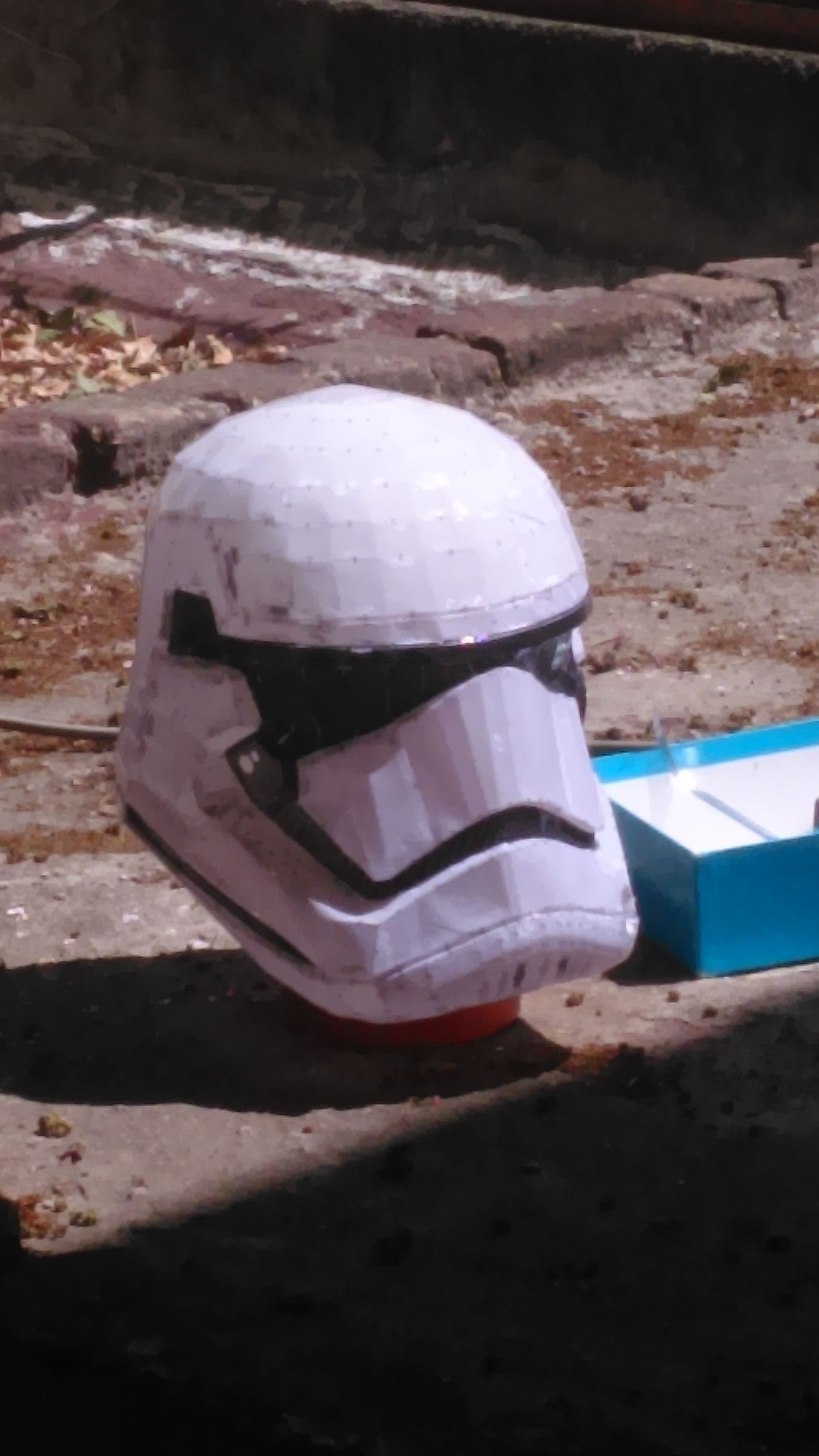

any way, this is what i did
i put it on the rooftop, the sun will make it to dry in seconds
So its done, but its not round like the ones i see, there's lots of angles that are "highlighted" cuz the resin

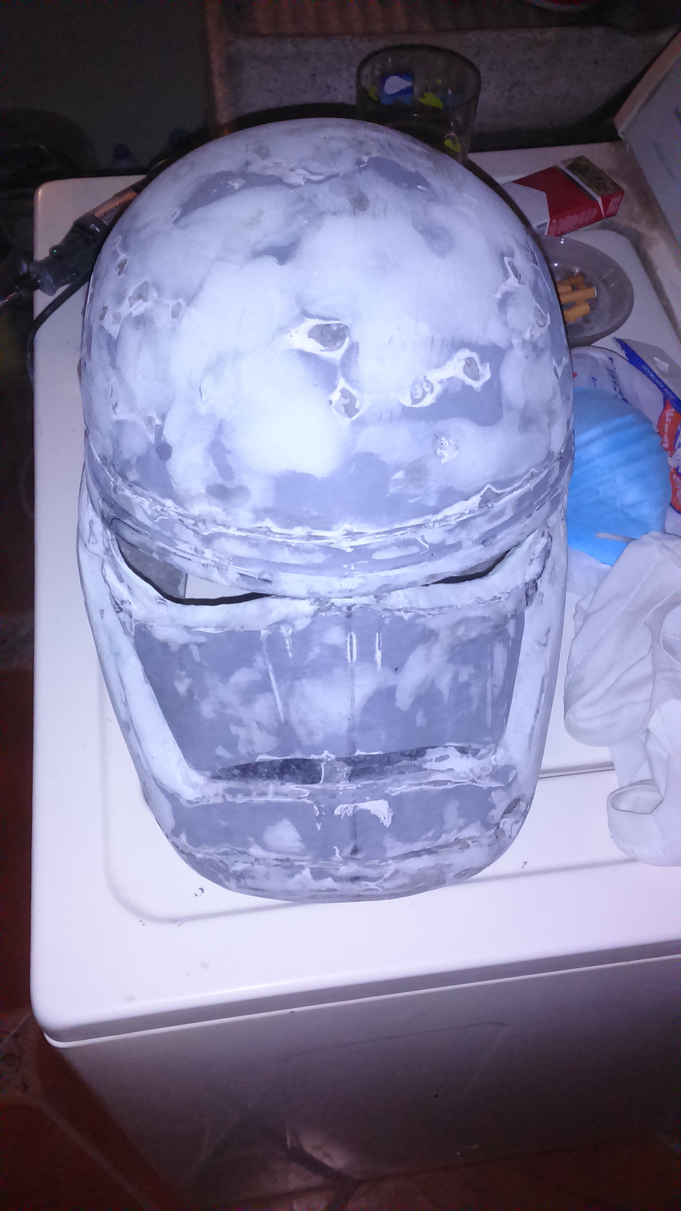

You can see all the pointy angles
*Use your respirator at sanding. it will generate to many dust, all you can and will taste its gonna be plaster/bondo dust on your mouth besides the coughing

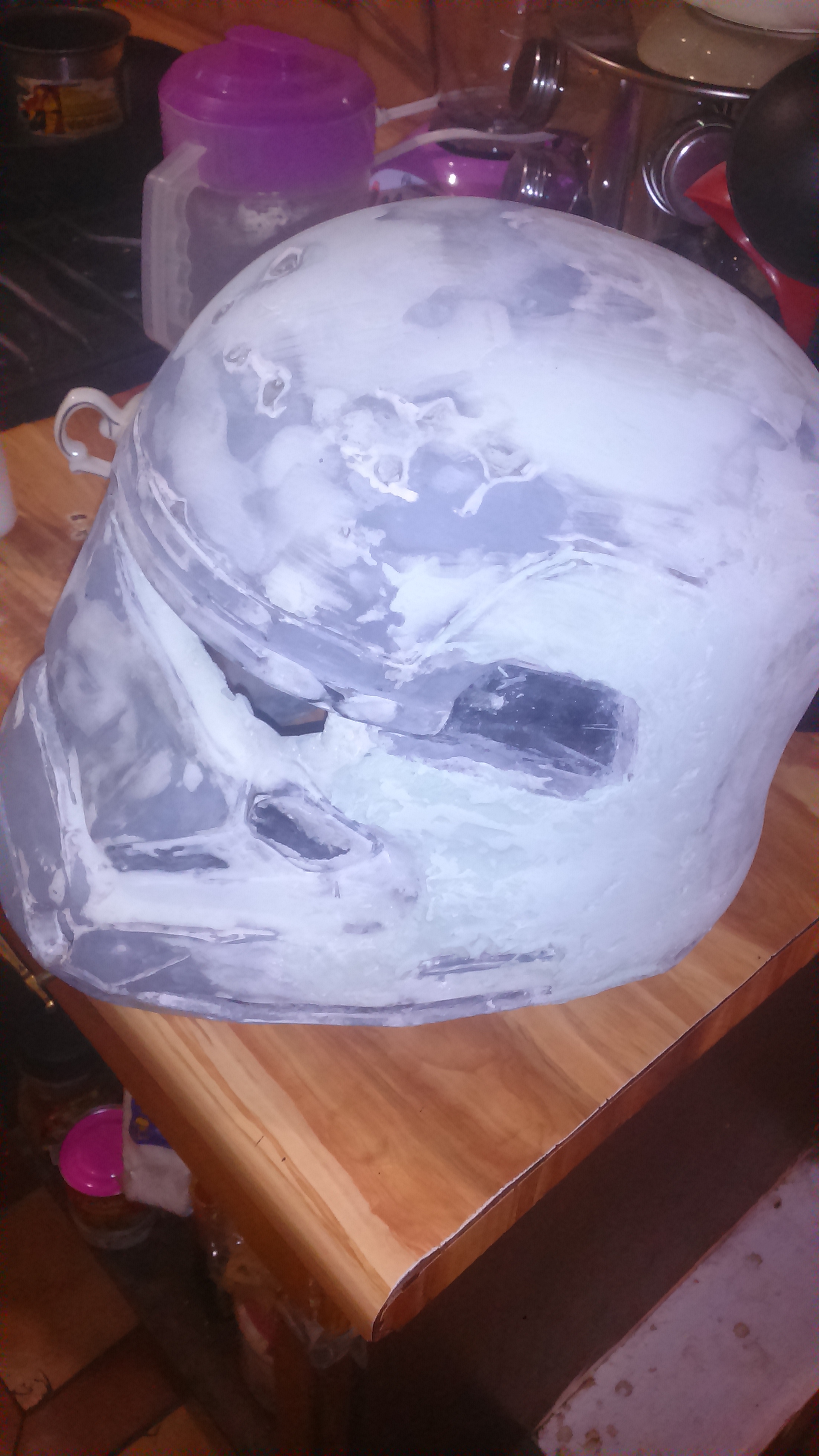

...and sanding, and sanding ....
( all the grinding were made by hand at this piont)
I don't like. it has no sphere shape on the top (cuz i fail on the cutting and gluing)

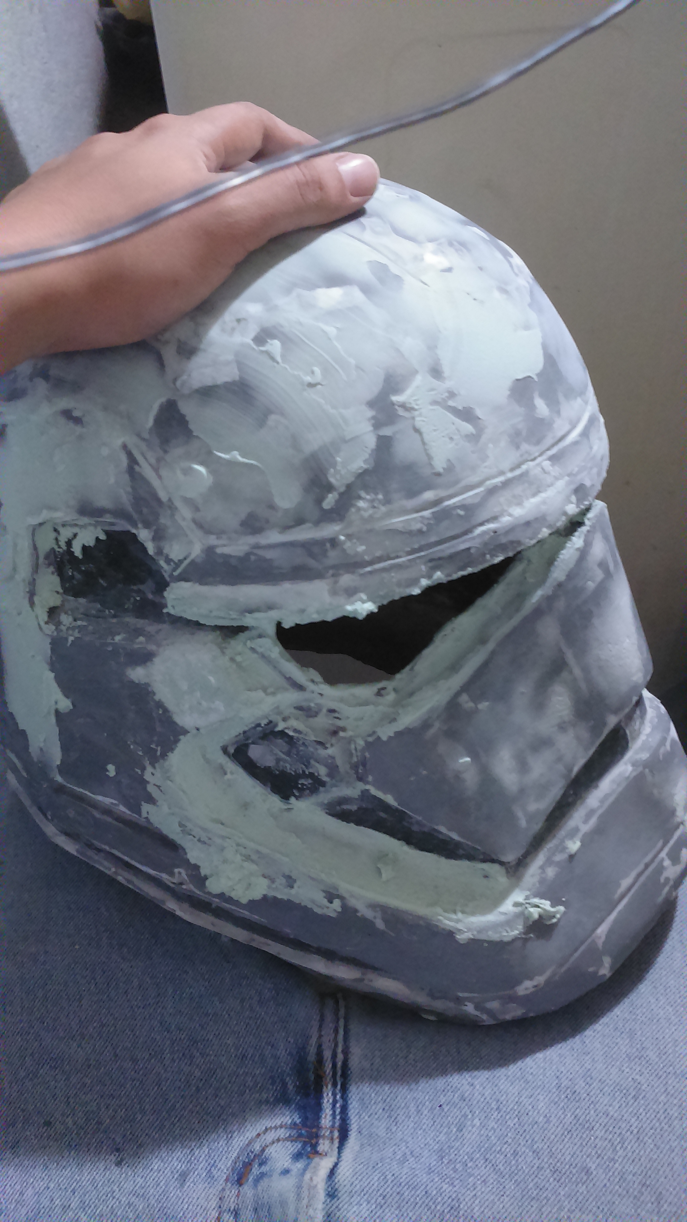

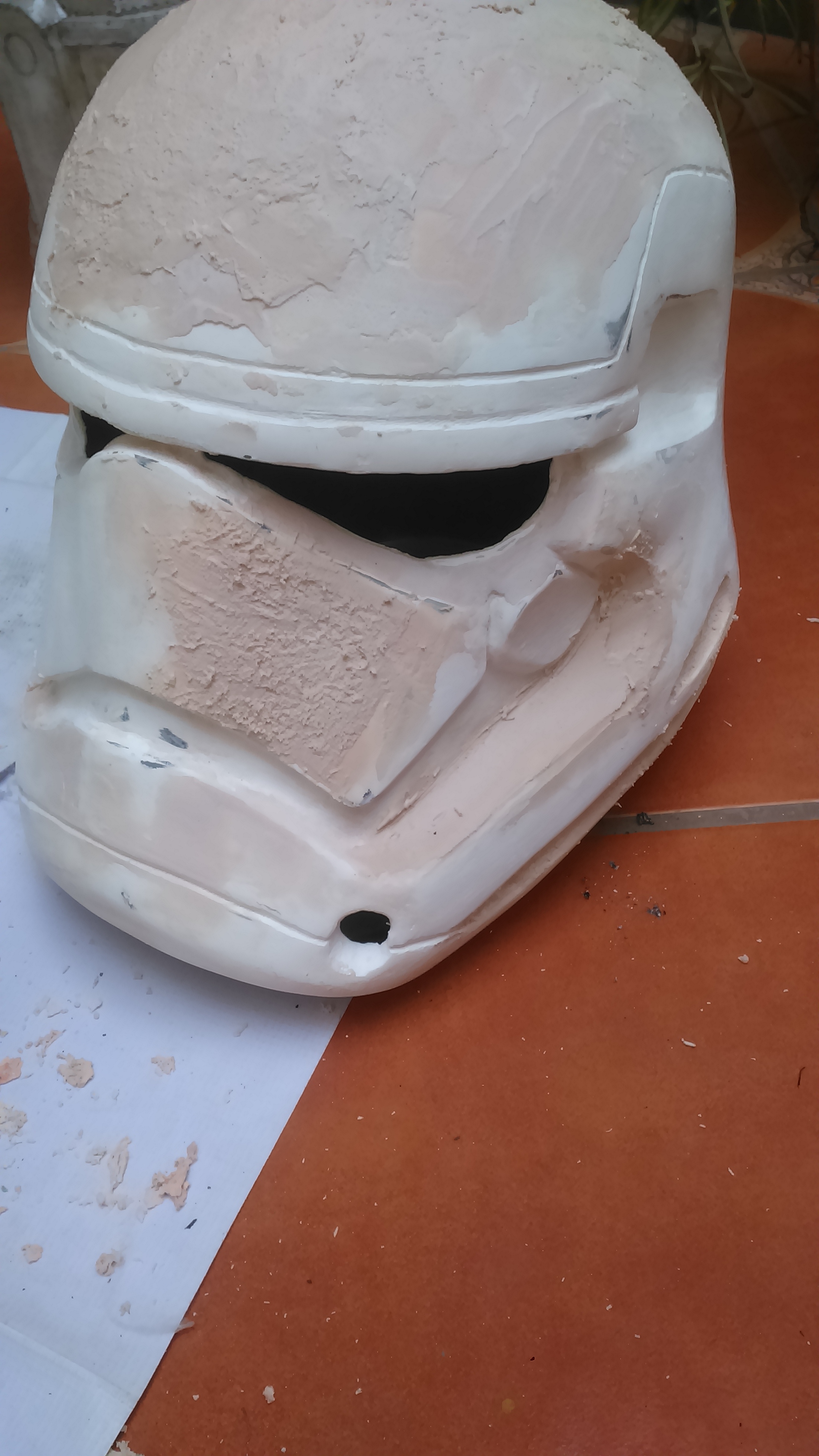

tthen i bought bondo
so more sanding, and bondoing and sanding...

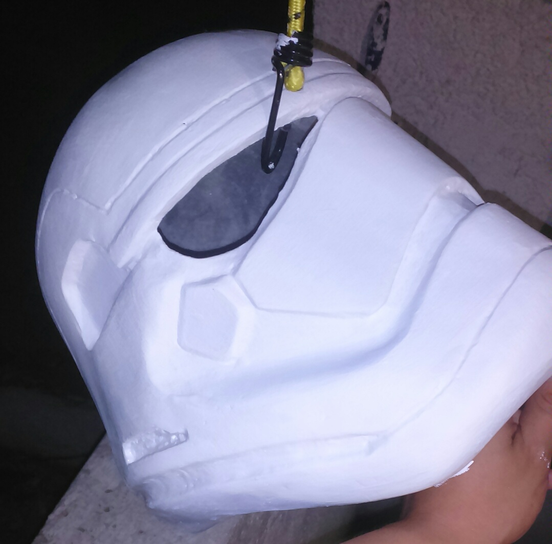

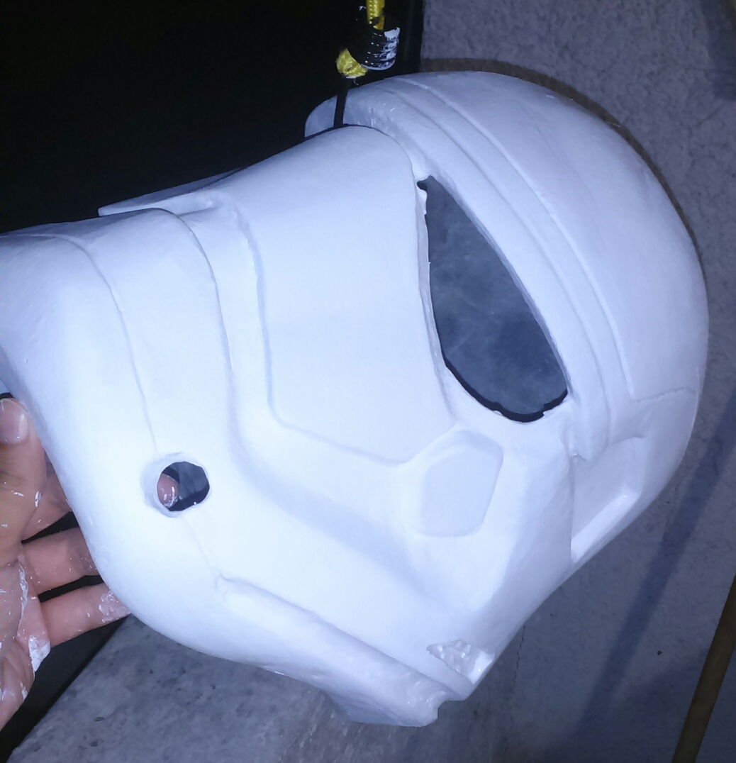

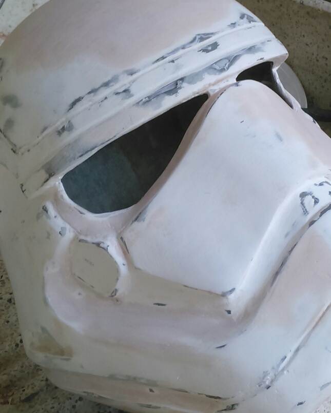

At this piont it was really smoot but still feld kind of bumpy. The thing is that its hard to sand even and it couses to feel that way. so... i decide to painted white
it help a lot cuz of the shadows.

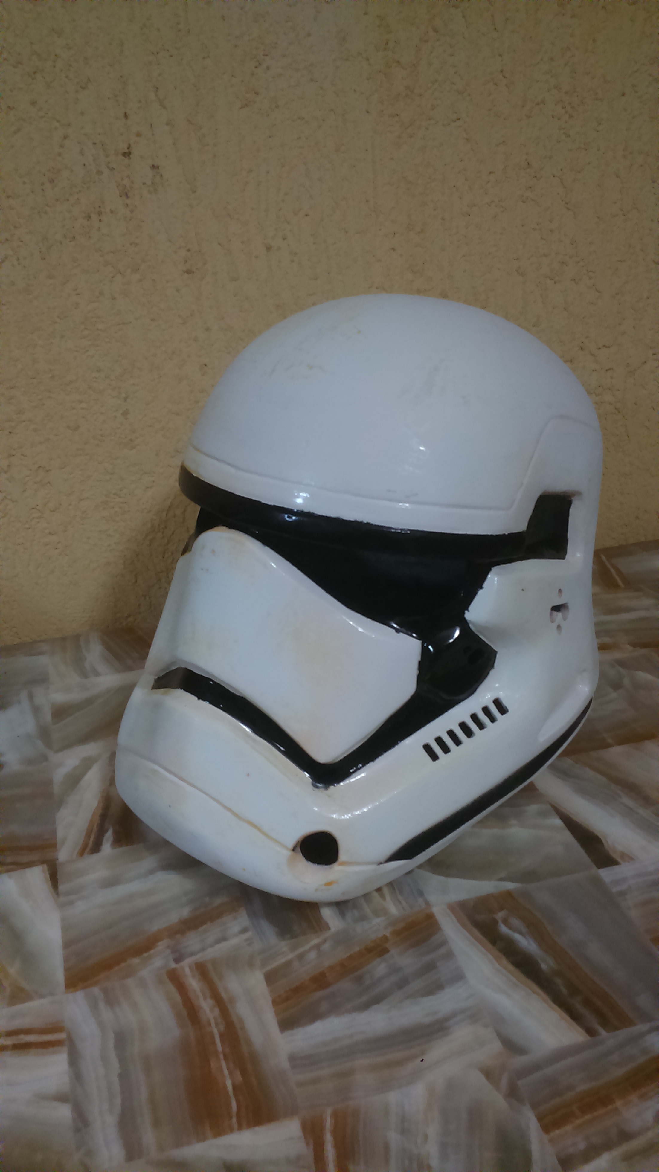

And more bondo and sanding...

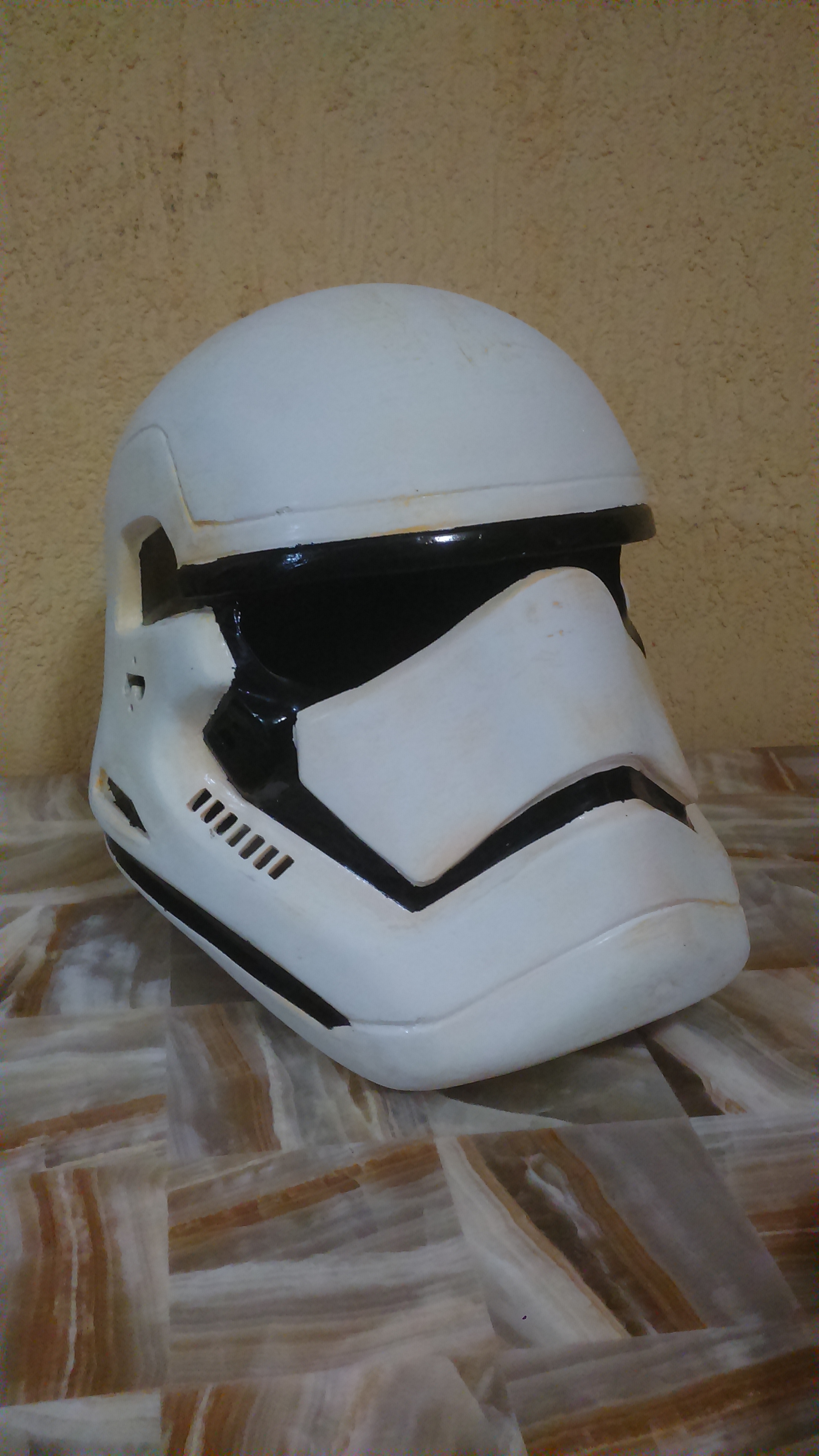

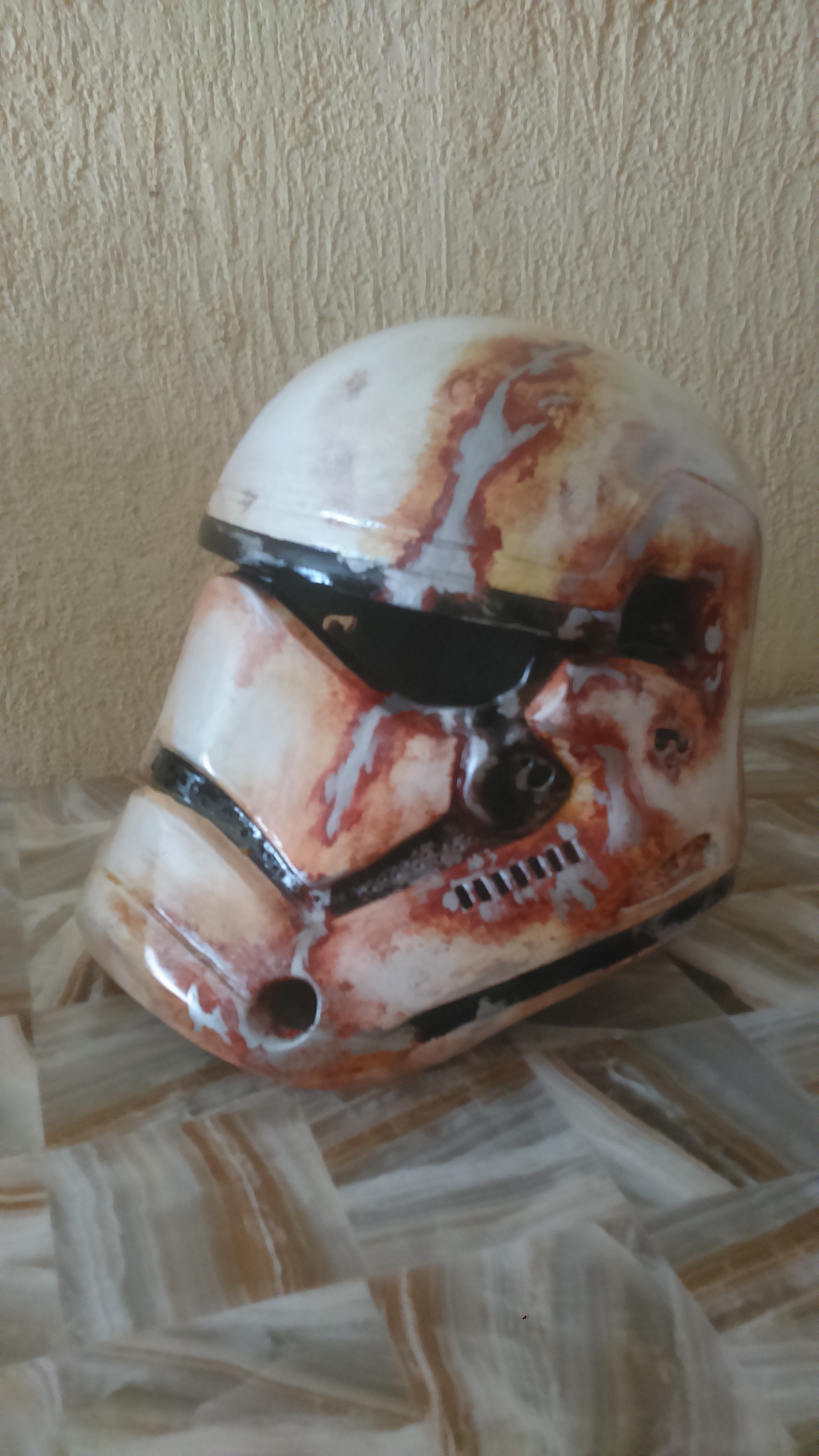

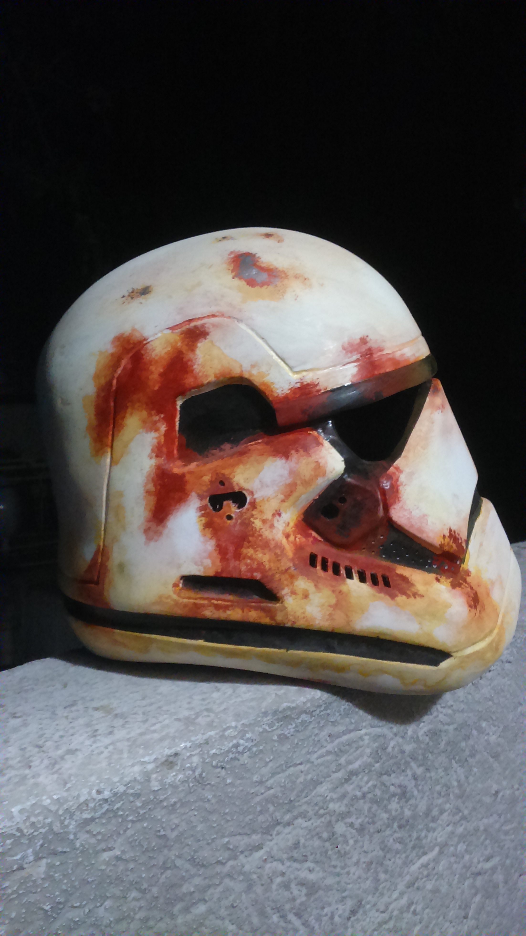

Then, the paint job. i know its sloppy but i wanted to weathering the helmet

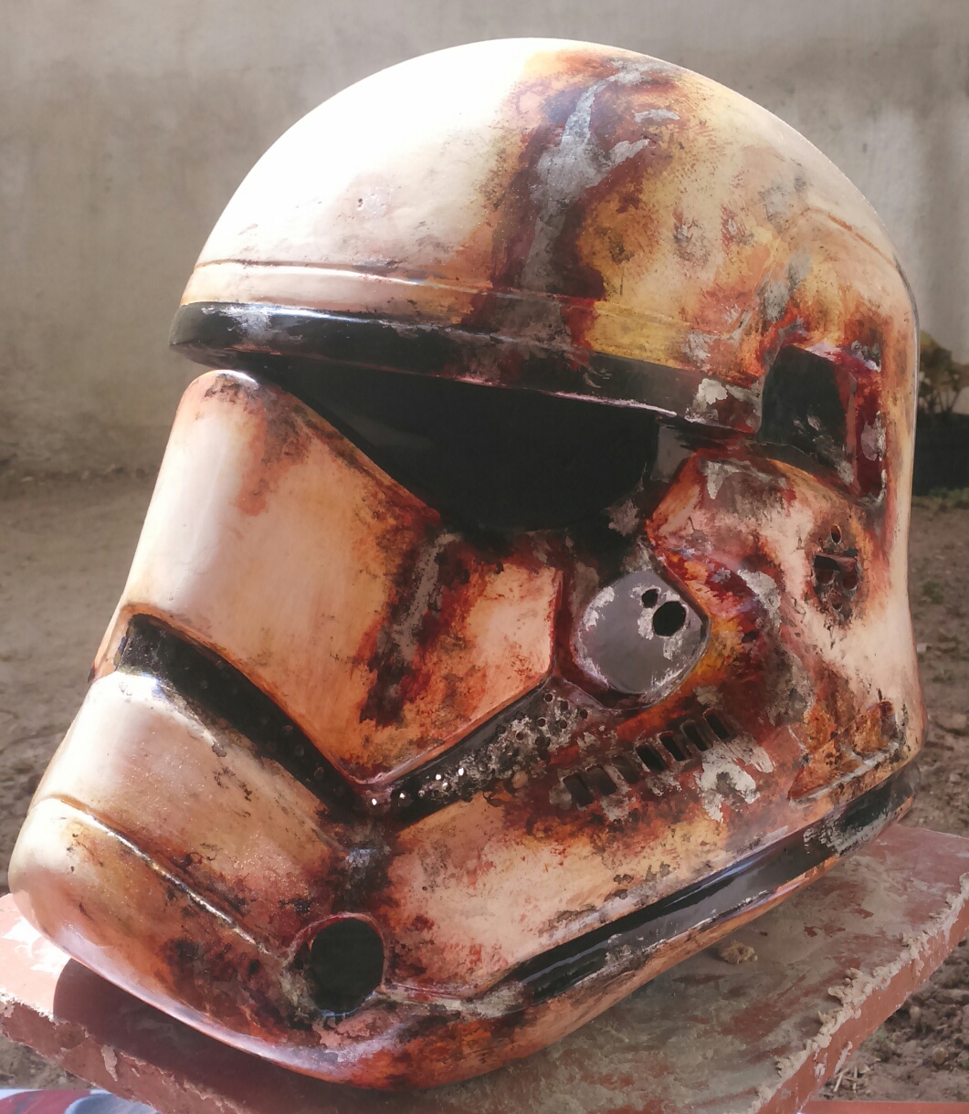

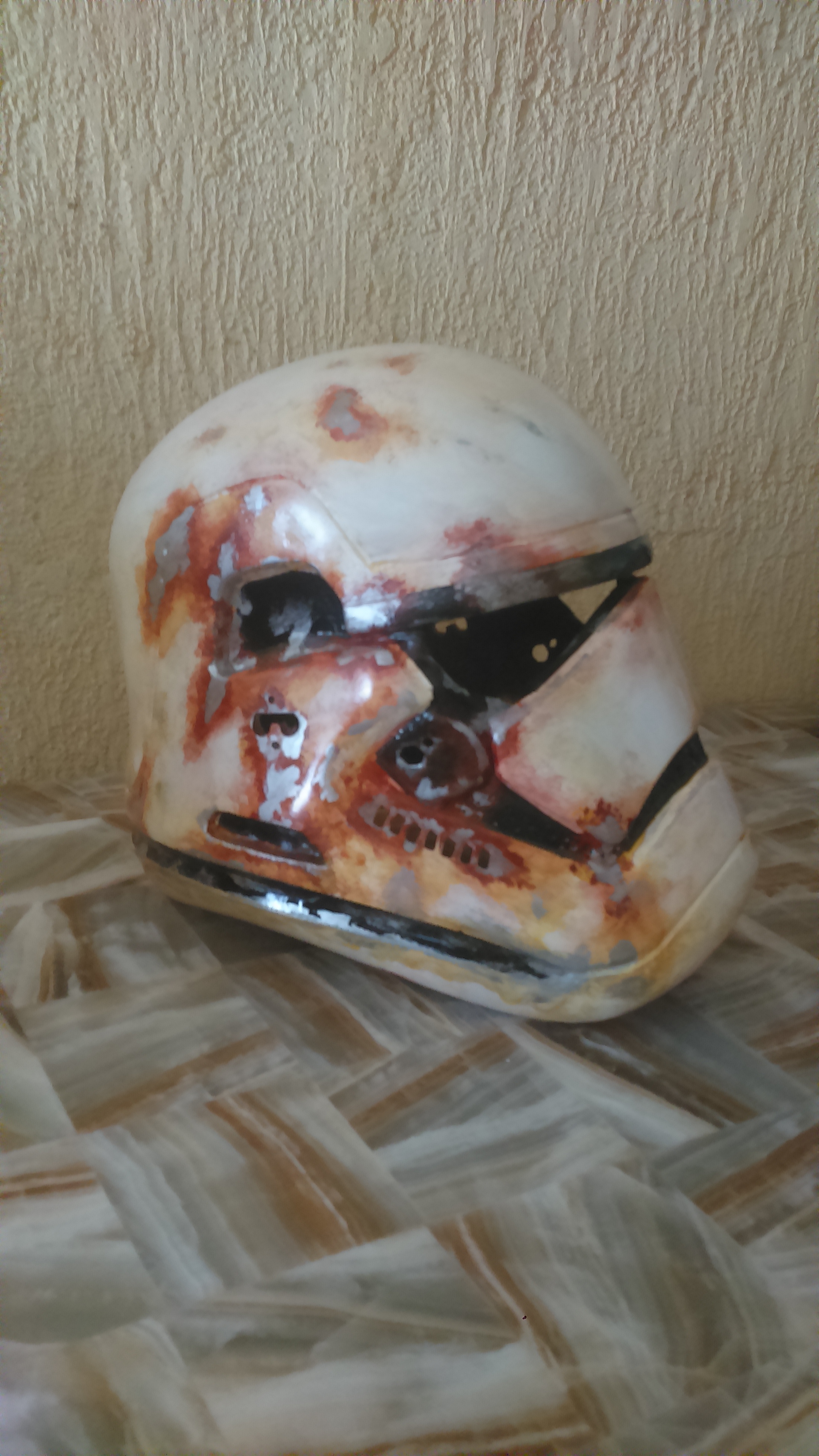

and the weathering...

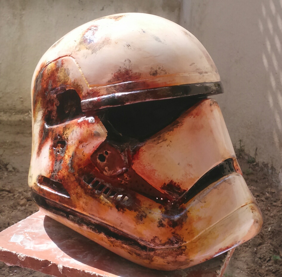

more paint..

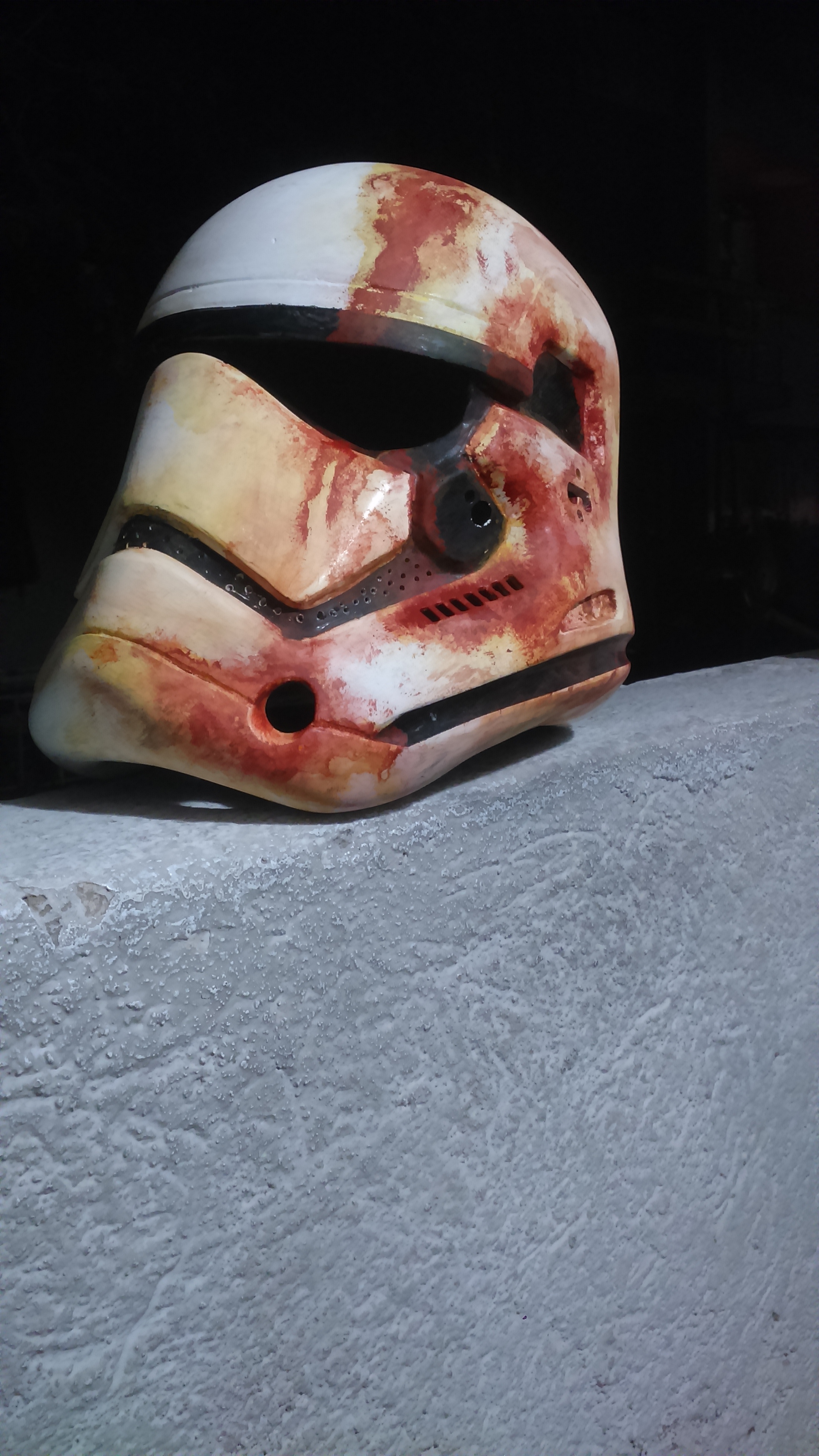

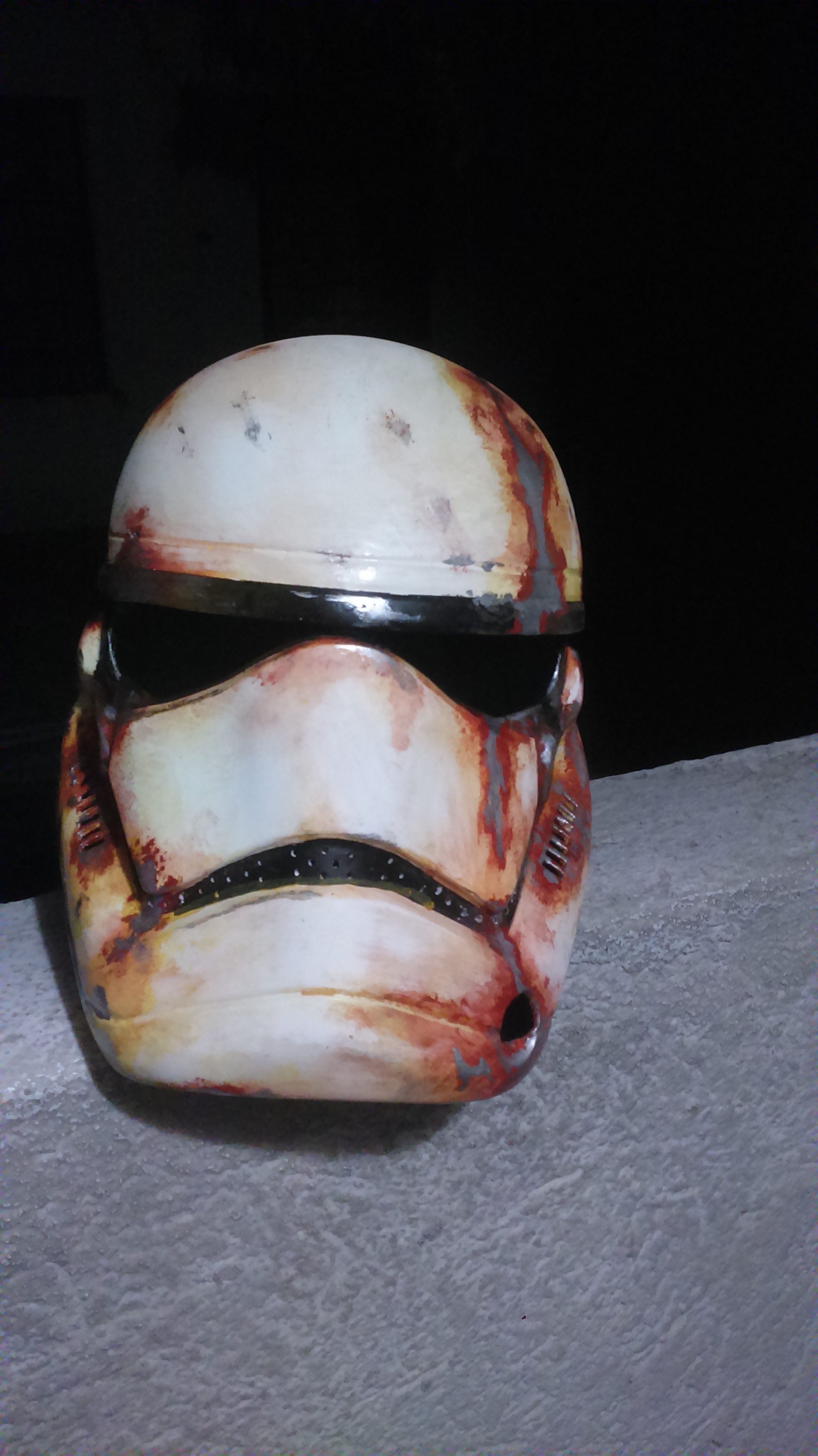

and here it is the finish helmet
I really enjoy all the process of this. its a nice hoby
