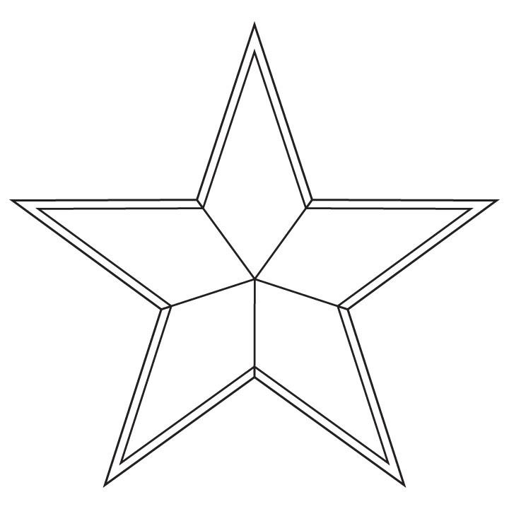

what template did you use for the star?
I used the attached template I got from Valor's shield build. It worked splendidly in a 10" centre circle.

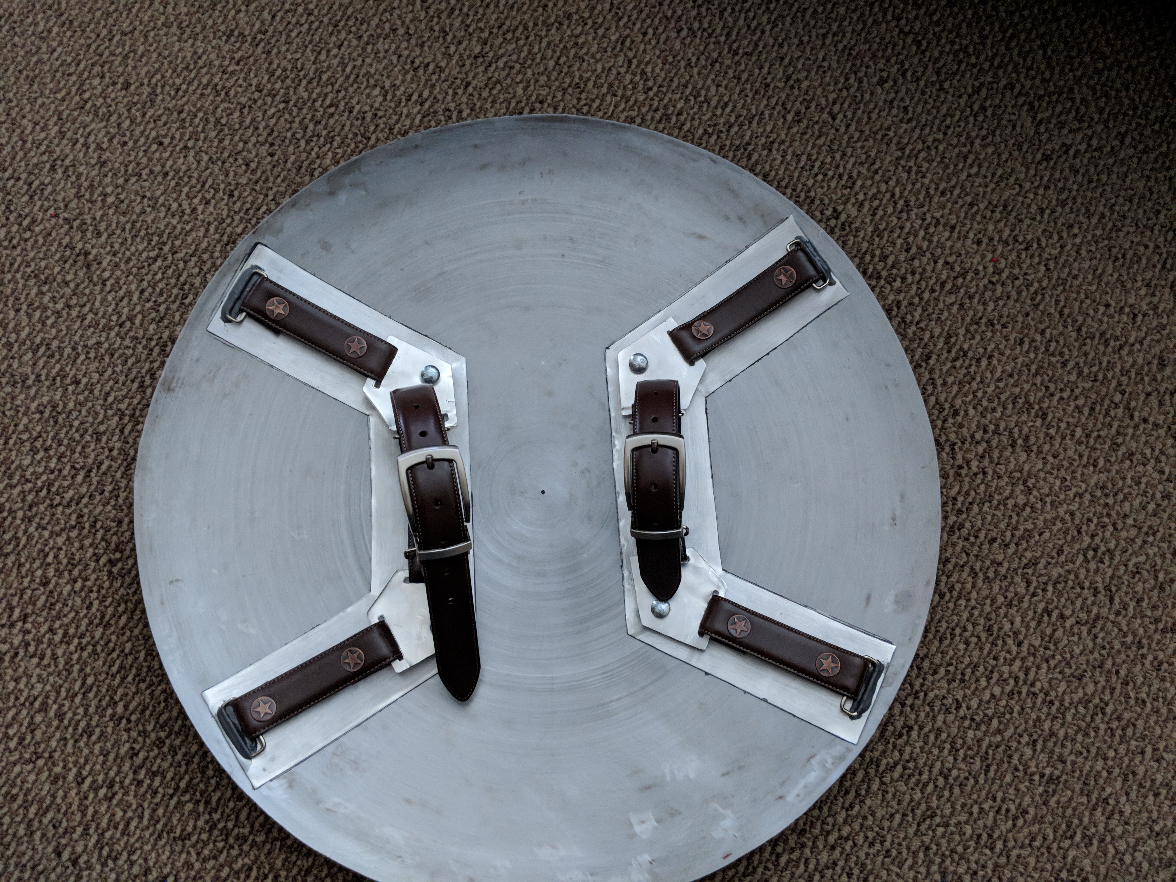

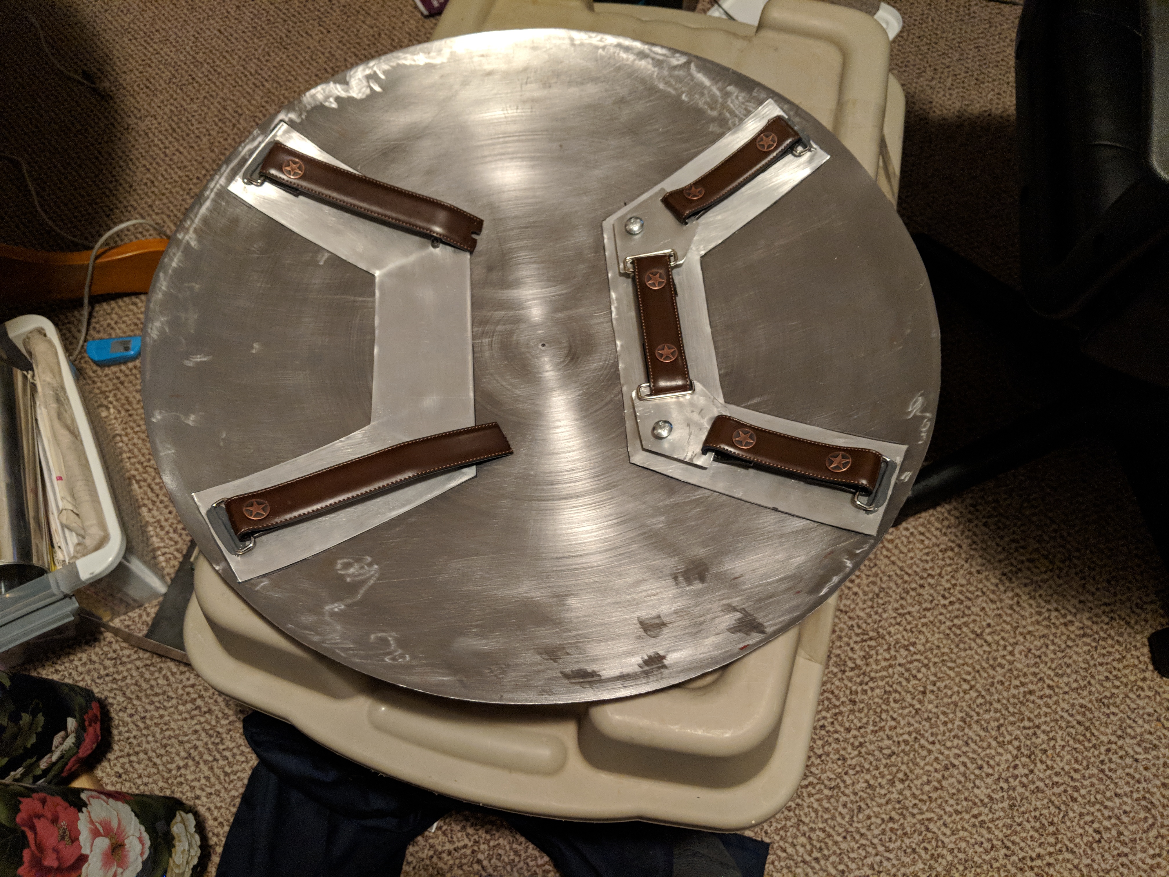

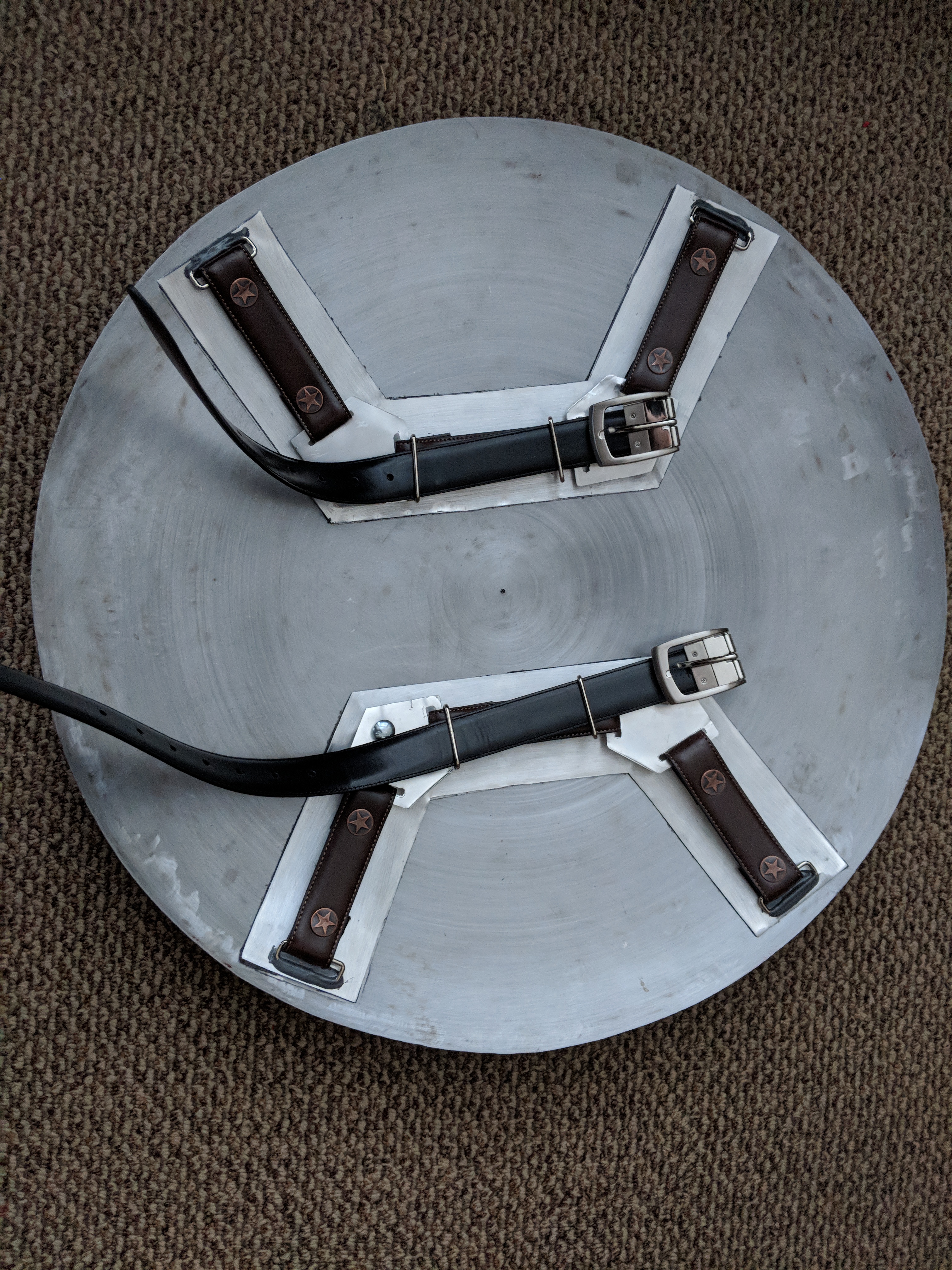

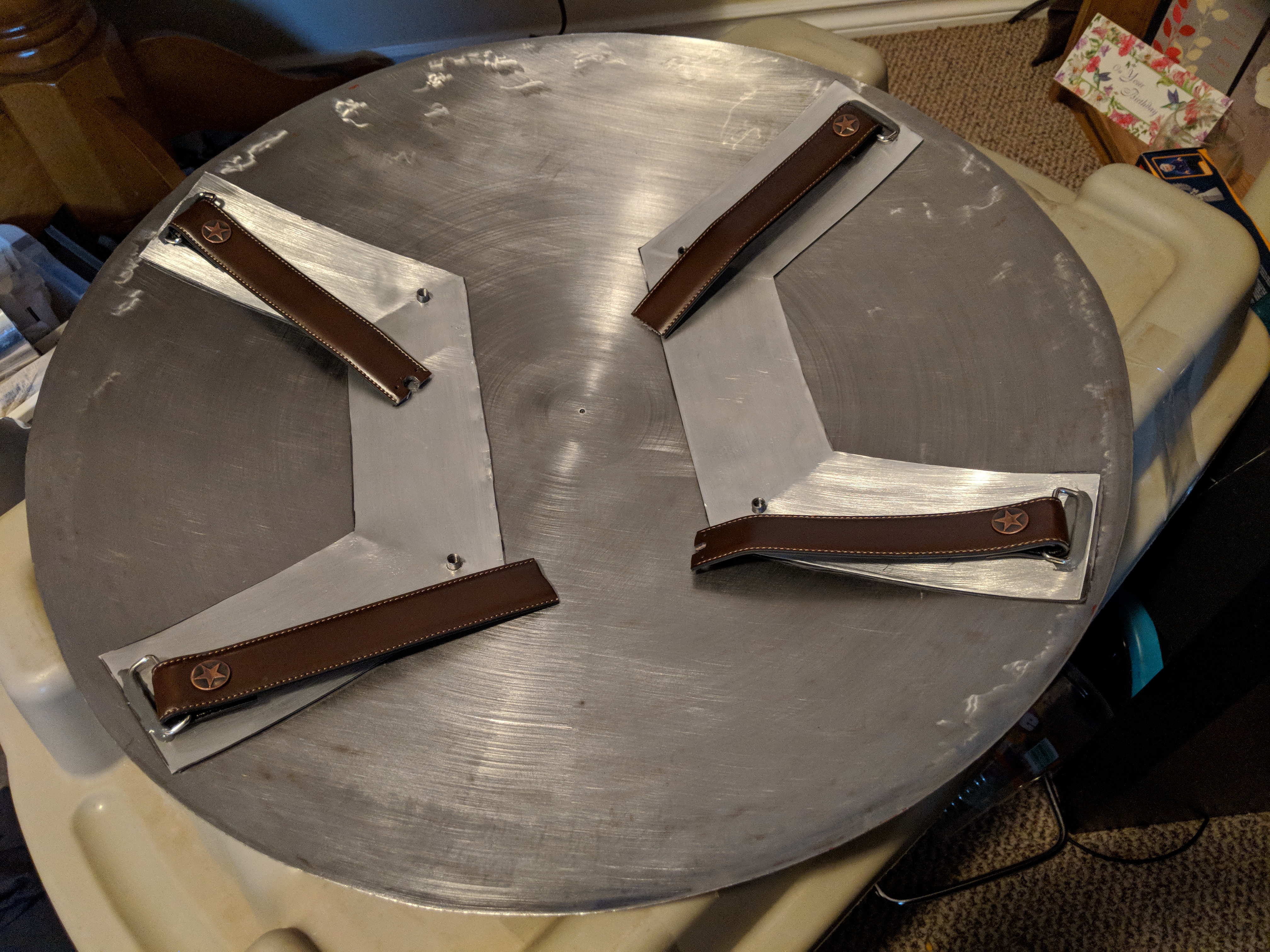

Finally done-ish with the shield! :D Got the clear coat on the shield, and then attached the brackets with some 30 lb. 3M double-sided tape. It hold the brackets really well, I can pull on the bracket and it feels like the metal is going to fail before the tape. Attached some rectangular loops with JB Weld for the outer attachment for the leather. The part that gave me the most trouble was making the middle attachments that hold the leather. The metal warped a lot on the first couple ones I made when I made the slots. I solved this problem by cutting the slots before removing the attachments from the sheet of aluminium. Once that was done, I attached them to the shield with some tee nuts and carriage bolts I cut down to size with a hacksaw. The next step was attaching the letter, which I did by reaming holes into a cheap cut up belt I got from Walmart, and then using some jean buttons I got at the local fabric store. In the middle I added some more rectangular loops to attach the belt loops, and now it's done! :D Still toying with the idea of adding some fake rivets done the sides of the brackets, as well as a US Government Property plaque in the center, but for now I'm calling it done!
