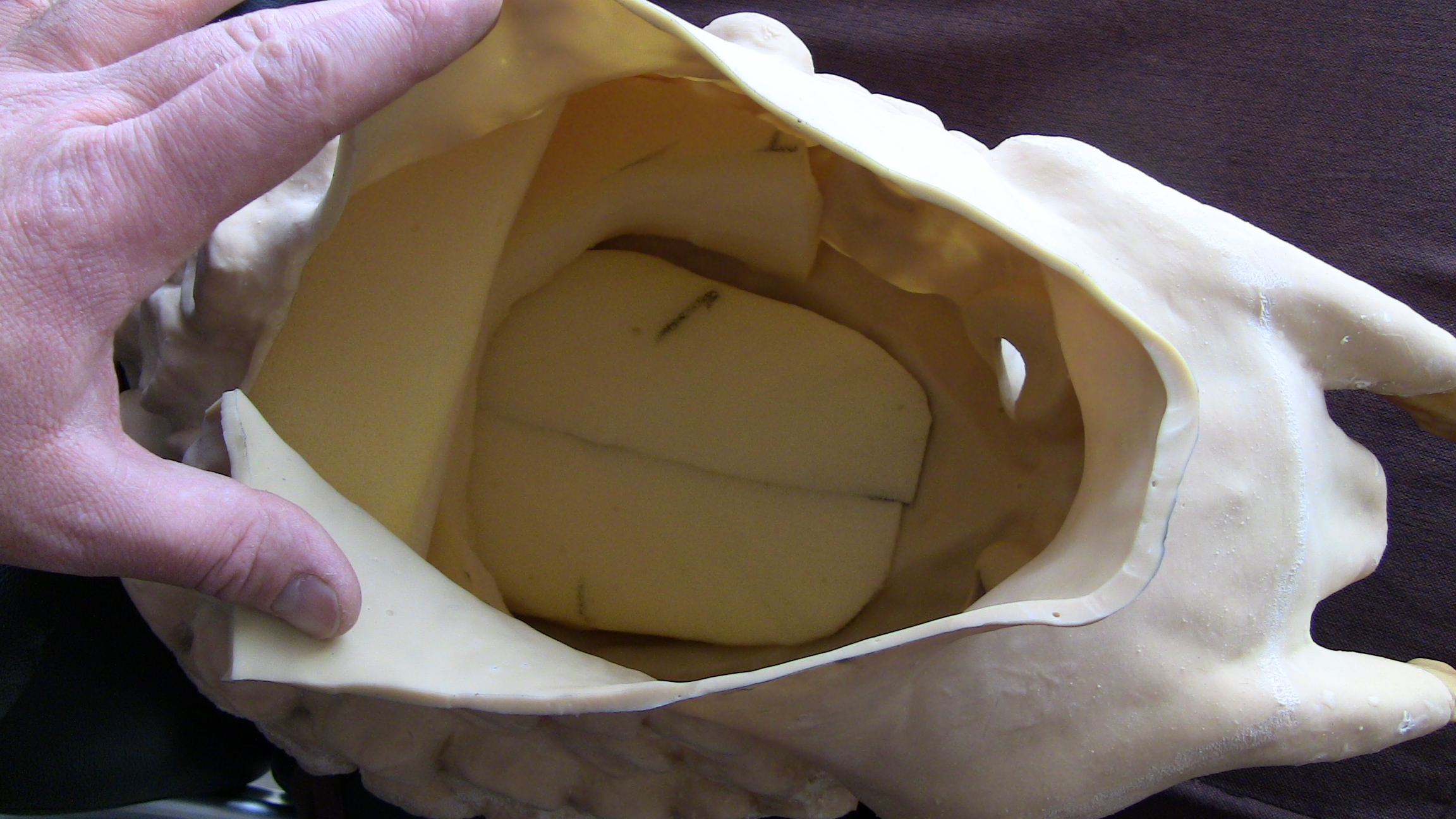

First I removed latex teeth , and i make my own ,from clay.I made latex mold for cating theet in acrylic resin.
Put some foam in the mask to fit.

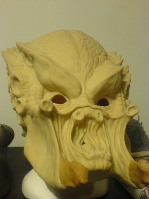

After fillling all the little hole with a mix of talcum powder and latex, I apply the paint ( 6 volume of createx paint for 1 of permawet)with airbrush .

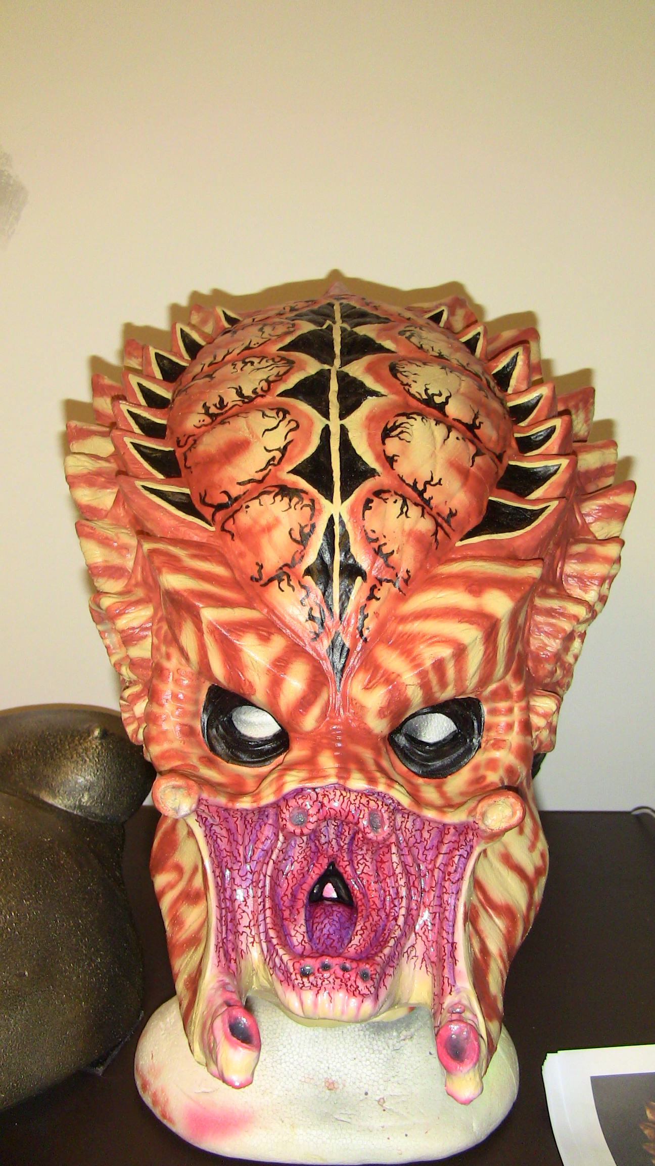

I used a brush for details...
I painted some sadows area with airbrush and put the quills and dreads.
The final result:

Dude beyond AWESOME !! question What did you use to draw the veins in the mouth? Airbrush, marker? I really hope my first paint up for the Chimera Hunter is at least half as good as your dude...

I used a marker for drawinng the veins in the mouth :
and now like "Mbzradeloip" said it'll be better to lighten up on the mouth veins,but I'm still trying How to do that...

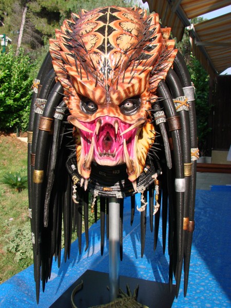

After your advices this is a little update,I tryed to lighten up on the mouth veins, put some brown on theet,I removed quills and stick them better, and this is the result:

Finally after one year,
I dicided to repaint jaws and some parts , changed quills ,dreads and beads, and get dreads and beads from Bambooie , glass eyes and quills from Froggy P2 neck seal from Biohunter 76:
