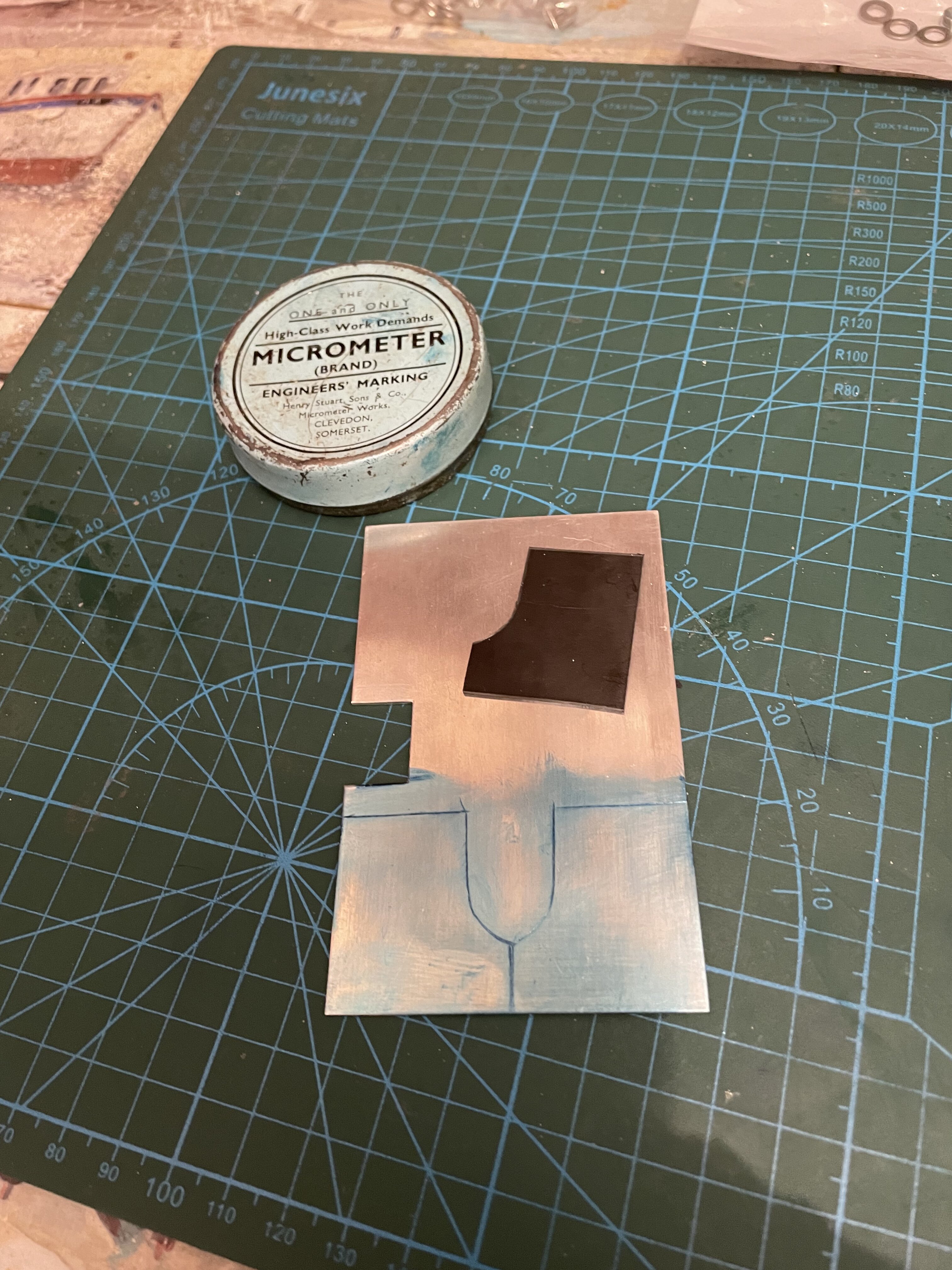

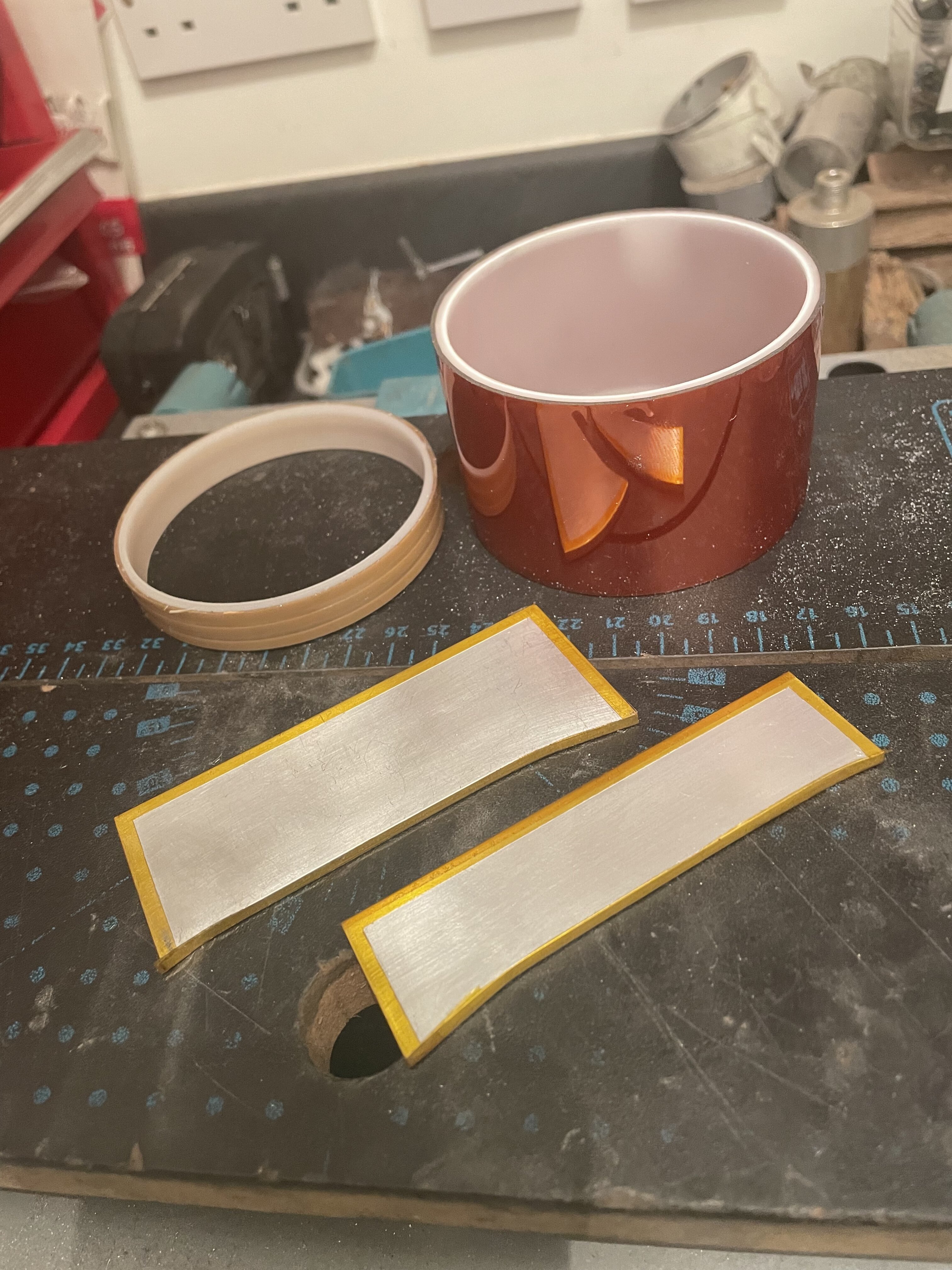

I got the top and bottom plates cut out and filed to fit the contour of the back. I don’t have access to a milling machine, so I thought I’d try to etch the lip using salt and copper sulphate.
I’m pretty pleased with how they turned out. I really didn’t want to have to re do these parts as they took me the best part of a week, I still need to drill some holes in them for the switch, so really hoping I don’t f’up.

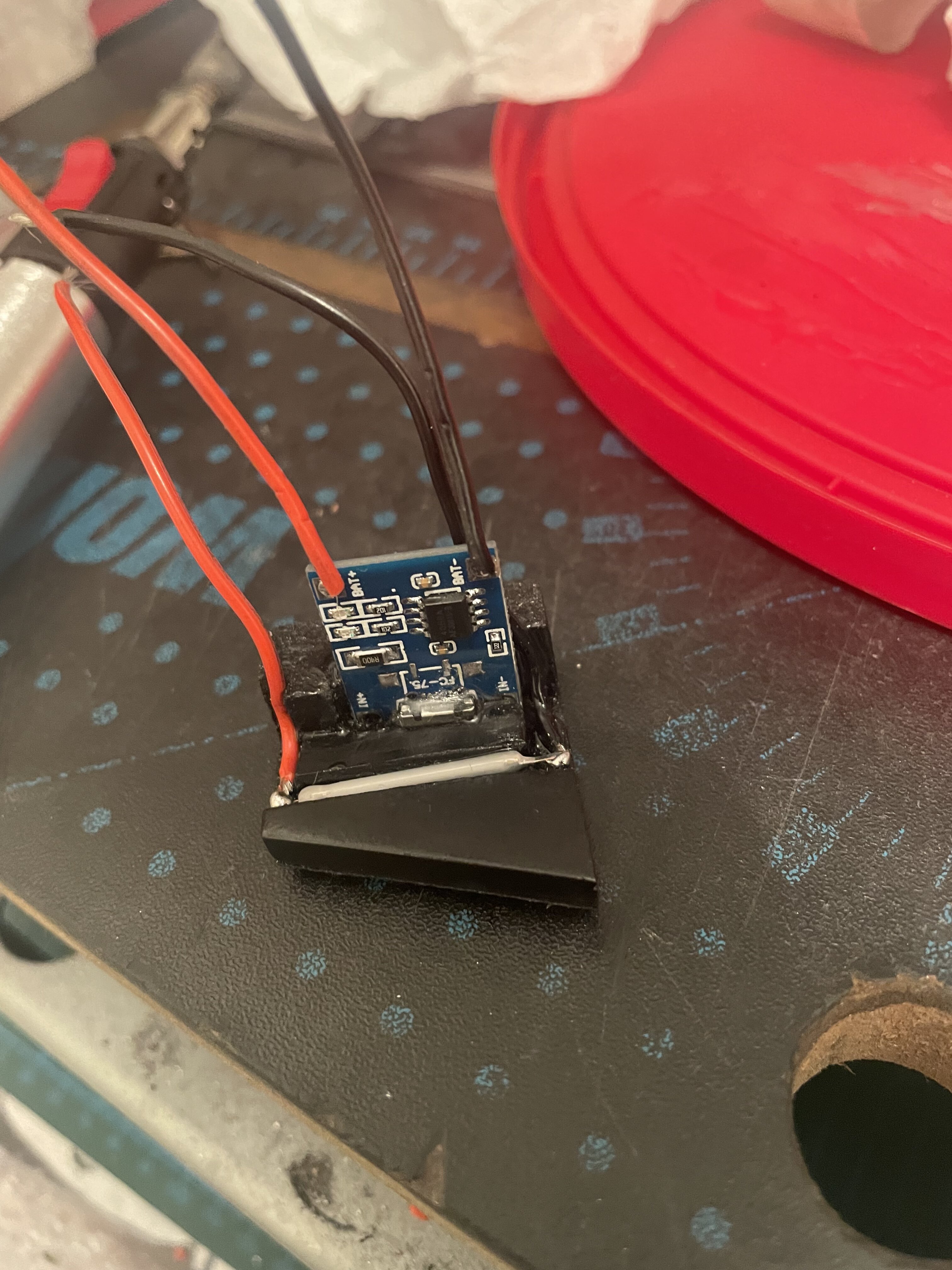

I thought about just sealing the battery in, and although I’m adding a recharge port that was still really bugging me.
So I decided to cut an access hole in the back, I took out one of the rivets from the back plate, tapped the hole and swapped it out for an bolt, now I can remove the plate to change the battery if I ever need to

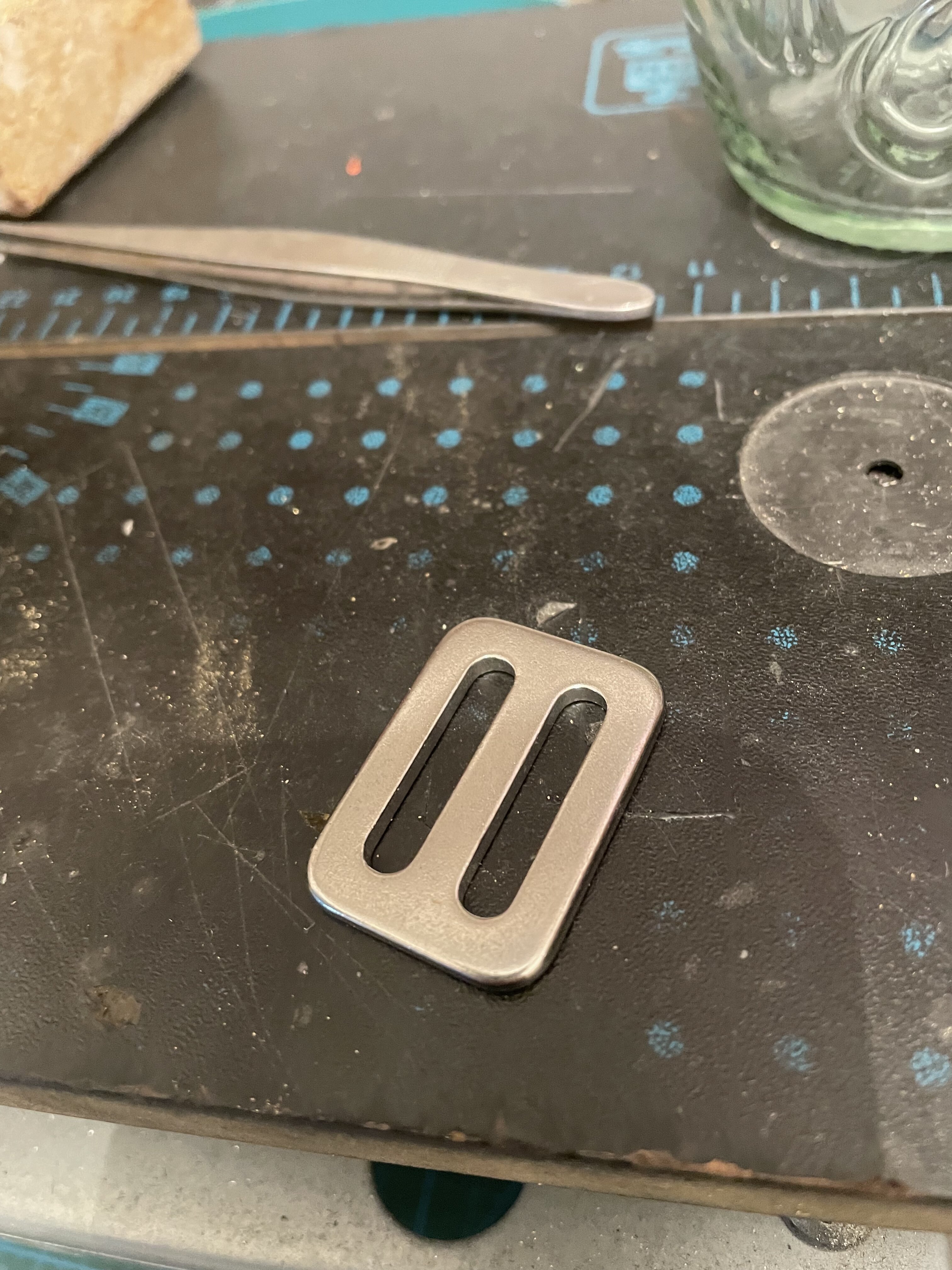

I found a slide buckle for the strap, it’s a little too fresh for Star Wars, so I’m soaking it in white vinegar for a few days to take off the shine.

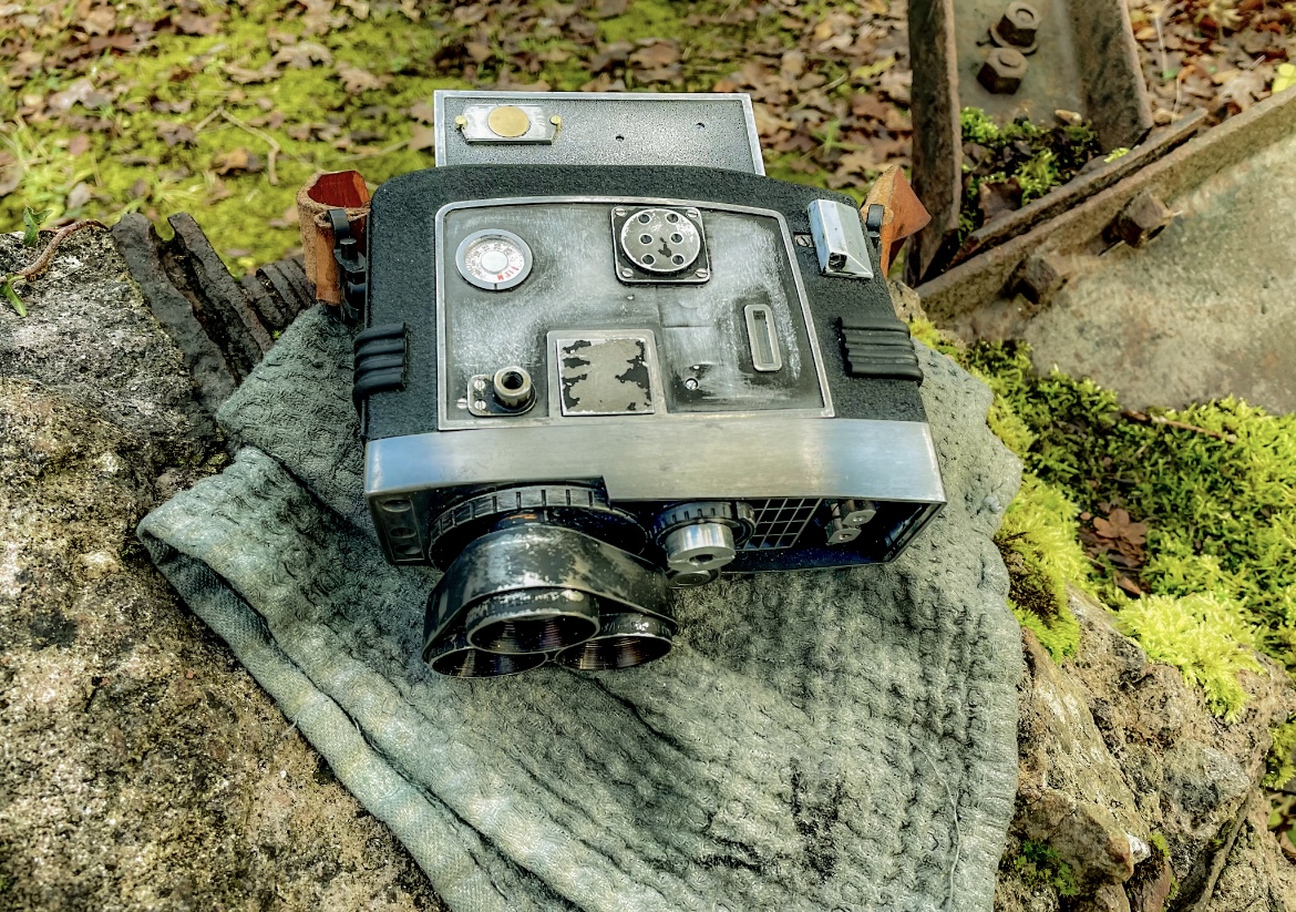

Finally got her finished and had some time to go take some pics. Really pleased with the end result. I’d like to take the trooper Trent for his excellent work on his kit and for sharing the images, whilst I didn’t use the kit the thread was a great inspiration/ reference. I’d also like to thank jocha for sharing his file for the laser etching of the display screen.

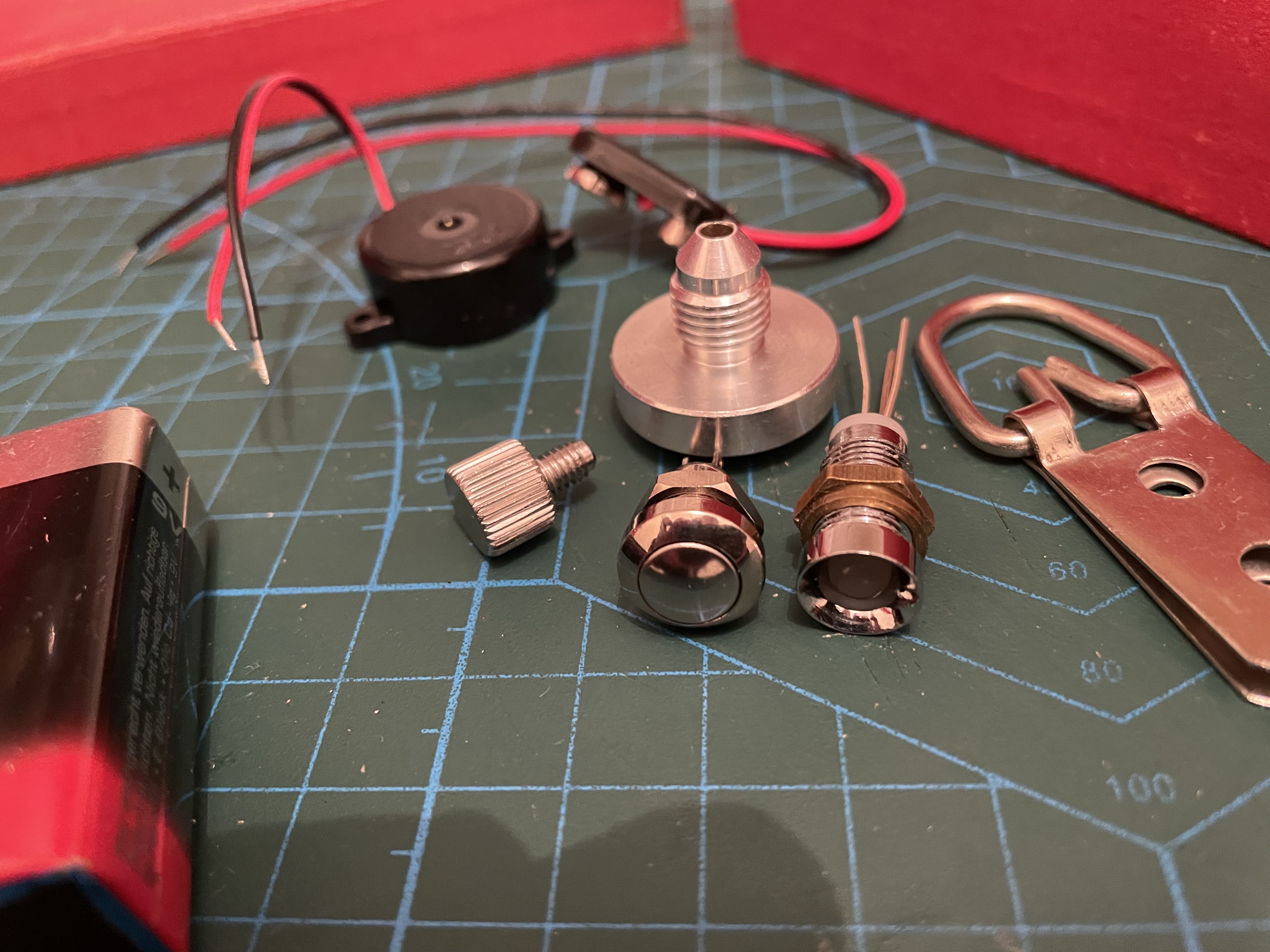

Here’s all the parts, obvs there’s the flash, I’ll be adding a switch, led, buzzer, battery plus connector, d ring, an ANC 4 weld on fitting and a knurled thrums screw.

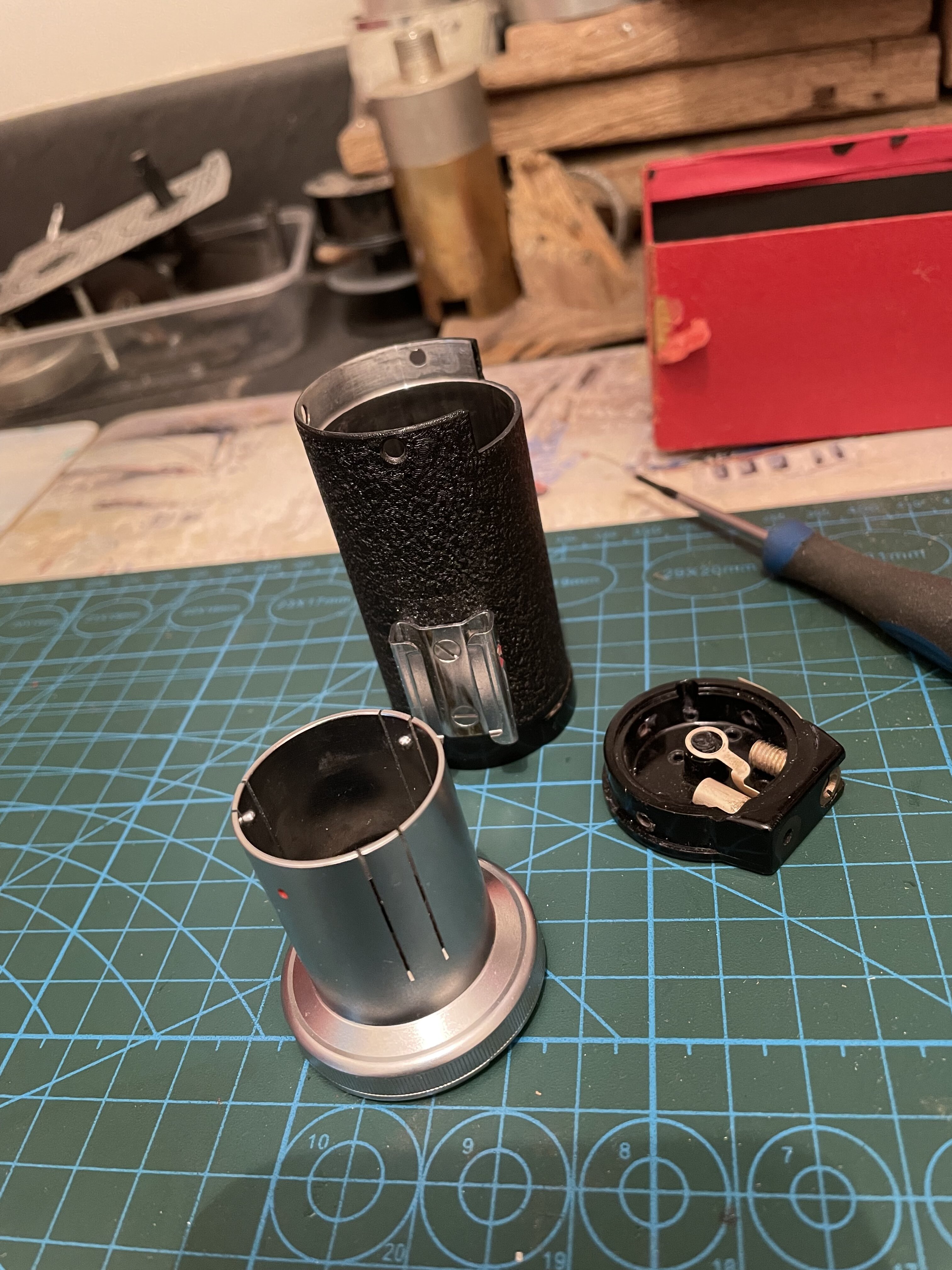

I stripped the flash down, here are all the bits I’m keeping for the build.
And here all the extra pieces I don’t need, including a funky 22 1/2 volt battery. There’s some nice potential greebles here - I’ve ear marked the brass pin for a hardware graflex.
The bottom is held in by 3 screws, (don’t loose one like I did and spent about 30 mins hunting for it) the rest of the bits come off too, I used a dermal to take down the central contact and opens the side a bit and cut down the connectors - to give extra room for the battery to fit.

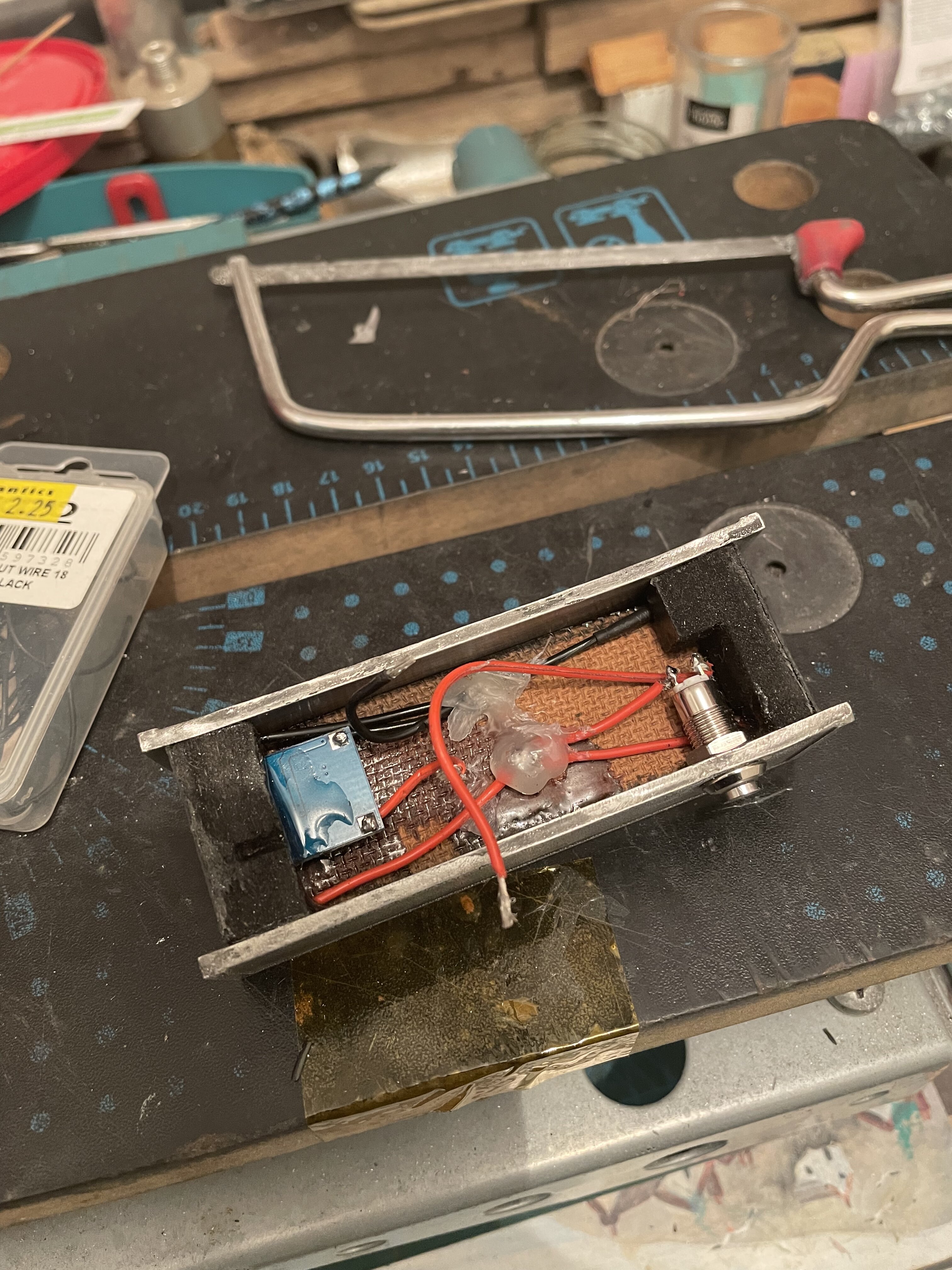

I drilled the 2 holes for the switch and led, there is just enough room for the battery.
Bit of hot glue and the buzzer sits on top.
Add the battery and screw the bottom back on, hopefully at this point your 3 screws are still where you left them and you’re not on your hand and knees hunting for it.
Quick test that the electronics work, twist the top on and it’s done. Not a bad rainy day project. Not accurate, but looks the part

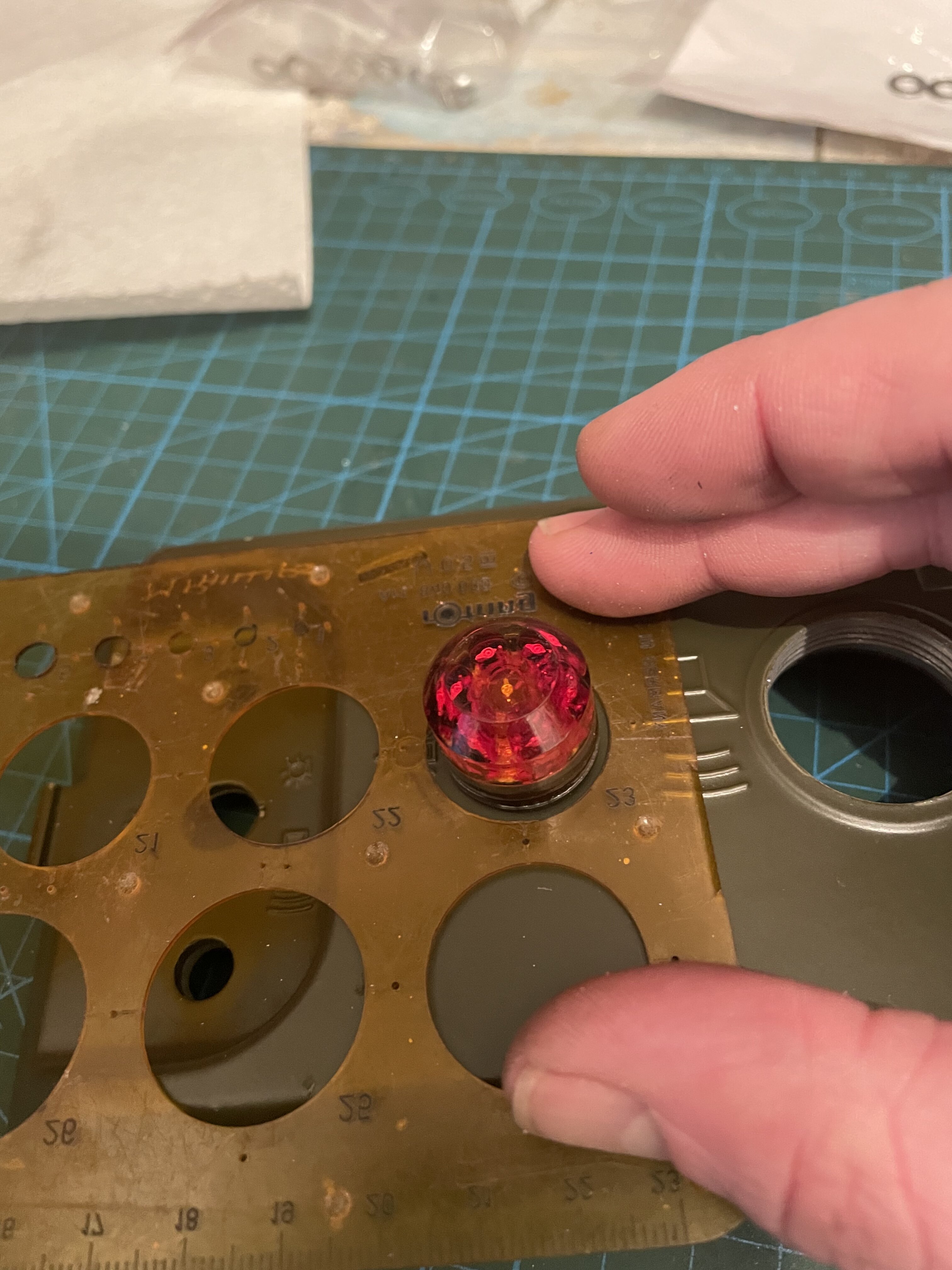

Next up Krate dragon detonator from E1:S2 of the mandalorian. This is what I’m aiming for:
I was able to find a Bund alarm and nkk switch. The rest of the greebles will be made from aluminium.

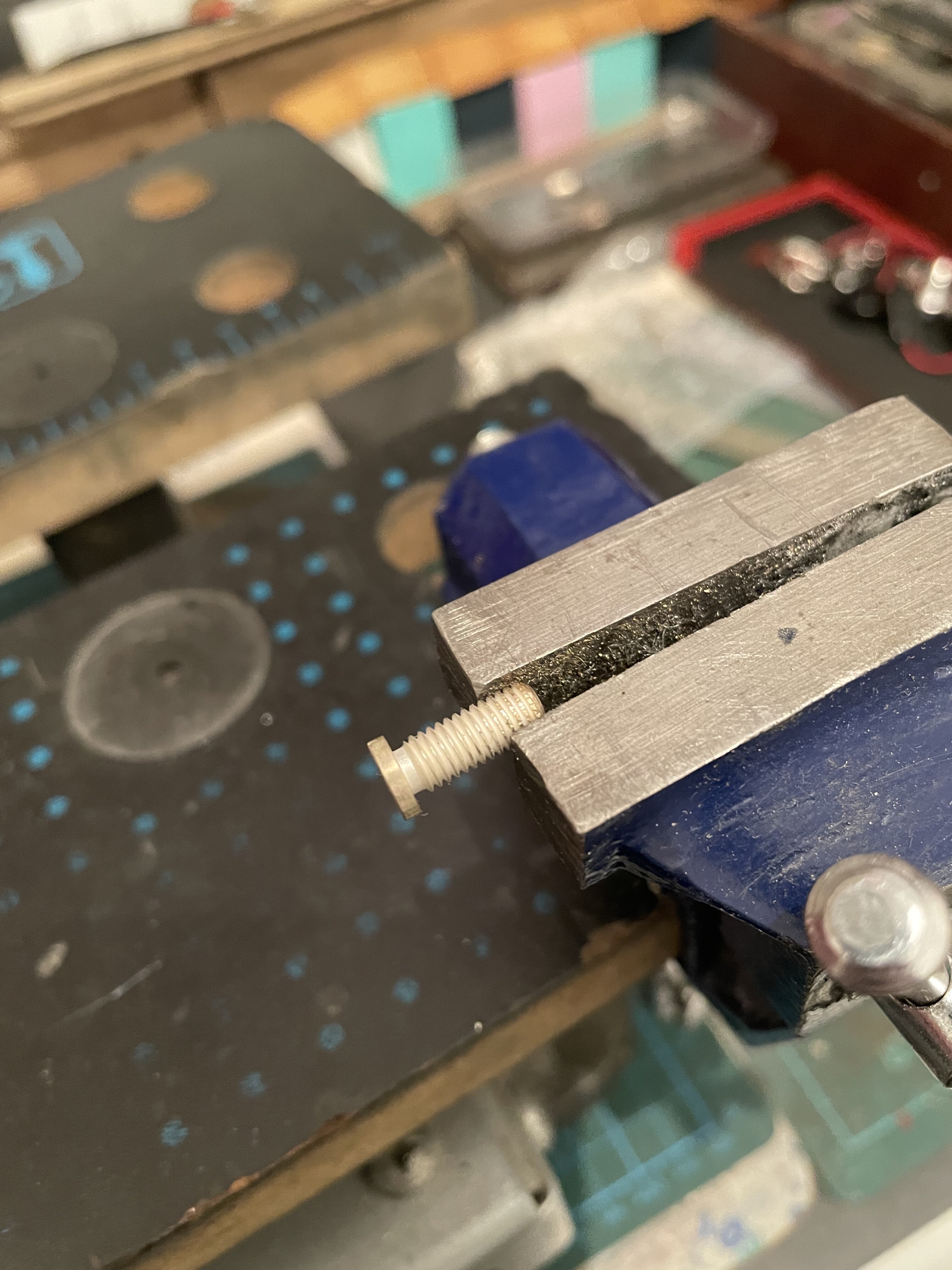

I’ve bent some 5mm aluminium and put a thread on the end for the stick protector as test, now I just need 2 the same/correct size

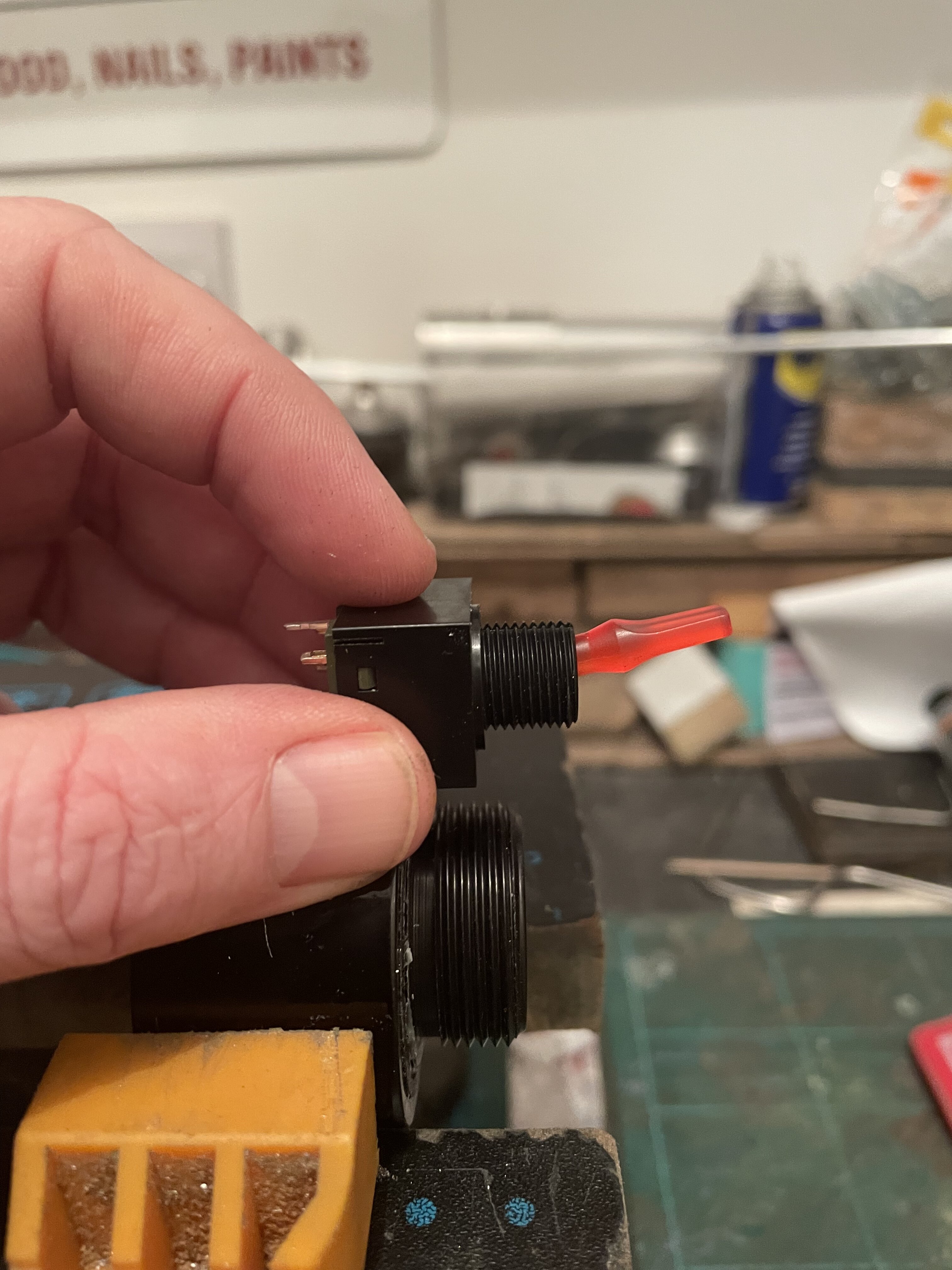

There isn’t enough space to fit the switch without modifying the buzzer housing, so I cut the thread in half, I was exited to test fit the switch.

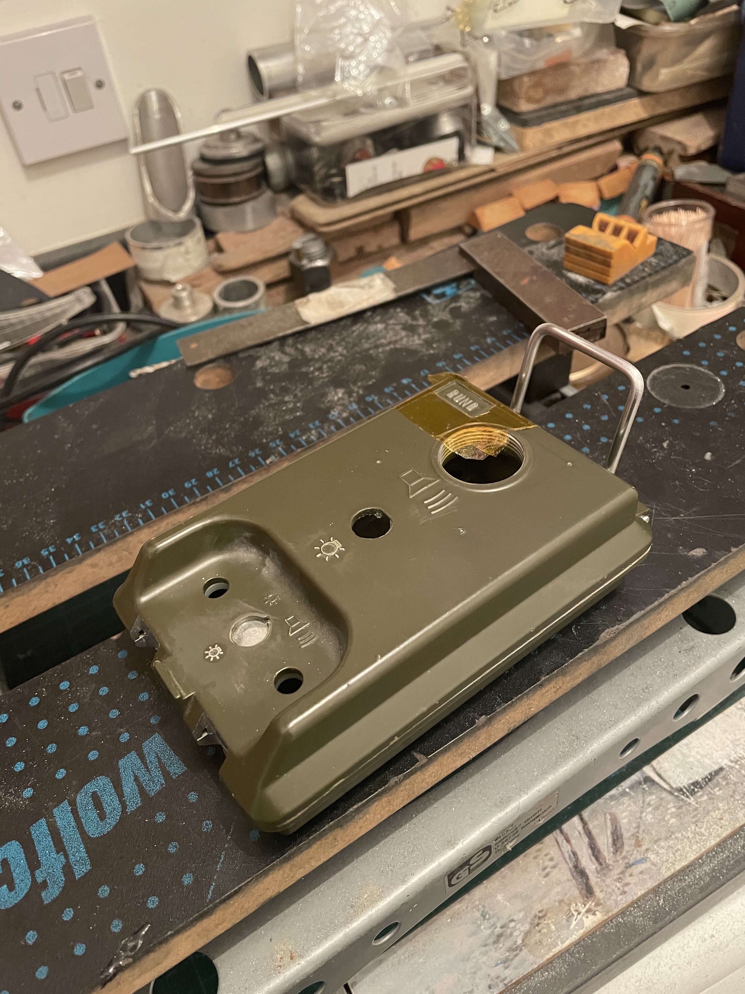

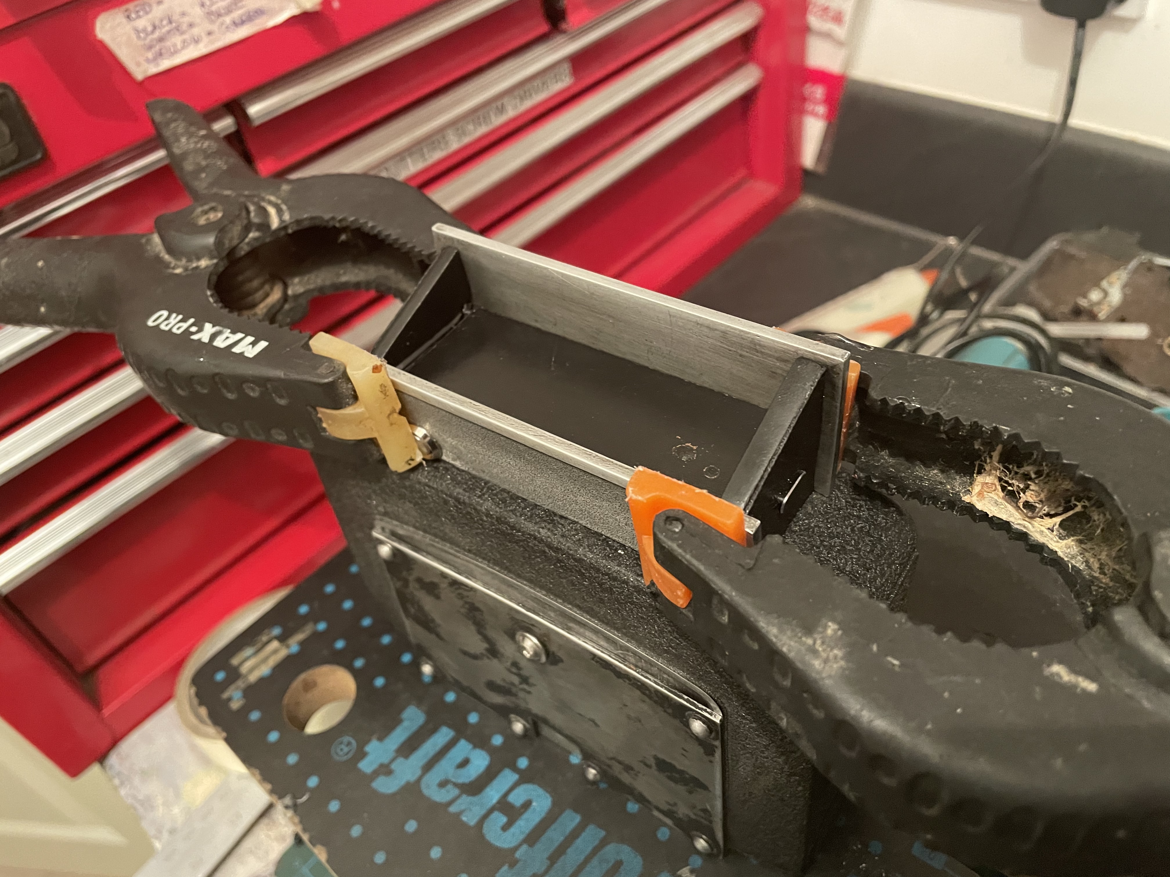

I got the side plates cut out and started cutting out the 2 notches below the post using a jnr hack saw and the files.
Added the hole to some 3mm aluminium glued it in, being careful not to glue the 2 halves of the alarm together at the same time. Then I filed it down flush.
but I’m calling it a day now, the 2nd notch will have to wait till tomorrow. Then I’ll work on the side rails.
Little progress update. 2nd notch filed and filled.
Blanked off the hole for the original switch from the inside ready to be filled with bondo.

Bent and threaded the switch protectors
