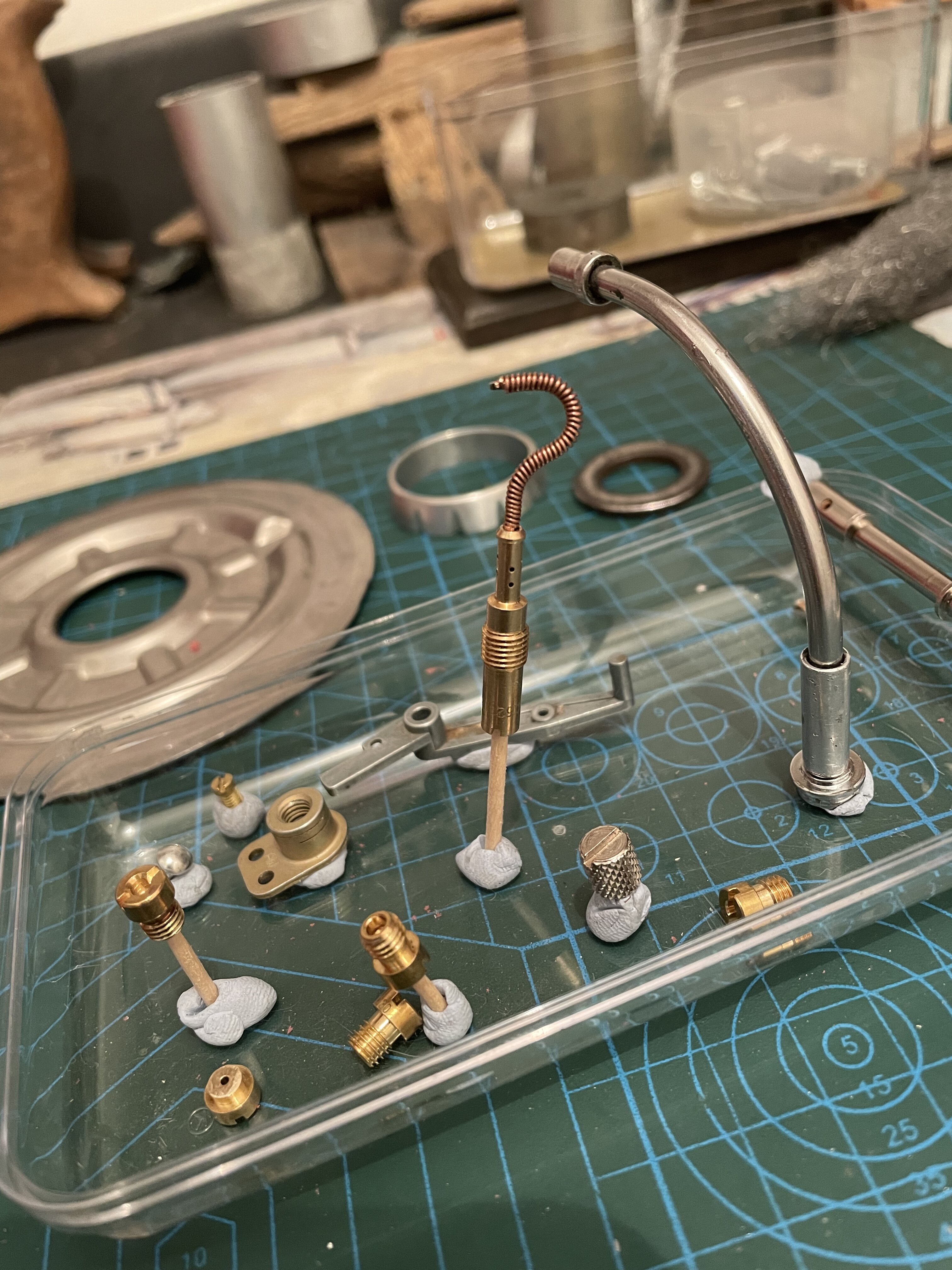

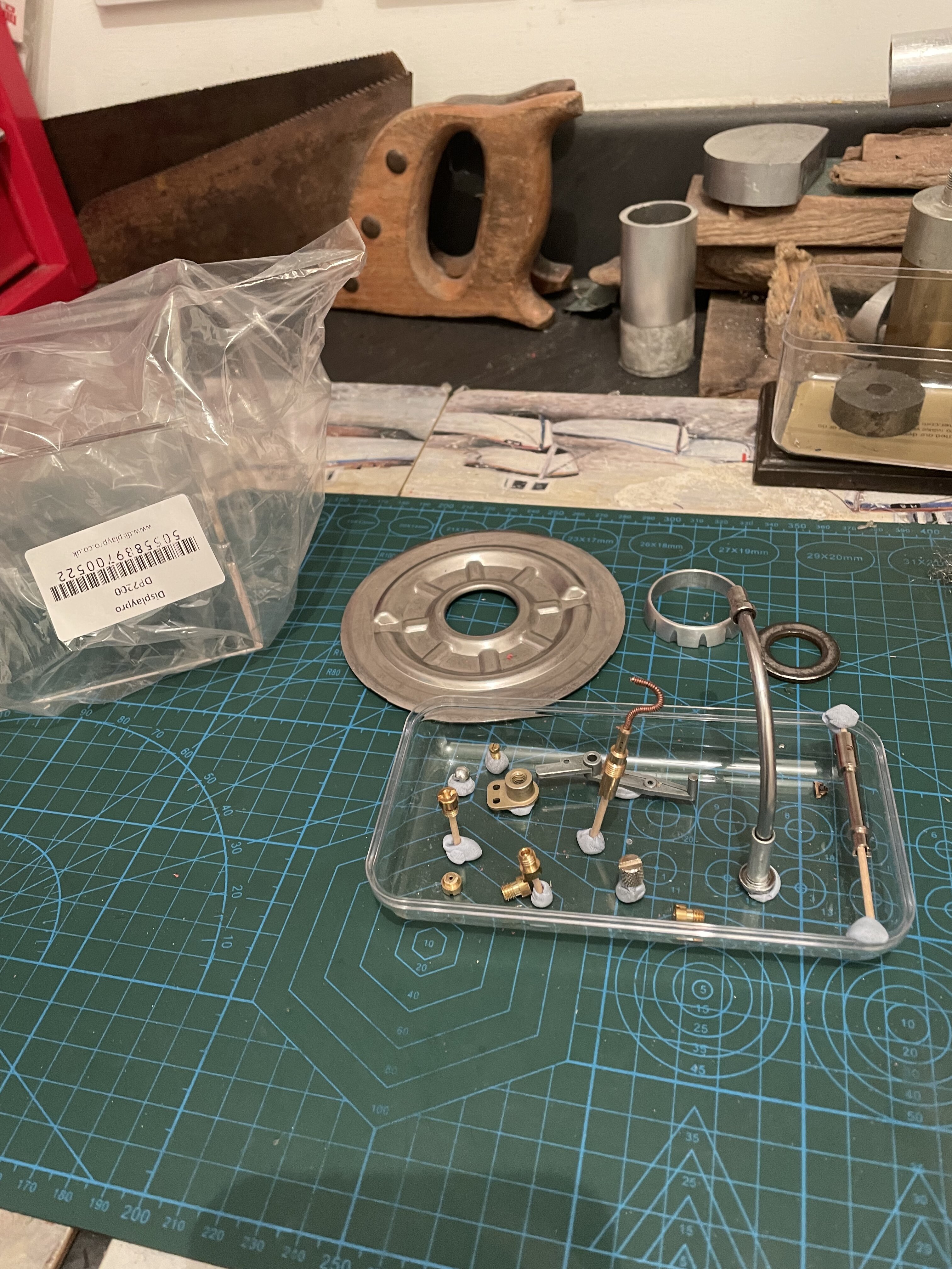

My display cube arrived in the mail today, I need to make a base for it. Here is the manifold plate I found by the side of the road, I’m assuming it’s off of a vehicle? It needs to be cut down a little to fit. I’ve picked out some greebles. There is a solder lug anchor, carburettor pin parts, a vape part, some sort of mechanical arm and what I think is the mouth piece from a head set?

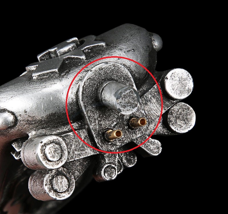

Nice! you have a good canditate here for a part of the Jedi comlink from the prequel trilogy:
Good eye, that is exactly what I’d bought them for. there is another used on the top.
they are also used on the visual dictionary version of the neuro-saav rangefinder that I’m building next! I had a pack of 10, so had some spare.
I think the part on the front of the communicator is also a mechanical arm, or part of steering rig from a kit, but I’ve never been able to identify it.

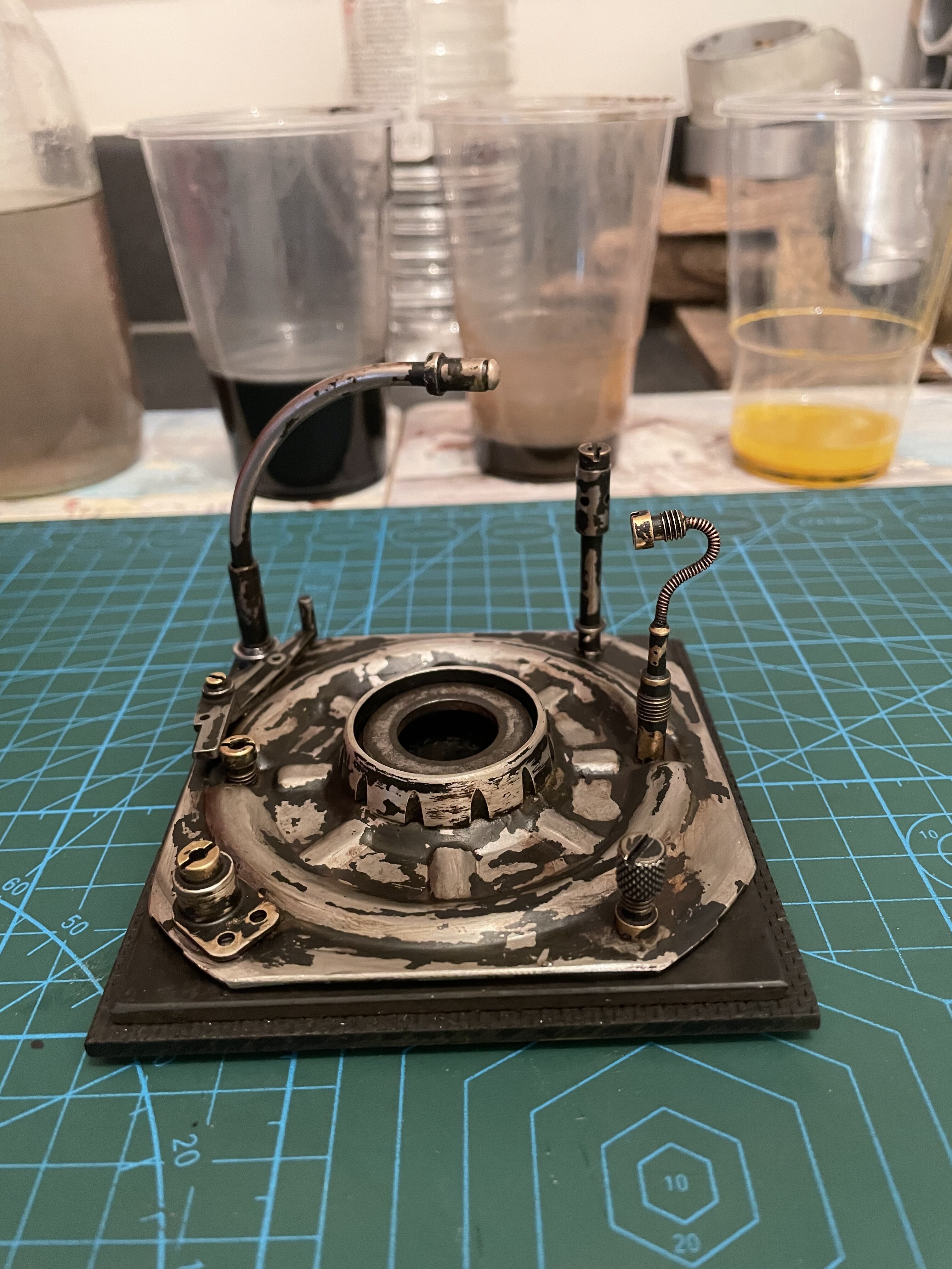

Display base is coming along, feels like it’s taking as long as the actual piece. The steel manifold took a surprising amount of time to cut. All greebles are pinned and glued together (not to the base yet. Just waiting for the glue to dry and the rain to stop so I can go outside and give everything a pre weathering coat of flat black
