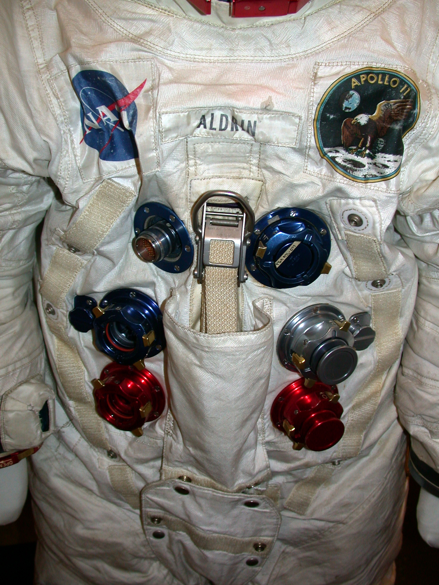

I was talking about color variations within the same suit. Take a look at the blue connectors on Aldrin's suit:
I've seen it myself in person on other A7L's in museums. The blue is often inconsistent within the same suit, but photos of the same suits on launch day appear uniform.
