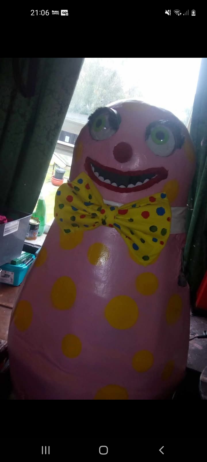

Well here is mine so far not 100% happy with it yet tho
Honestly, I’ve never dime anything like this before, it probably took me around 2 months with a few trial and errors, but I’m very committed to it now haha. I’m pretty good with photoshop etc so I worked it out with placing photos over other ones.
I ordered a 40cm wide polystyrene ball and used half for the top of his head and then attached some Eva foam to make it the right size. Then sealed the joins with wall filler and once dry I sprayed it all with plasti dip. Then eventually used pink plastikote spray to get it that colour
im confused as today i purchased the 40 cm polysstryne ball and io have sprayed it with plastidip today but it appears to have melted the ploystryine did you cover yours with something first?

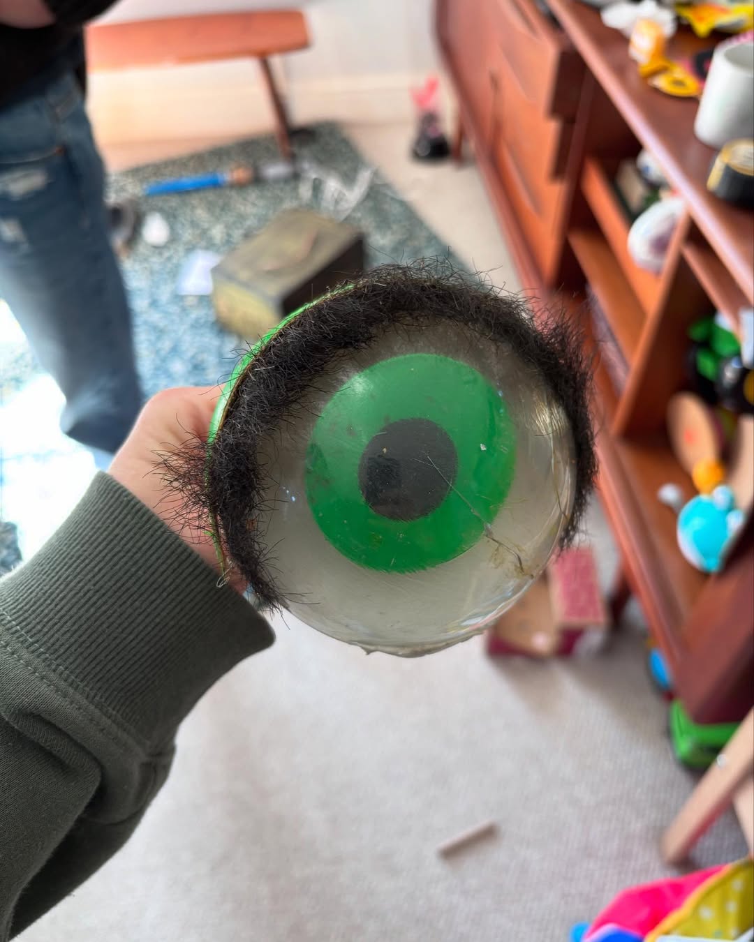

In terms of owners of suits I know the person who runs the MrBlobbyCollection page owns a theme park Blob. I tried contacting them but I got no response, I believe the person myblobby may have been contacting is Scott Harrington who actually owns 2 Blobby’s (lucky lol) I believe he runs this Instagram https://www.instagram.com/h.house.of.ho?igsh=MWpnNDYwNDh5emwxeQ== which I found by shear luck a few years ago. There’s actually some good blobby pictures on that profile. Also in my Instagram travels I found someone who has one of his eyes but I can’t remember the account name.
