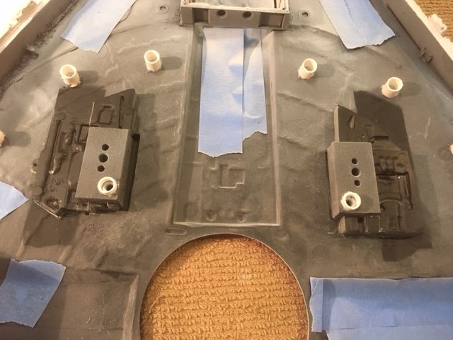

almost ready to primer shoot the lower, hull separation tube that I saw another guy doing. fattens up the center. he had made his 6.6cm tall, but that required cutting out and repositioning the "hall way" sections of the docking collars...a bit more work than I wanted to do. so I shortened mine up finally to 5.7cm, then pulled it all together with tape a rubber bands, then hit it with the wife's hair dryer in a circular motion top and bottom till the pieces bent down.
bottom shot is the added ESB landing gear which I feel makes the YT-1300 look more substantial. with only 3 ANH landing gear, it looks a bit fragile. IMO
I should have used a flash with the landing gear pic so the inner well greebs could be seen better, but all the hoses do go to something, junctions and feed blocks, etc. not screen accurate obviously as I was unable to find any pics anywhere...so I winged it. looks good enough for who it's for right...
I did also figure out the on all these I've done, I've installed the front center landing gear with the thin ram to the rear...wrong position, right. you'd think on the 5th one a guy would see that in the instructions...duh. but, I like the way it looks as I've done them and again...good enough for who it's for lower hull 1.JPGlower hull 2.JPGlanding gear frt ctr 1.JPGlanding gear frt ctr 2.JPGlanding gear rr 1.JPGlanding gear rr 2.JPGbtw, if you're wondering what the all the holes are on the left side of the lower hull that aren't landing light positions, those are for the recordable sound module I like to put in these.

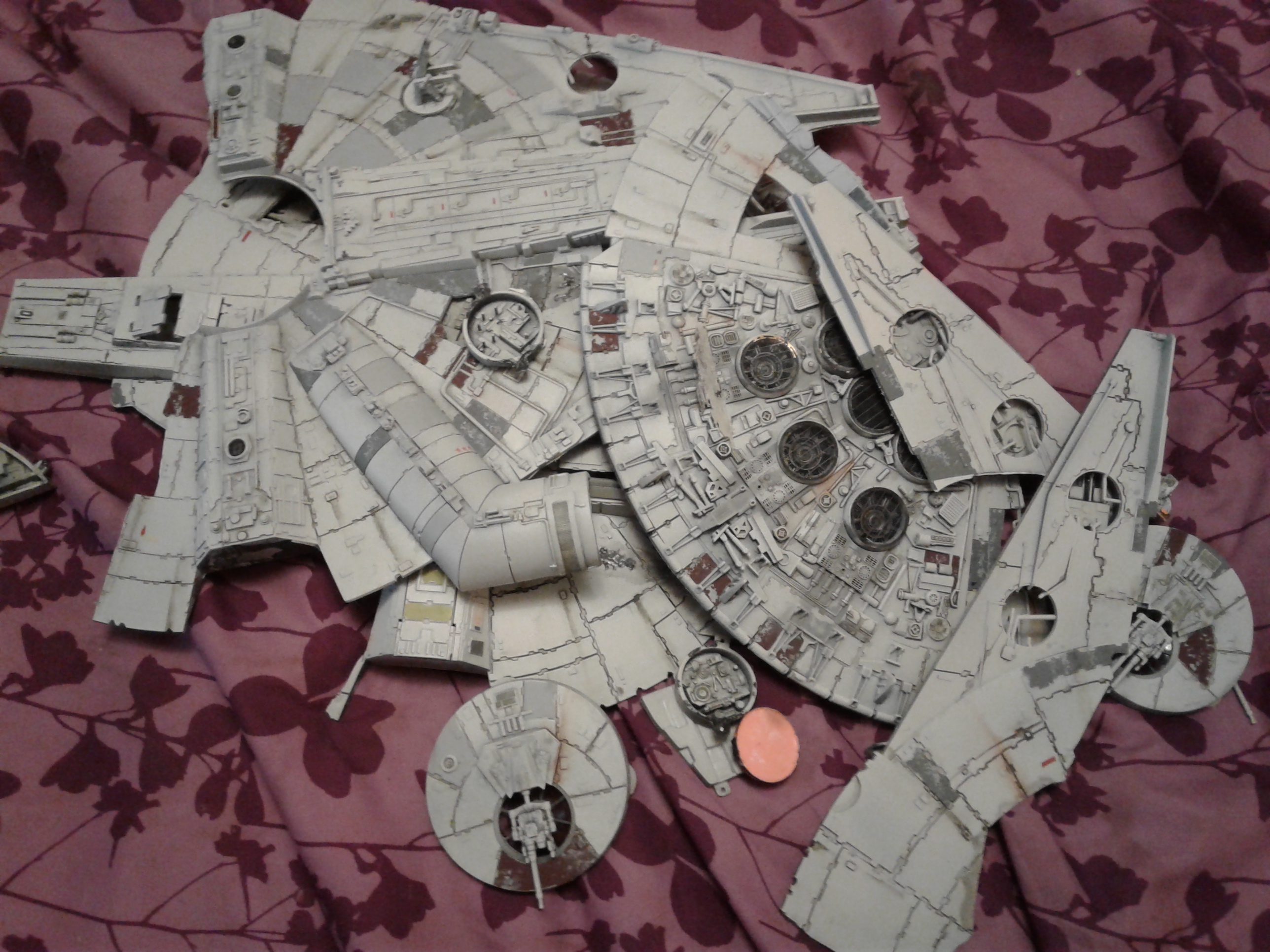

Well, I just don't know what to think, Everything was going well and I don't know what happened. I'm really embarrassed. I can't, in good conscience, Display or invite friends and family to view this finished model. It turned out horrible. I'm really ashamed at myself. I just don't know where I screwed up so badly. I fell that it is a lost cause. I'm scared to try and take it apart for fear that it will be very damaged in the process at this point. Well, I'l let the pictures speak for themselves. I warn you it will be hard to watch. Haystack, how does that refund policy work?.........005.jpg006.jpg007.jpg008.jpg011.jpg012.jpg010.jpg009.jpg
The result trying to take apart resin parts that have been cured with JB Weld Pastic-Bond.....and a little frustration......all I'm saying about it.

good lord, what happened there?

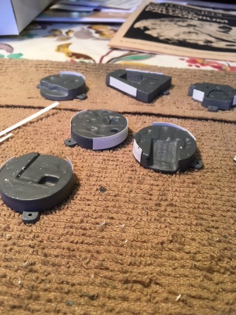

maint wells 1.JPGmaint wells 2.JPGmaint wells 3.JPGI hate when these go sideways...ugh...
anyway, what I've done with these in all my builds is I put these strings of 20 LED's up each side for the landing lights, landing gear well lights and the maint well lights. I drill holes in the side, the glue thin styrene sheet cuttings over the holes. the light from the LED hits the styrene and lights the hole, looking like work lights for the wells. the upper hull wells get the same, but I make the sheets pieces slightly higher so it picks up residual light from the bottom, thus illuminating the uppers as well. works pretty slick and no need to run fiber optics or LED to the upper hull half. this also work for the ones in the rear upper as well as the mandibles.

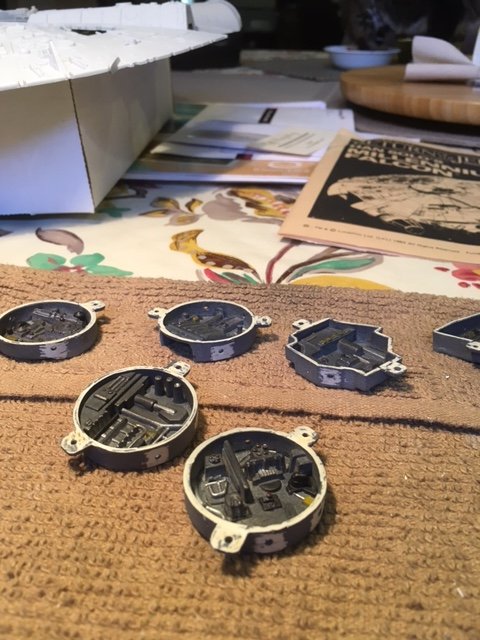

I also took another run at the salt method of paint chipping, this time with an air brush. 10 times better results, and this time I took the large grain salt and took a crusher to it some, better variety of sizes. bottom line, you can't do this with a rattle can.paint chipping.JPG also finished the maint wells and added some pipingmaint wells.JPG

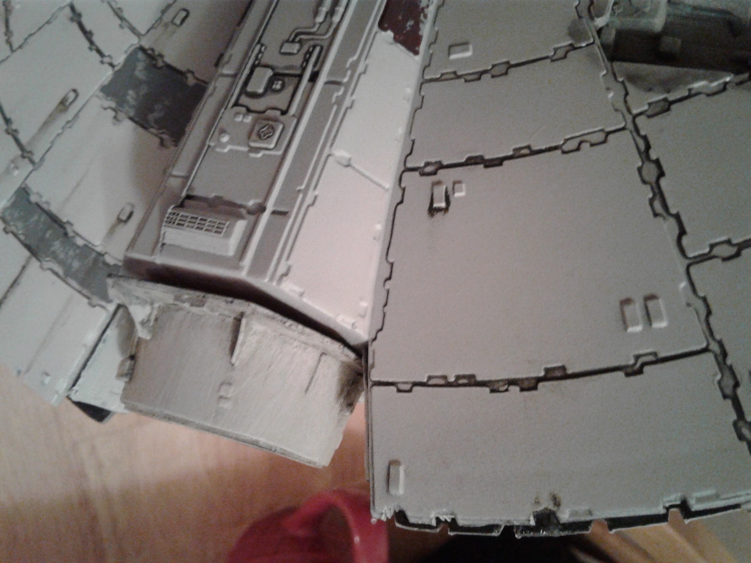

Buckey, I did a test fit with one of those, the starship modeler pieces, right? it seems as if it was just a tad too tall with HH sidewalls. nothing that can't be overcome. I've not done a second attempt test fit yet, provided I had it positioned correctly the first time. However, I figured at worst I'd have to lightly "trench" the top and bottom hull pieces where that grille is supposed to sit, just enough for it to sandwich in enough for the contact between the upper hull and the top of the rear quarter walls. the gap I found was small, but enough that it needs to be addressed because I don't see a way to shorten up the grille without major and delicate surgery to it.

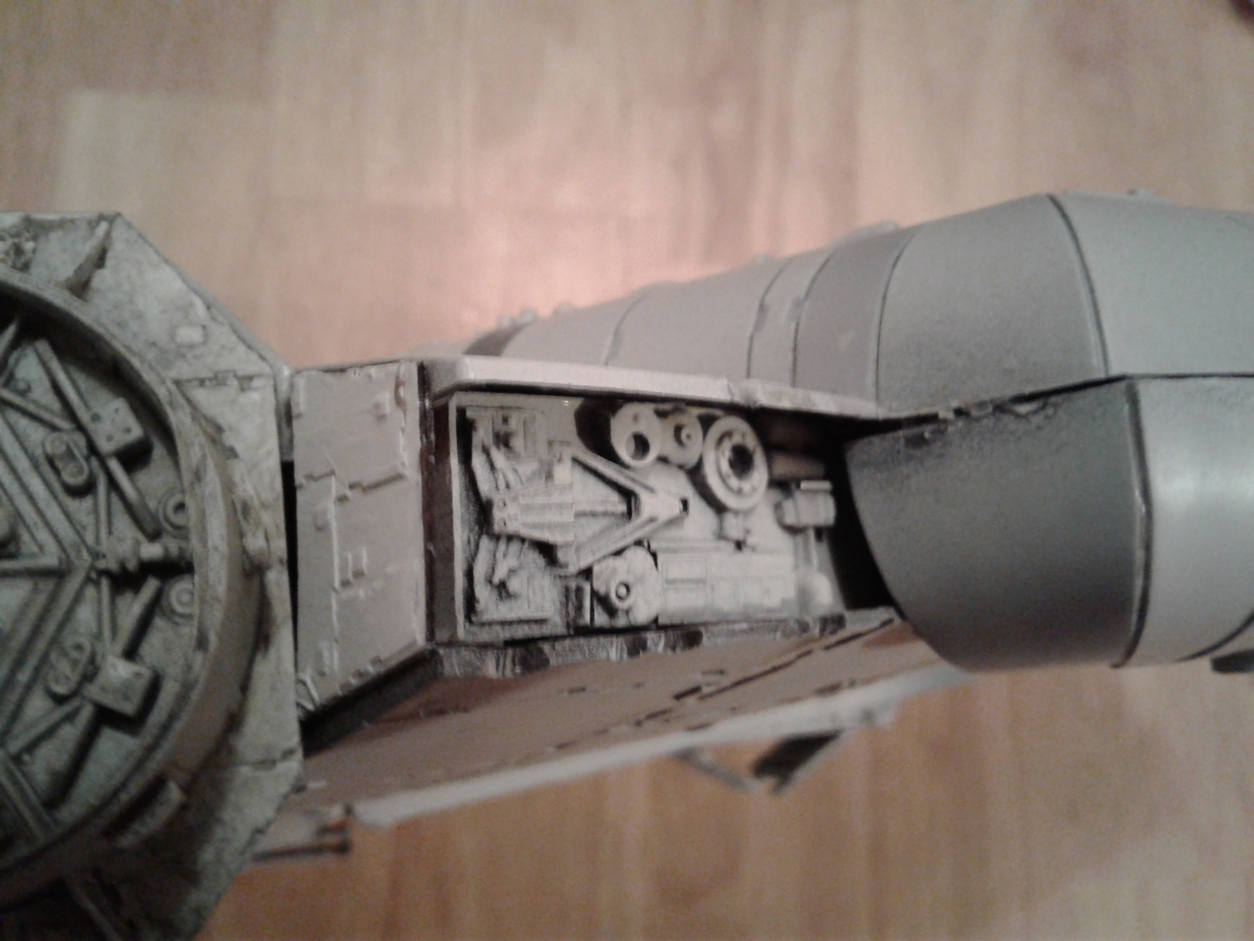

Also, I'm gonna attempt to use this for the Aft/Back engine exhaust grill, it's the reduced height egg crate kit from Star ship modeler. Can't remember the exact dimensions. Do you happen to know anything about their parts in relation to the HH miniature parts?
Well, I've officially abandoned this build, but as far as the small gap goes, I just, well, lived with it. That was the last thing I did before running into total frustration. But it sounds like you build is going fantastic. Keep up the great work.
