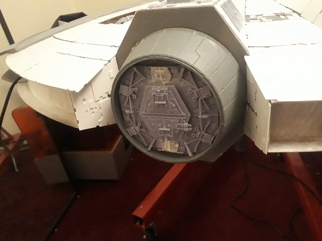

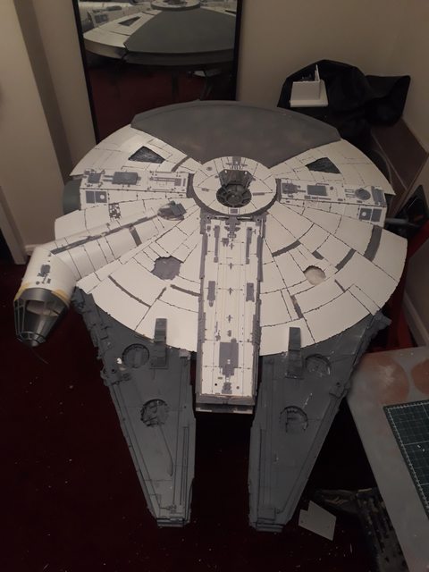

Thanks. So, another update. more progress on the hands-on stuff;
Got The Mandibles on! And both sub-assemblies and damage hole fitted
View attachment 1087652 View attachment 1087653
All the plating topside is done except around the Upper Deck. Still got all the chips to do though
Also got both Docking rings nearly finished but not fitted all the greeblies/plating around the outside
Are the mandibles just glued on or do they key in to the armature? And how do you reinforce the sauce halves without internal ribs?
The saucer is 3d printed with infill support at around 20% so plenty strong enough. The mandibles are fixed with steel dowels and epoxied on
