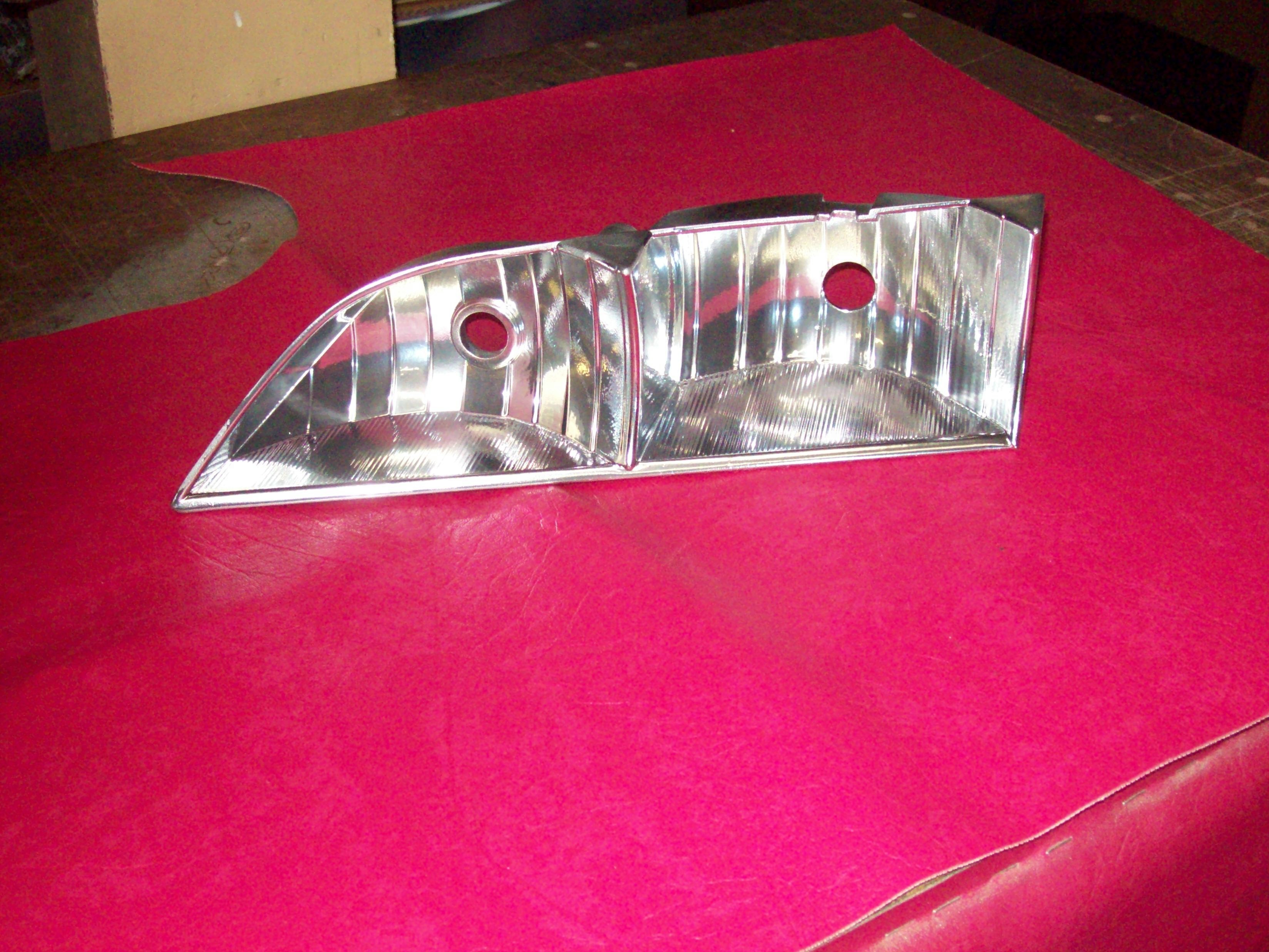

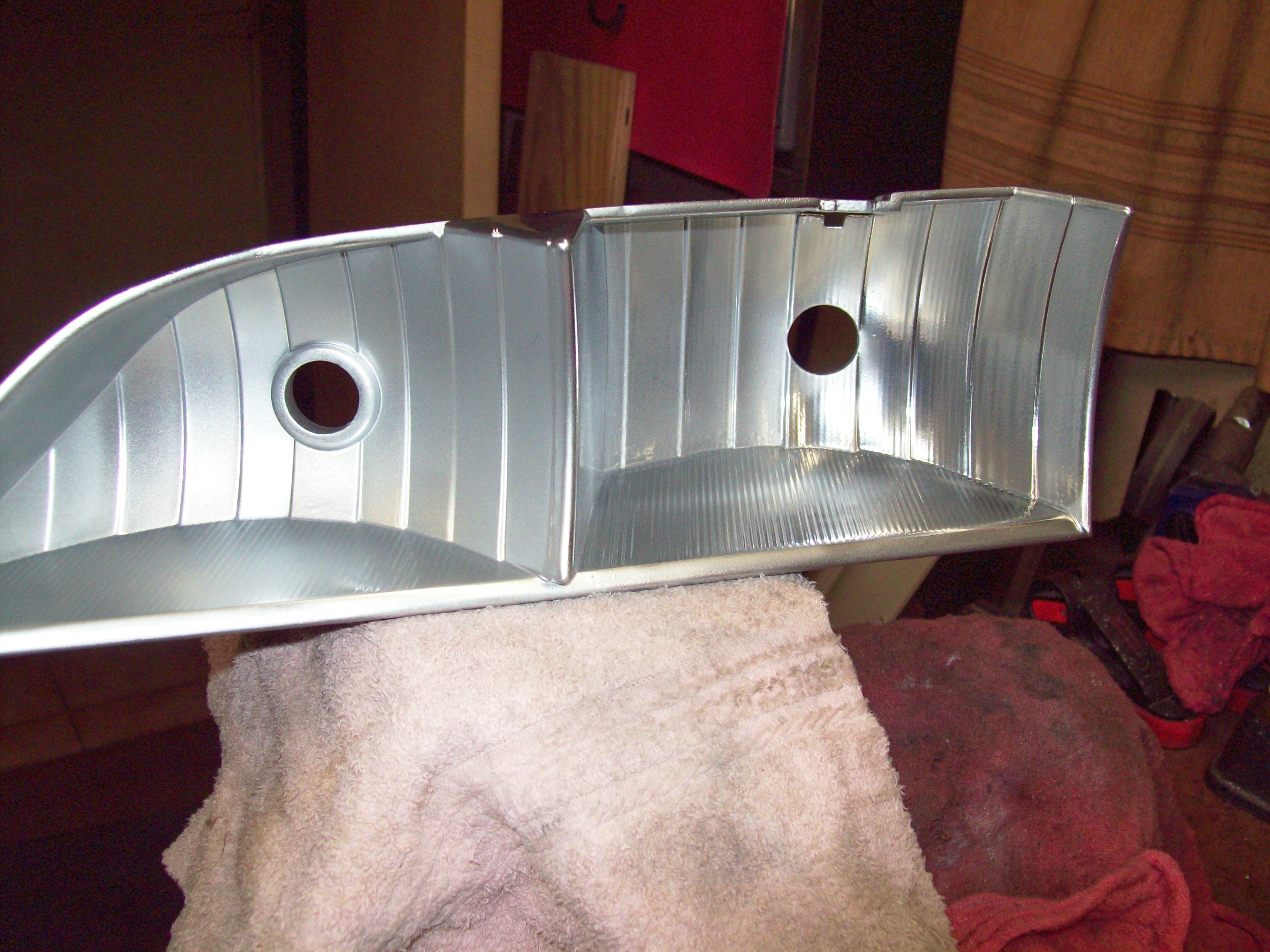

Hi all, new guy here. Molotow Liquid Chrome is fantastic.I was trying to find out how much heat it will take. I rebuild headlights, and for over 4 years couldn't find any chrome spray that I could do. I tried it in my masters G-44 air brush, and it wont put out enough paint. Art primo painted some train cars using a cheap Harbor Freight air brush. I bought one, and it worked great. You have to put enough on to keep it shiney, any dull parts, will stay dull. Pic of before and after, and I didn't even wipe the test piece off.
