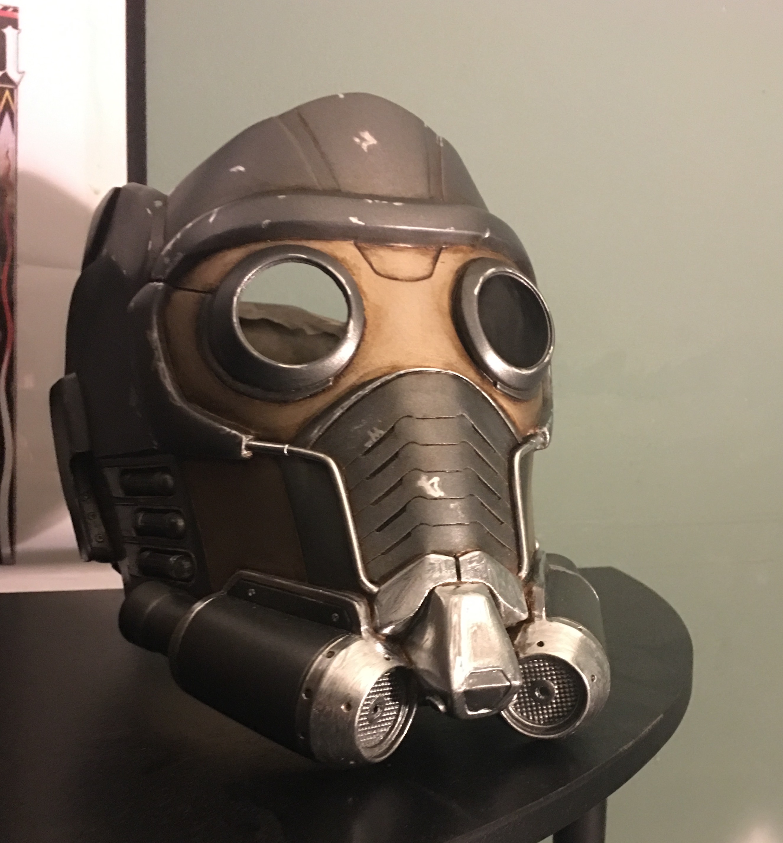

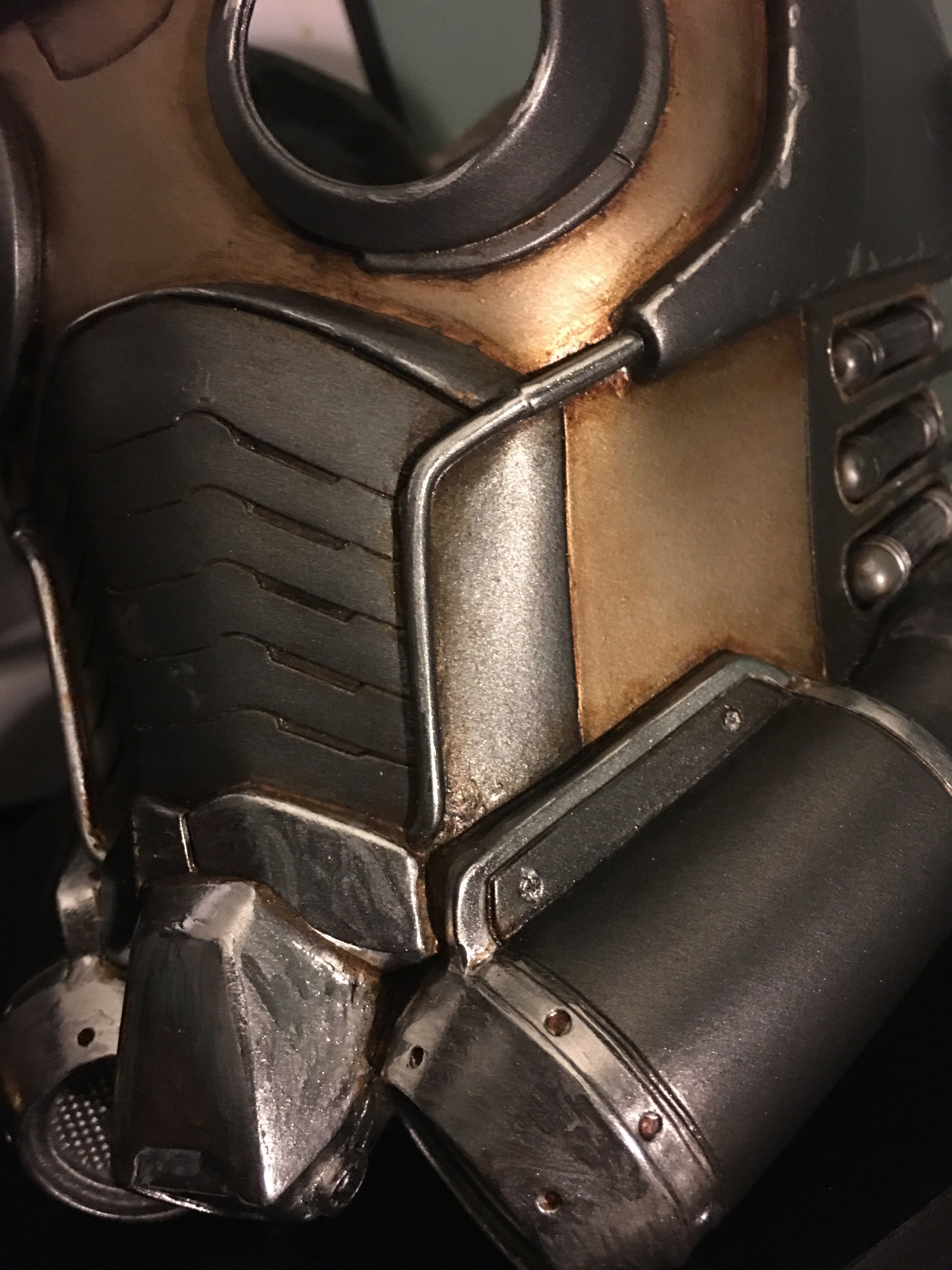

    So I picked them up and decided to try them out on a Star-Lord I am painting. On larger areas, close up the "brush strokes" of the marker are pretty clearly visible. I almost wonder if opening the marker and transferring the ink to a wider chiseled tip marker would be better? I was using the biggest one they sell, the 4 MM.
    For small details that you can get in one stroke, such as the tubes here and weathering? It is absolutely amazing.
    It won't replace Alumaluster for chrome on larger areas but specifically for battle damaging? It's PERFECT. Even though the strokes are visible close up, from a distance the chrome look is actually quite amazing.
    I'll have better HD photos soon when my camera is charged up.
