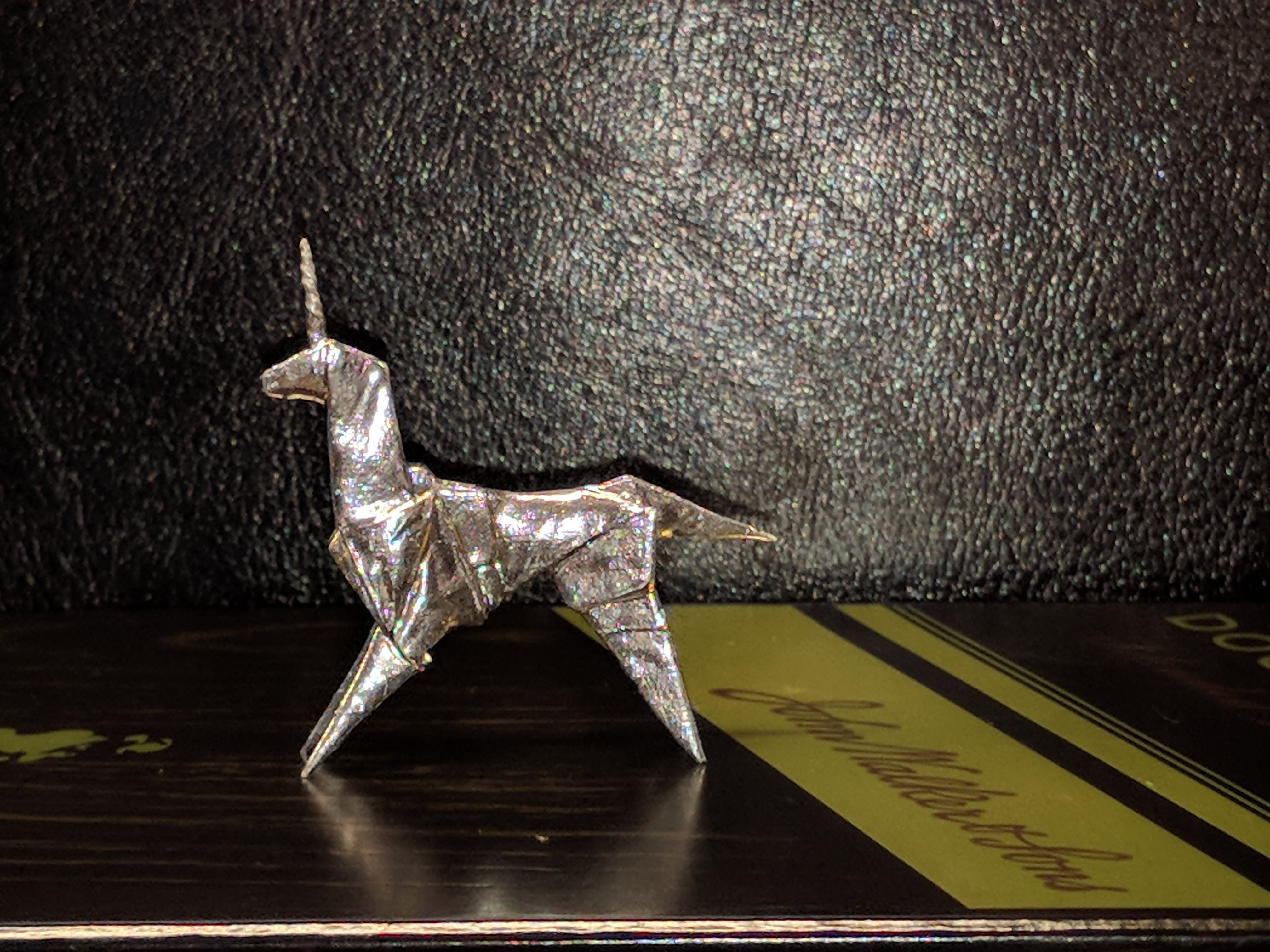

Thanks to this thread, I bought a Molotow pen and a refill. It worked great on a 3D printed Blade Runner unicorn. You'd think it was really folded tinfoil. IMG_20180220_153755.jpg
Thanks to this thread, I bought a Molotow pen and a refill. It worked great on a 3D printed Blade Runner unicorn. You'd think it was really folded tinfoil.View attachment 800574
Bit off topic, but given that Gaff was always using found objects for his origami, my thinking is the unicorn isn't tinfoil, its the foil paper wrapper from a pack of cigarettes. When Deckard holds it up, it looks like the inside of the legs is white, though that could be a trick of the light.
Actually, it is most likely actual silver origami paper. Origami paper is only silver on one side, so the legs are the reverse, non-silver, side of the paper due to the folding.
The foil paper on a pack of smokes is the same way, white on one side, silver on the other. I suspect that what they did in making the prop was to use silver origami paper, but narrative wise, it'd make more sense that it was from a pack of smokes, since every other origami he made was from what was handy at the moment.
I think you're right, but I thought it looked better all silver.
