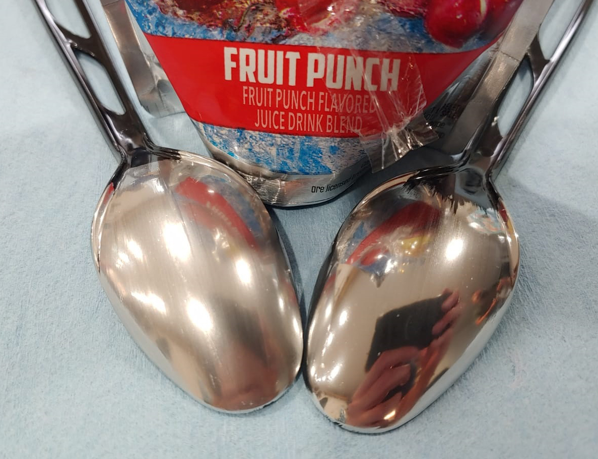

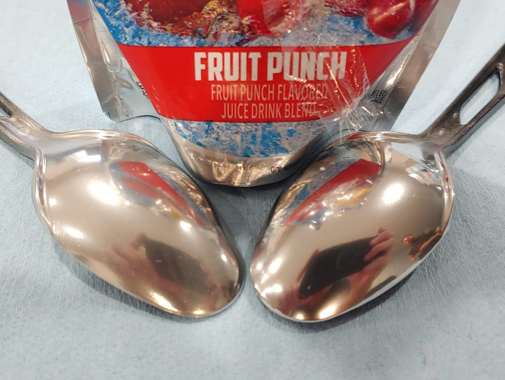

My MIRROR "mirroriest chrome paint" arrived, and I've done some tests. I'll try to get pics tomorrow when it's dry, but so far Molotow seems to be the clear winner. Definitely more mirror like. Perhaps the new stuff will hold up better? I'll do some touch tests as well.
Ok, a couple pics. In both the new stuff is on the left. One is painted (with painted Molotow on the right) and one is airbrushed (again, Molotow on the right).
Molotow definitely looks better, but the new stuff still looks good. If it happened to be more durable to touch or could take a clearcoat any better, those would be strong reasons to use it. Thanks for testing!
It's pretty much the same as Molotow for durability.

When you say "painted Molotow", you mean you're just using a Molotow refill and...a regular paintbrush? From your photos, it looks shockingly smooth for a non-airbrush paint job!
Yeah, dripped paint out of the refill bottle and spread it everywhere with a paintbrush.
