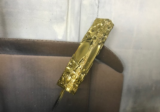

For those of you that want to use Molotow for gold shades, here's a current project- Gamora's switchblade double-dagger from Avengers: Infinity War.
There aren't really any good mirror pale brass sprays out there, so I used Molotow and hit it with some Alclad Gold Candy. (Waited about an hour to apply after the chrome.) Then a couple hours later I hit it with a 2-part urethane-based clear automotive lacquer.
I also did a test with Tamiya Yellow Clear and Orange Clear (about a 5-2 ratio) instead of the Alclad and that looked OK too, but ever-so-slightly more saturated, and it killed the mirror finish just a tad.

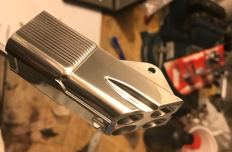

Here's a photo of something I painted yesterday. Molotow Chrome with 2-part auto lacquer on top:
The stuff is so reflective that it creates lens flares and blinds you when you work with it!

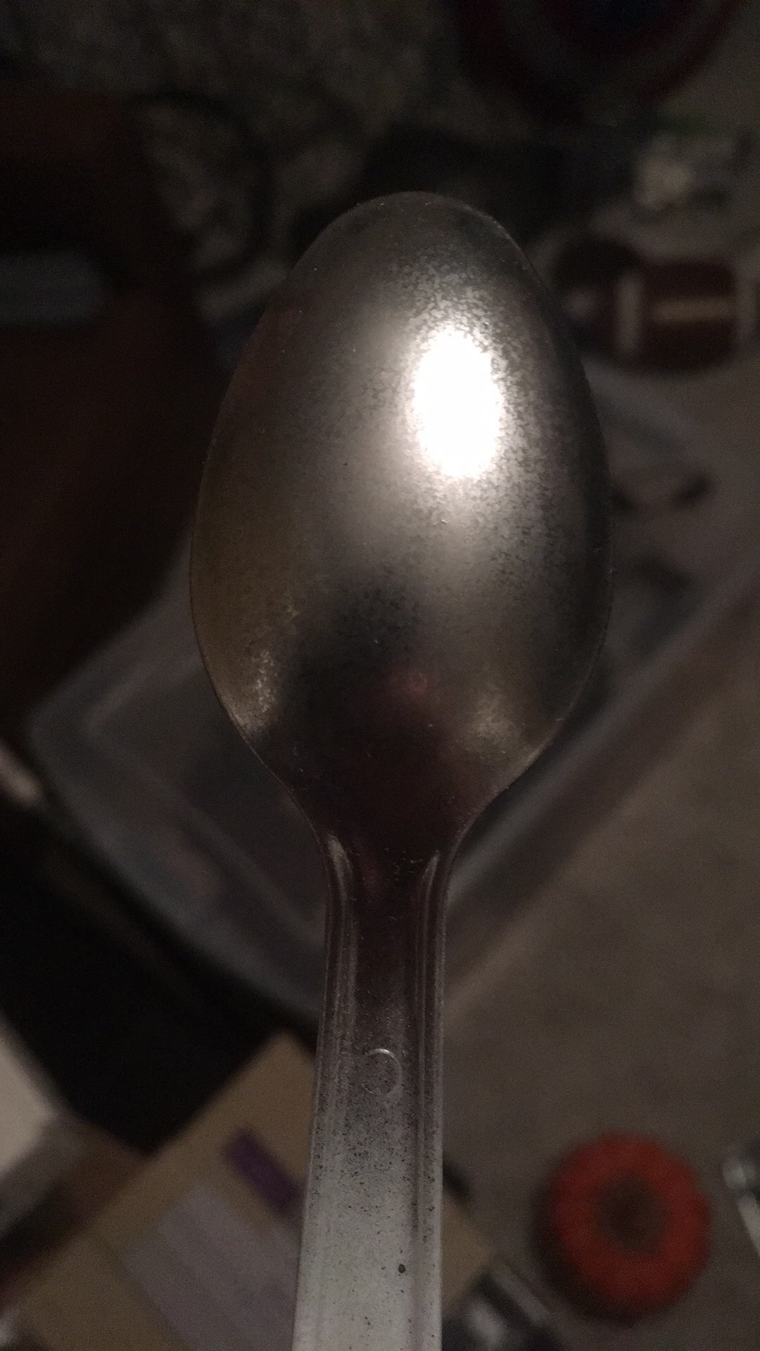

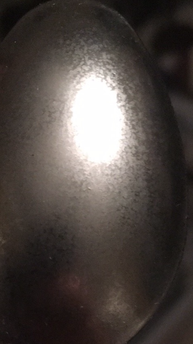

Well, I tried the Spaz Stix clear coat. It had some weird crackling effect on the silver. See the images below with one pre-clearcoat. Didn’t dull it much, but definitely did something else altogether. Going to retry it again tonight. Strangely enough one of the bottles recommends 2K clear
