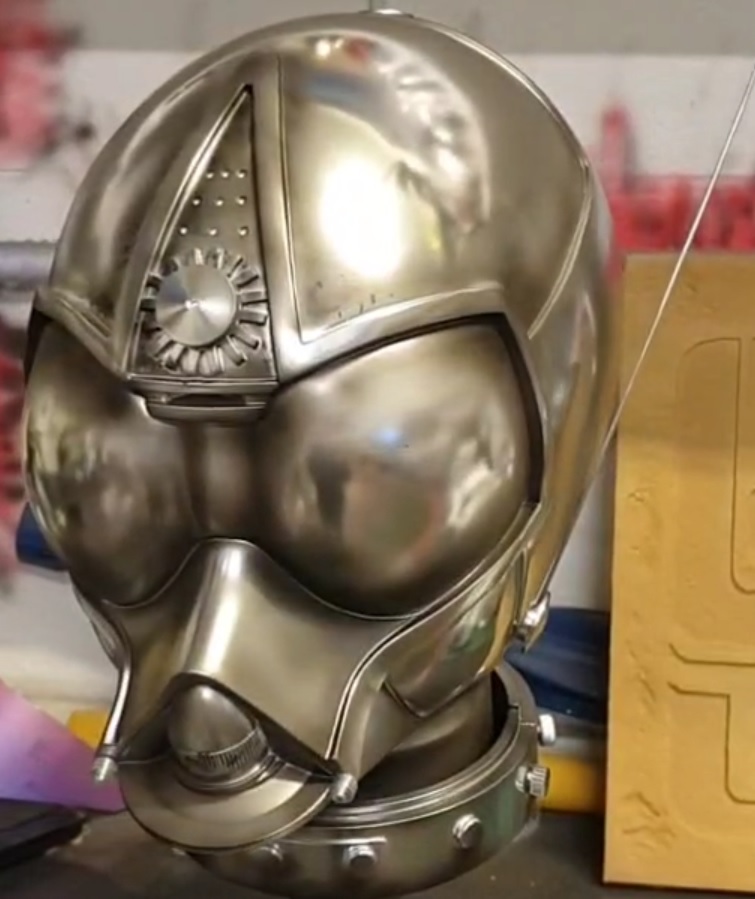

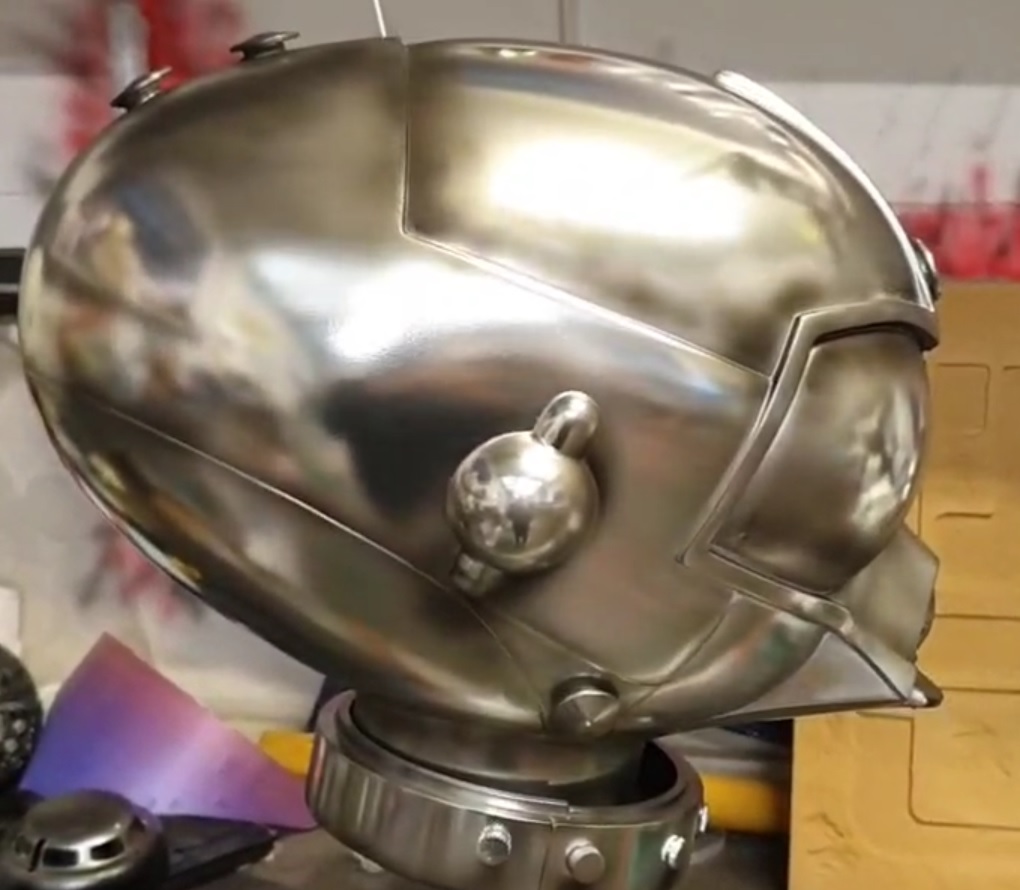

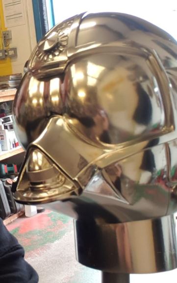

a fellow board member (fimmo) had success with one of my RA-7 heads, this is the largest object i've seen done with molotow,
the trick i hear is not using an airbrush for larger objects. he used a HVLP spray gun and i believe the head took only one refill to do.
for the cost i would be very happy with this finish, i believe working fast is also must. .. ... .. .. all images used with permission.
before weathering
i don't think so, i've been trying to get him to try that alclad klear kote stuff, the stuff i've tried it on it hasn't really dulled it in my opinion and certainly gives you more confidence in handling it.
