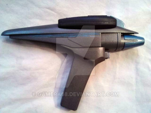

Here is my Diamond Select 'Star Trek III: The Search for Spock' Movie Phaser.
It was primed and repainted by myself. The P1 was repainted flat black. (3 coats)
The main body (Phaser 2) was painted dark metallic copper. (3 coats)
The beam emitter, curved top plate, and trim was painted a custom, dark, metallic blue.
(Testor's gloss medium dark blue, flat black, and bright silver; about 3 drops of each color, mixed thoroughly and applied by hand w/ a small brush)
I need to repaint the pinstripes on each side though...
Re: WIP: Modifying an AA Star Trek: III Phaser
That metallic copper color looks great! I wouldn't have expected that.
I'm not in love with the blue on the emitter or top, but that is one of the great things about having this toy available- you can customize as you like.
Nice work!
