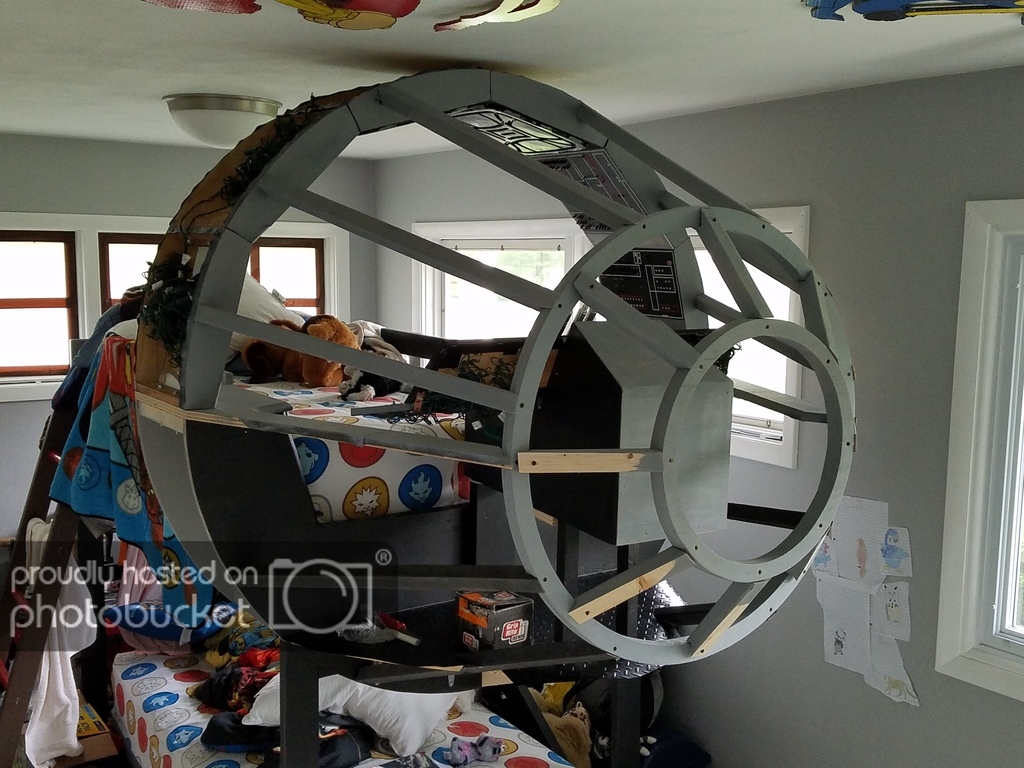

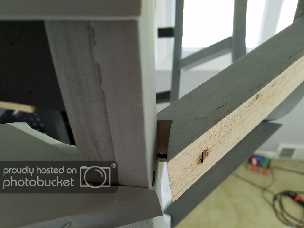

I did (unsurprisingly) little this weekend. It’s a busy time of the year! I installed the front window ring and struts. At some point between cutting out the struts and installing them, I had the brilliant idea to shave down the leading edge to accommodate the ¼” skin. That would have worked beautifully had I not cut down the trailing edge. :facepalm
I also tend to forget that this is real life and not a blueprint scribbled on a napkin. The struts should have been cut individually to account for warping and abnormalities (screw ups I’ve made). I cut them all relatively the same and ended up with this…
At the end of the day though, she’s closer to being finished. We’re on the home stretch!
