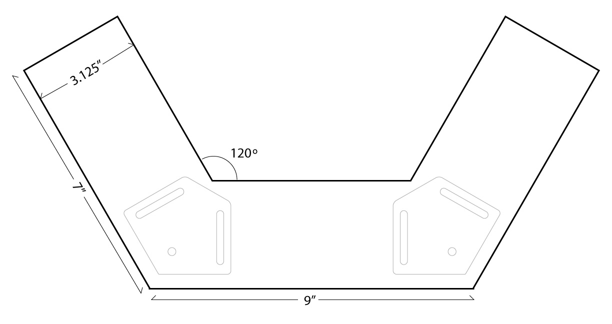

Painting the blue as I type ... well, kinda. Attached are some schematics to help with building the bracket assembly on the back. The small clip image is to scale. The larger piece is also to scale but also has dimensions to help if you can't print it full size.

that looks absolutely amazing Valor, i love it. also thank you very much for posting the schemaics for the brackets, that was very awesome of you. if/when i decide to do a bracket on the back more movie version style, would you mind if i use those schematics?

You're welcome. That's why I shared the files. Go for it:)
Thank you very much, i can't wait to see the leather! also the tape you're using says it has a max load of 5lbs, is that about the weight of the sled?
