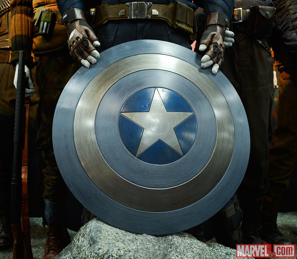

Very, very cool! I have definitely been inspired to give this a shot! I have two questions for the braintrust that's been watching this thread:
- Do you have any paint suggestions for the light blue rings on Cap's stealth shield featured at the start of Captain America: The Winter Soldier?

The paint on the winter soldier shield makes me think of the same blue for the middle and then using the same blue on the stripes but maybe sanding it back to reveal more of the metal underneath.
