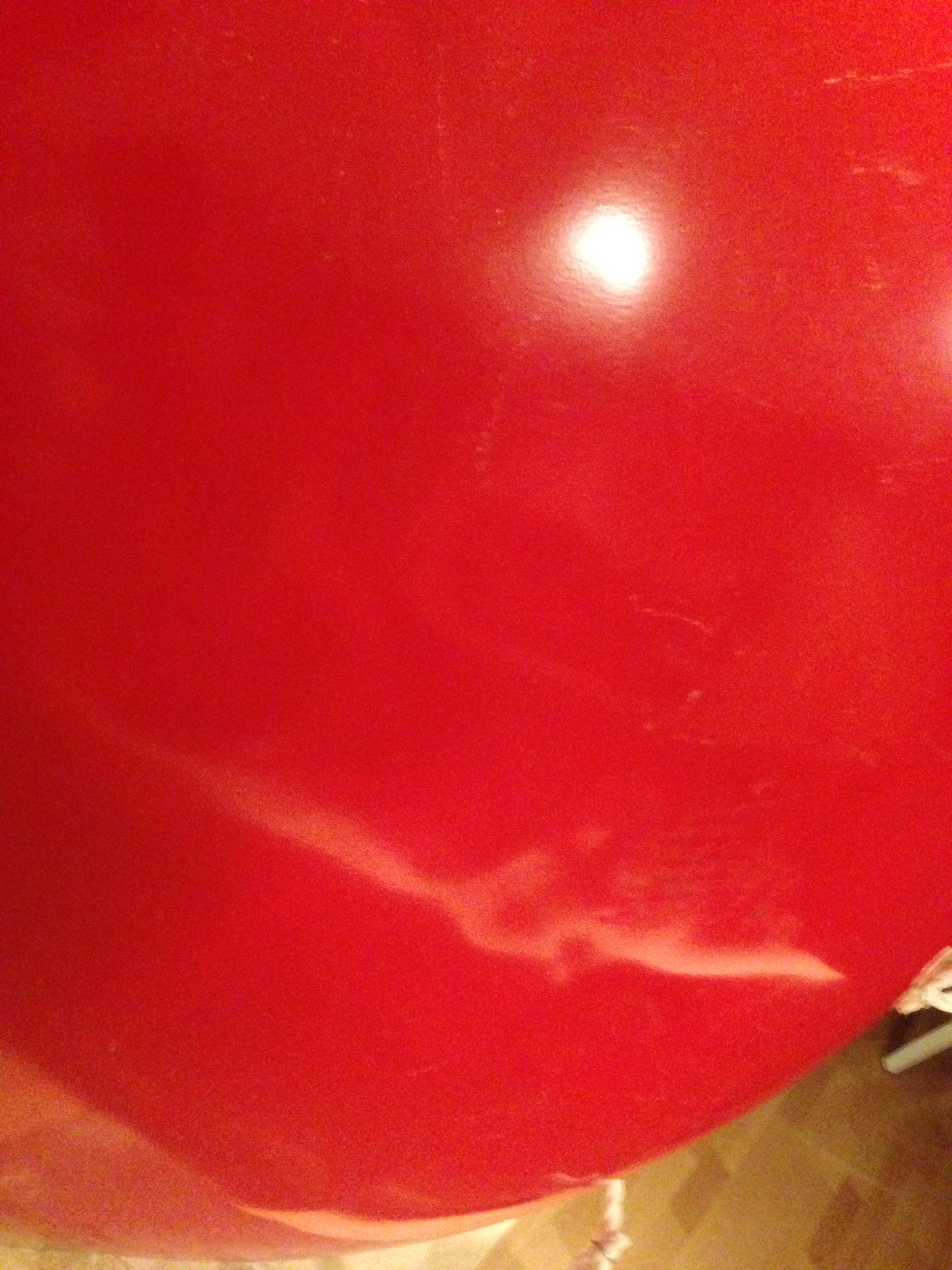

I ordered a sled off ebay, but it's not perfectly round and it has a few dents in it. It was supposed to be brand new, but I haven't had any luck finding this sled anywhere else for a reasonable price and don't know if I can get one in better condition. I've attached a few photos so that you can see.
Does anyone have any recommendations on how to handle these dents (i.e., how to get rid of them)? Or do you think I should try to return the sled and start with a new one? This is my first attempt at anything like this, so advice would very much be appreciated.
Kirks,
Use a sand bag (or just a bag filled with sand) and a nylon tipped mallet to get dings out. Anyone with a planishing hammer or English wheel can smooth it out as well.
Have fuN!
JPH
Thanks, JPH. I ended up ordering a shield blank, but I still have the sled. I'm thinking I may make it into a comic book version if the shield rather
than movie, so your advice will be useful. I'll have to give it a try.
