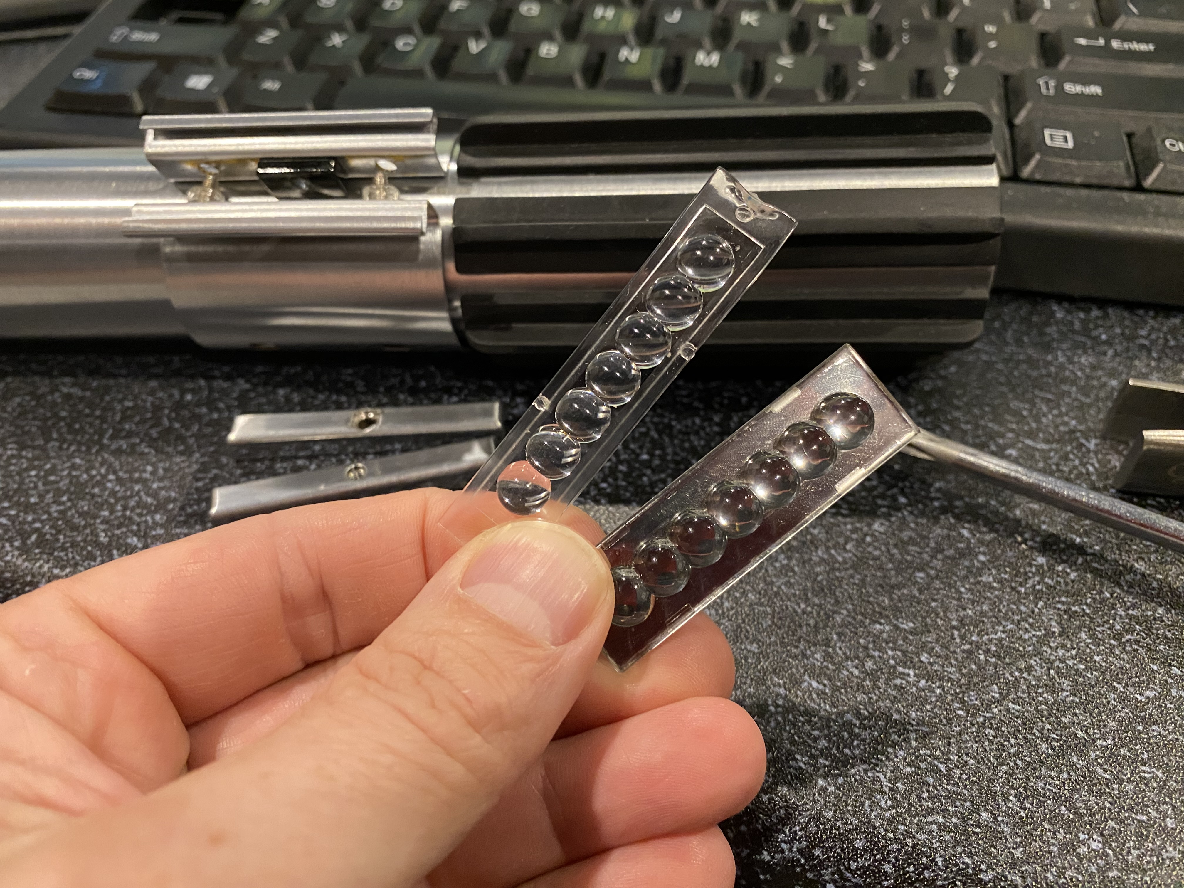

Master Replicas Obi Wan As First Built. Limited to only 500. One of the Crown Jewels of the line and very expensive. Average price 3000 and up.
Mine has an imperfection in the bubble strip. Crack or scratch. Original owner treated it like a baby. No impact and no idea how it happened.
I would like to explore the possibility of replacing the bubble strip. For those who know it’s locked in very tight into the metal control box mount.
It needs to be a perfect and invisible repair and the bubble strip needs to be identical to what Master Replicas used.
Remember you are operating on a true heirloom and essentially irreplaceable.
I’ve attached a close up of the issue.

To open the clamp you first have to remove the pin that holds the lever to the clamp bolt. Once the pin is out and the lever is removed from the bolt the lever side sidebar can be removed and the bolt unscrewed. Under the removed sidebar you’ll also see 2 screws on either side of the bolt that hold the clamp together that are hidden under the sidebar. Once the lever, bolt, and screws are all removed the clamp will be loose enough to remove/replace the bubble strip.
Wow. Thanks for the info. All this can be done without damaging the saber and with conventional tools? And can I find a bubble strip identical to what MR used?
You can unscrew the lever/bolt without removing the pin. Once the lever is out you’ll see the screws and once those are loosened the bubble strip can be removed.
The down side is the MR bubble strip is wider than a real bubble strip, meaning all the awesome replica bubble strips are also accurately narrower than the MR unless you get a spare bubble strip from an MR regular or FX saber.
Another possibility, since the current bubble strip is already damaged, is to gently tap it out from one side using something like a small wood block and a small mallet to protect the saber and not worry about the bubble strip if it breaks. You could also cut the bubble strip down the middle with a utility knife just outside of the bubbles but I think tapping it out would be the best solution.
Once the old/broken bubble strip is out you can take a new MR bubble strip and very gently sand the edges so it will *just* slide into the clamp but tight enough to hold in place.

Bad news. I knew the MR FX bubble strips have tabs on the bottom for the on/off switch that I thought could be removed but the FX bubble strips are a totally different construction from the LE/Signature bubble strips and won’t work. I pulled one of the MR Vader FX clamps I have that includes the bubble strips and it’s not even close on the underside or how it’s put together.
That saber I took apart and took photos of is a Master Replicas LE Luke ANH. The clamp and bubble strip are 100% identical to the AFBB Kenobi lightsaber so the clamp would come apart exactly the same way.
You can open the lever, unscrew the lever bolt, and continue with dis-assembly the same way but there is the possibility of damage/scratching the saber depending on how careful you are, what tools you use, and how you protect the saber while working on it. I would do it to my own saber but I wouldn’t do it to anyone else’s because I can’t guarantee no damage.
All the current replica bubble strips like Roman’s and Roys (WannaWanga) are replicas of a real Exactra bubble strip which is more narrow than the MR version (see the photo above). Yes, you could use a Roman or a WannaWanga bubble strip but it won’t look exactly the same, plus it would lower the value of the AFBB Kenobi saber. To be both a perfect fit and keep the value the same you would want to get the bubble strip from an MR Luke ANH LE and swap it in for the broken one.
If I were doing the job, to help guarantee not damaging the saber I would use non-marring tools like the corner of a small square wooden dowel and a small mallet to dislodge and free the broken bubble strip and sand microns off the edges of a replacement MR bubble strip until it slides in the clamp.
You have been beyond helpful. Does rotating lever do any damage? It seems a simple hinge. Then unscrew seems unlikely to damage. After how do you loose the internal screws when then sidebar comes off? What other areas should I watch out for when dissembling?
So only really perfect match is Luke LE? I would think Luke Elite edition as well. And Obi weathered wouldn’t work because it’s dirty?
On your question about the lever, any damage to the saber depends on how carefully the lever is rotated and what precautions are taken. Once the lever is off and the sidebar removed it’s just a medium size Phillips screwdriver to remove the 2 screws to fully open the clamp.
Any version of the MR Luke ANH would be a perfect replacement however the LE would be much less expensive to purchase than a Signature edition or the Elite edition so I would think you’d want to source a cheap MR LE Luke ANH. IIRC the weathered Kenobi ANH has a weathered bubble strip so it wouldn’t be a good replacement.

As far as taking the saber apart, I would definitely use a soft tape like Masking tape and cover as many surfaces as possible to stop/reduce any scratches before starting. Basically cover the clamp, the grenade and booster, and everything around the lever with masking tape including the sidebar around the lever. Masking tape should come off leaving no residue and should not damage the finish but I would not press any harder than you need to just keep the tape attached, don't press very hard just enough to allow the tape to stick and protect the metal from possible errant scratches.
If you use any tools, use either rubber jaw tools or cover the jaws with a thick tape like duct tape so the edges won't scratch the saber. You might look for soft-edged jewelry tools or specialty pliers designed to not marr or scratch metal.

The lever bolt on my Luke saber did have some glue on the threads that made the bolt difficult but not impossible to turn and I did use a pair of flat-billed pliers to get leverage to get it turning. Once the bolt started turning a few rotations I was able to use my fingers.
