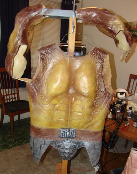

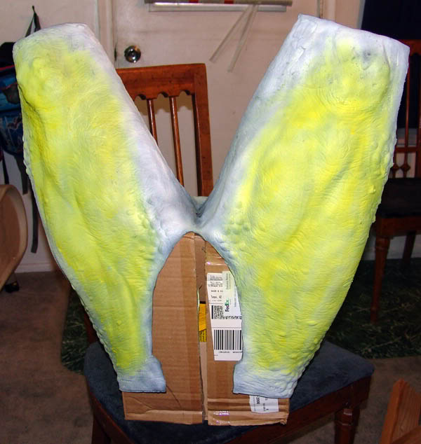

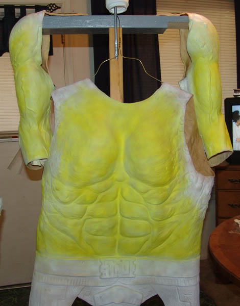

I started with complete coverage of Pros-aide and white. Then just white. I went through almost a 2oz bottle of white. I probably should have finished it off to get everything completely white but I'm not that picky. Then the lighter areas got a treatment with yellow. This is the point I worked in the blue for he viens on the arms. I should have done it sooner, like before the yellow.
and the legs

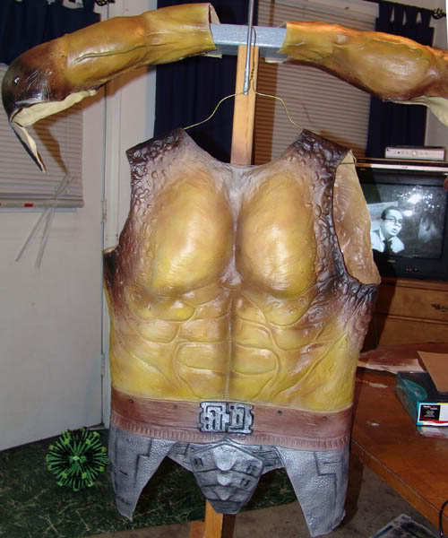

I covered the yellow areas with a tan to dumb it down. Then I covered the rest of the white areas with a brown and tried to fade the brown into the yellowed areas.
I then added black to the outer darker edges and the back.

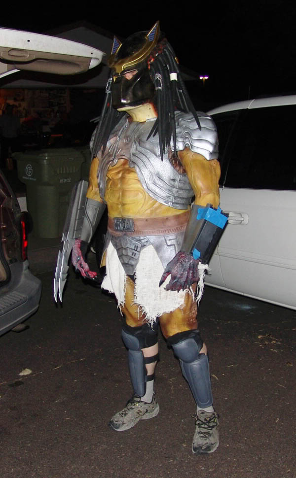

I spent about an hour suited up last night walking around with my family and freinds. This was a pretty good shake down.
My timer gauntlet busted open when I was putting it on so my wife taped it together. the gloves were OK but I don't think I like them as much now. Apart from not taking the paint I wanted them to have, they weren't cooperating. My half mask velcro came unglued so the mask was not cooperating either. A pillow case stuffed up in the head helped a little, I'll need to figure that out too.
I found some rub points, I don't know it more permawet or just time to dry would help more. I still think I put on the Pros-Aide a little thick. I'll probably go back and add some spots but I'm not sure just yet.
And no, it wasn't quite the armor setup I originally wanted but it was a shake down on Halloween and I ran out of time.

I'm just wondering about the paint job on the hands. Are they supposed to be that red in relation to the skins?
Thanks guys.
The hands are there own sad story, they are Demon Hands that were painted red already. I sprayed a set with Prose-Aide and it didn't take. I thought it might be the plastic, so I wrote them off for now and grabbed my second set and sprayed one with black plastic paint. That paint didn't seem to dry right either. So I sprayed them both with a grey primer to dumb down the red. If you look in the last pic you can see that my left glove is darker then the right. I'm going to try to get them painted right but this might just lead me to break down and sculpt hands too. It really is too bad they weren't latex, then they'd be more workable.

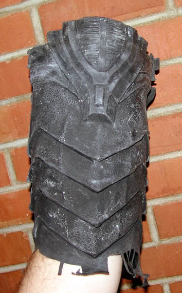

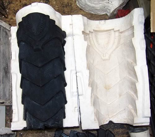

So I sat down last night and I wanted to see how well I could repair the FGR-95 mold...
I got all of the exposed burlap covered and most of the air pockets filled. The bad side is that I don't have the original texturing all over. The good side is that I can make them looked worn with out too much difficulty.
My first pull.
If I can get a second pull, I'll have my pair and I'll hold off on the resculpting. Or maybe just change it up and make it more custom.
Edit: this was part of my shin mold too.

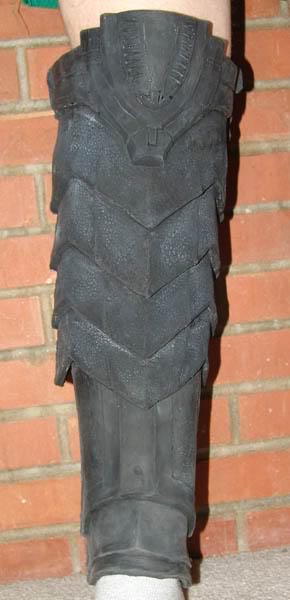

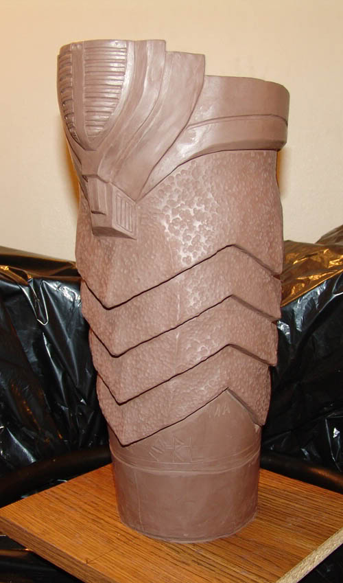

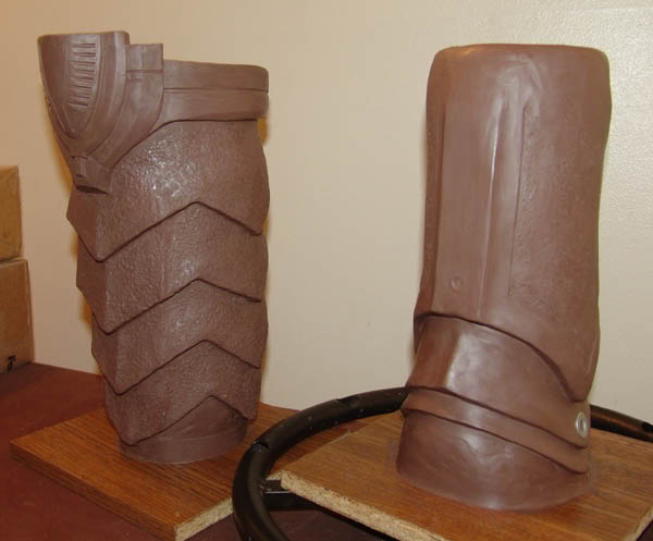

I resculpted the upper shins. I found that I measured but didn't compensate for shrinkage right. So, what I have is basically too small. I increased the diameter and lengthened the spacing on the scallops. Great experience and I'm glad I got the couple pulls I did. That gave me a point of reference for the size for shrinkage. I've estimated that the Bat Black latex shrinks about 6% which is less then what I expected but more than the Mold Builder.
I also built the armature and sculpted a lower shin. I based this one on the McFarlane Scar, but I didn't like how different it was from the movie so I added in some changes to make me feel better.

I'm making the mold for the lower shin right now. I flipped it over and mounted the board on the top. That will allow the bottom of the shin to be at the bottom of the mold. Since that is more important than the top, it will get fully submerged in the latex before slushing.
So I finally did the mold on the top part of the shins. The mold came out pretty good considering I was trying things a little different in regards to the layering. The mating serfaces don't match as well as my previous molds so the seam on them will be little bigger than I'd like.

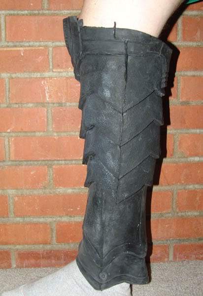

Got my first pull and had to put it on considering how small I made the last one. I feel good about the size but I still find I should have gone larger on the diameter of the botoms piece, they fit my calf fairly snug and they aren't even the thickness I would normally make. :) so, I may end up resculpting yet another part. I cracked the mold of that one pretty bad anyway.
