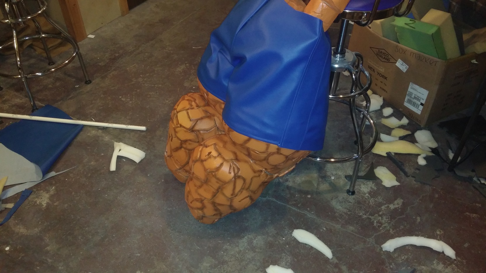

This is dry fit I did before doing the pants. It was a very good thing I did this as a lot of the foam tore and split from the stress of all the stones. After the fit I was able to re secure and enforce all seams under where the pants would be.
Work on the pants. Final product looks a little baggy but when pulled up they fit pretty decent. The only way I could get them to be skin tight was to glue the material on and I really did'nt like the way it looked.

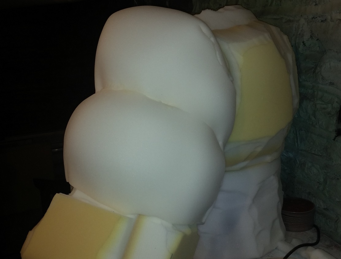

Started the sloppy process of building bulk on the torso. I have to switch over to the upper arms before I can go any father building up the back and chest. I will need to make the upper arms and torso truly massive to look appropriate to the massive hands and forearms I have complete.This is where that ball and socket approach should help me out. Lets hope that what i see in my mind can be engineered in the real world.
Started carving in some general shapes even though im not done bulking it out. Needed to get a feel for where I needed more mass.
If the torso seems oddly long its because it is. I want to make sure i have plenty of material to work with when I dry fit this with legs on.

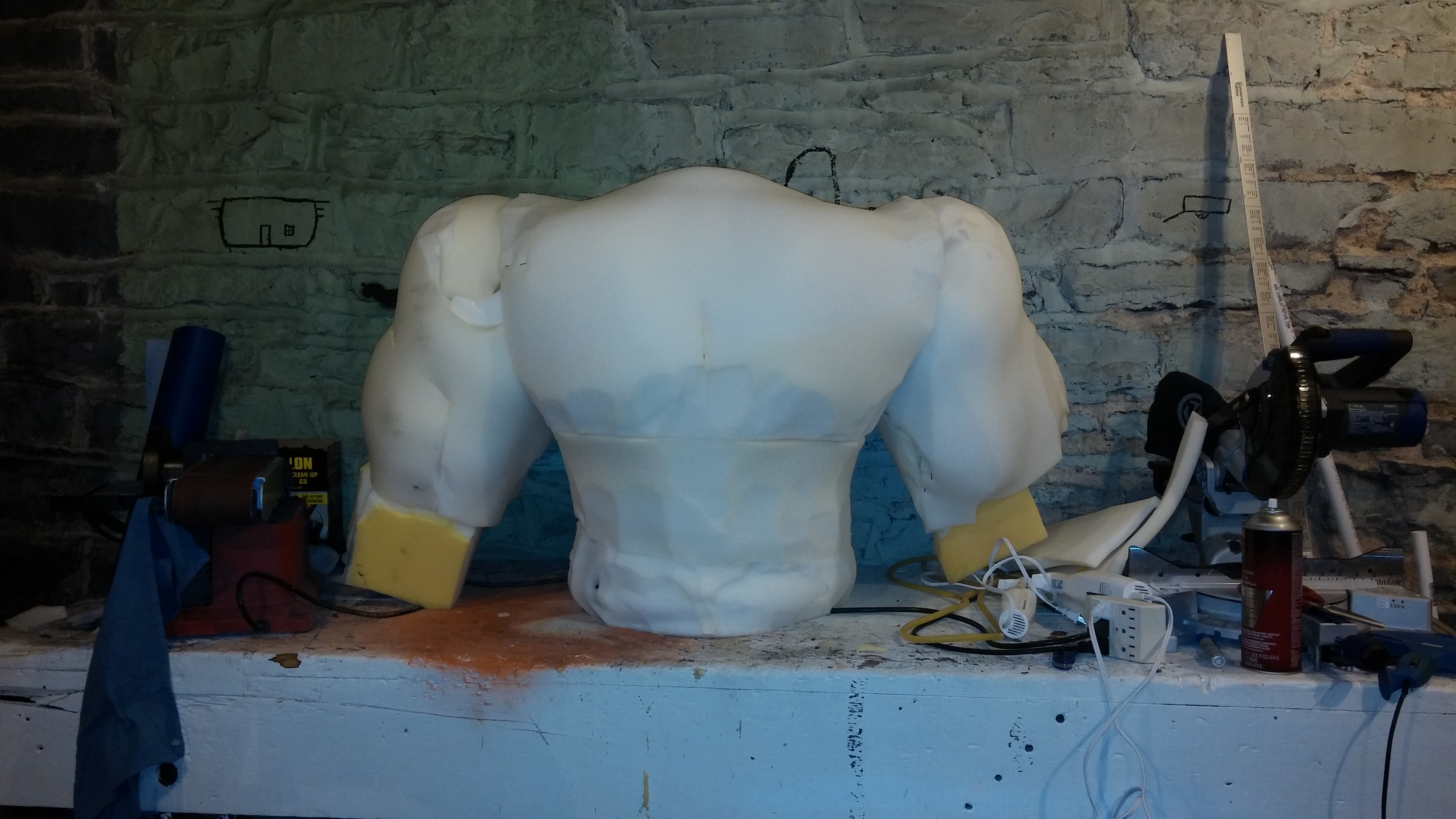

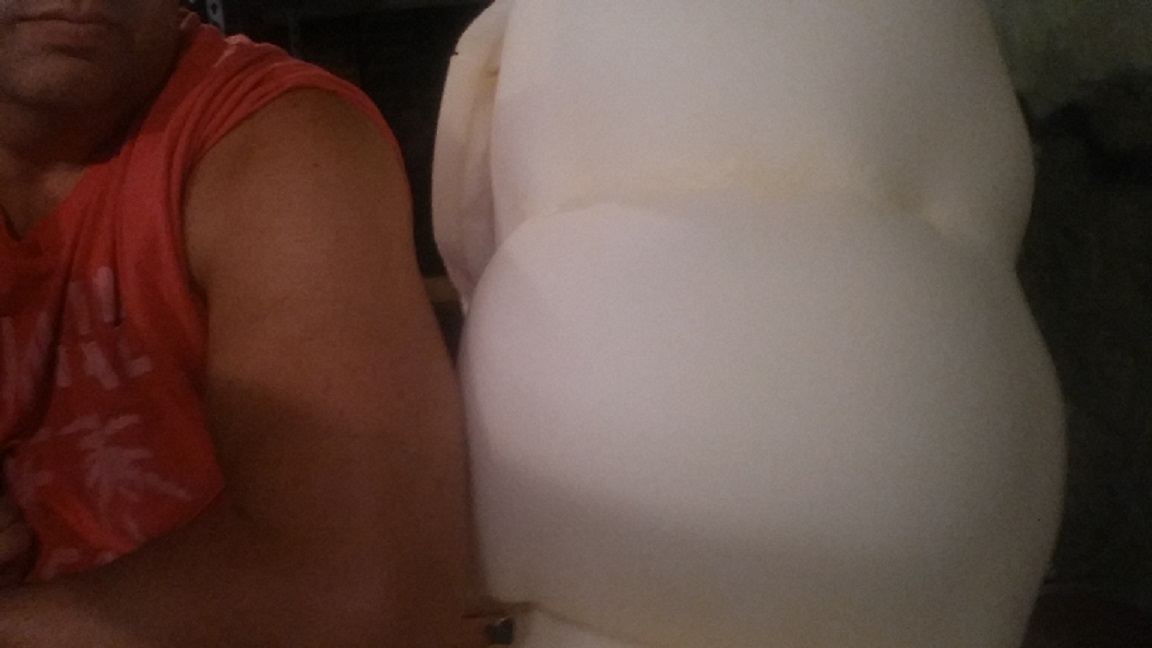

So just a quick update. I have been working on one of the upper arms to see how big I need it to be for proportion and to be honest im pretty happy with end result. Still a lot of customizing, padding and trimming to do but I think im going to be able to make this work. Goal is to have torso ready for test fitting and trimming by Monday. Will post as I go.
0820151323b.jpg0820151324.jpg0820151326a.jpgMe 19"arm. Thing 46" arm.

finished 2nd upper arm. Continuing to tweak and pad out chest and back.

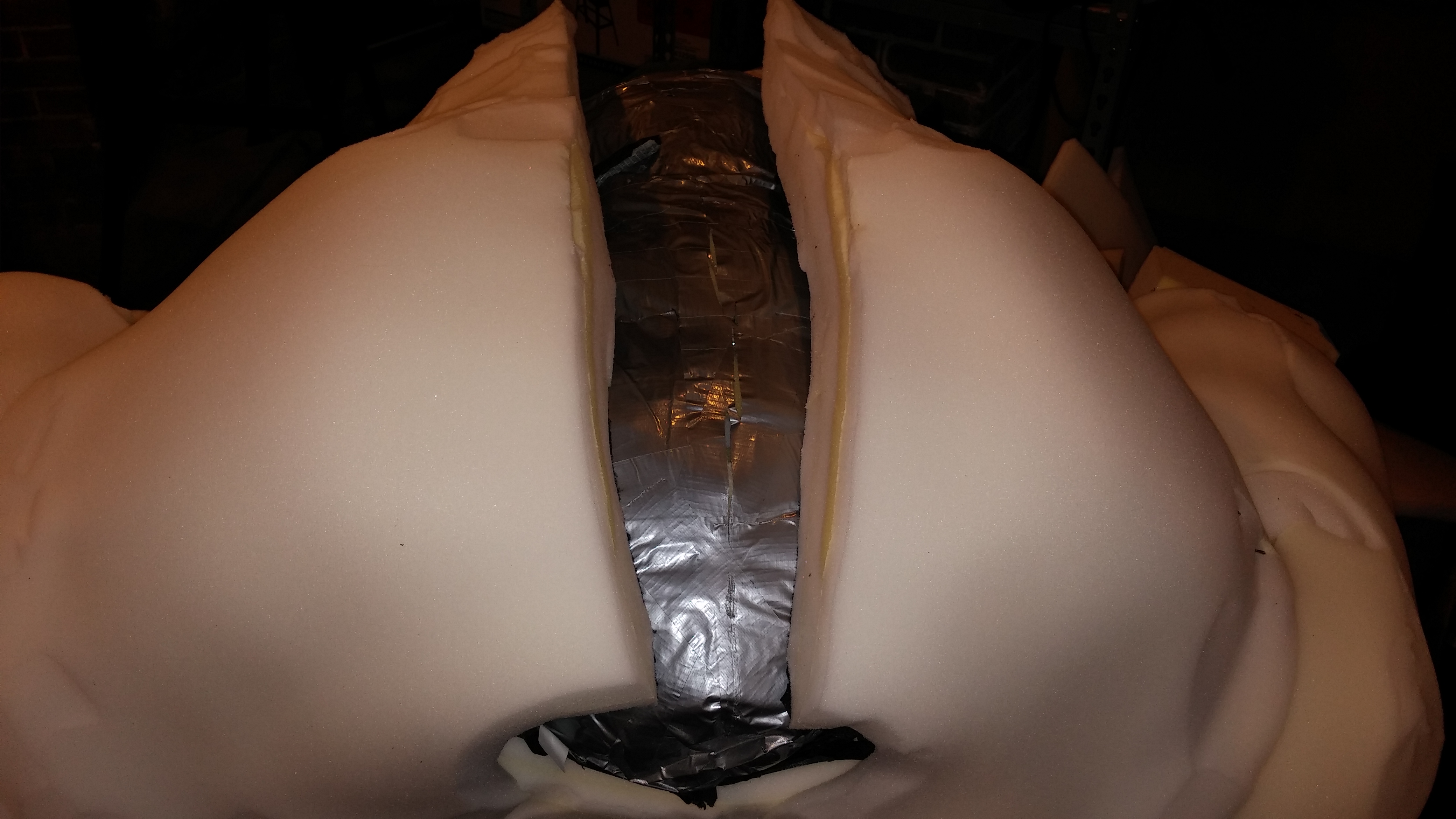

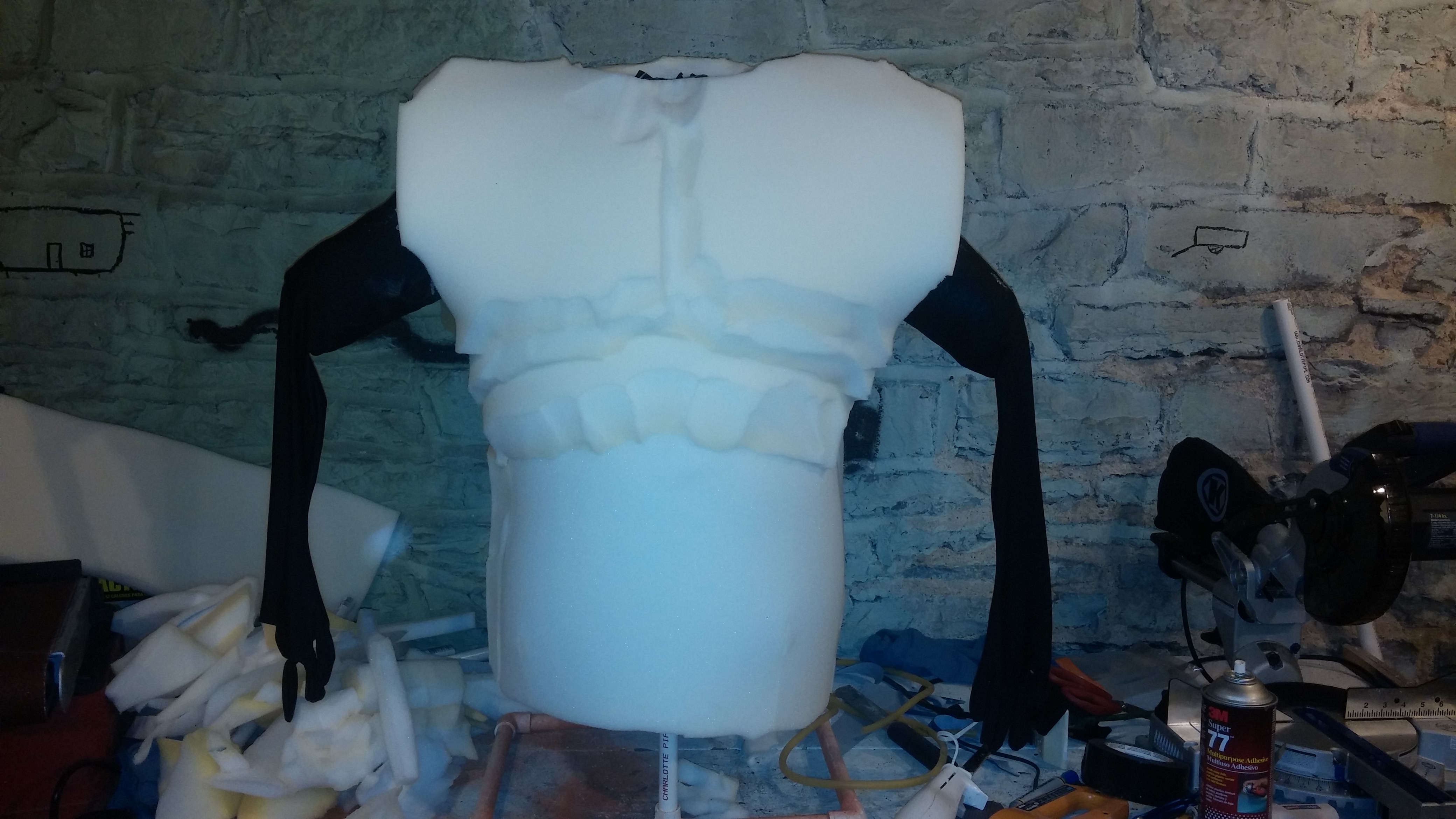

0823151524.jpg0823151530.jpgCut the back open for fitting. This seam will be connected by Velcro strips and alternating Velcro on the rocks themselves. Should be pretty seamless.

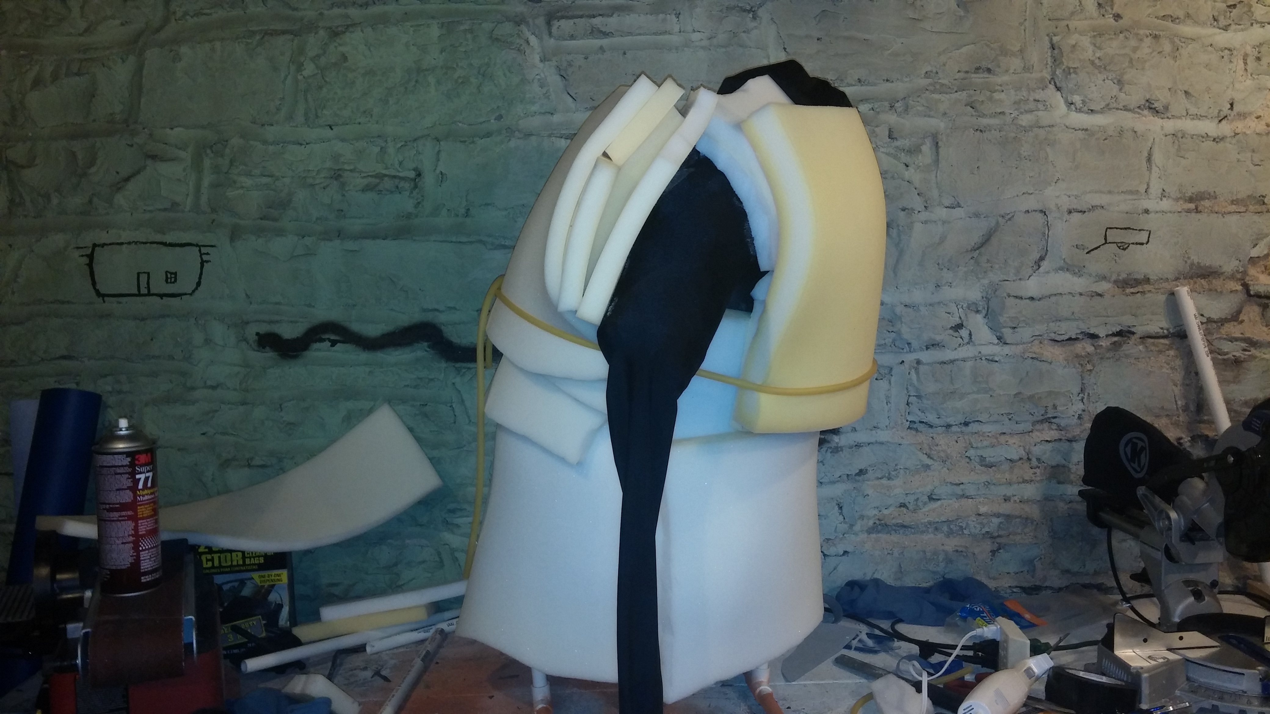

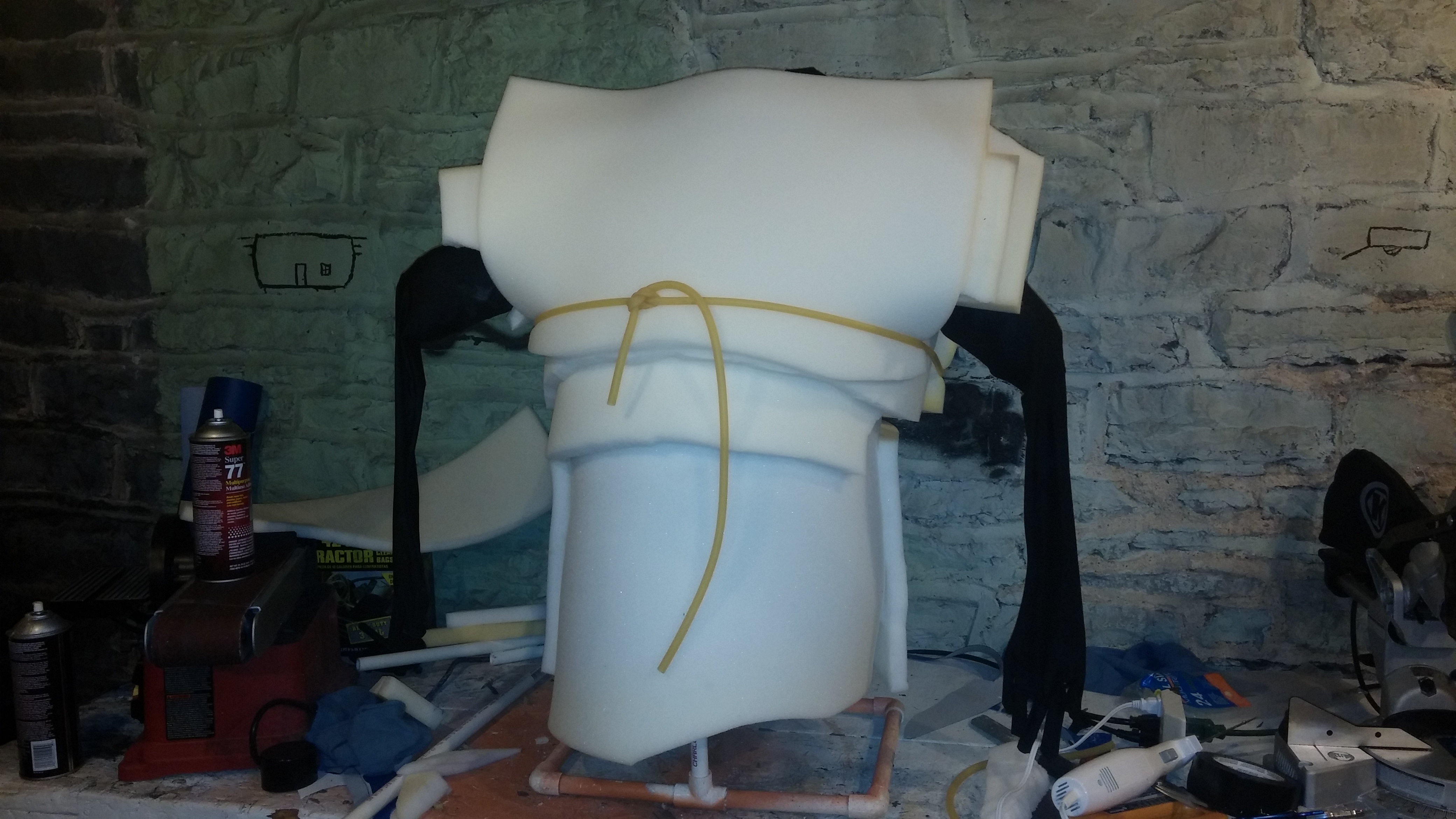

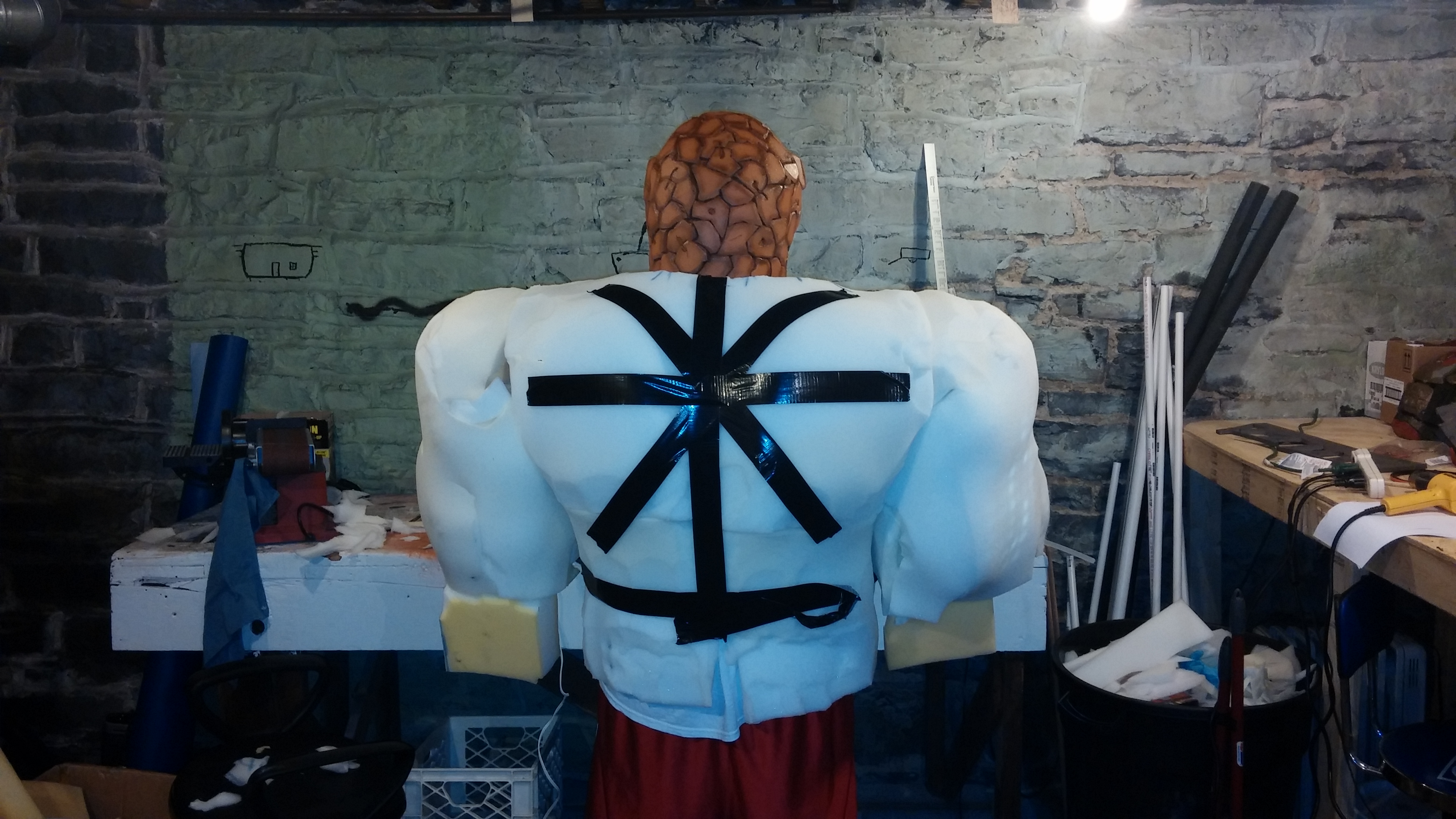

Time for the test fits. I knew there would be a lot of tweaking so on this series of fits I am just addressing the fit of the head on the shoulders and the fit of the shoulders into there sockets.
0823151721.jpg0823151602.jpg0823151737.jpg0823151738c.jpg0823151738f.jpgOk so after 7 test fits and trimming and adding and taking away it appears that I have a solid fit for the head and shoulders. Next I will test fit with Legs for the proper trim out on the waist. Once that is done I will tackle the brutal task of fitting the lower forearms and hands with the upper arms. This part will be the most difficult of the build I'm afraid. Wish me luck!!

View attachment 518731View attachment 518732Cut the back open for fitting. This seam will be connected by Velcro strips and alternating Velcro on the rocks themselves. Should be pretty seamless.
I'd be slightly cautious about relying on velcro to hold it together.Based on my own experience with a hulk costume (with fairly similar construction) there can be quite a lot of force put across the back of the suit. You might need something a little more robust to take the strain and then have the velcro to just keep the edges in place.
Just a thought. Great build.
This is an awesome build man! Looks so cool.
For the back closing I would use a couple snaps and then velcro :)
I would suggest elastic strapping with buckles on the inside to hold it together, then your Velcro idea to cover it all up.
