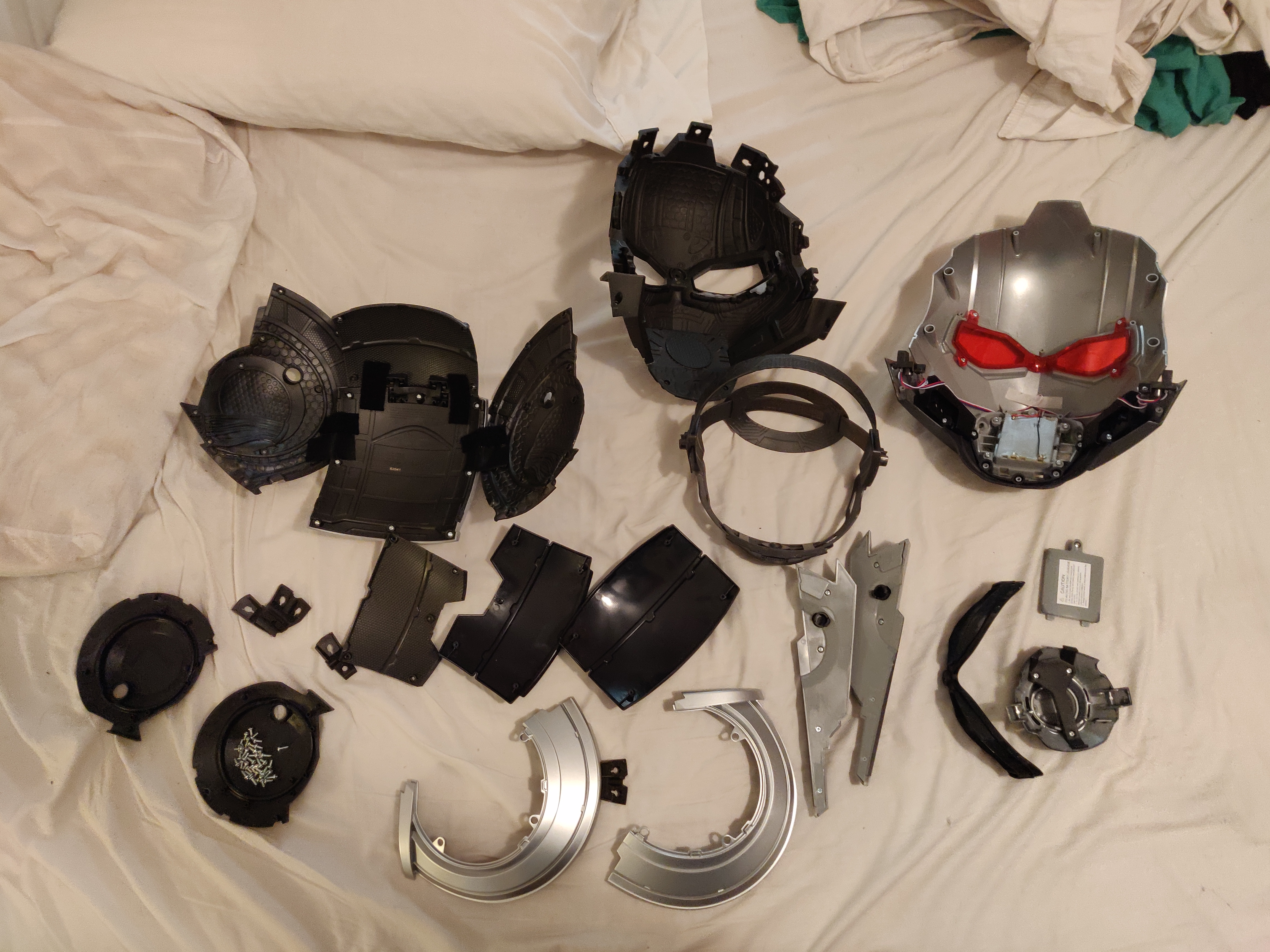

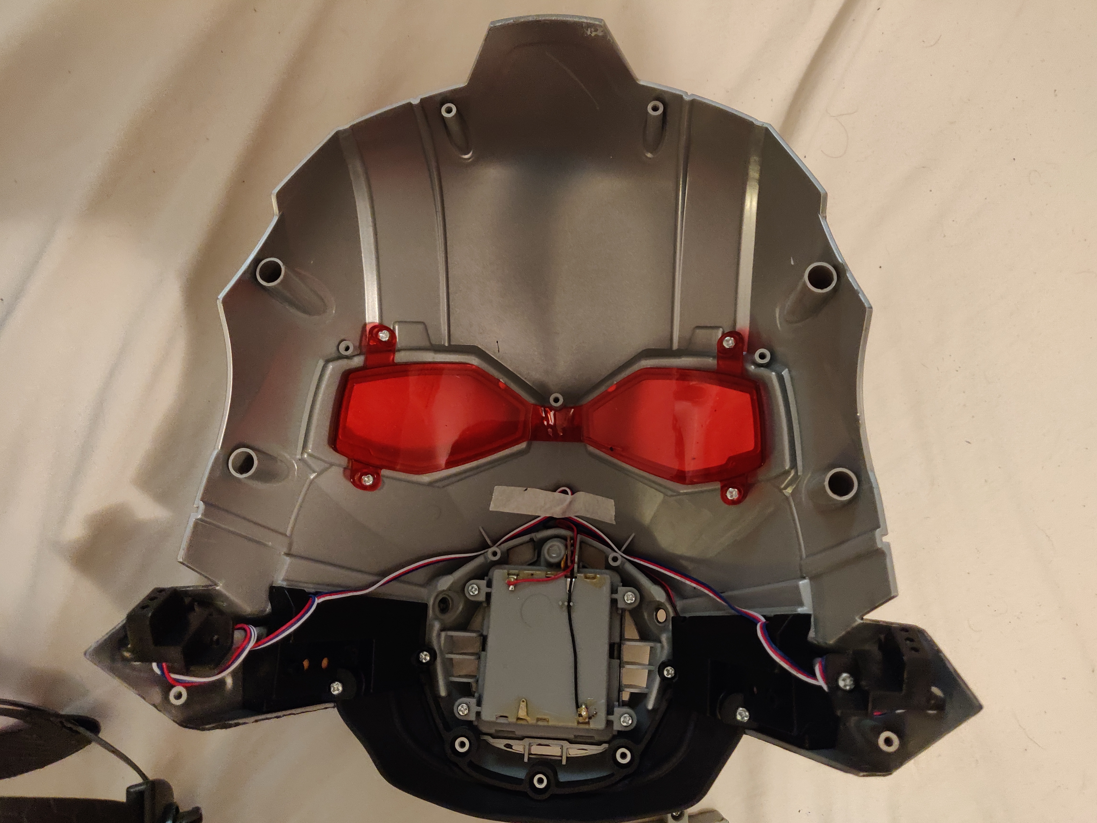

I just took mine apart. There's some 30 screws inside the helmet. The helmet is comprise of a dozen pieces that cone apart. It's going to be a bit of a puzzle to put back together. It's a lot more complicated than the Black Panther or Iron Man helmets. Once you pry the face off from the interior piece, it's easy to unscrew and remove the electronics and lenses. You will have to mask the top of the face in order to paint the jaw.

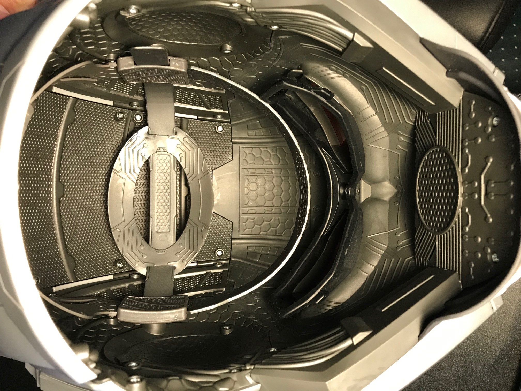

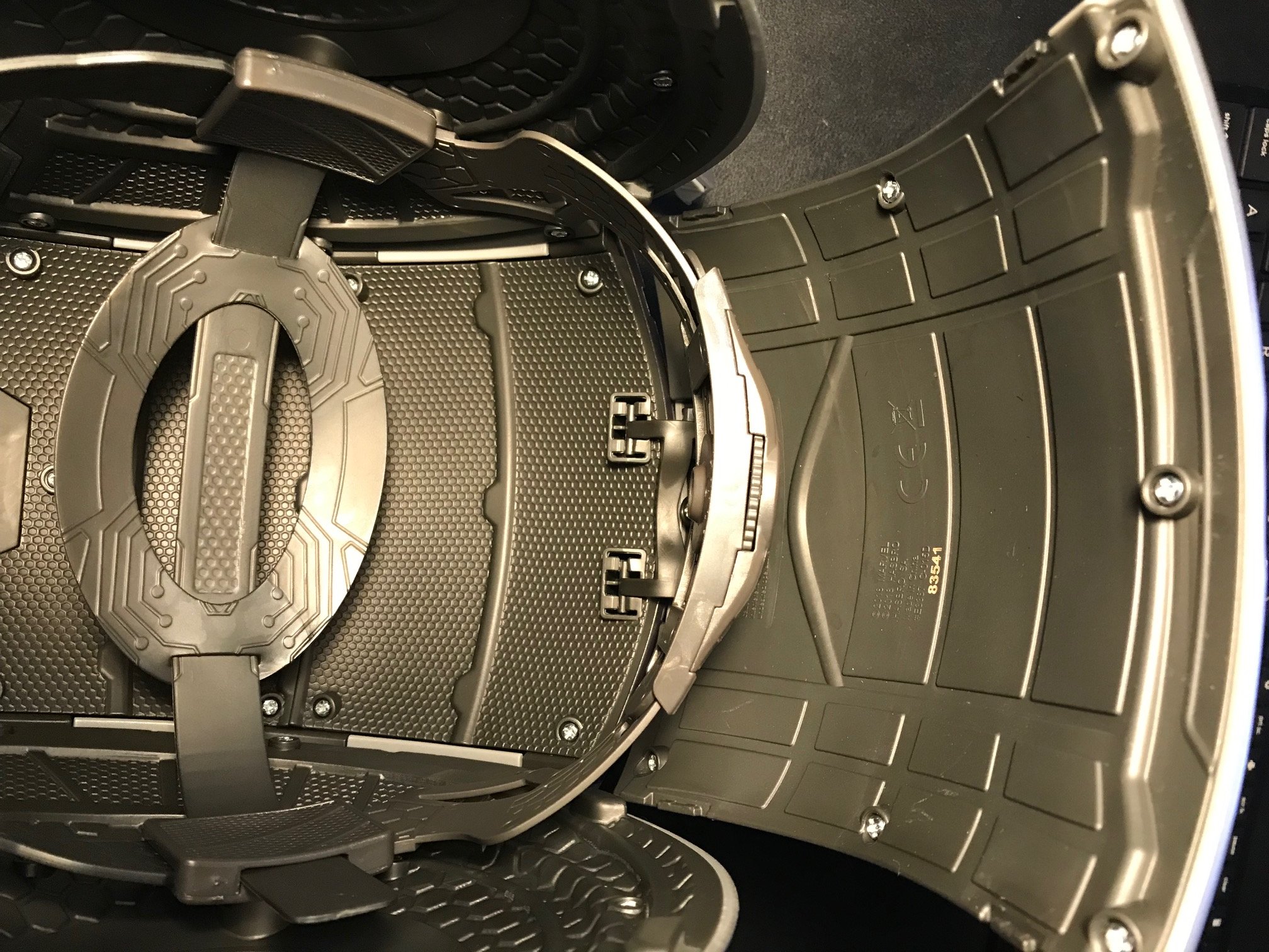

Shots of the interior - a lot of molded detail, even a honeycomb pattern in some areas. Looks like faceplate and side jaws are one piece, then you have the mouth piece where the battery pack is. The ears look to be separate pieces too. The top of the skull is separately attached, as is the back skull. For those thinking about having a removable face plate, looks like you'll have some cutting to do.

I'm happy to see the black and silver areas are separated, this negates the need to mask for painting those areas.
Can you tell me if the black frame that surrounds the red lenses also is removable?
I think the black frame is just painted part of the face.
After removing all the screws, the helmet pretty much falls apart and I didn't pay much attention to the order of everything. Several pieces are interlocked with one another. It didn't seem like you can access the screws to remove the faceplate before taking the rest of it apart first.

Putting it back together wasn't so bad after all.Fortunately there IS a more efficient way to remove the faceplate.
Remove the top of the helmet only, which is comprised of 9 screws. Don't worry about the hinge or the backplate.There are 2 hidden screws that are otherwise inaccessible near the top. Then just unscrew the face (6 screws inside the face + 2 near the antenna + the eye mask). You can then pry off the faceplate.
