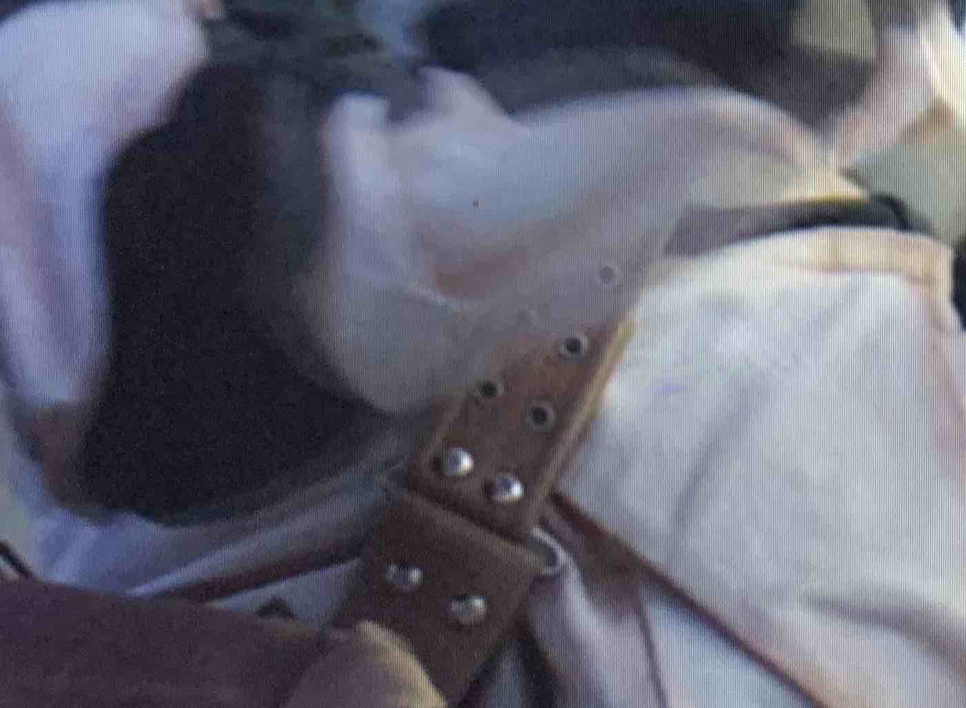

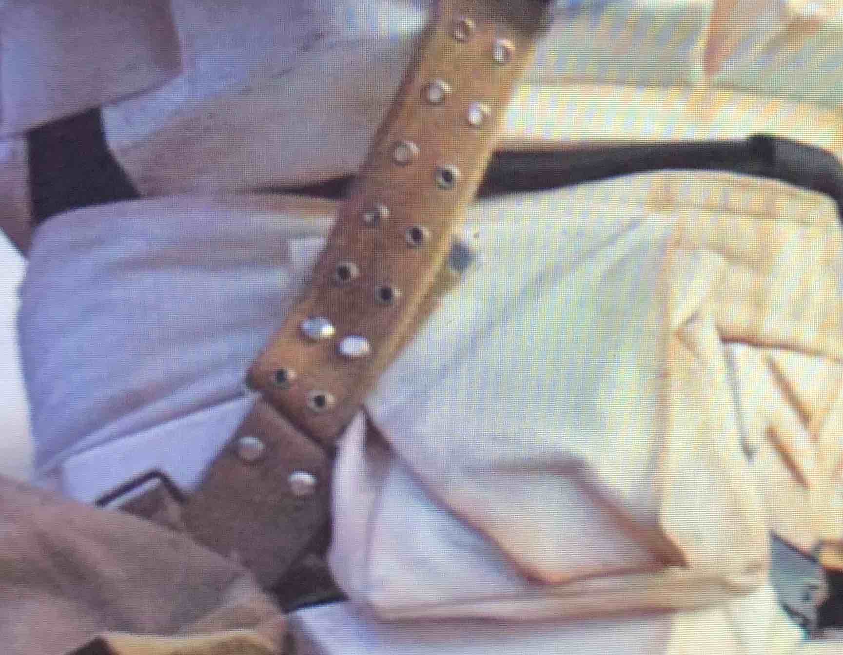

Do you have a screen cap or two illustrating the two versions of the bag? I’ve been following this thread and tried to spot this in the episode but am feeling a bit clueless.
I have attached a comparison of the two types of bag variations. This is around the 4:30 mark of Episode 8 where the two scouts are waiting at the check point. As with most props, they must have had different versions of the bag on set and didn't catch the continuity issue with the bags as minor as it is.
I went with the version that worked for the rivets I had. I went with the version that had the rivets placed 2nd to the last row. This only needed the rivet to go through the grommet and one layer of the belt. The other version may have had longer rivets to pass through 2 sets of grommets or had the grommets removed. Both versions are screen accurate.

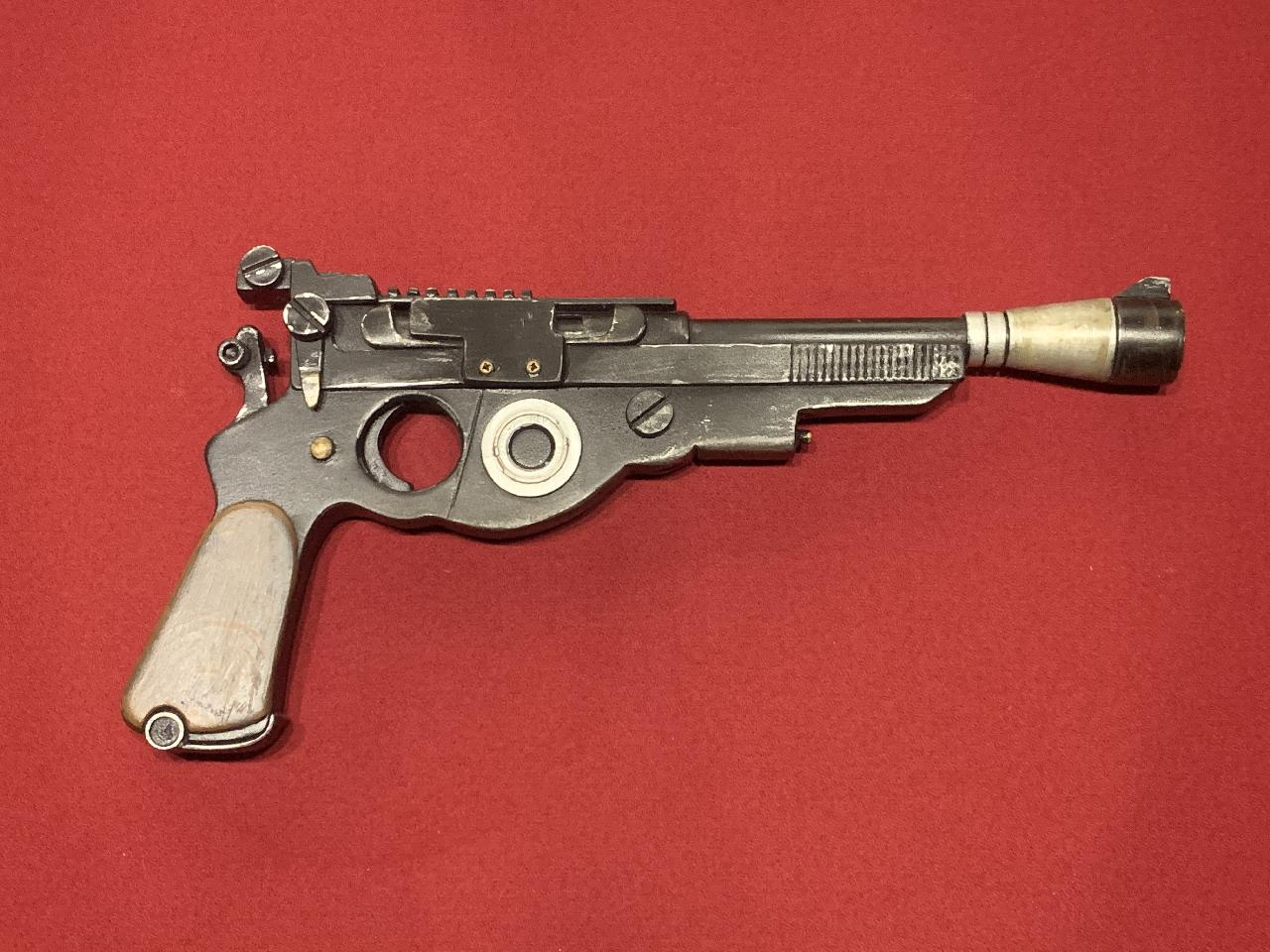

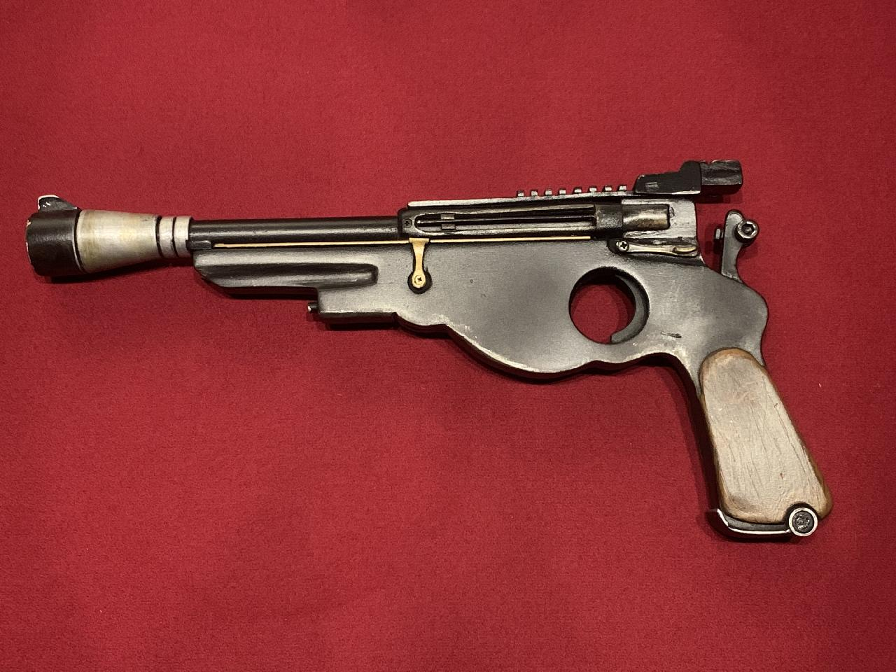

I finished the weathering on the Mandalorian blaster that I built. I'm pretty happy with it. I met up with a bunch of my fellow Mandalorian Mercs last night and they all thought it was a 3D print and were surprised to find out it was all built by hand. For now I am calling it complete because I need to get back to build the rest of the armor. Hoping to have it done before Phoenix Fan Fusion (Phoenix's version of Comic Con) and definitely need it done before SW Celebration 2020.

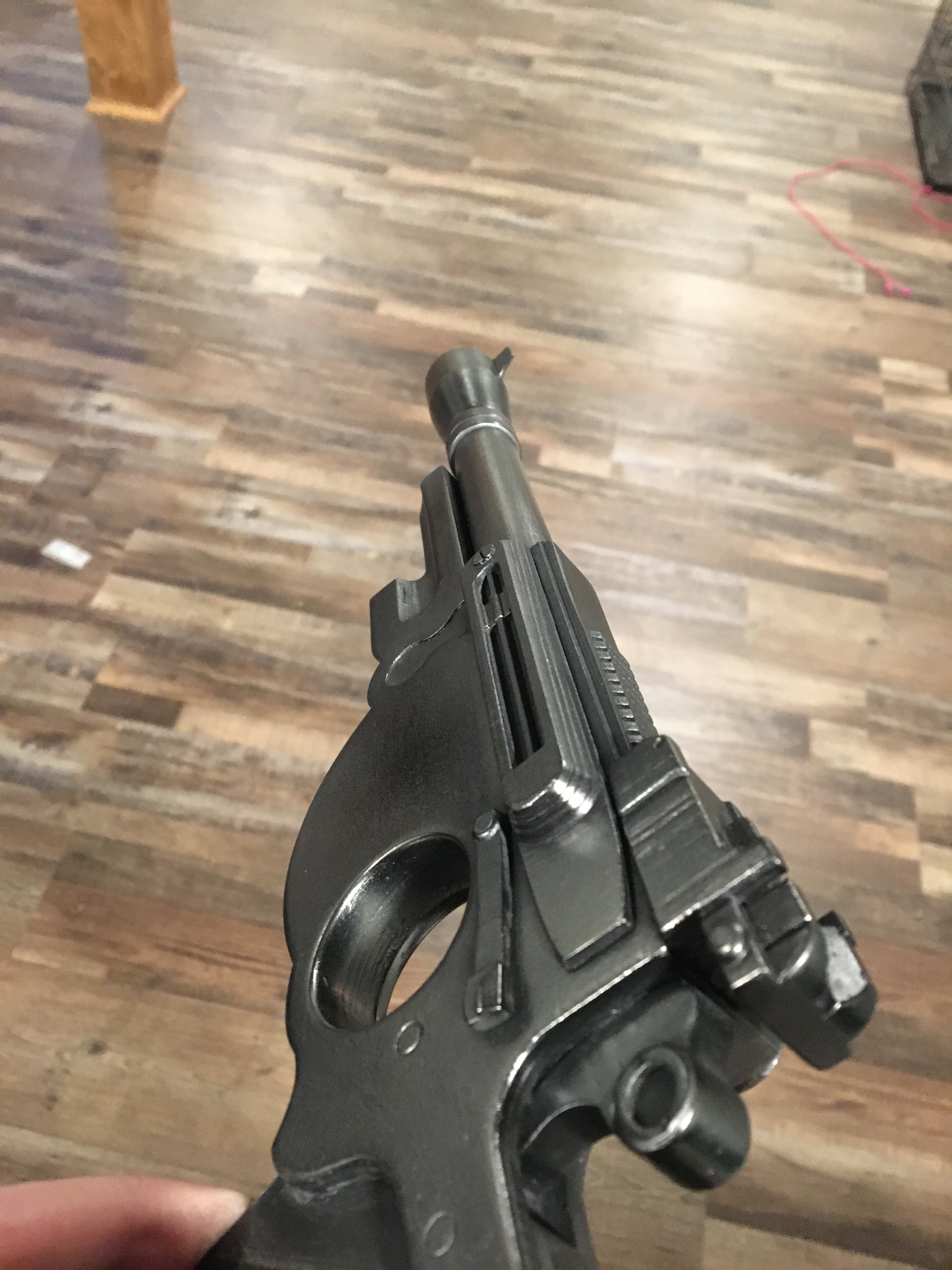

I'm not sure if someone has given there opinion, but graphite powder buffed onto gloss black paint looks amazing!
I've heard this before. I'm not familiar with the process at all. Do you then seal it with something like a gloss clear coat?
I'm actually using the process now to work on a bergmann mando blaster. Basically the shinier the undercoat, (the black) the more chrome-like it looks. So for the blaster I used more of a satin. You buff in the graphite powder when the paint has set up for around 2-3 hours. Graphite powder is actually a form of dry lubricant and can be purchased from an automotive store! Yes you then seal it with either a glossy coat or satin depending on the look you're going for!
Nice! Thanks for the info. I will be trying this for sure.

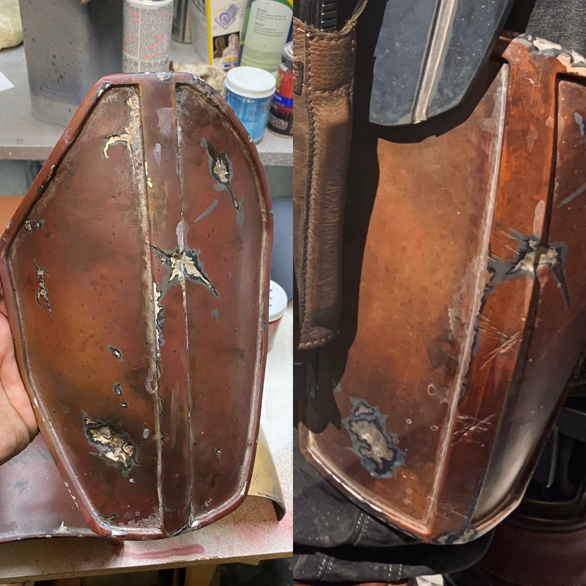

Working on a (mostly) full set of Mando armor. Not ready to share all of the pieces yet, but I did spend a good bit of time working on the thigh and I’m happy enough to share it.
Damage was a combination of this image, the D23 Armor, and the actual physical damage sculpted into this piece. Not 100% accurate by any means, but I think it’s close enough.
Now I’ve just got to do this with all of the other parts!

I did some graphite powder buffing on my Mando blaster tonight!

Thanks as always for your support my friend. This set of armor comes from the Plastic Arms Dealer. It is a mix of fiberglass and 3D printed pieces.
They arrived super rough and I’ve had to do a lot of bodyshopping. I’m under a deadline but if I wasn’t I would have really liked to have taken a full week or two just getting the pieces cleaned up.
