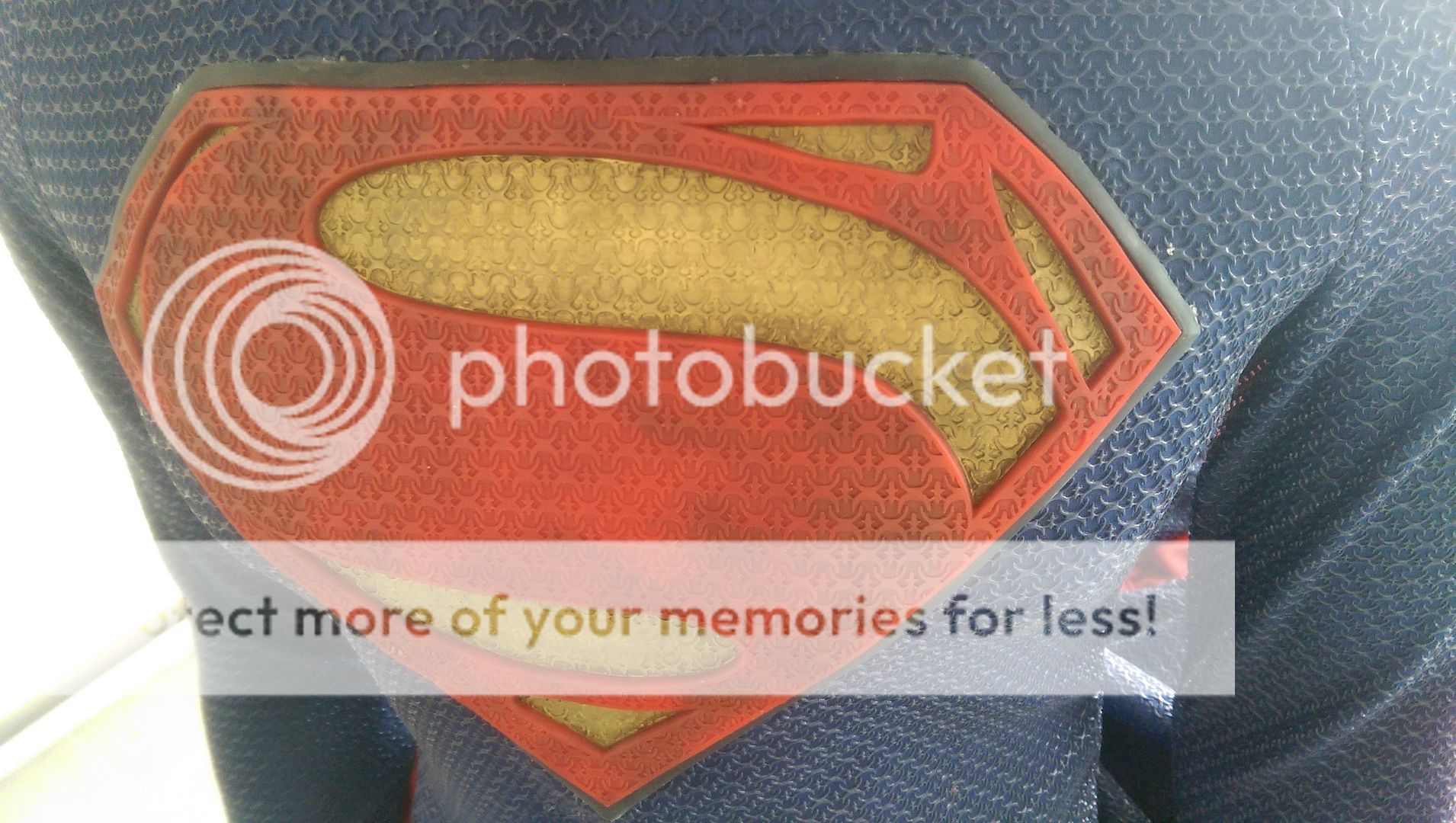

Hi Guys ... its been a while and i finally found the perfect Super glue that works really well by bonding the urethane armor piece with the body suit silicon texture chain mail surface .
My buddy Mike ( PunisherNC ) has sent me some E6000 glue and Silpoxy from smooth on for test .. but the glue is not working . Even the cure time takes longer until 24 hours , it can hold the armor piece in place but easily peel up .....
Ive done lots of research and been advice by a friend that made Raimi urethane webbing Spiderman suit . Recommended the Loctite super glue . So i called my local Henkel office for some sample .. after few test ... we finally nailed it ...
For all bro that owned my MOS suit , u may need to get this LOCTITE 401 super glue ( or any other code of Loctite superglue ) with the LOCTITE 770 PRIMER .
The 770 primer is to activate the sensitive surface of Silicon and to make it easily bond with the urethane surface .. and it works perfectly. Only few seconds and it works ... BUT FULLY RECOMMEND TO LEAVE IT 24 HOURS OR MORE BEFORE U CAN SUIT UP !!!
Apply thin layer of the 770 Primer on the silicon surface , and only few drops of the Super glue , and it takes few second to cure ..
Minor work i did today ... finished gluing the chest Emblem and also the Neck and back armor piece . Love the glue result ...
