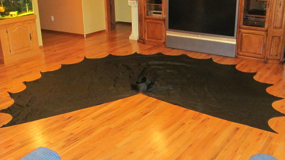

Here, for example, is a typical dramatic batman cape pattern showing how the semicircular aspect works, from Flash Dixon's build, though this one continues forward into what's closer to a complete circle than a semicircle to allow the performer to do that 'pillar of black' look where Bruce's body is all swallowed up by his cape.
It's very hard to find shots of the MOS cape spread out that aren't CG-augmented, but it seems like we're shooting for something that can be accommodated with a semicircular cut.
