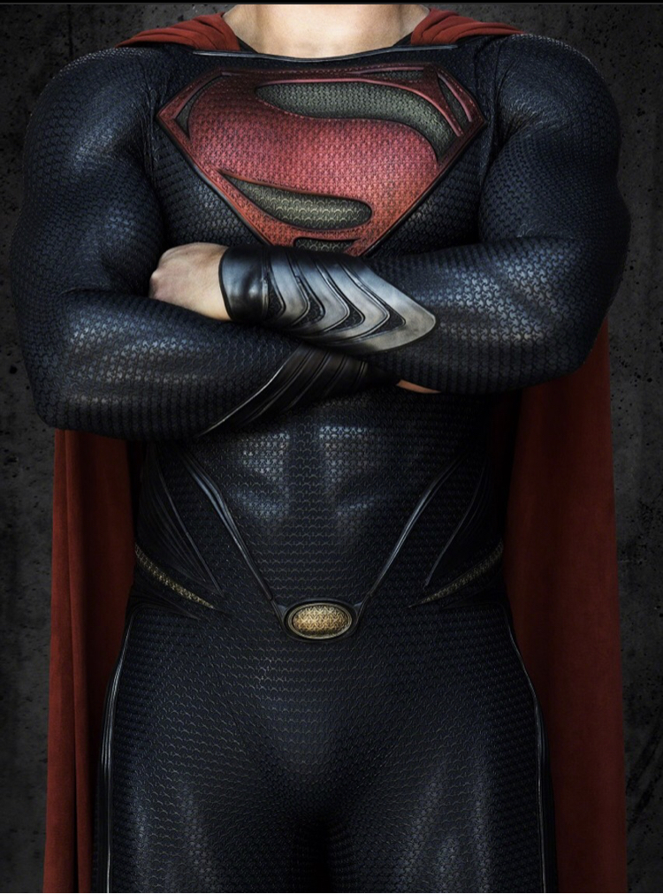

Dude how’s going. I know many time has gone since that discussion. But I’m still a little bit confused about some image distortion on MOS costume. For me the one attached is the perfect and original one, but sometimes it’s seems Shiner in other pictures on Google. So backing to famous question, what fabric, color and finishing painting that atsuit are made?
Please guys feel free to answer in case this answer was already posted here and I missed it. I’m new here sorry
