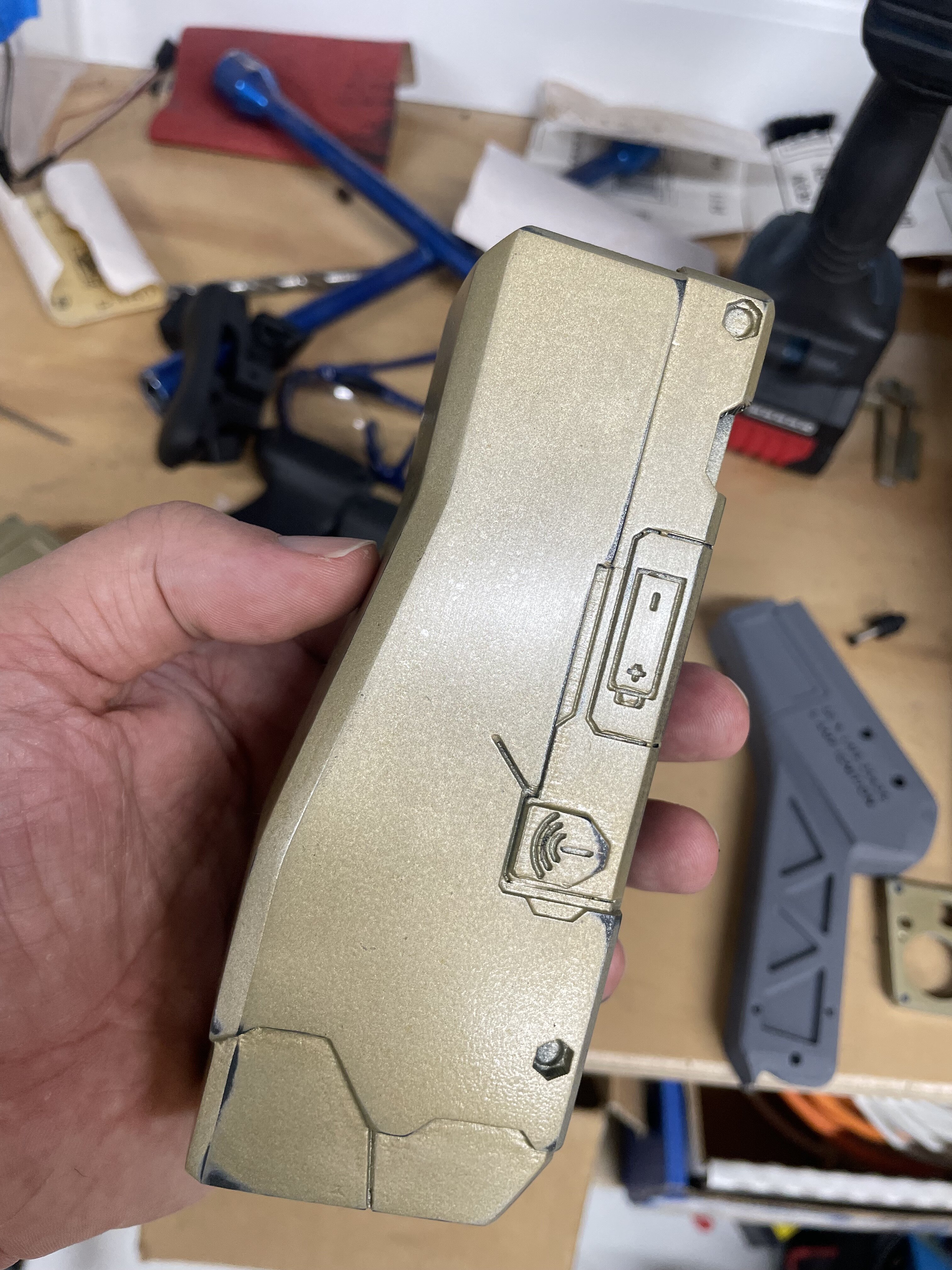

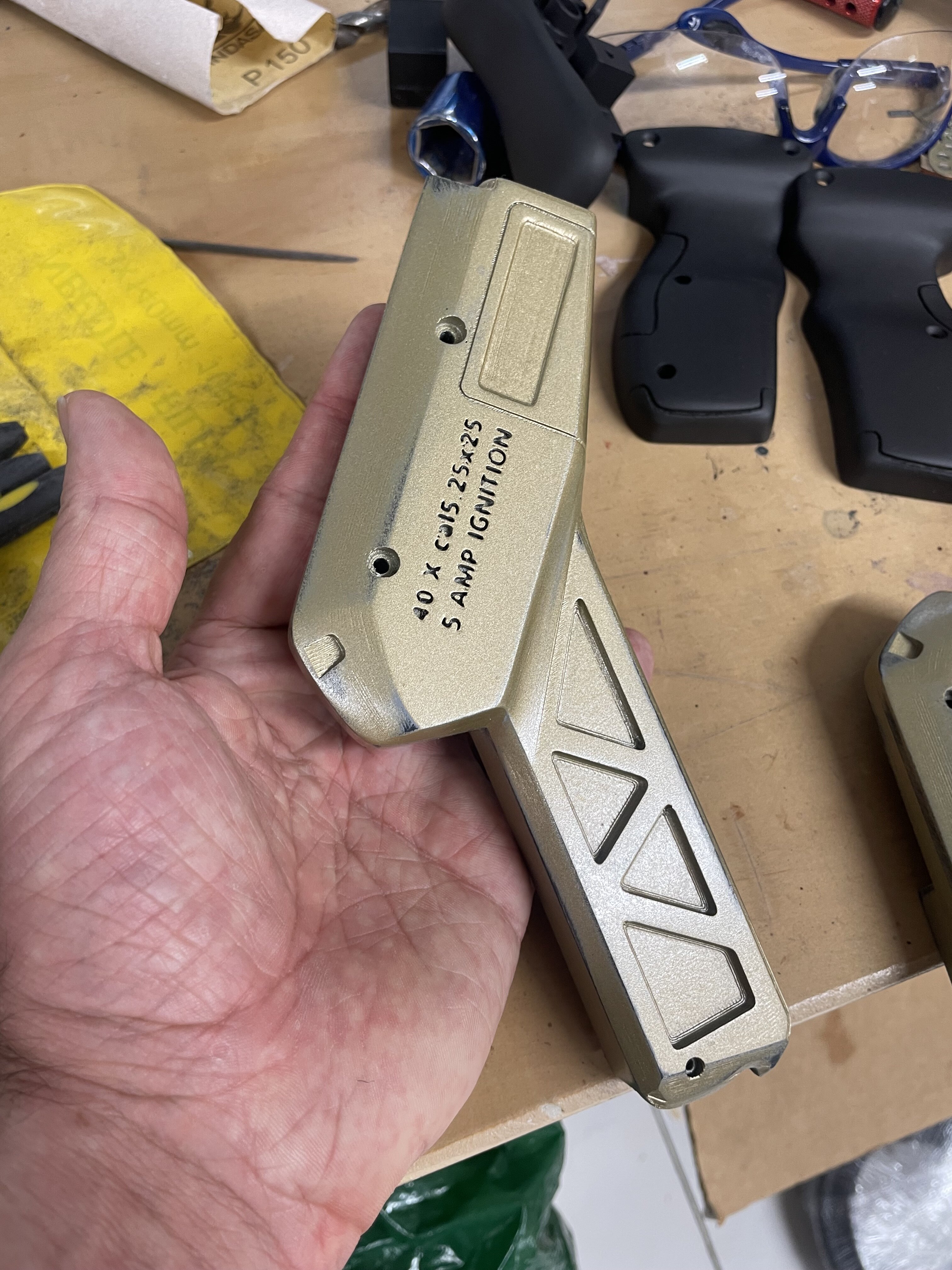

I picked up the real pieces today, and can still "feel" the fingerprints want to stay there. Its not hardened yet.
A joiner piece that I coated prob 2 weeks ago is feeling dry.
If I were to bake the metalic paint, what kind of temp, and for how long?
Usually a combo of 75 to 80 degrees, moving dry air and a UV source. Those in the sun belt just put it outside and rotate it once every ten minutes but even then you need to not overheat as some areas sunlight would melt your project. The UV is far more important for certain brands but I just always do it.

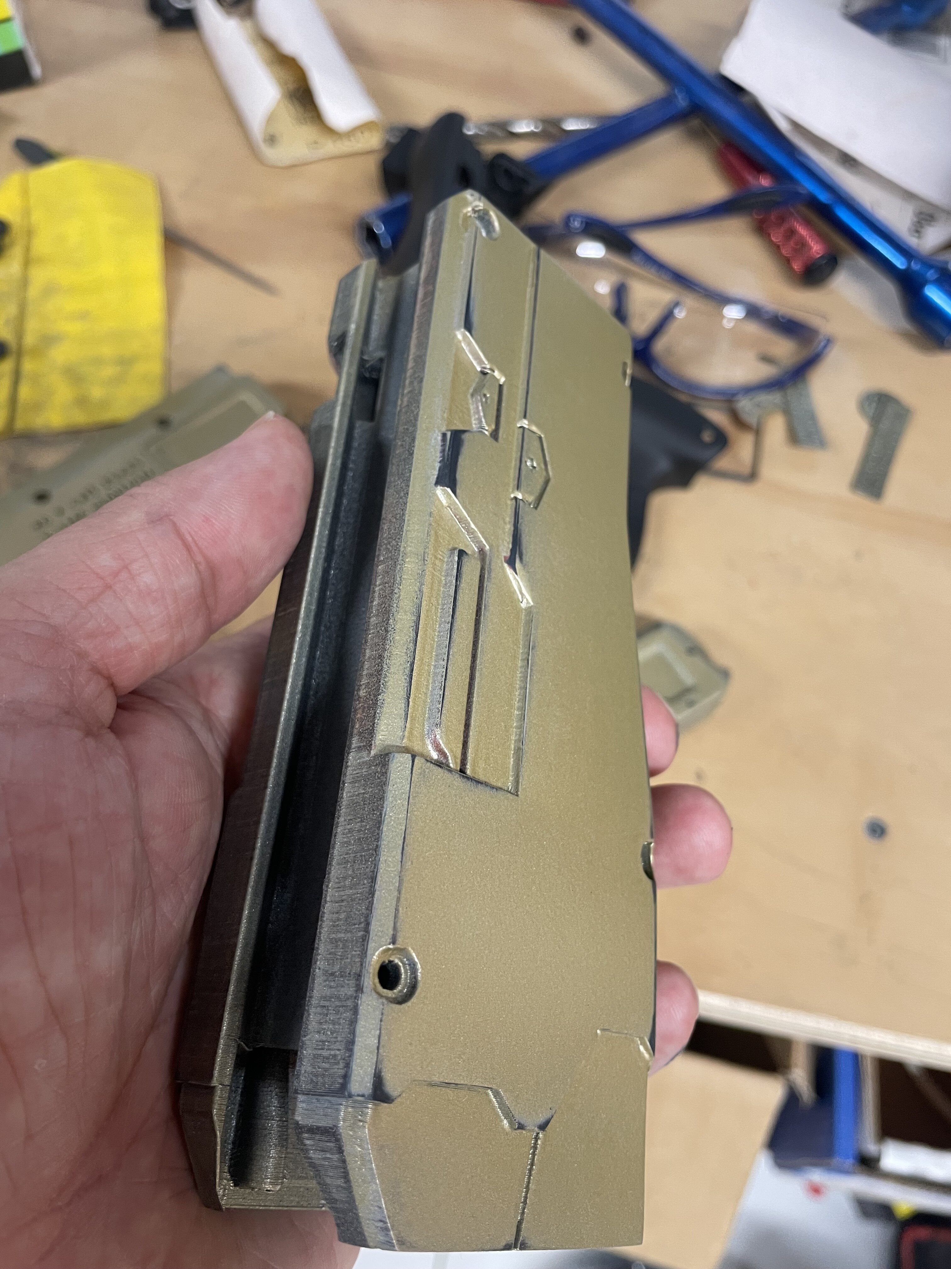

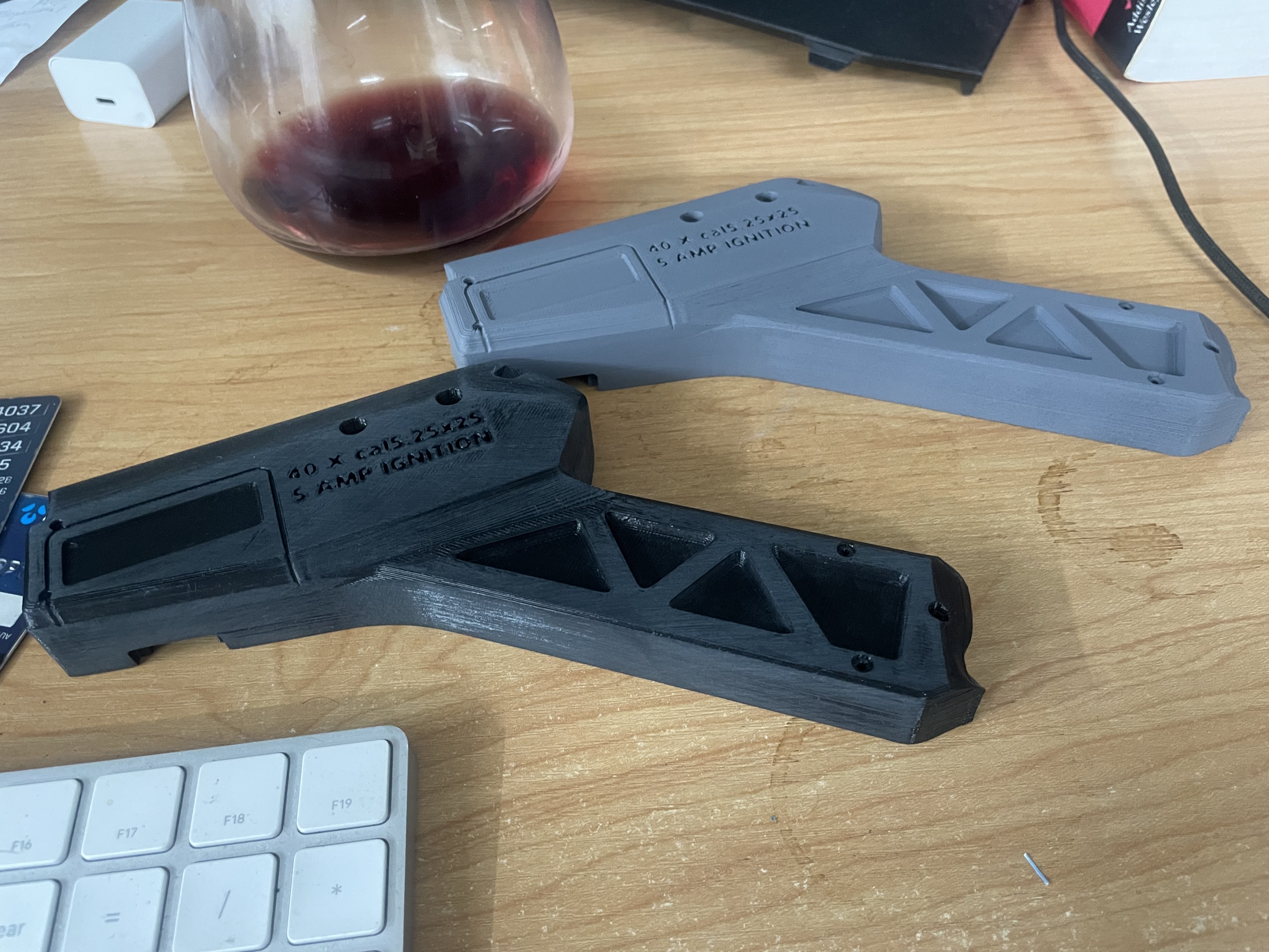

OK. Todays update. I bought some different clear and primer. The goal is to try to prep two pieces using the same technique so far. It's already somewhat derailed because I don't have exactly the same primer (which, I didn't like that much anyway). However: I'm going to prep two pieces. Sand them the same. Prime the same. Gold (with horrible R gold awful) and then I'll do my best to get them to cure. I might turn 80 before they do. THEN I'll try to clear with both Rosto-matt-clear and a Rusto-Enamel clear. Only cos I read somewhere a different material could (MUST BE DONE OR DIE YOU MUST MUST MUST) be good/better.
So. While all the parts themselves are having a paint holiday, why not mess about with other things. Try to learn some stuffs. To all that have posted ideas and got me thinking, and experimenting, my thanks. I would not have done this without you. So give yourself a pat on the back, grab *another* coffee (or a beer). If you've in Wgtn, NZ, I can provide the fluids :)
Here’s what I got. Oh. I should add the clear I’ve used in the past. The matt chalked clear.

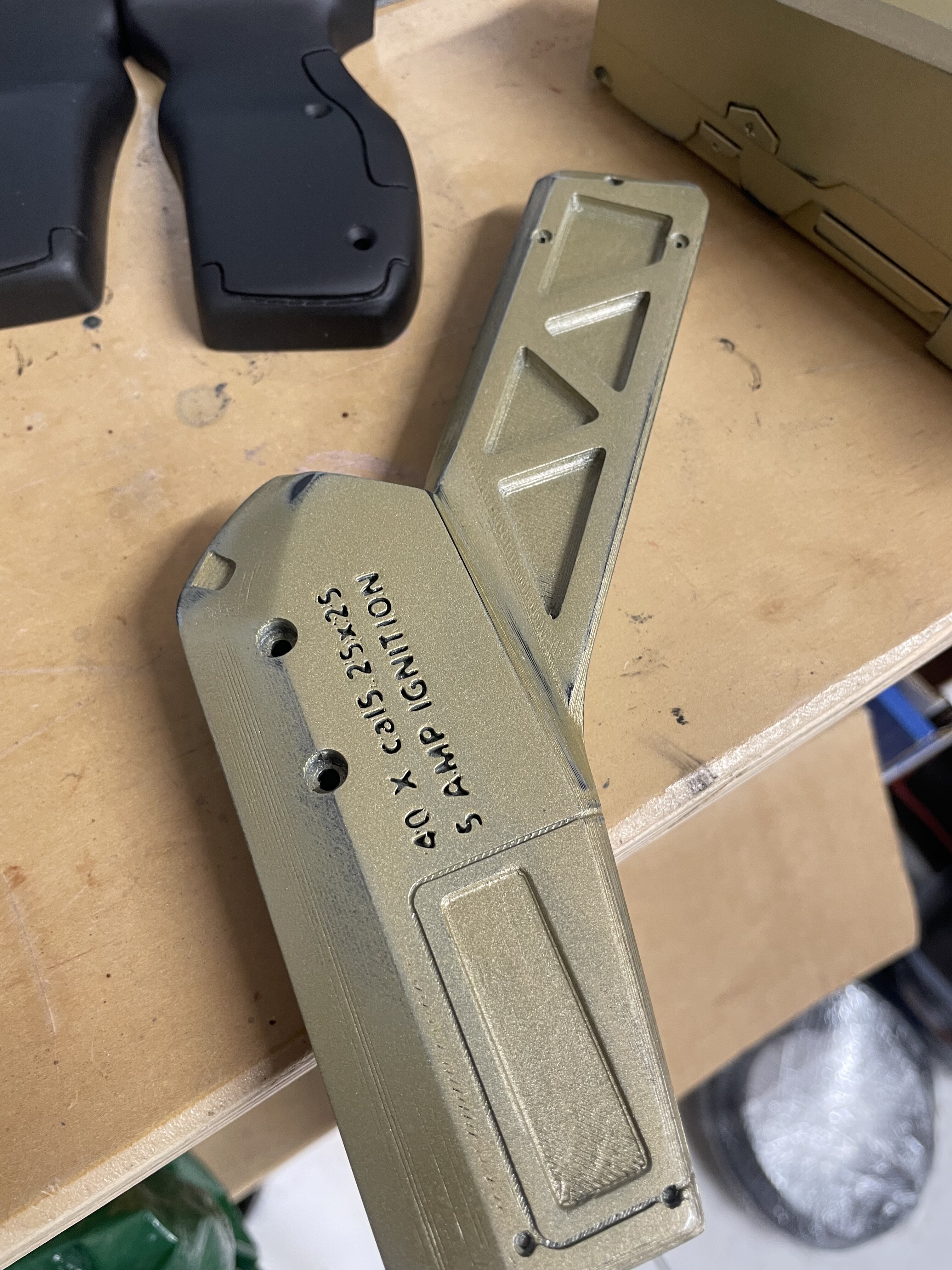

So here we are. One piece with one coat. Another just sanded. I’m hoping the scratched jn E for enamel stays.

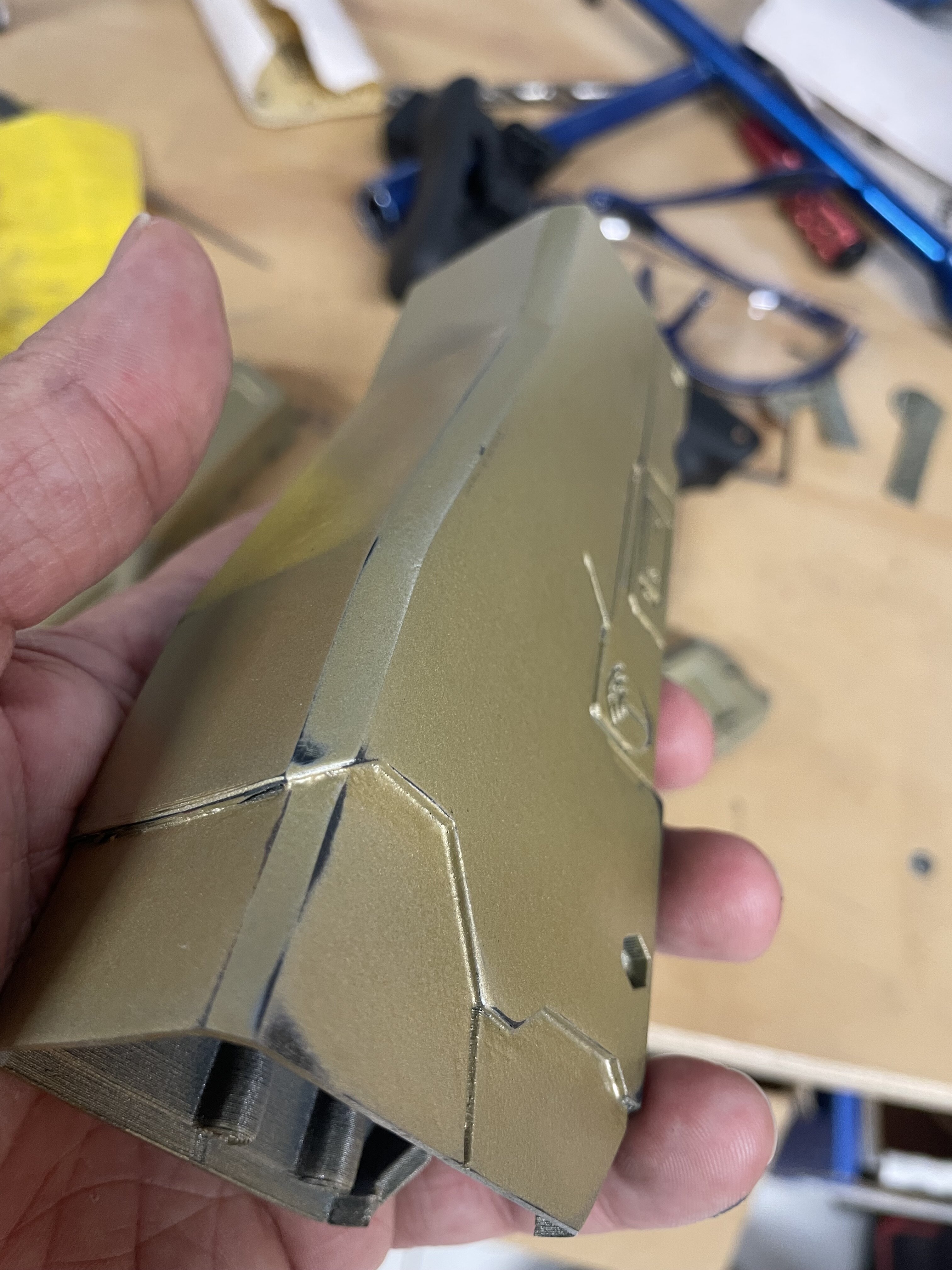

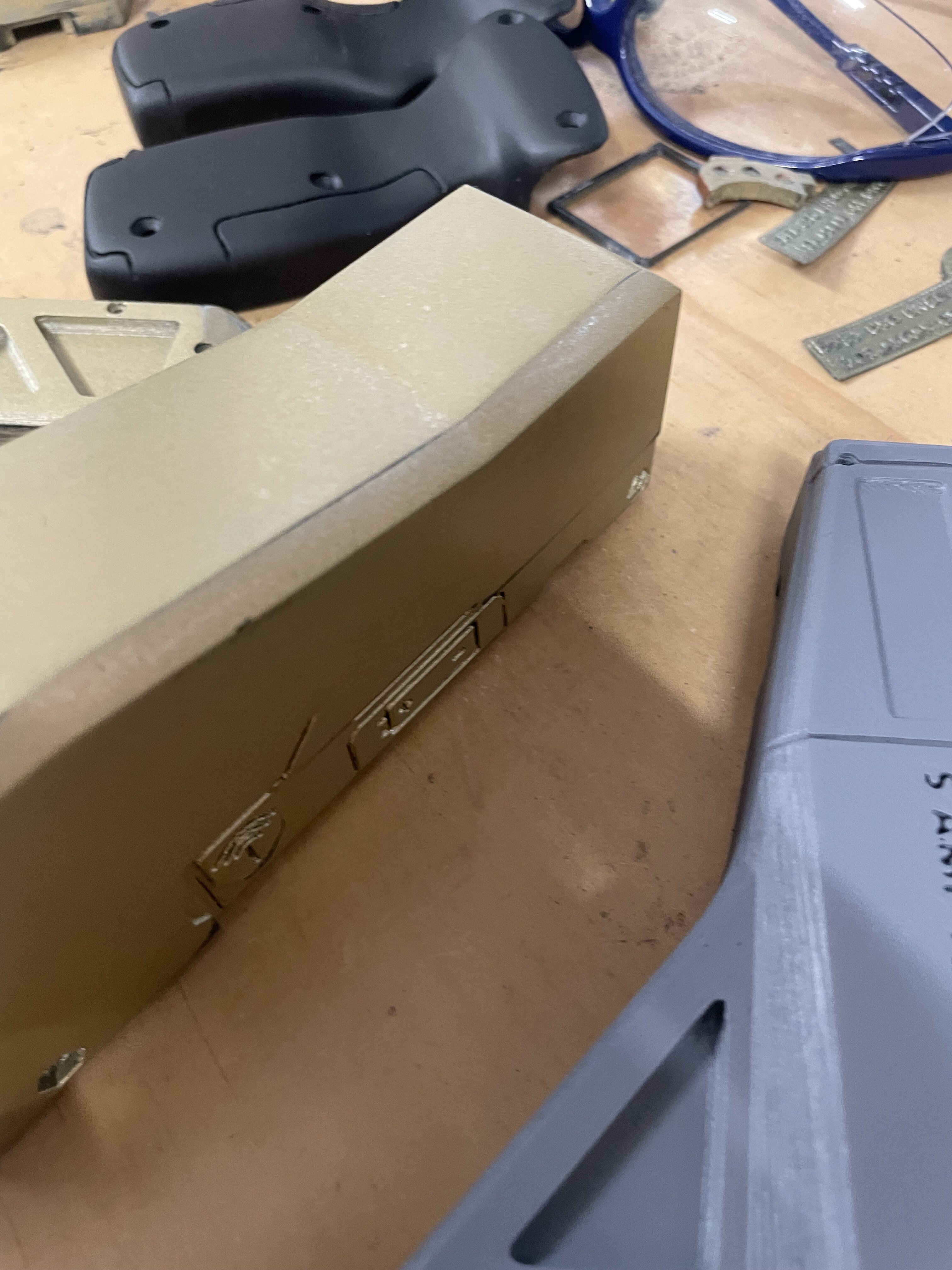

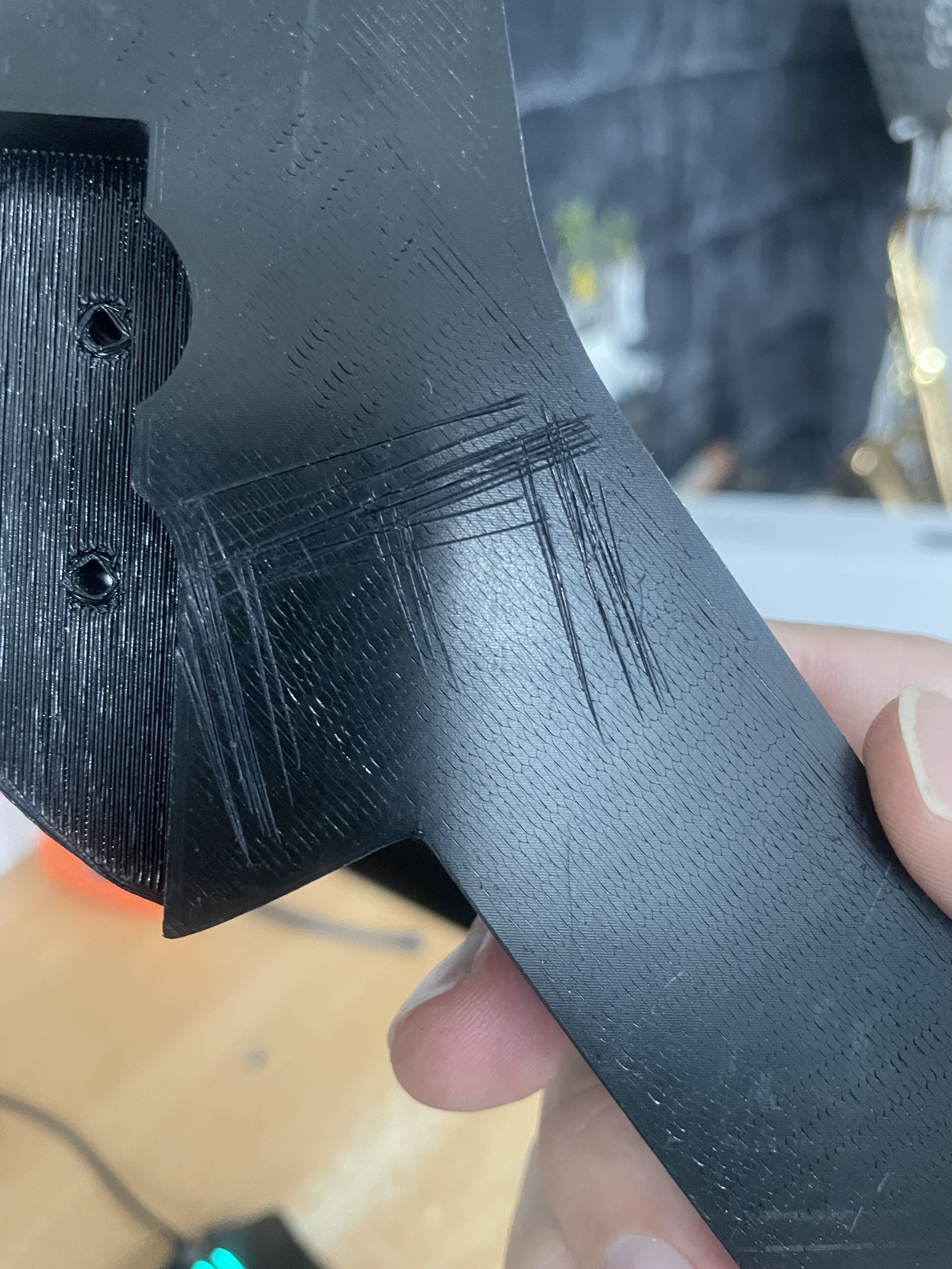

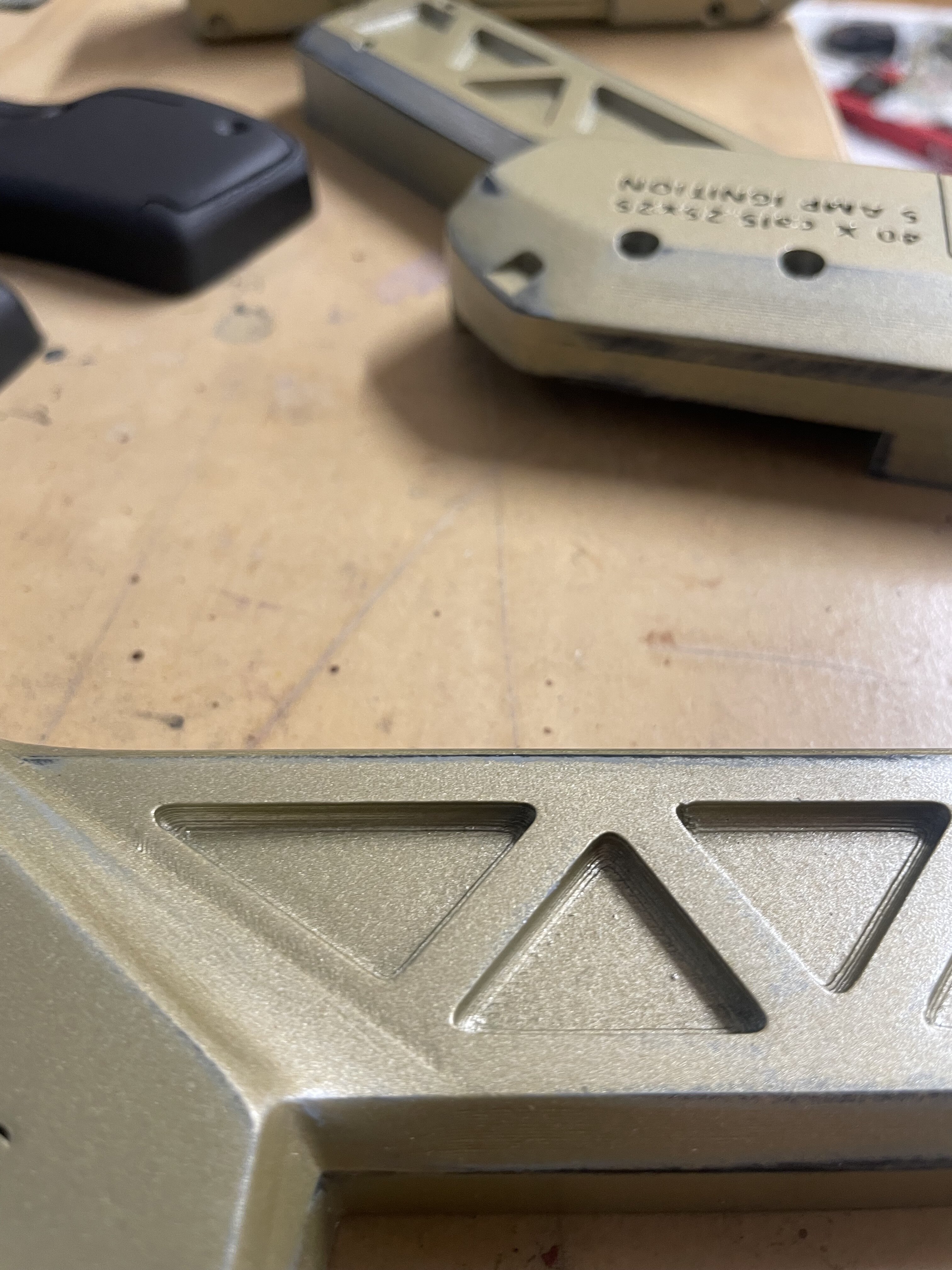

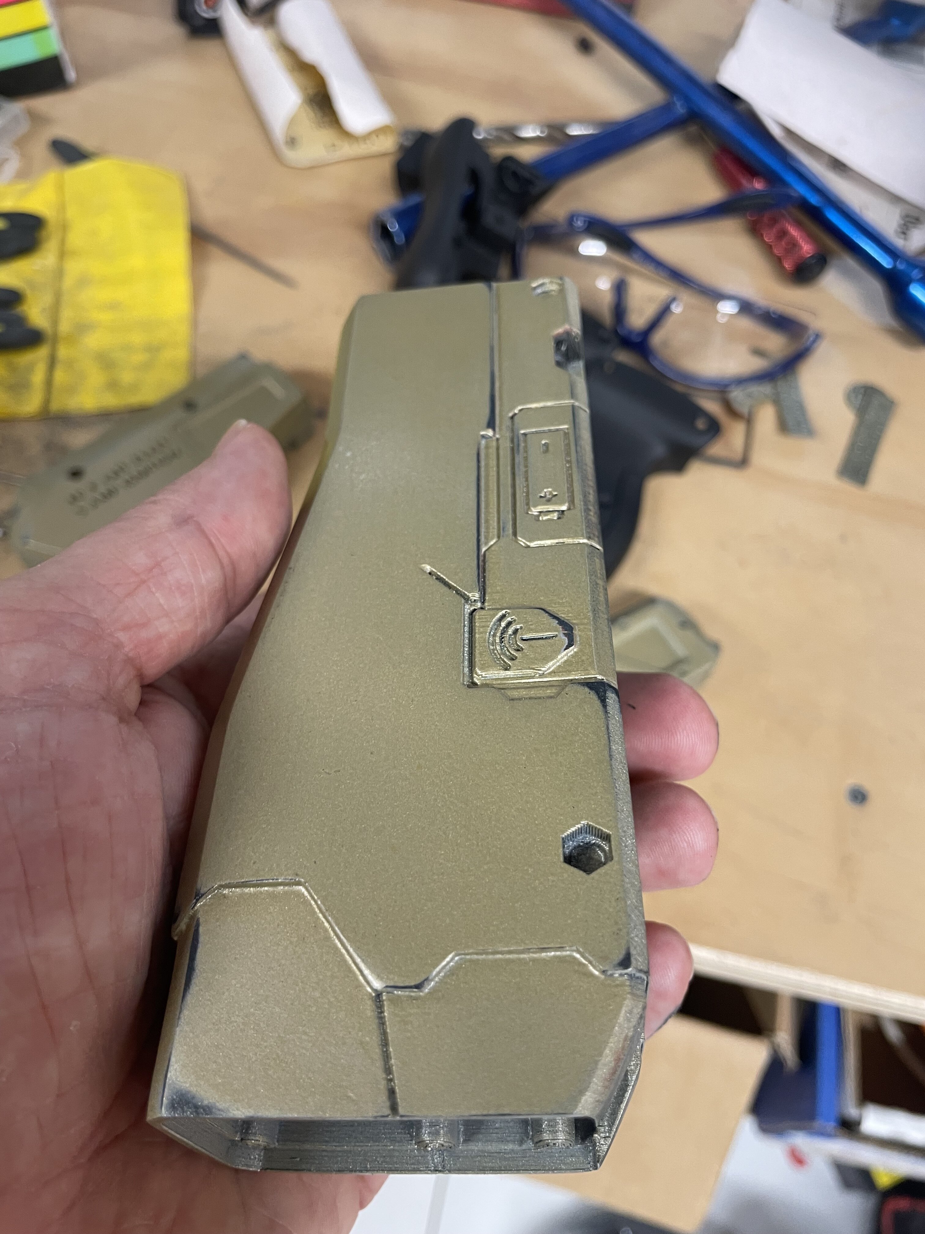

For reference: here are the sanded parts to date, at the time of posting. These from memory were sanded at 600. They still do not feel “hard”
The above are better than a few days back. But I don’t think you could call them cured.
What I’m hoping to do then, is reproduce this. One and the same way I’ve done so far. Second in the same way prep wise but then clear coat with enamel vs whatever (I presume acrylic?) of the original matt clear I had intended. Ah. Yes. The “chalked” one.
