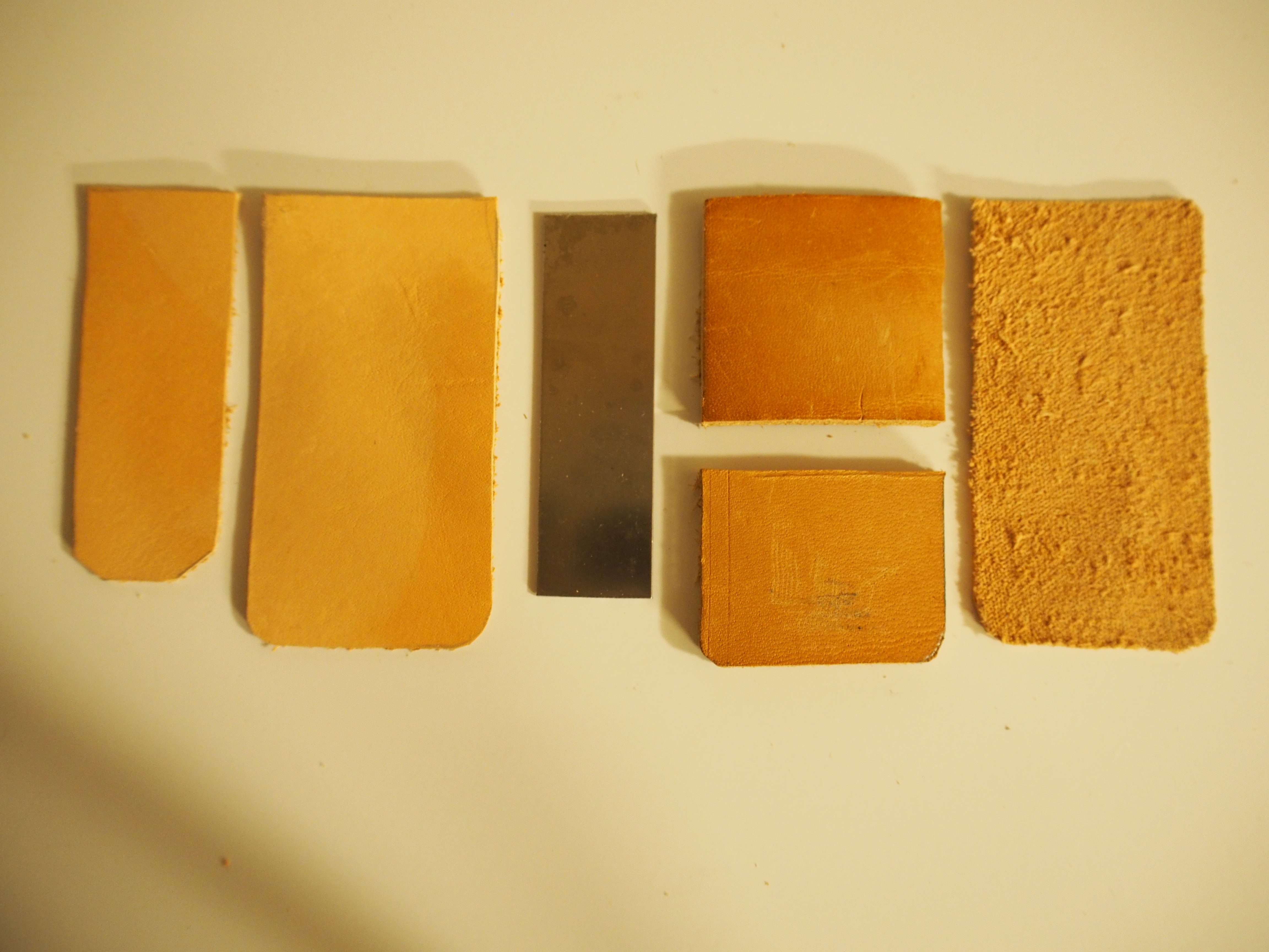

The top stripe (left) is decoration (thin leather 1,3mm). Front also thin leather. Steel spring to provide enough stability. Very thick leather in between ( approx. 4-5mm). The last layer as the front one (perhaps this will only cover the lower part under the headband – since I have found no picture showing the inside of the headband this point is unclear ...

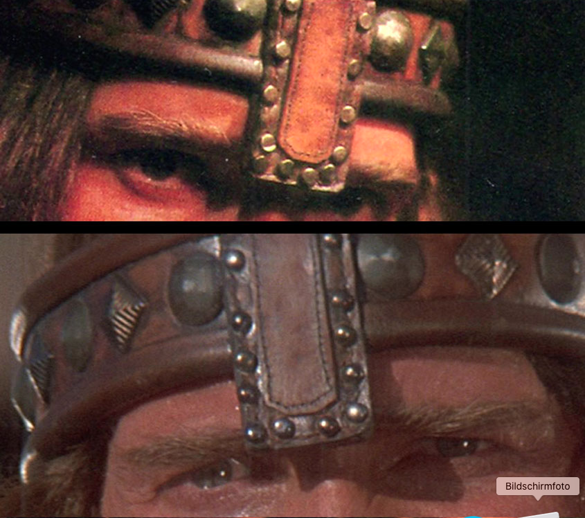

Another interesting point raised by triburito that was discussed in the conan closeups thread Conan closeups?. I hope it is ok to repost one of their great comparison pictures here ...
The nose piece is definitely a different one in both movies. The nails, shape and in particular the stitching on the decoration stripe is different. The build quality of the barbarian nose version is great and matches the band itself (even stitching, nails in optimal position above and underneath the rolled edges). The nose of the destroyer version looks like it was done in a hurry (uneven stitching, two nails go right into the rolled edge) whereas the hadband still has a great quality.
So the question to me: Was only the nose piece replaced or is it a complete rebuild? Why should they replace the nice nose piece from the first movie? Unfortunately I have no idea who build this piece and wheter she or he is still alive to answer these questions.

Some first tries to figure out the details for the main leather part (since there was a lot of discussion about the used technique, I decided to show them and add some info) ...

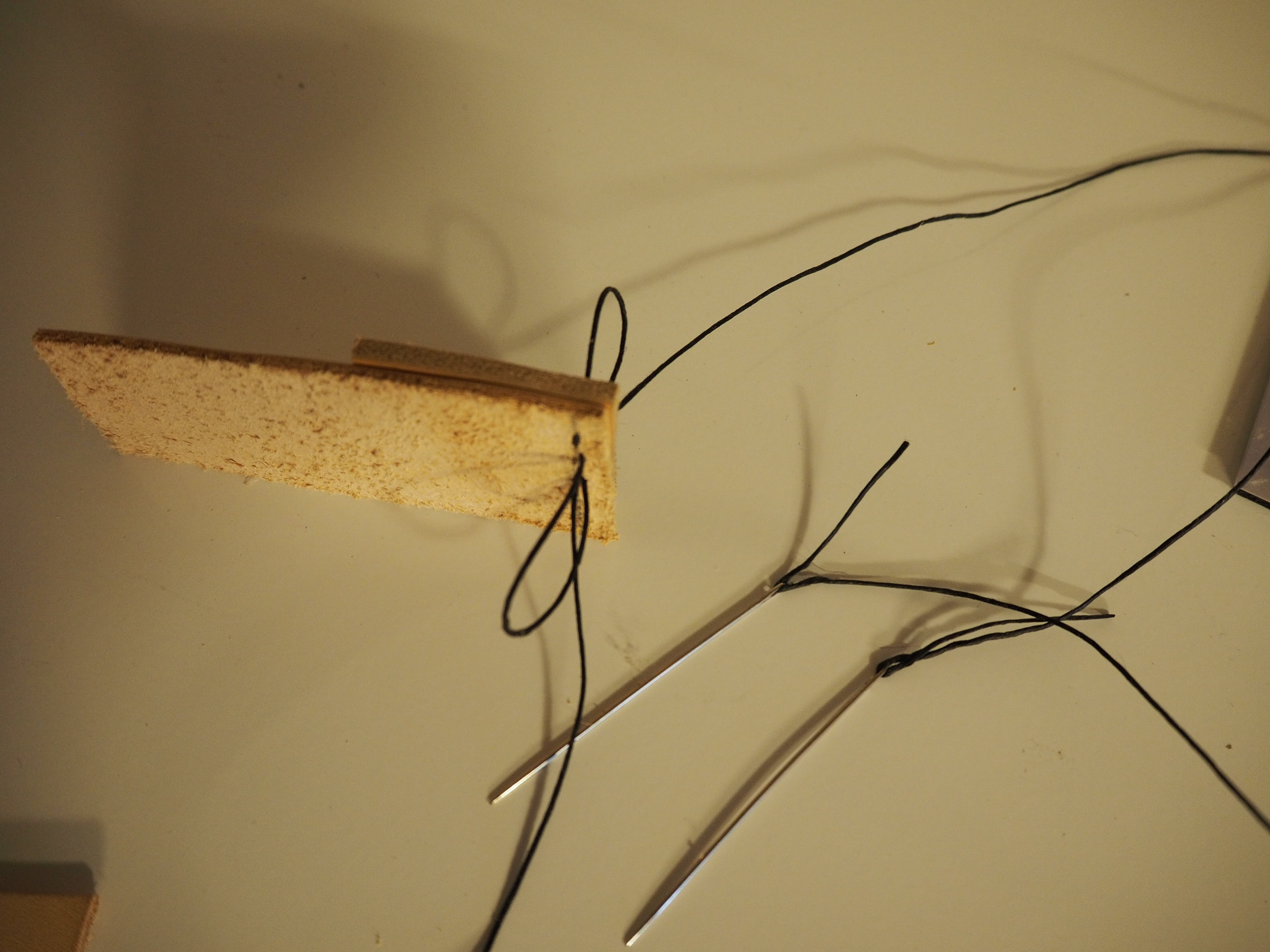

The technique is called "french binding" and a three piece construction. I used it before for my Pirates of the Carribean part one baldric. Here are some example pictures – front and back (four seams, two hidden underneath the envelopes and to visible ones) ...
For Conan we simply skip the two seams that secures the envelope on the backside. This is not as durable because the backside is only glued in place, but otherwise, we would see the seams on the front. Here a quick test (one thick leather part in the middle and two thinner borderparts) ...
Step one: Sew in one border part. Use saddle stitching because this seam has to be very durable.
Step two: Bend it over and simply glue to the backside. Et voilá ... we are done ...
Same on the other side and its finished ...
Comparison with printed 1 to 1 reference shows we are quite close. The borders are 1,5 cm thick. However the complete band has to be 2-3 mm wider. This I have to consider for the final build ...
The tricky thing with this technique that there are several parameters that define the end result. The most important one is the thickness of the used leatherparts, but also the stiffness and the distance of the seams from the borders. Since there is nor rule for that one have to adjust everything to the materials and dimensions ...

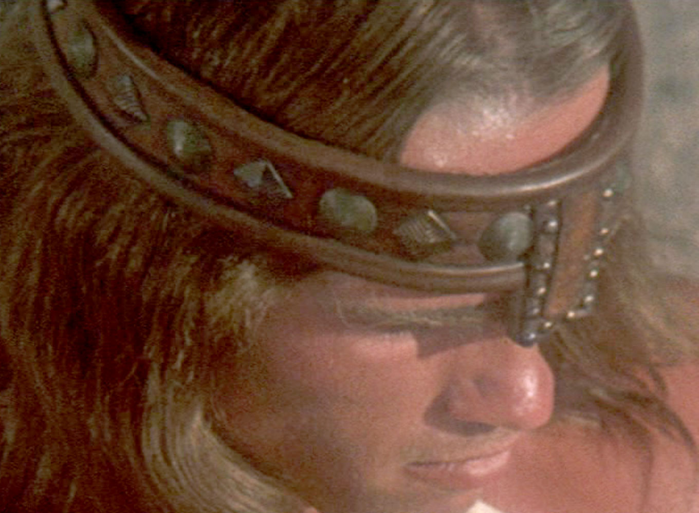

Just looked again for pictures to figure out more details of the destroyer nose piece construction. Thereby I found this shot with 3 characteristic dents in the leather ...
Here again the barbarian version ...
May be its hairsplitting but I would bet its the same hadband. But than again, why was the nose changed (i.p. because it is not easy with the multilayered construction)? We will never know ...

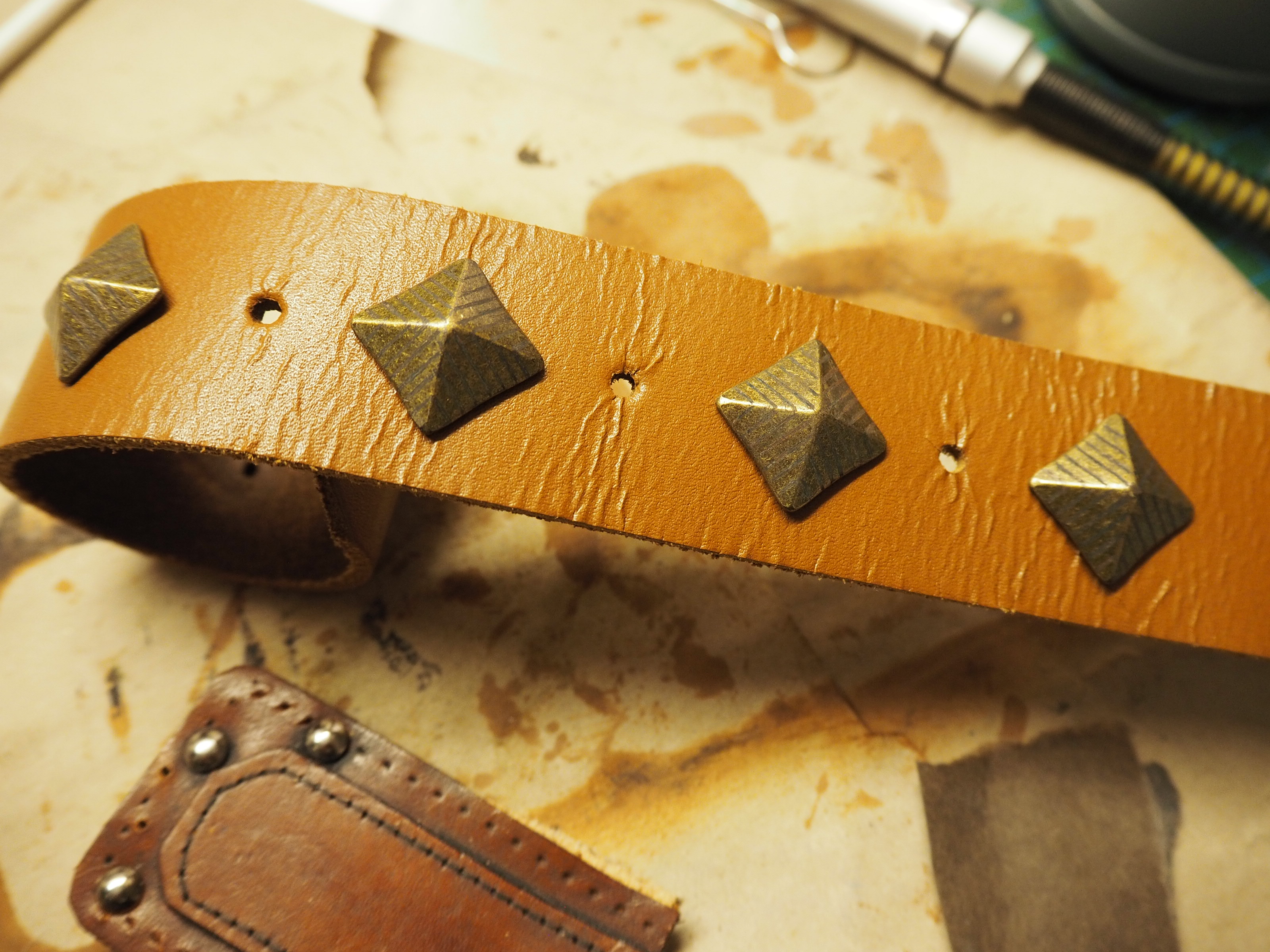

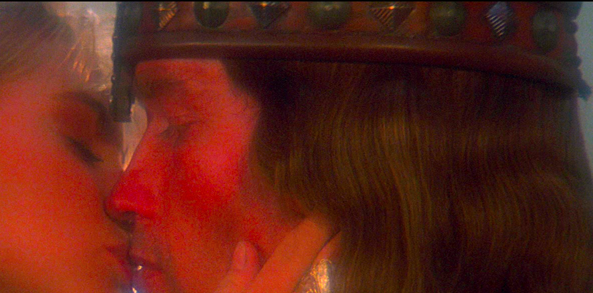

Since I am still desperately waiting for a new batch of leather to proceed, I will further improve the pyramid nails. Thereby I started to ponder wether all of these square nails are gold / brass colored? From some of the images it seems that we have brass and silver colored nails alternating. However I am not sure about this point since it could be also depending on the light direction and reflections ...
Does anyone has further info or opinion about this point?
The bottom pic looks to me like 3 gold in a row, with a 4th silver one. Which makes me think that they are all the same with different lighting like you mentioned. Maybe try taking some pics of yours, trying to mimic the different shading effects. If you can make your identical ones look different in the same shot, I think the movie ones are all the same too.
As suggested I used an old belt to make some quick and dirty shots from different angles. Here alternating brass and silver nails ...
Here with four brass ones (below some first tries concerning aging and attachment of the nose piece and its nails) ...
Two more movie shots with color saturation set to max ...
Think I will go with alternating brass and silver nails – until there is evidence proving I'm wrong ...

I think I have the pyramid nails ready. Here's the final result ...
Machined the grooves deeper in the metal and changed the aging process. This should be pretty close to the original.
