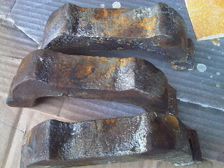

If you want to add some real rust you can pick up a 2 part package at your local craft store. Basically one bottle is a gray paint with iron particles mixed in. When you paint that on it leaves a thin layer of iron on your piece. The second bottle is a liquid solution of something that speeds up oxidation and creates the rust. Check out the link to the bigger photo to really see the texture you can get.
I used it for these pieces.
Link to bigger
Link to bigger 2
Keep in mind what type of materials you're using this one, don't want to run into any unexpected results. Also if you do go this path apply the rusting solution in really light coats. And give it a day or two (or more) to see how the rust really develops. The pieces in these photos are a lot more brown and rusted in some areas after about a week.
