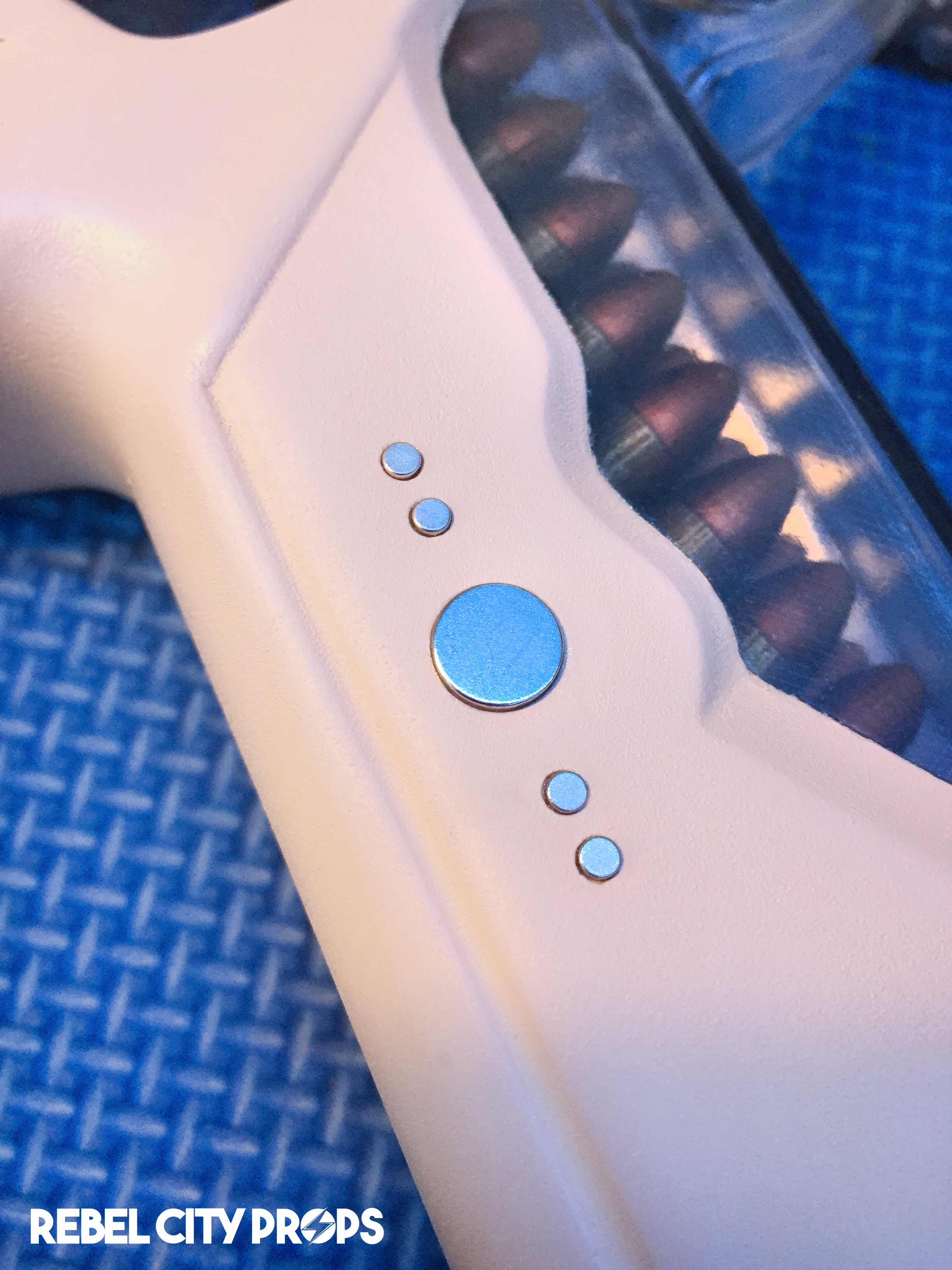

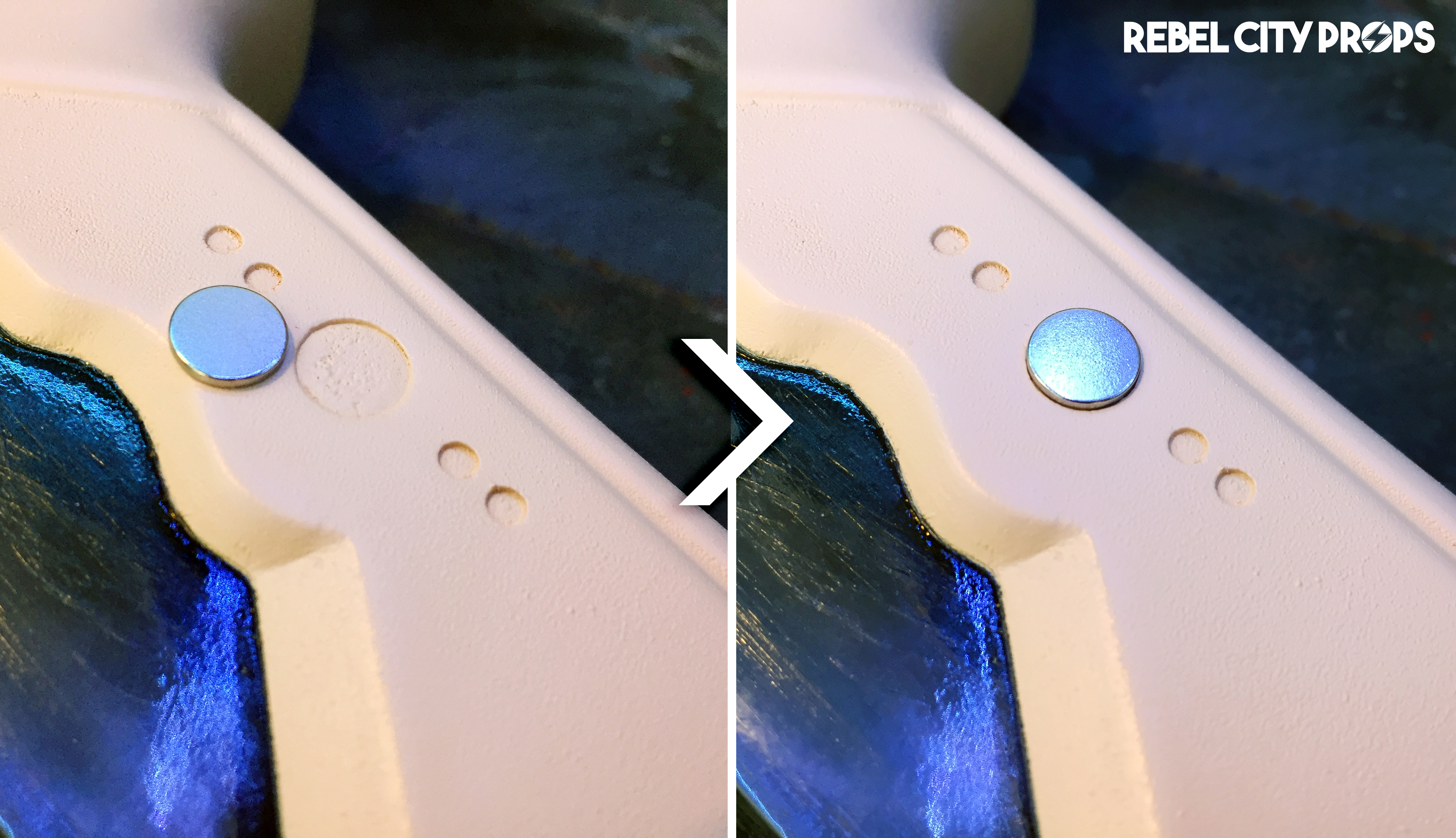

I had bought some magnets to act as catches for the clips (which you will see in the next set of updates) and they just so happened to fit into the larger circle in the pattern row PERFECTLY. So after discovering this and seeing how much better they looked, not to mention more realistic to the original prop, I decided that this was the far better way to go.

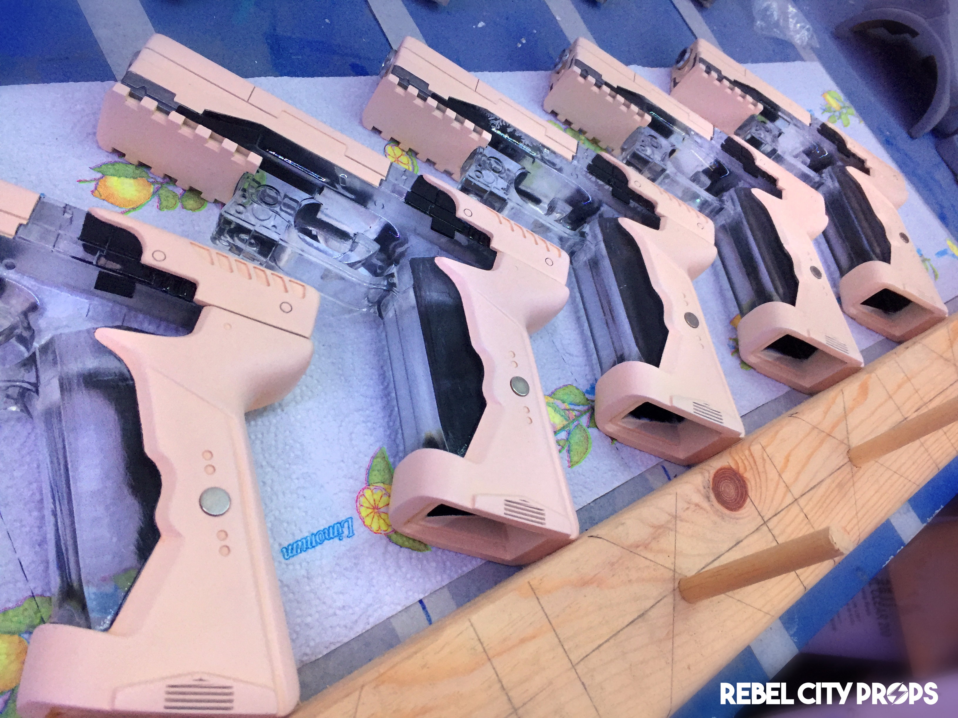

So with that I immediately ordered enough magnets to fit the grip slots and went to work. The larger magnets that I'd bought previously were easy to reorder, the biggest problem came with the smaller ones. The smallest holes are 2.5mm in diameter, and the magnets I needed only come in 2mm or 3mm configurations. Now added to that they had to be 1mm thick to match the larger magnets and this made them even harder to locate. After looking everywhere i possibly could, I found 1 company in the states that sold these magnets (in bulk) in the exact 2.5 x 1mm configuration I needed. So knowing i would basically have to wait for international shipping I got to work on at least gluing in the lager magnets to the grips.
Finally, after what felt like forever, the small magnets arrived, honestly i know the measurements, but still couldn't believe how small these things are. So, I set to work getting these affixed to the grips.

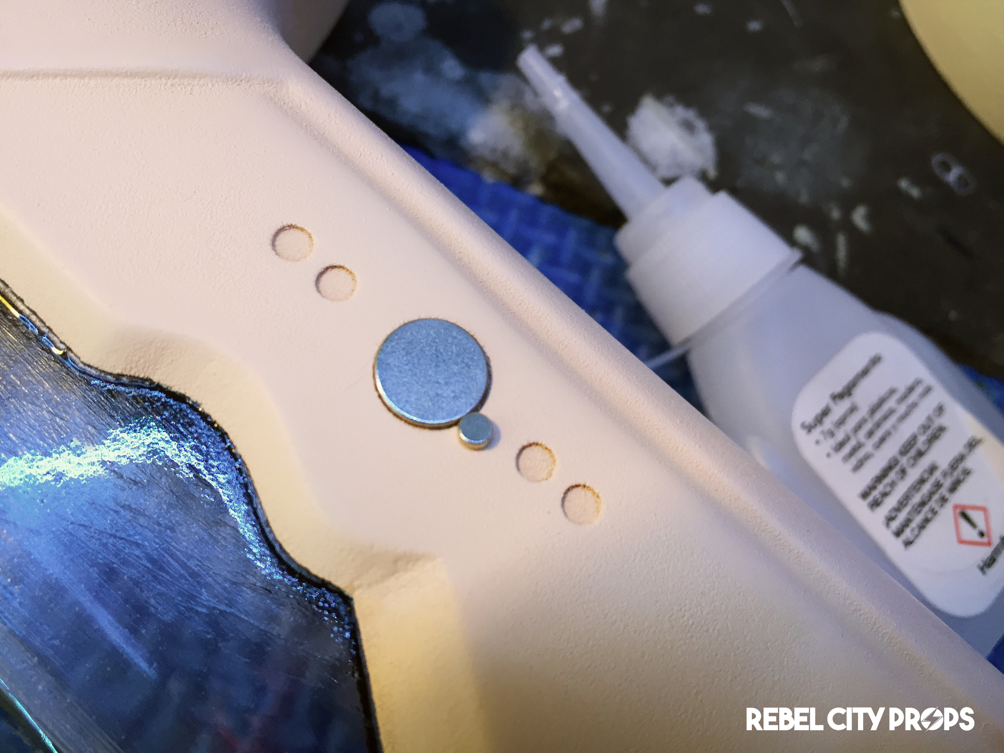

It was here I came across my first mistake, by gluing in the larger magnets first I had something there that had a stronger pull than the small magnets. So every time I simply tried to glue on in place it would ping out of its slot. Not a good start, Note to future self not to do that again.

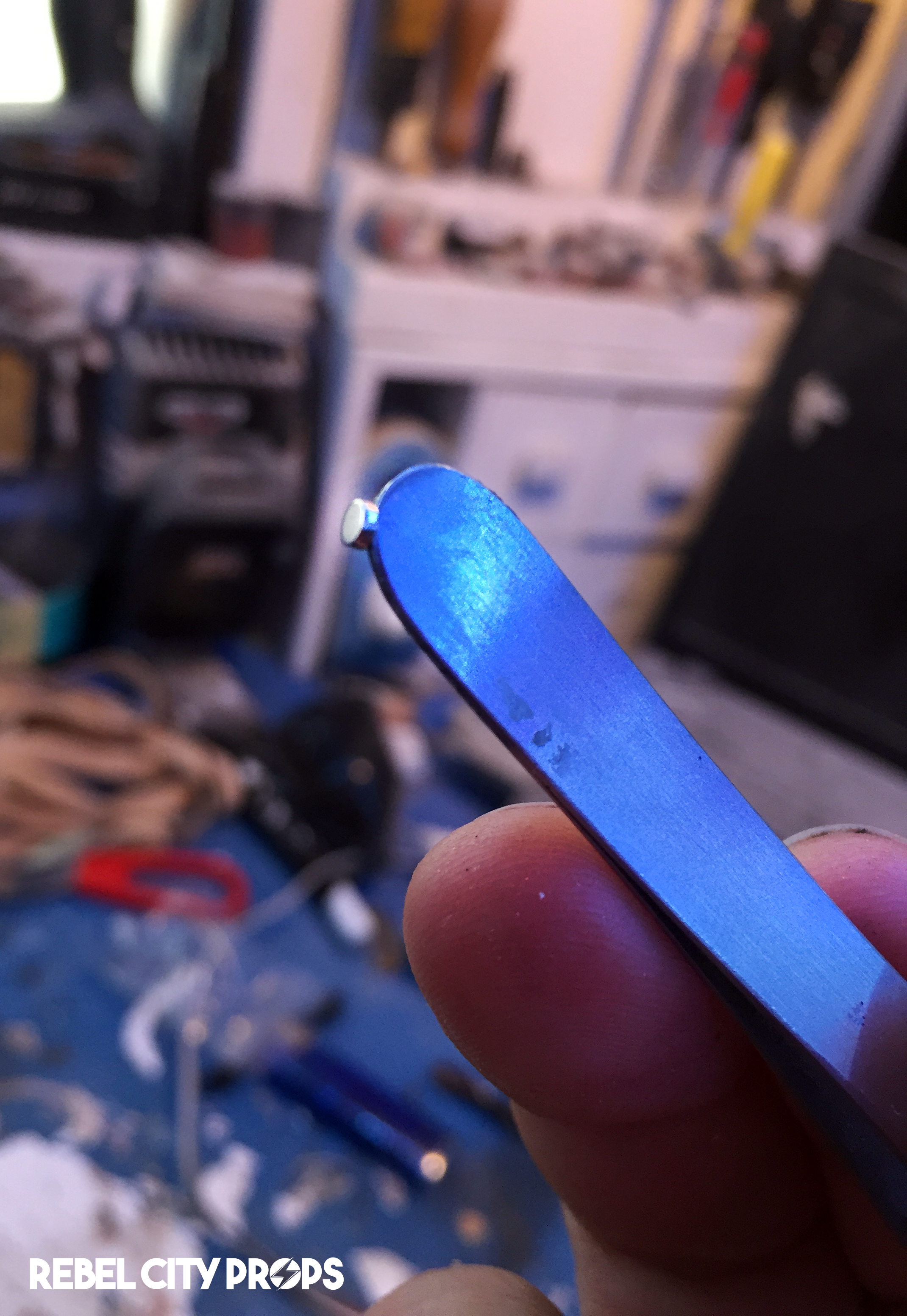

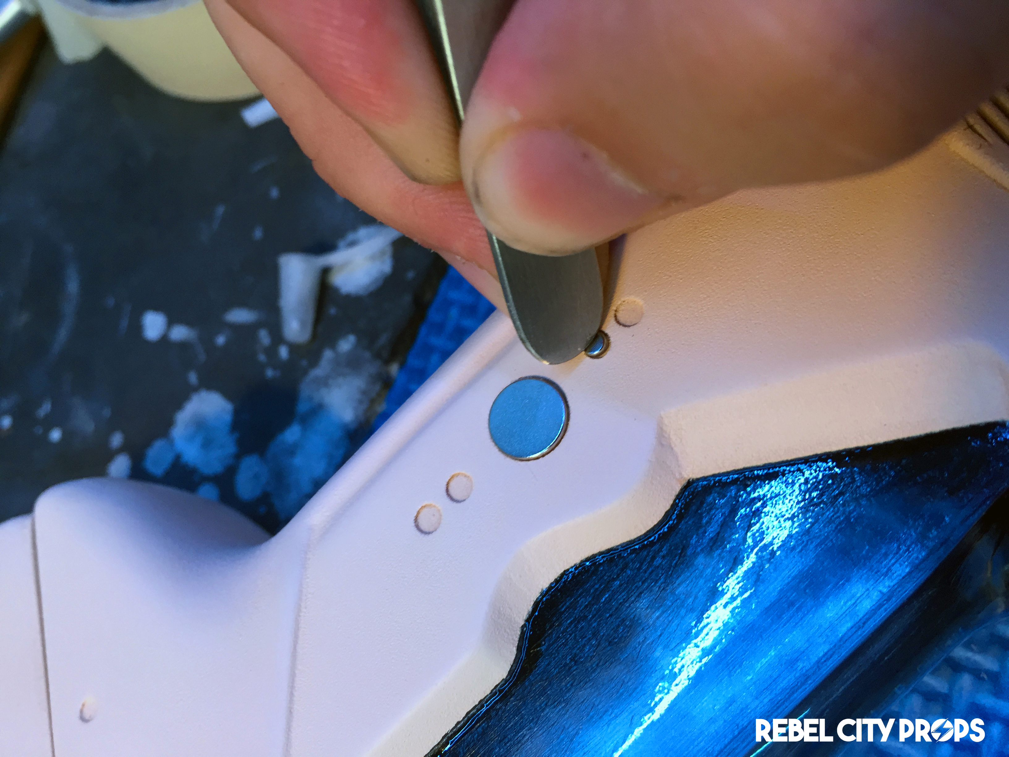

As they kept pinging out of my fingers I decided to place them on the smooth end of my needle pliers to give me a bit of control. Since the small magnet was attracted to these rather than the other magnets it at least gave me enough time to place each one without the risk of it coming loose in my fingers.
But because of the pull of the lager magnet, if I did not keep the pressure on until the glue set, it would just come loose when the pliers were removed. Also, because I was worried that these small magnets would be pulled out of place after the fact by using just normal super glue, I decided to use a 2 part epoxy instead to ensure they stayed in place. Which means I had to hold each and every one in place until the epoxy set... 4 magnets per side, 8 per gun, 11 guns... you get the idea...
So after all of that slow slow work, the finally started to come together and I am so so happy I decided to go down this route for these detail parts, even if the small magnets took a while to arrive and were difficult to locate in the first place.. They look far more realistic, they have that shimmer to them that only real metal can give you and they will be far more durable.
