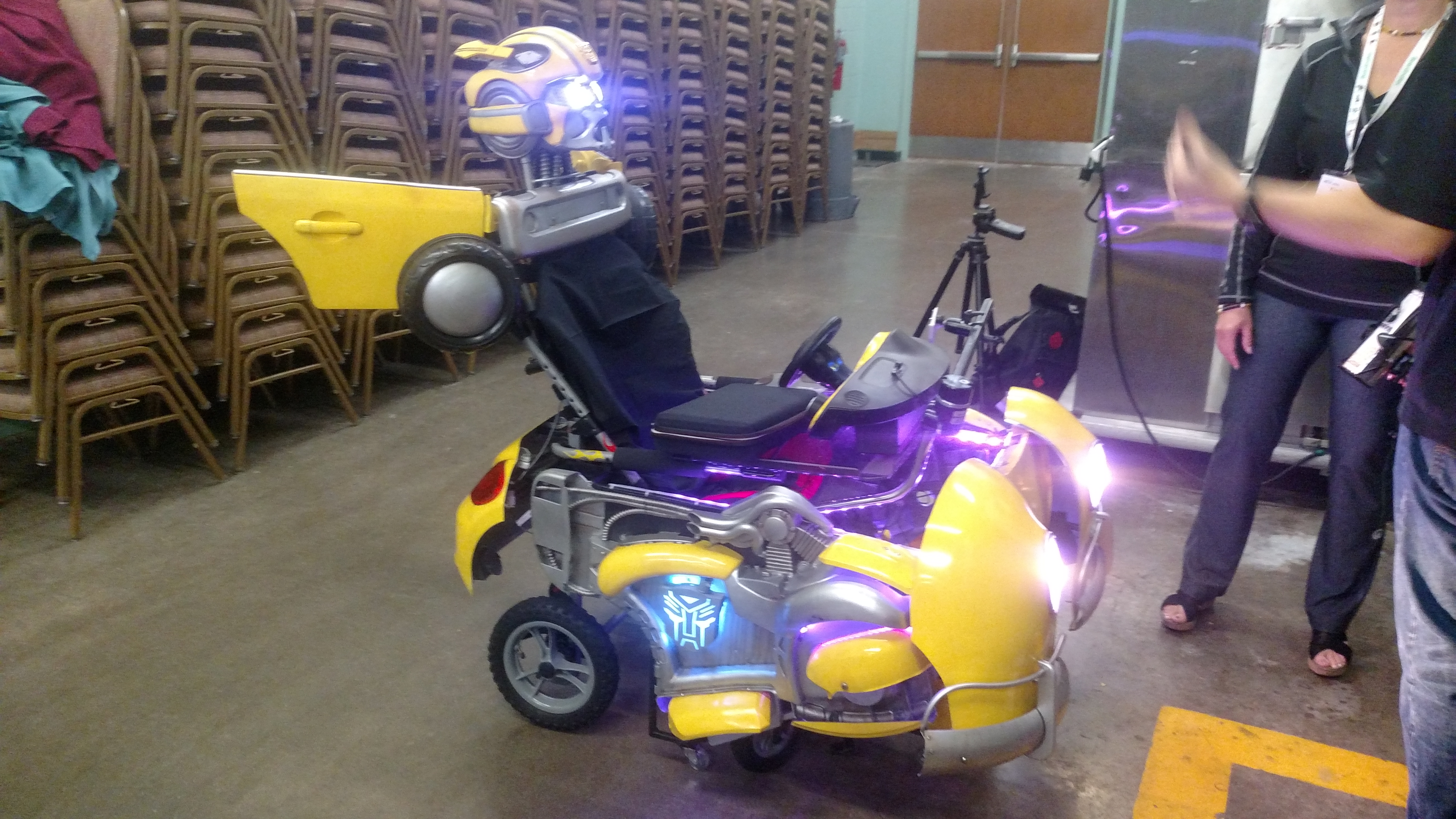

Here are a couple of pictures of the Bumblebee head, chair, and Alex and I together.

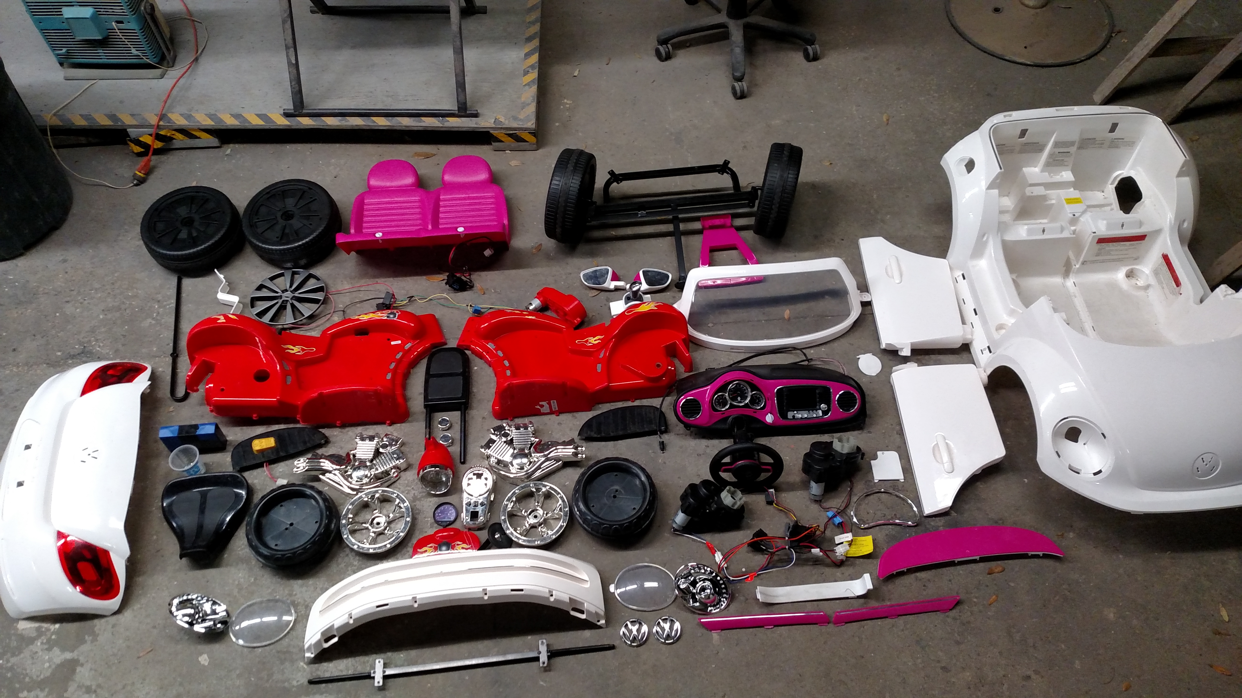

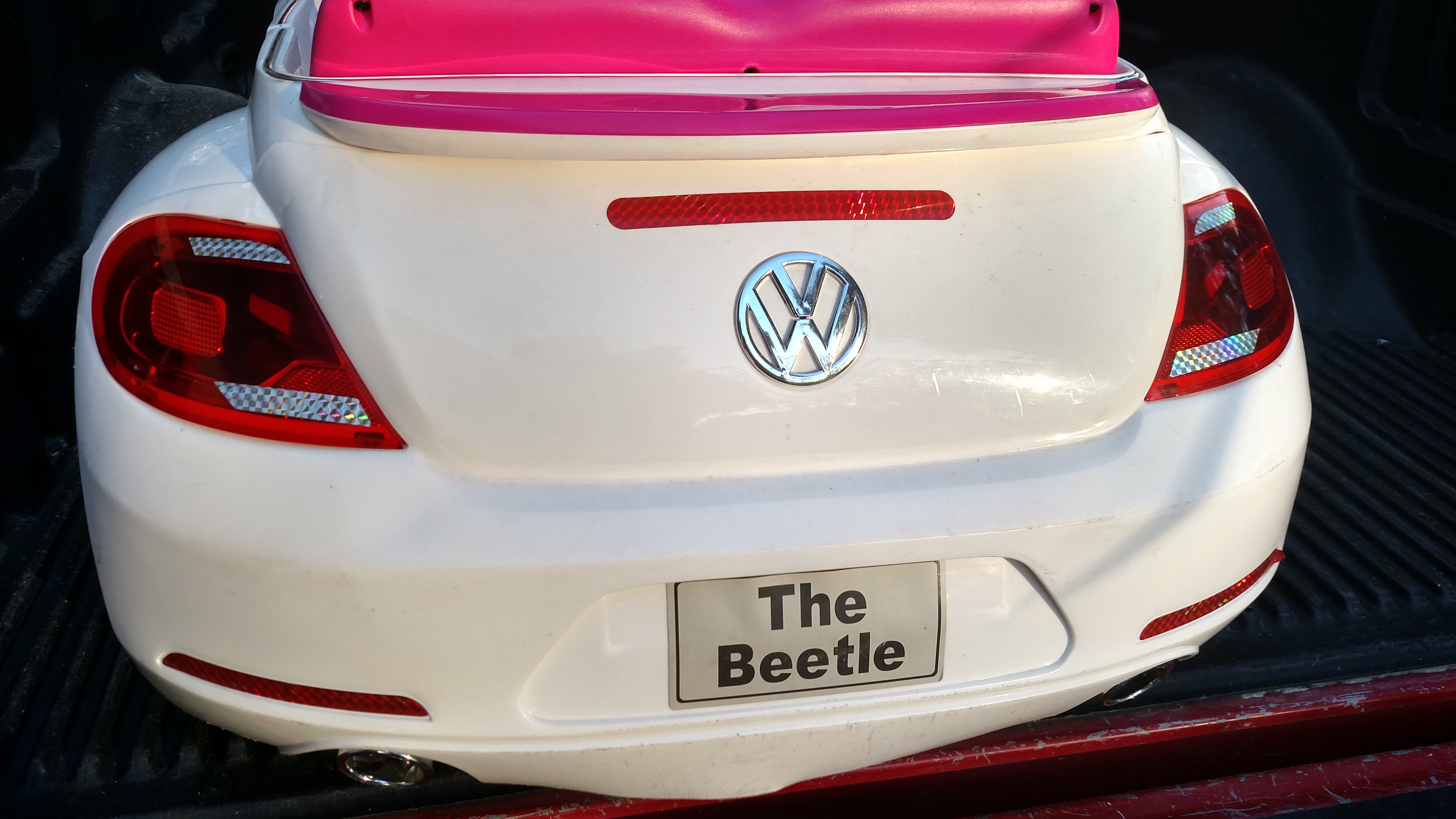

I knew that with the tight time-frame, the best bet was to try to use as much existing things as possible and basically kit-bash as much as possible. So I purchased, got donated, and scrounged several power wheels. You can see the raw elements in the pictures.
I made the hood sections by using the front and back hood off a power wheels. I then cut out a shape using some expanded PVC sheeting (Sintra) and I glued and screwed it on. I didn't have time to do any body filling.

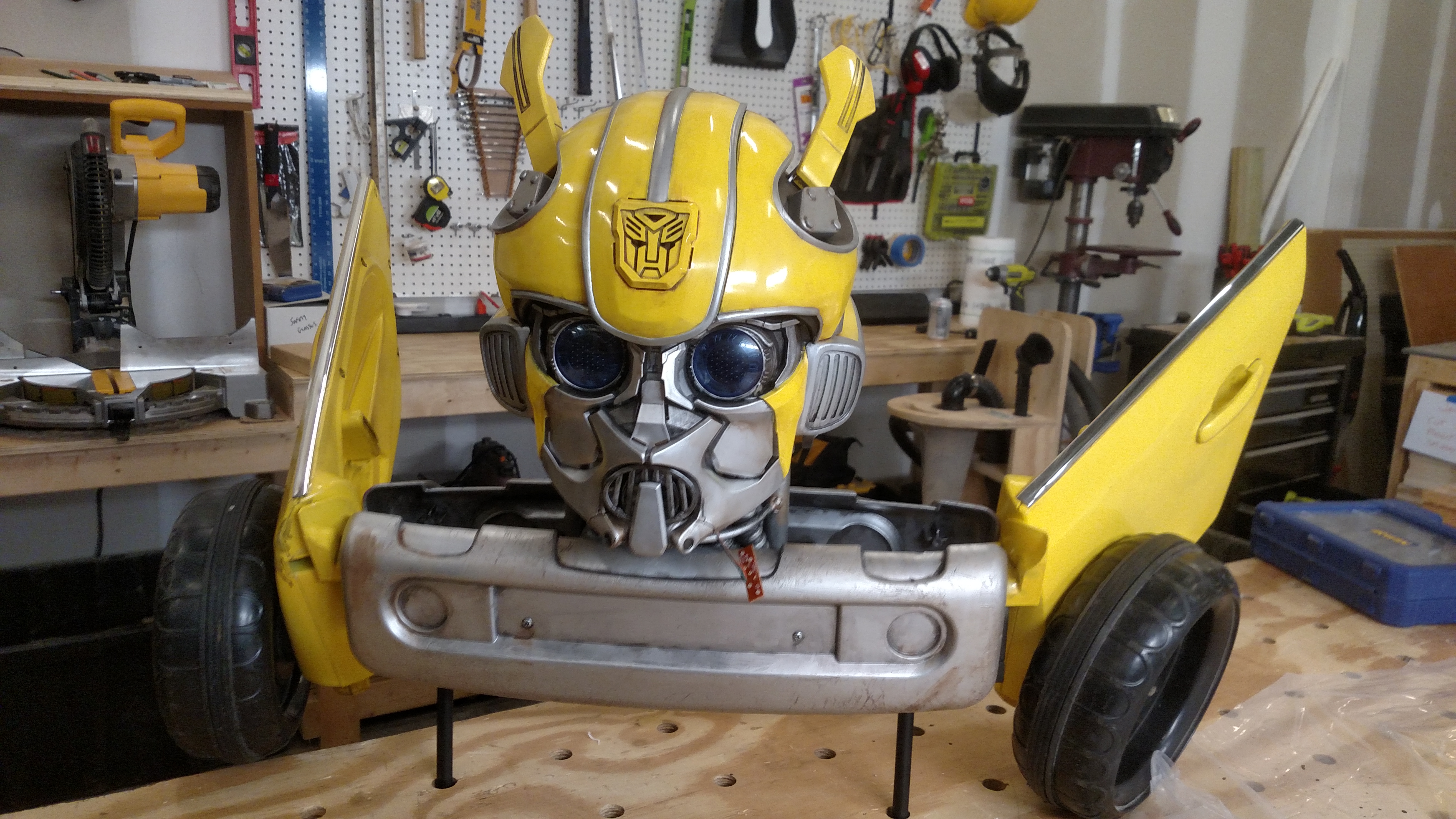

Once I had the start of the form I knew that I could make some modifications to give the hood the classic VW Bug look and I would have to sculpt the fenders from scratch.
I sculpted the fenders from styrofoam.
I didn't have time to plan out things so I free-handed the design and sculpt. I coated the foam in aluminum foil, then several layers of epoxy resin (Epsilon) and fiberglass cloth.
I then carved out all the foam to get the shell parts. I then sanded and sprayed with a high fill primer, and sanded again.
I did a little bit of spot putty for some tiny air bubbles.
I fabricated the bumpers out of a bicycle fender cut into parts, some copper pipe bent to shape and pop-riveted on, and some pieces of 1/2" thick sheet plastic (PVC) cut, routed, and sanded to shape.
I then primed the parts with two to three coats of white primer and then two coats of yellow.

But it was a fun character to try and capture the essence of in a costume like this. I got a video from Alex's mother showing he was hanging out in it all the next day playing with the buttons and piano.
