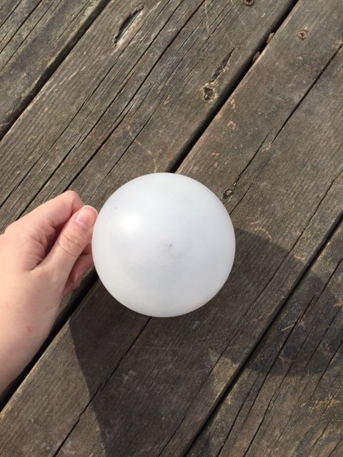

Orb (done)- plastic fillable ornament sprayed with frosted glass paint and has red LED lights in it.

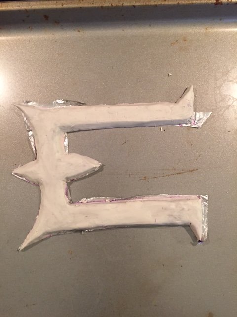

The belt buckle that I sculpted in sculpey:

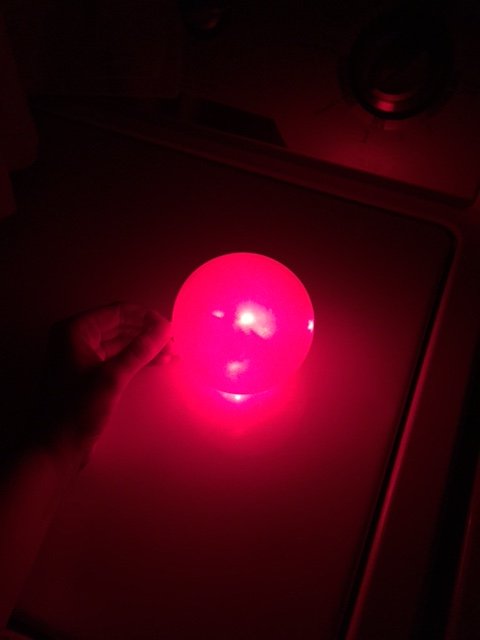

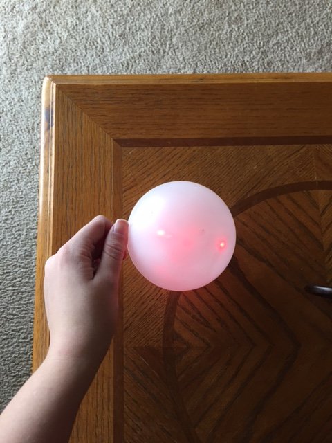

The orb with the LED lights in it, ranging from different lighting situations (outside in sunlight to inside to in my dark laundry room:

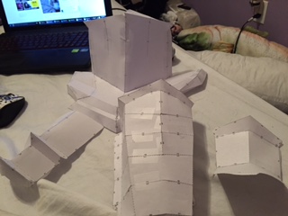

Anyways, so I was getting frustrated with drafting patterns for the armor (I'm really bad at making straight lines n such so one corner might have been the proper angle while the opposite would be a completely different angle) and I actually found a set of pepakura files for the armor (something that I had been searching for for MONTHS). IDK how recently they had been made up but they look fantastic and I mocked up all the pieces using plain computer paper and was really pleased with the result. Although, I am not going to pep out the gauntlet since those pieces are WAY too complicated and ridiculous.

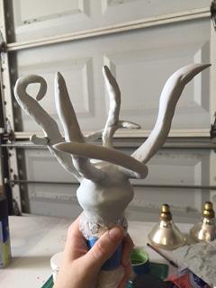

I've also worked on the top of the staff. I finished scultping and sanding and bondo-ed the top weird branch thing and it looks pretty cool! I glued it on to the staff and then blended the edges in with MORE apoxie sclupt. I then painted it white just to get a look at any more areas that need attention but I think it's ready for brown paint.
As you can see from the pre-sanded to the final photo, I removed the weird curly piece because it just didn't look right. I'm also not going to cut it in half like I originally planned for transportation since the vehicles that are up for discussion for this con adventure do have large trunks and can fit. It'd be more of something I'll look into if I ever plan on flying with this cosplay.
