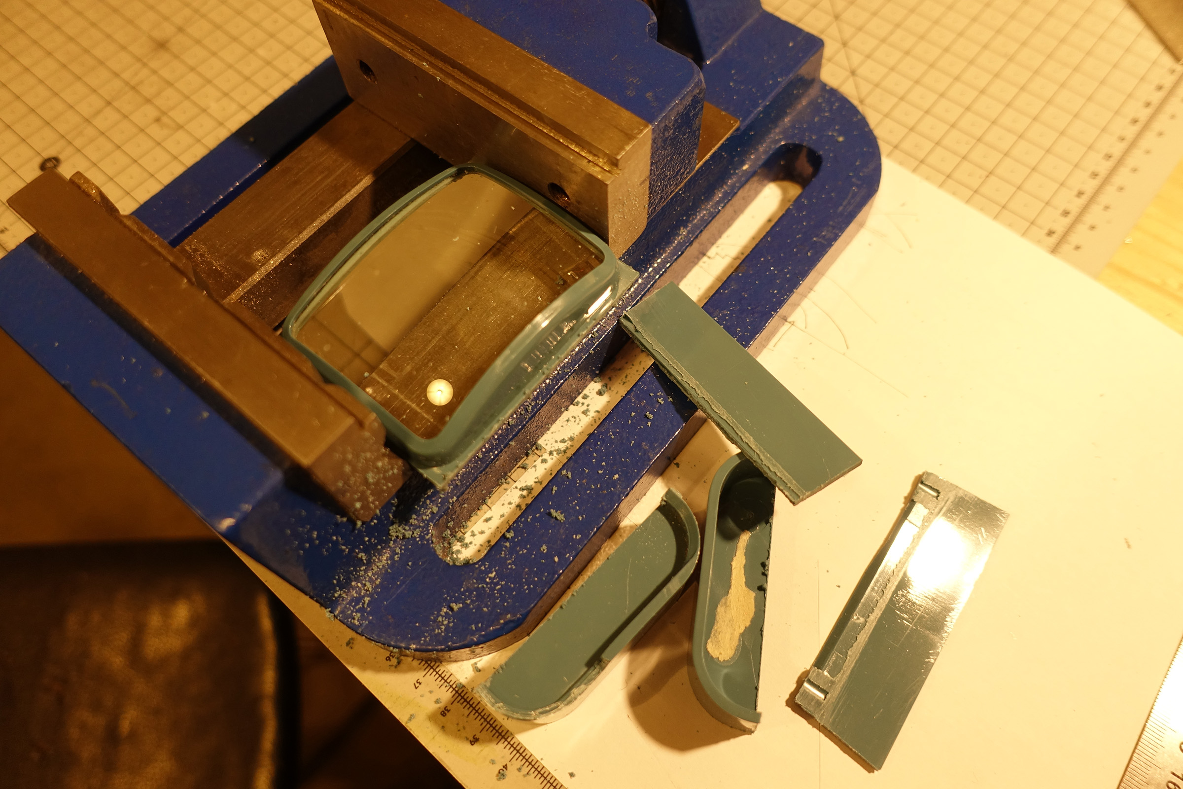

I don't remember if I posted that already, at least I didn't here, I experimented a bit with a viscount viewer I had laying around last time I worked on my macros, I haven't finished it yet, and it's not a perfect fit, so I'm not saying to go for it if you don't have access to good tools, but the viscount glass is roughtly the same size as the transition box, the Kalimar hood and a good fit for the printed transparent that Tatooine machines sells and it makes for a potential fun vintage screen for the macros:
but yeah, cut like so, it's still not a perfect fit for the transition box. It could work though!
cheers
Great idea, viscounts are pretty cheap, for a moment I thought you’d used a trident!
I wonder how it would fit without the plastic, or if there is a different slide viewer out there that would fit better like the royal or manaview?
