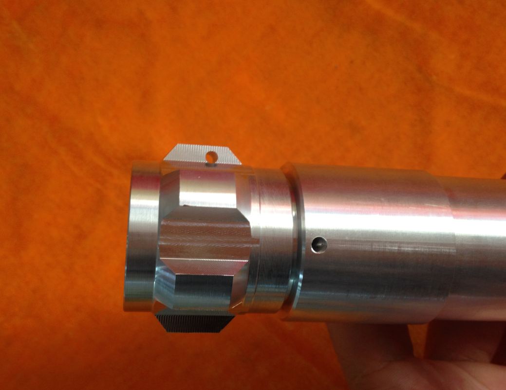

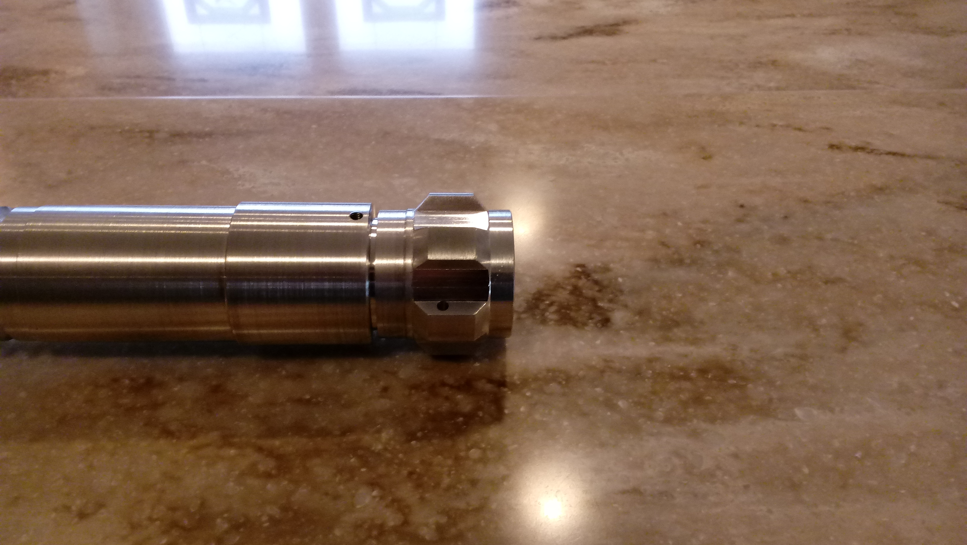

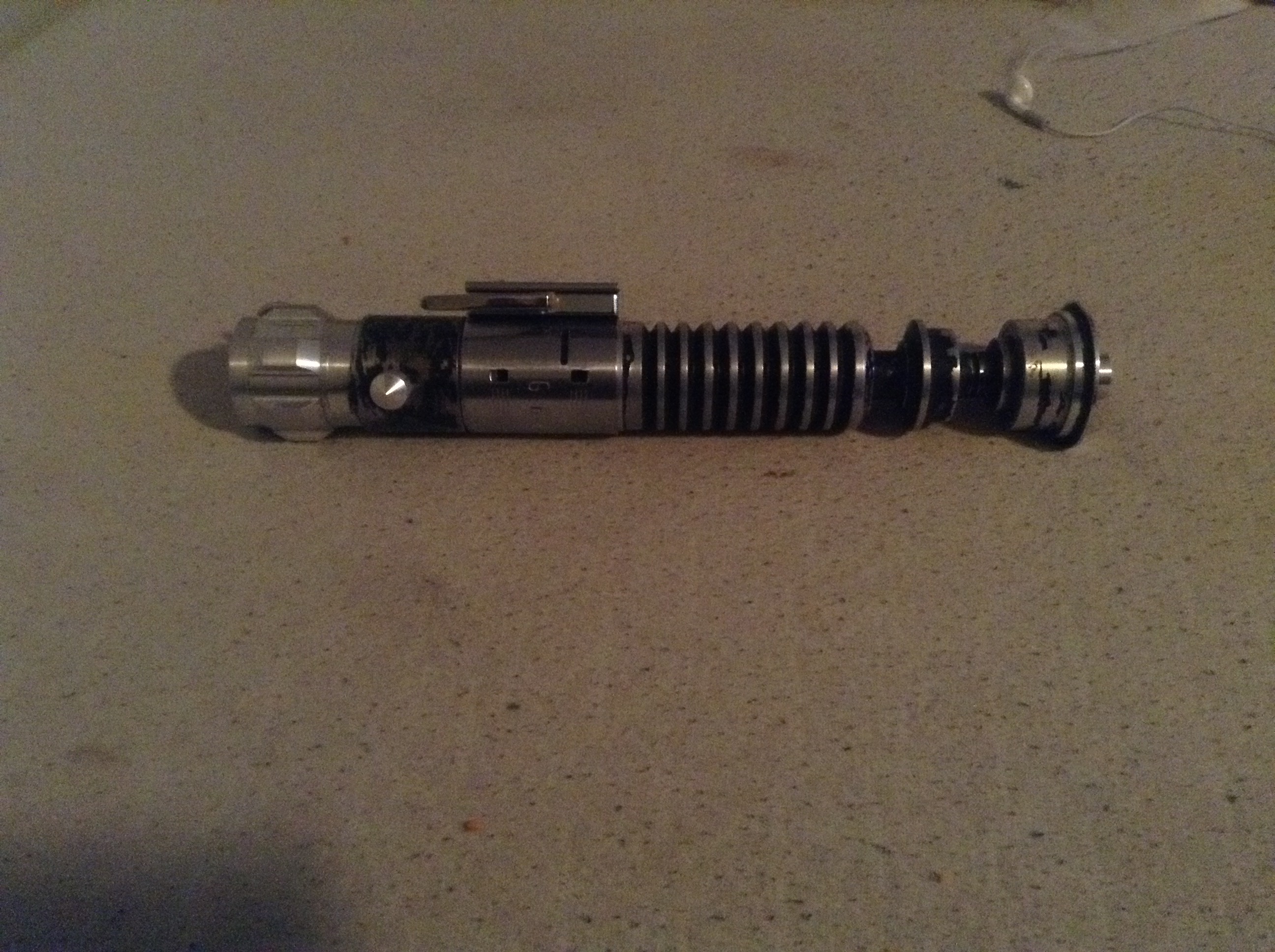

So, the sabers arrived. But there are a couple small things that need to be corrected. I plan to take the sabers to my shop this week and complete the work.
The step down after the pommel cubes, before the booster section, was not as deep as it needed to be, so the pommel recesses left a small mark. I need to put these on a lathe and skim that area, taking off a few thousands of an inch to correct the dimensions. I'm gonna work on that Monday night.

Your attention and dedication to detail is what keeps you on top! Thanks for being anal, I love it as well as appreciate it:thumbsup

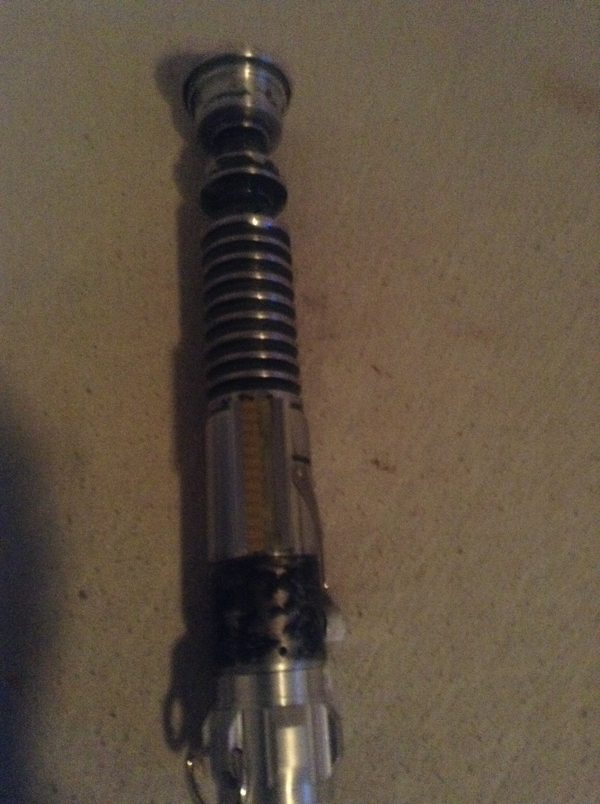

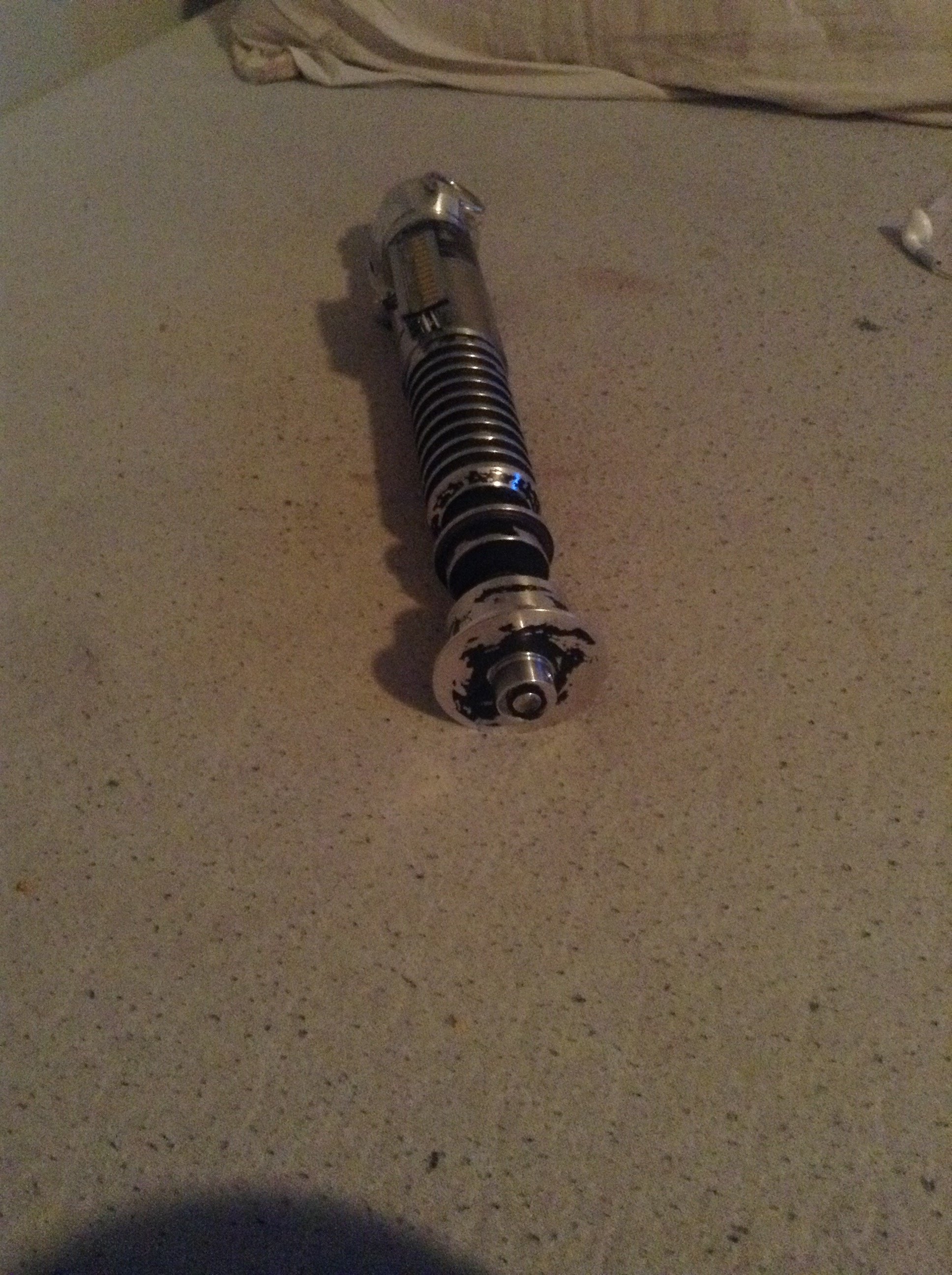

What I do for a v2 is paint everything with flat black spray paint, and then try to make the weathering look as natural as possible using my fingernail, knife, etc. Sometimes I even rolled it around on concrete haha. For the booster, before I add the spray paint, I use aluminum black to darken the metal and give it that kind of oxidized look. This was the result on my SH v2 and I'm planning attempting the same thing on my Starkiller v2.

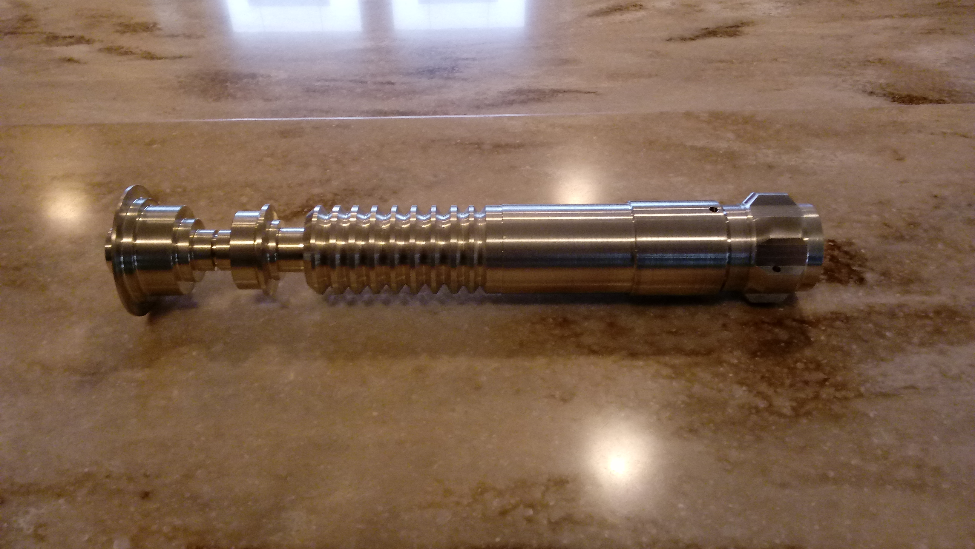

View attachment 703765View attachment 703766View attachment 703767View attachment 703768
so sexy :$
