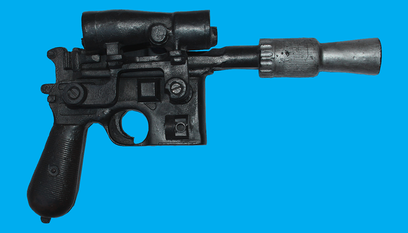

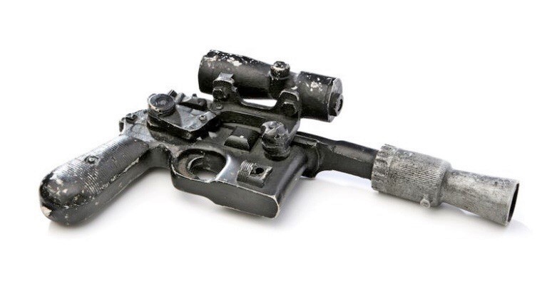

Here are some more pics of the real stunt weapon, someone will find and appreciate it someday. :) Apologies if I'm hijacking your thread genZOD , your blaster is great!
And the "other one" that's in much better shape.
These pictures really are fantastic! I wish that I had them when I was building mine! I have always loved looking at behind the scenes images & videos. My goal isn't to recreate the filming props, but to recreate fictional items--if That makes any sense. I get a kick out of holding something that looks like it IS a blaster (or whatever). That said, I definitely appreciate the effort it takes to make faithful copies of props & a would 100% lose my mind if someone let me touch a real filming prop...

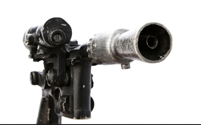

Indeed! I'm sure that they had to stuff the tip of the flash hider to cast it. I'm assuming that this was the real barrel since it's cast from the ANH hero, and they clayed up the inside of the suppressor before molding (hence the dimples left over from the holes on the original).
oh man, idk how I missed this. That can't be the original barrel because the bull barrel ends inside the flash hider. If you look at the disassembled gun in other movies you can see the original skinny barrel is gone and this chunky thing has a flat muzzle

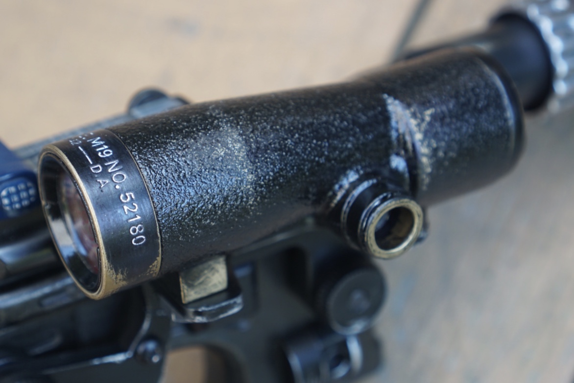

Yea, not to get side tracked, I noticed the pistons are heavily thinned before being glued to the master and the gun cast includes the welded nuts for the original scope mount in ANH
Oh man, how did I not notice this?? When I built mine I found that the pistons didn't look right on the Lytle C96 I used (which is noticeably smaller than the Denix or MGC), just too big. So I scaled them down, thinking that the Lytle cast is just smaller. But I'll bet that the majority of what was "off" is exactly what you're pointing out, they're shortened by sanding the back quite a bit! Gonna try that and see how they look...good eye sir!
I definitely noticed they didn't look right when I made mine... means I'm not 100% happy but thats an excuse to build another :D
Anyway, thank you! The nuts are casts of the Bespin knob. I've always been tempted to try out the theory that they cut a bespin bracket to make the S shape. Weird thing though, the bracket is THICK vertically, and less so on the platform. Maybe they built up the original with clay to thicken a mold of it? I wonder what scottjua thinks with his familiarity with the hero guns. I wish we could see underneath the bracket more too, we'd be able to see where they tac welded the threaded nuts for the ANH Hero.
