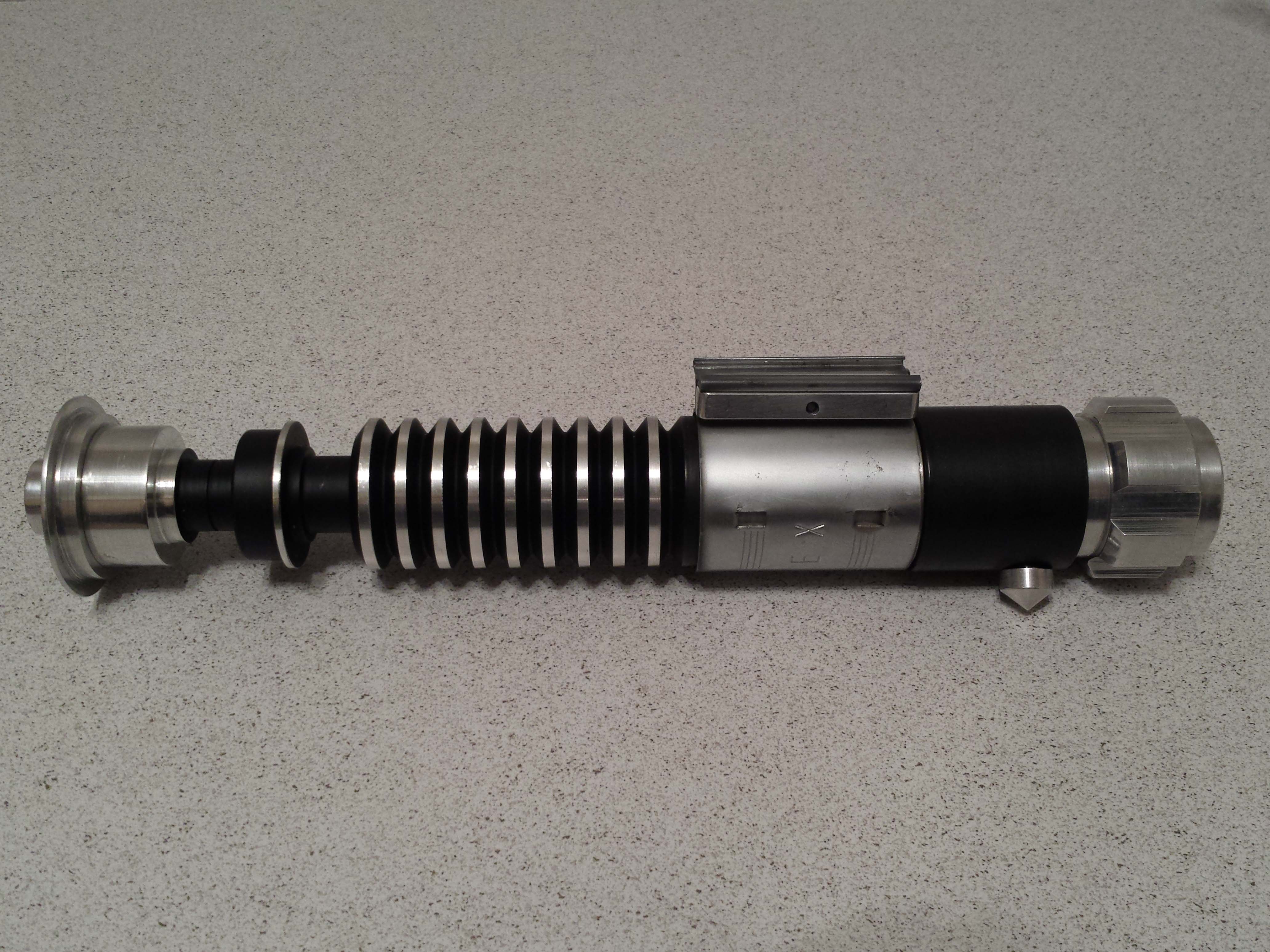

We don't know the cone knob, right? I'm struggling to think of a practical reason to have a cone shaped knurled screw on any machine at all--where could this have come from?! I can't say that I've ever seen a pointy screw/bolt/etc. Weird.
The cone knob didn't come from the record player that supplied the Imperial disc greeblies? I thought I read somewhere that it did.
Yep. Top plate nuts. Transcriptors are now selling modern machined replacements on their website. Think they're listed as motor cover nuts.
The unknurled version was used on C3P0's chest.

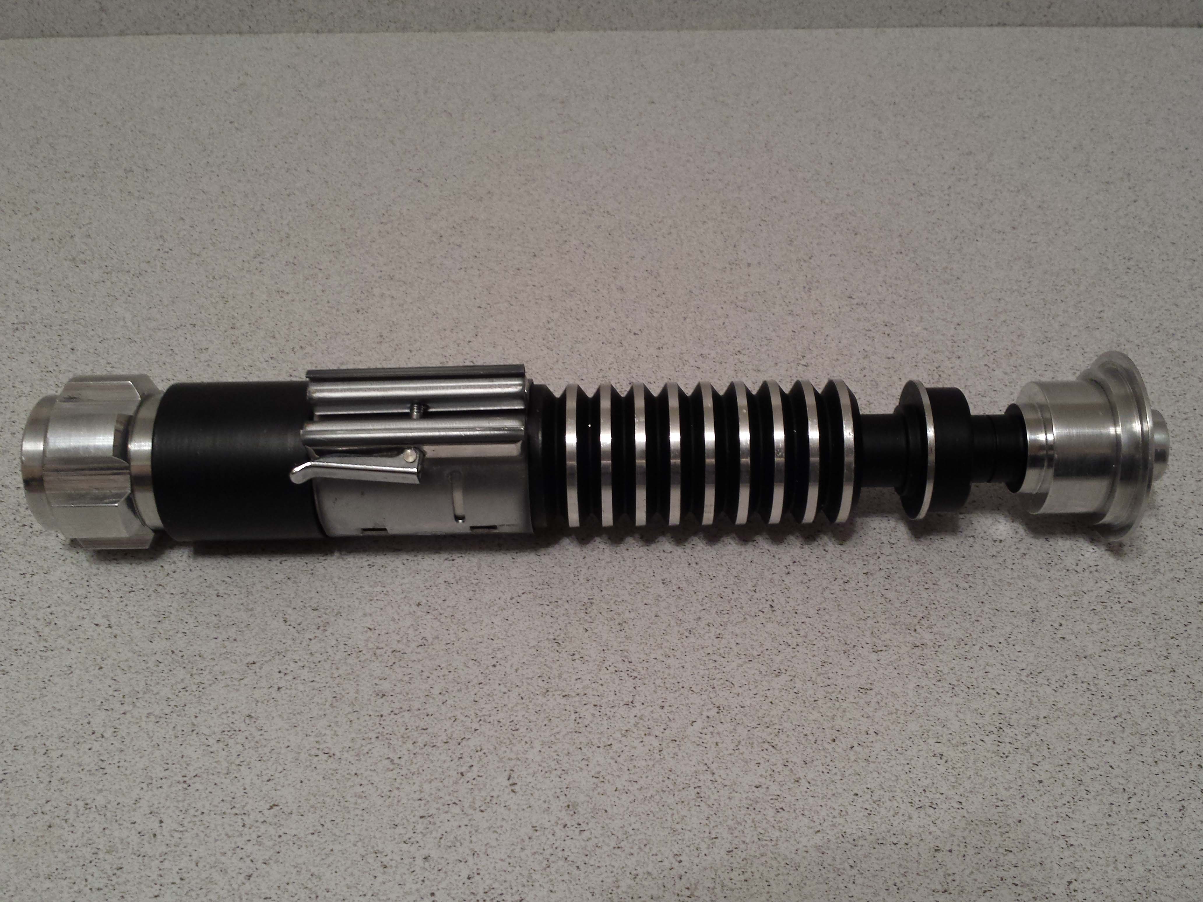

Looks a lot like mine ... except my cubes on the pommel are a bit more square on top ... I do reckognize that replica G R A F L E X clamp ... sorry I don't know the maker ... could use a D-ring as well and some weathering if you want the look of the V2 today ... I left mine as the AFB by Obi-Wan though :)
Chaim
I'm not sure who made yours, like Sym-Cha said, it looks kinda like his.

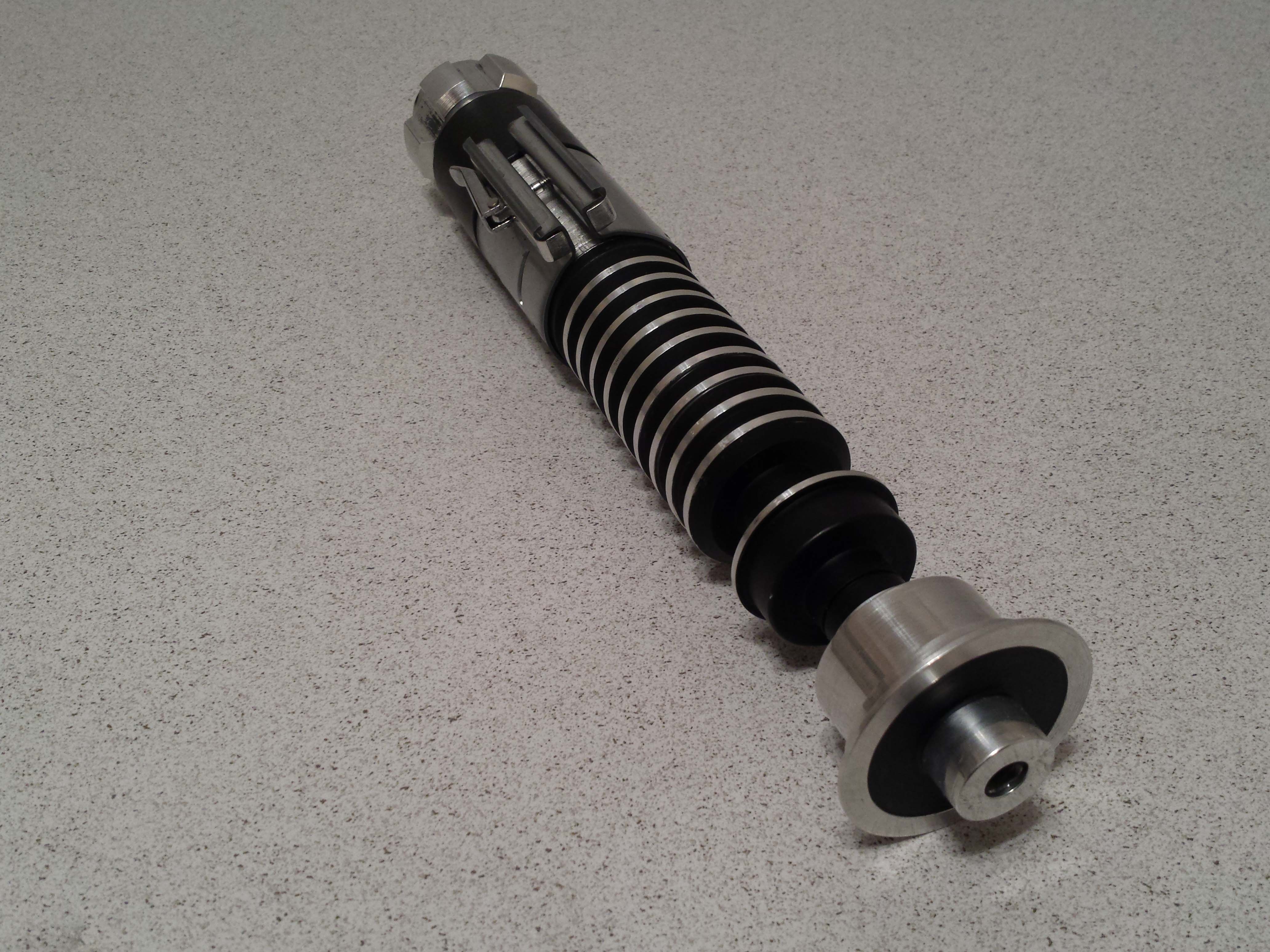

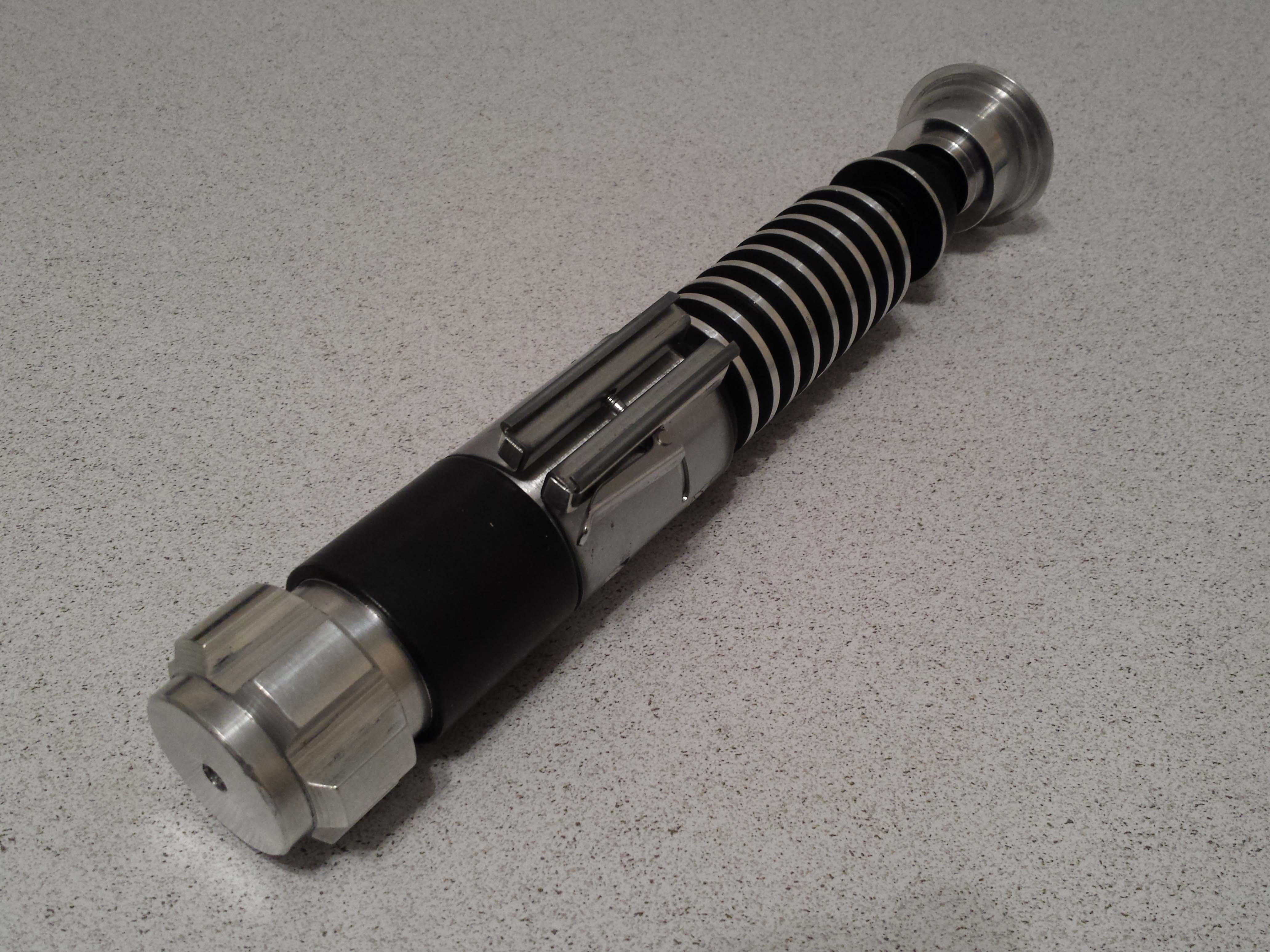

Well, thanks to that presentation at Celebration and the photos posted here, I tried to update my RussRep as much as I could, until a better circuit board and lever come along.
Here it is, with the things I changed circled!
I added the set screw holding a piece of rod in the emitter, put some gaffers tape on the top half of the neck, replaced the one block from the graflex clamp with a square nut I made myself from 1/8" thick aluminum and put that other set screw further down on the hilt below the clamp. I'd still like to replace the lever and circuit board, as well as my fillister screw behind the conical knob once what its supposed to be is identified. I always love when reference like this comes out, because then I get to revisit props I thought I was done with!
Anyway, here's a few more photos, for prosperity.
