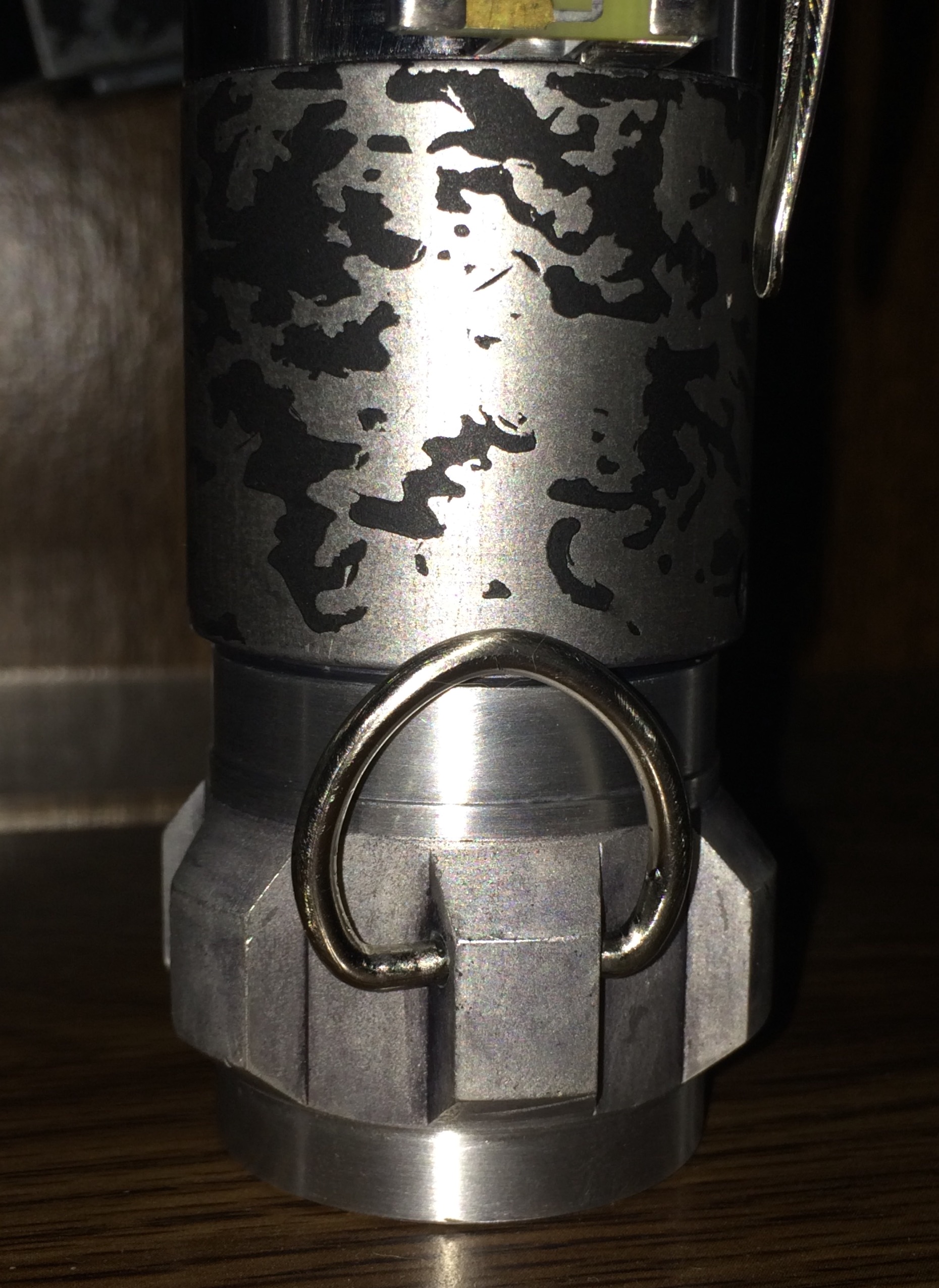

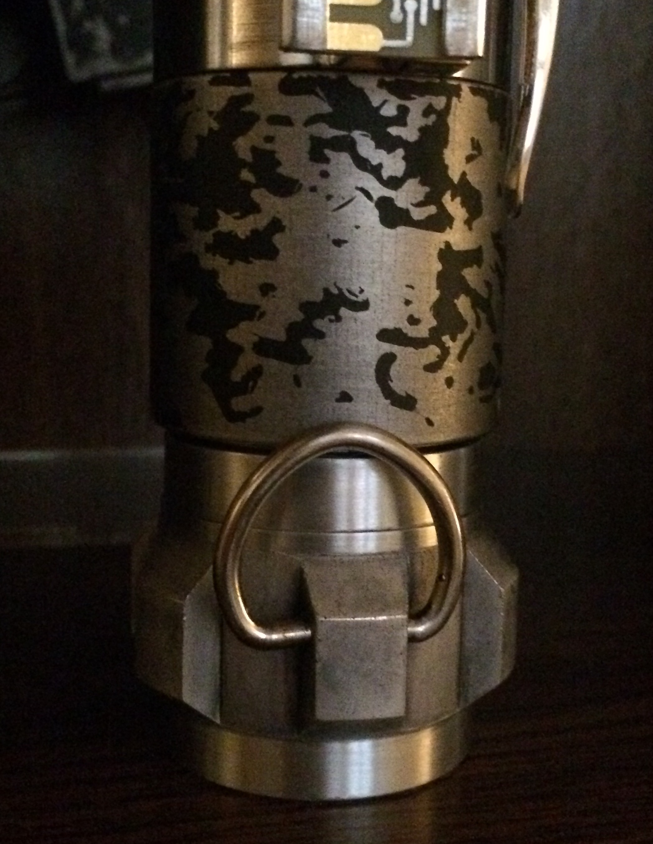

Here's how the leather dye soaking worked out. Not super dark, but definitely darker than the rest. Clear coated it with MrSuperClear UV Cut to get it a bit duller.

Just wondering if there is a permanent way of darkening the alluminium without using a clear coat in a similar way to gun bluing for example
That depends how you define permanent. No matter what you do to aluminum, even if it's a tough-as-nails anodization or a process that penetrates a few mils, any treatment or colization can always be sanded, buffed or worn off.
The oxidation from a dishwasher, the leather dye, aluminum black and anodizing are all "permanent" in the sense they won't just disappear over time if you're not handling the item.
Even though it will be on display (when made!!) for 99% of the time, I will be after a darkening treatment that if handled, wont come off in your hands.
None of the ones I mentioned should come off in your hands once properly set/rinsed. Paint is another one that would survive handling - the degree of handling would depend on the kind of paint & prep.
