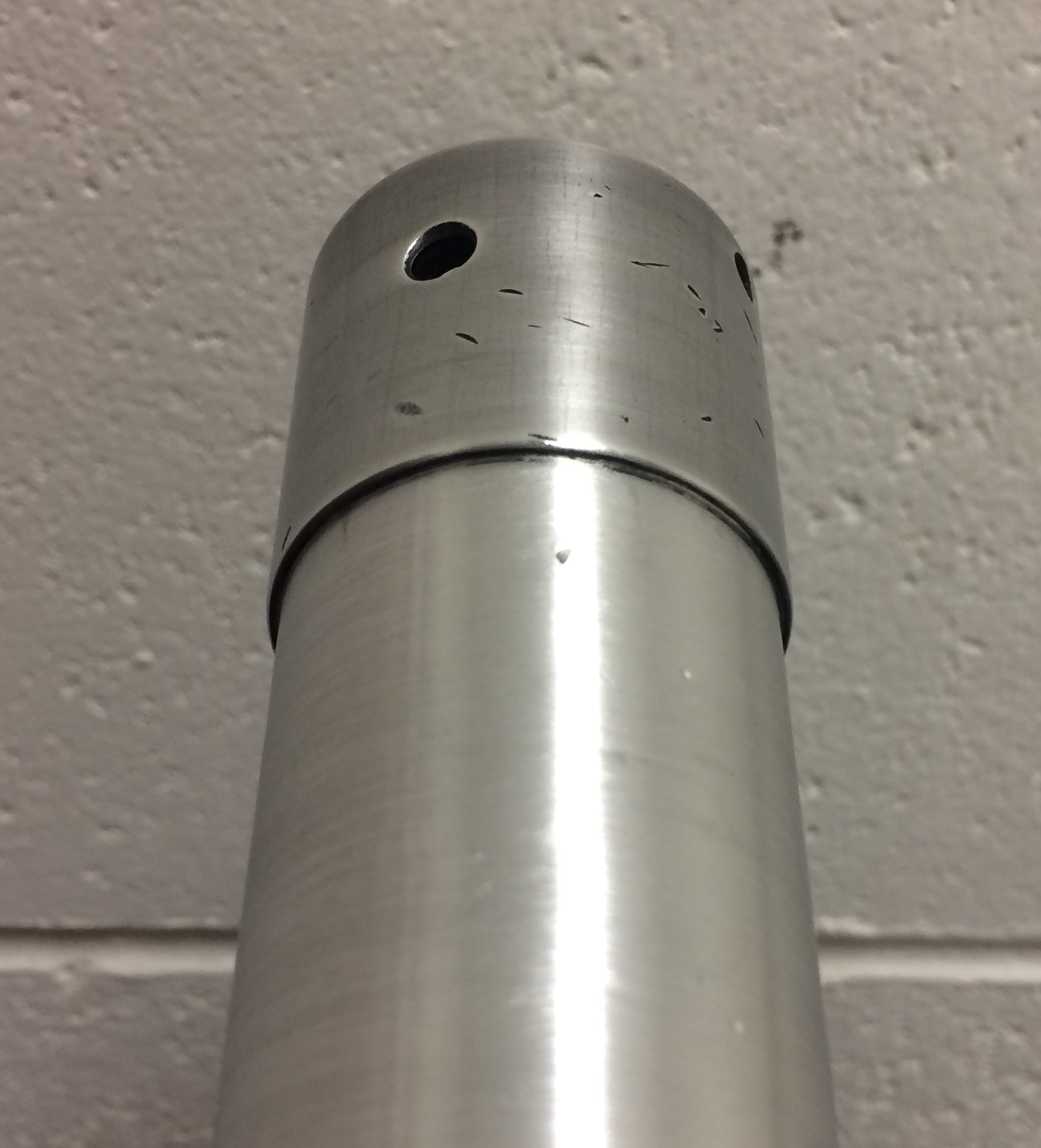

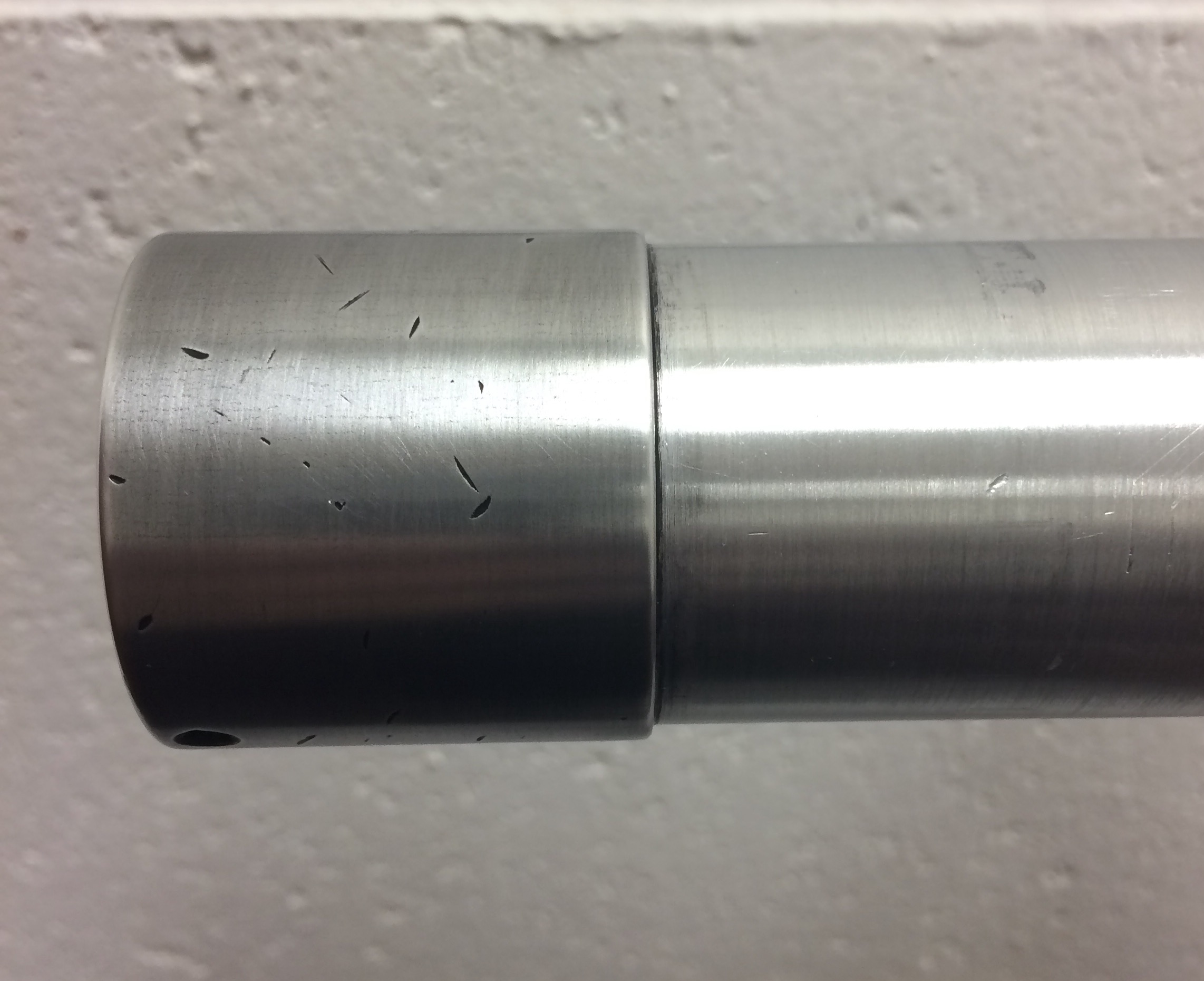

So yeah it's nearly impossible to get a smooth even color with aluminum black. It streaks and splotches even on completely clean smooth metal. Gonna let it soak in leather dye for a few hours and see where that gets me.
Did u try applying it with a cheap sponge brush? Also called "chip brushes"
I actually dunked it into the stuff in a cup, so I wouldnt get any kind of brush marks or anything, still didnt come out even.
Alu Black, or any bluing, after trying that same trick with my DL-44 flash hider, I found out can't be applied evenly in just one pass. It works best if it's done in multiple passes, buffed down with a fine steel wool pad, and then applied again. For mine, I did 3 light passes, buffing in-between, to get it to the color I was happy with.

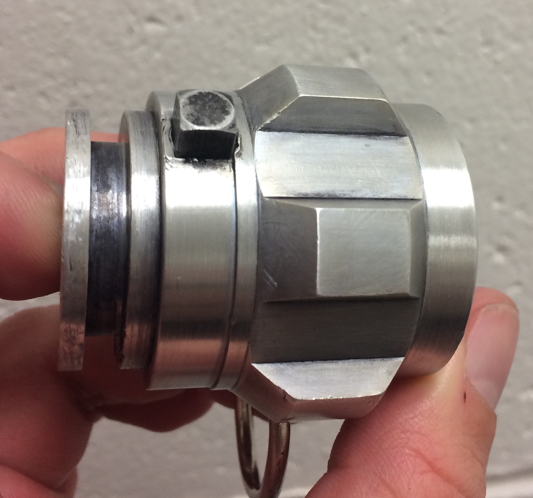

The black leather glove theory might have something to it. This is from 4 hours soaking in leather dye, at a fairly cold temp. Gonna let it soak overnight and heat it up later. I would imagine constant friction against leather would also dull it up.
While I do see slight brown, I think it's just from the light. It looks more like the black on the grenade section than it does the brown on the windvane.

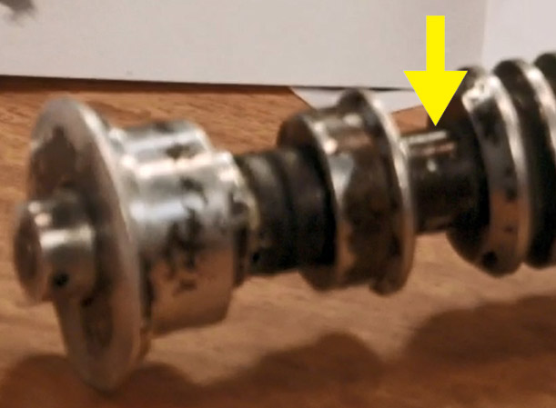

Of course, this could just be me. Now I just can't help but think, how aren't there any really good pics of the v2 prop?
It might be just me, but I see hints of brown here...
Edit: Also having looked at the video with Brandon and Mark Hamill, it does appear that this section is black. But again, I could be mistaken.

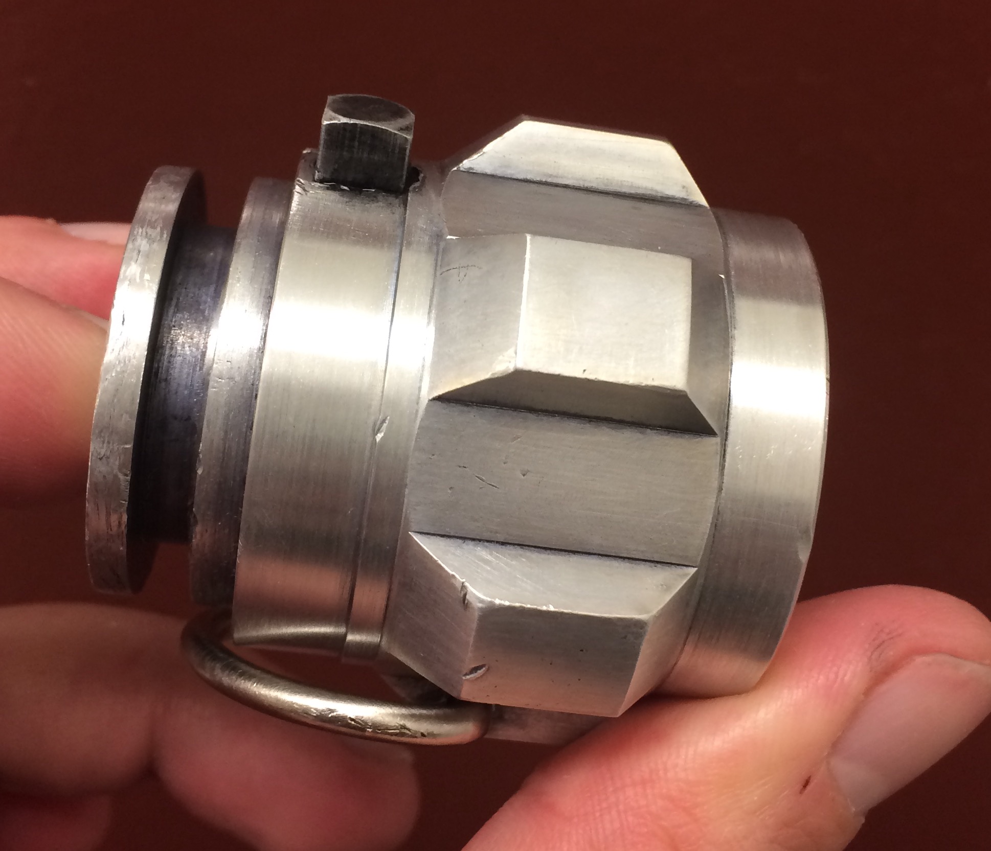

I may do a few more soaks to get it a bit darker, but yeah the stuff really works.
How are you soaking the parts? Particularly the pommel cubes. Are you brushing the dye on? I'm really digging the effect!
I taped off the ends and just let it sit in a plastic cup of the liquid dye all day. Heated it up a little before rubbing it clean with paper towel.
