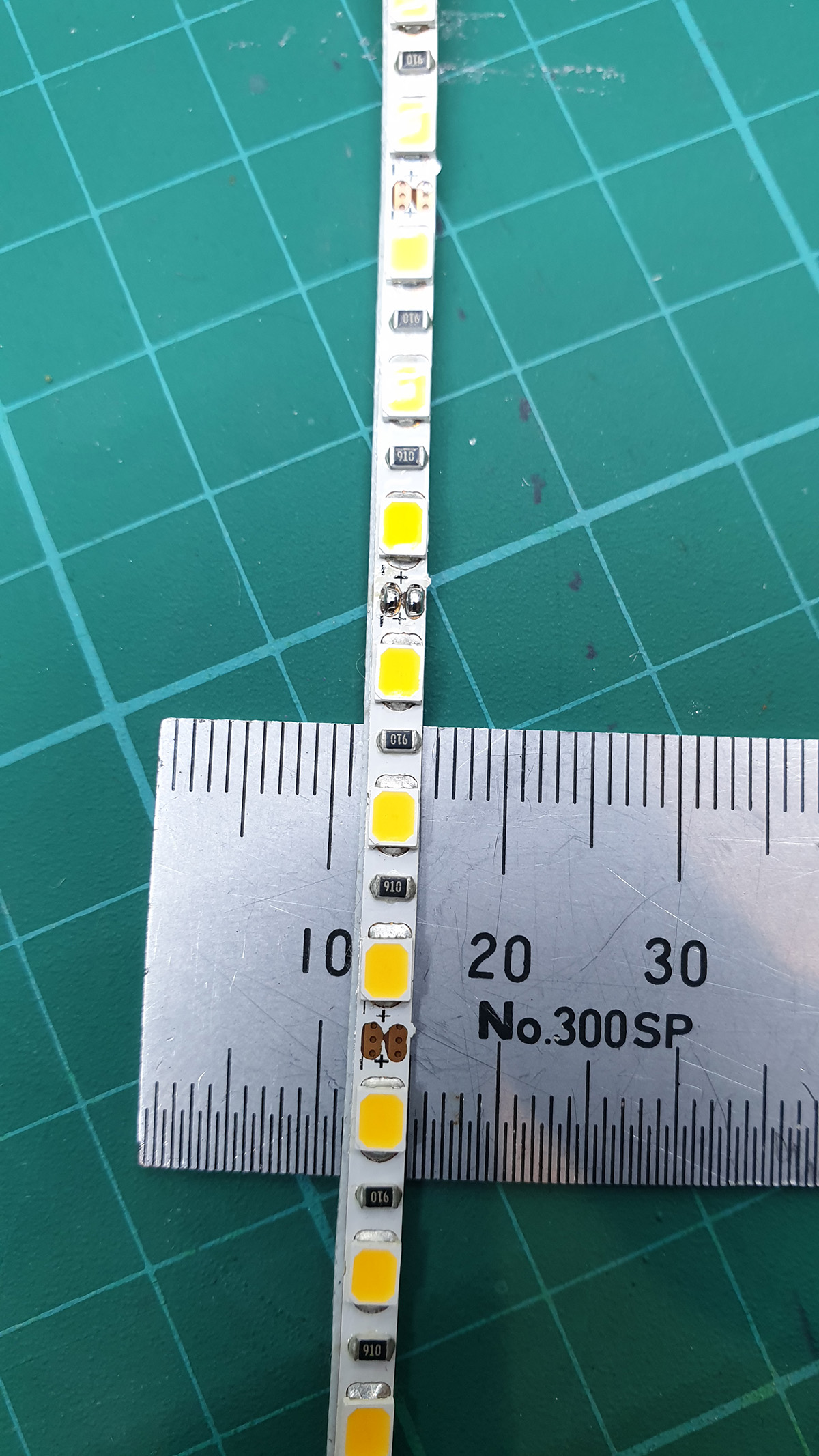

For your reference, here's the LED strip that I used. Its a 3mm wide 2835smd strip, 120leds/m. Runs off 12v.

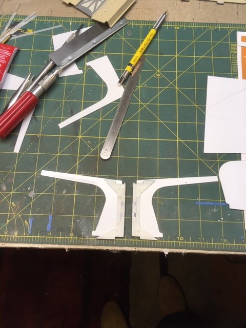

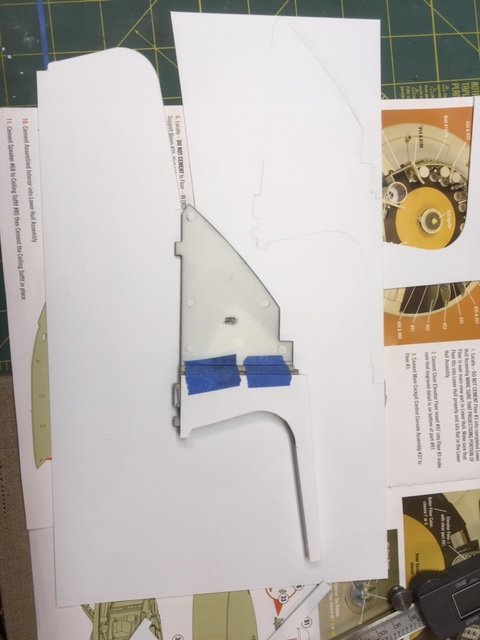

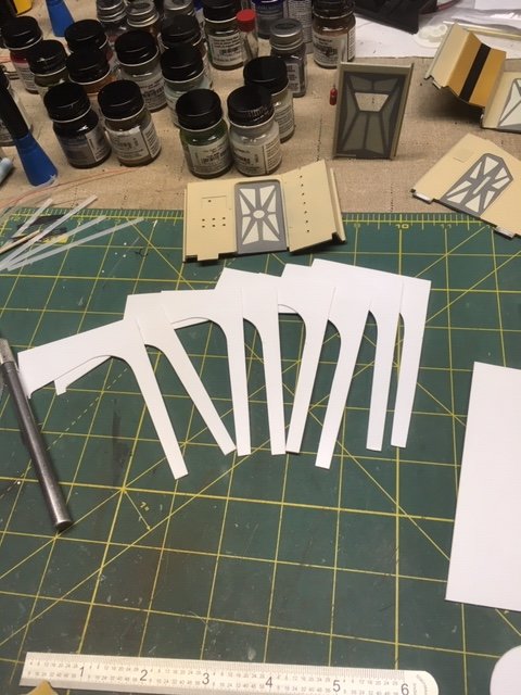

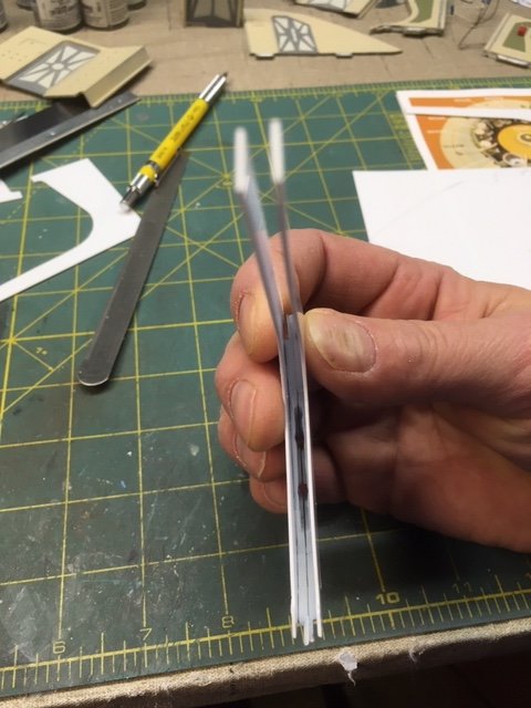

off to a good start with the alternate walls, smd strip roll should show up today. Thanks again Harddrive for showing me a great way to do these!

but i got something listed as a 3014 and not the 2835. from looking at harddrive's pic, his looks like there are more smd's spaced closer togetherWhere did you buy them from?

Say, this is probably a dumb question but...this will be the first time I've used strip lights, I'm using 9V power, do these require a resistor?For your reference, here's the LED strip that I used. Its a 3mm wide 2835smd strip, 120leds/m. Runs off 12v.
No they have them built into the strip. If you want to dim them further you can add a resistor to either the + or - to dim them down. I do this all the time to make the lighting more realistic and in scale with the model.Say, this is probably a dumb question but...this will be the first time I've used strip lights, I'm using 9V power, do these require a resistor?
