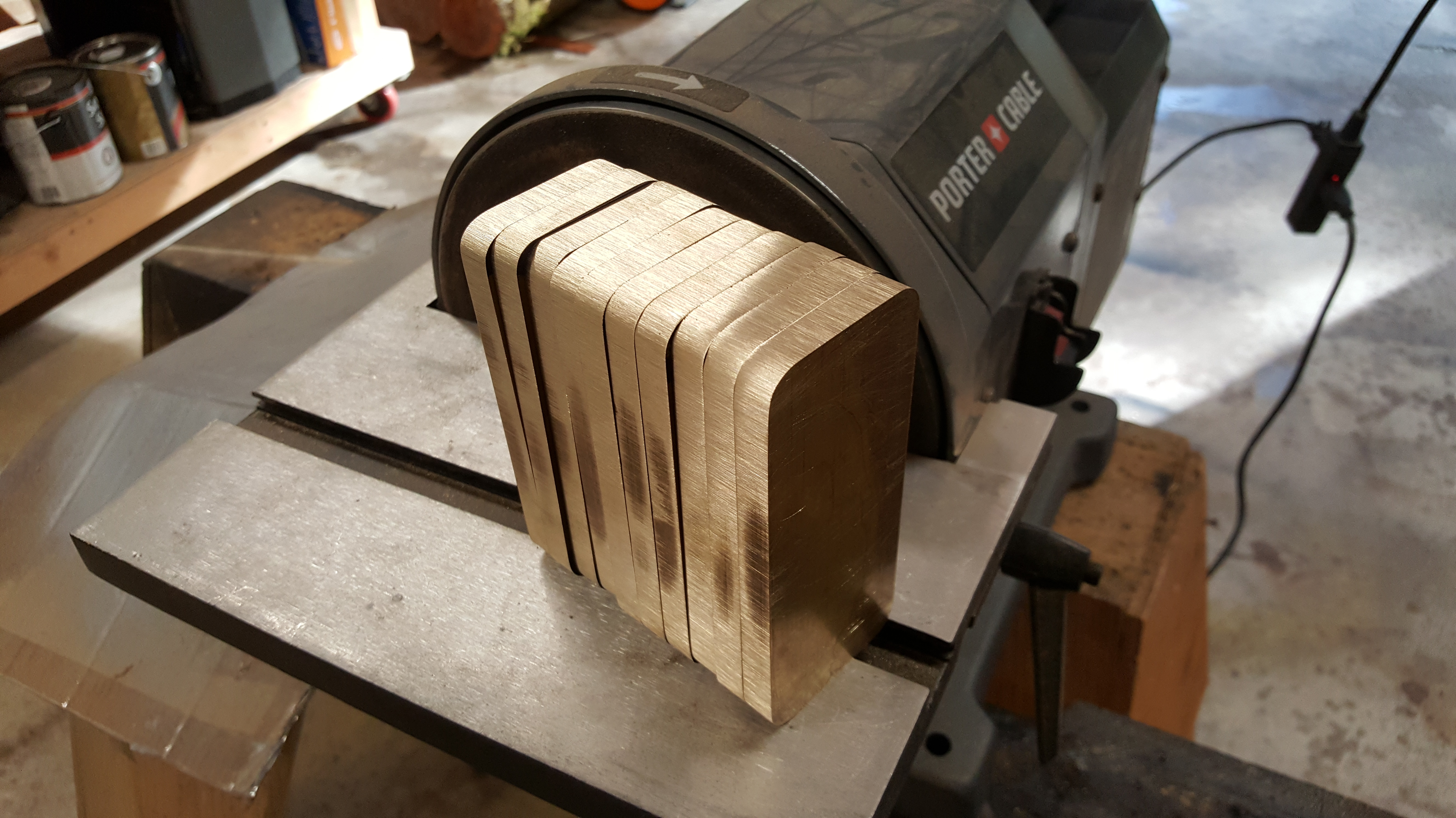

Been a bit, my workshop is finally available again after a fair bit of flooding. I took all the 1KG pieces down to final dimension, but 1 big drawback to doing these in mass is that the 120 grit sanding belt turned all the brass I took off into a super fine powder that has now covered every inch of my shop, even with the use of a baffle. Going to have to take another bit of time away from the project now to give my entire space a thorough cleaning lest I breathe in brass dust for the foreseeable future. Need to design a better way to power sand these things :\

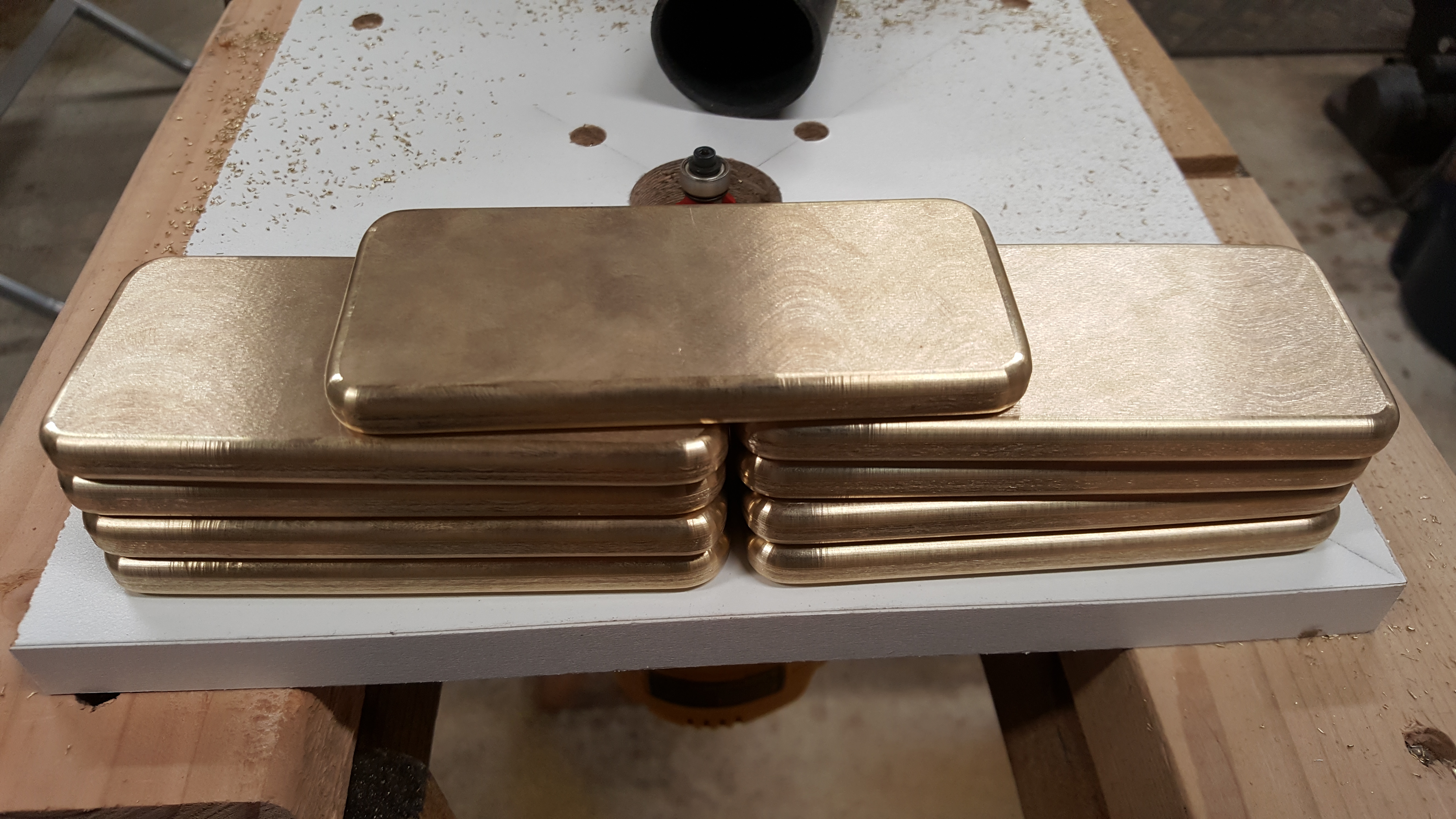

  • I was getting deep sanding lines on the edges from my initial shaping that were proving a pain to remove in the hand sanding phase. I made sure to remove them entirely using my spindle sander before moving on to routing the edges, which resulted in much cleaner fillets.
  • I swapped out my oak makeshift router table with a laminated MDF board after a couple bars. I was finding that brass chips were getting in the grain of the oak board and scoring the bars when I was sliding it on the surface during shaping the edges, causing me to have to revisit the sanding phase to cleanup. I took the time to cut a new makeshift router table and mount my 1/4" shank router to it. This also resulted in far cleaner edges on all subsequent bars as well as a faster turnaround.
  • Take breaks in between bars. Routing metal is slow work, you have to feed really slow and steady in order to get both a clean uniform cut as well as avoid catching. Moving slow however will also heat things up fast and you want to avoid letting the cutter bit heat up or it will increase likelihood of damaging the bit. Also leaning over and moving slowly is rough on the body so taking breaks in between bars to move around and let things cool down is ideal.

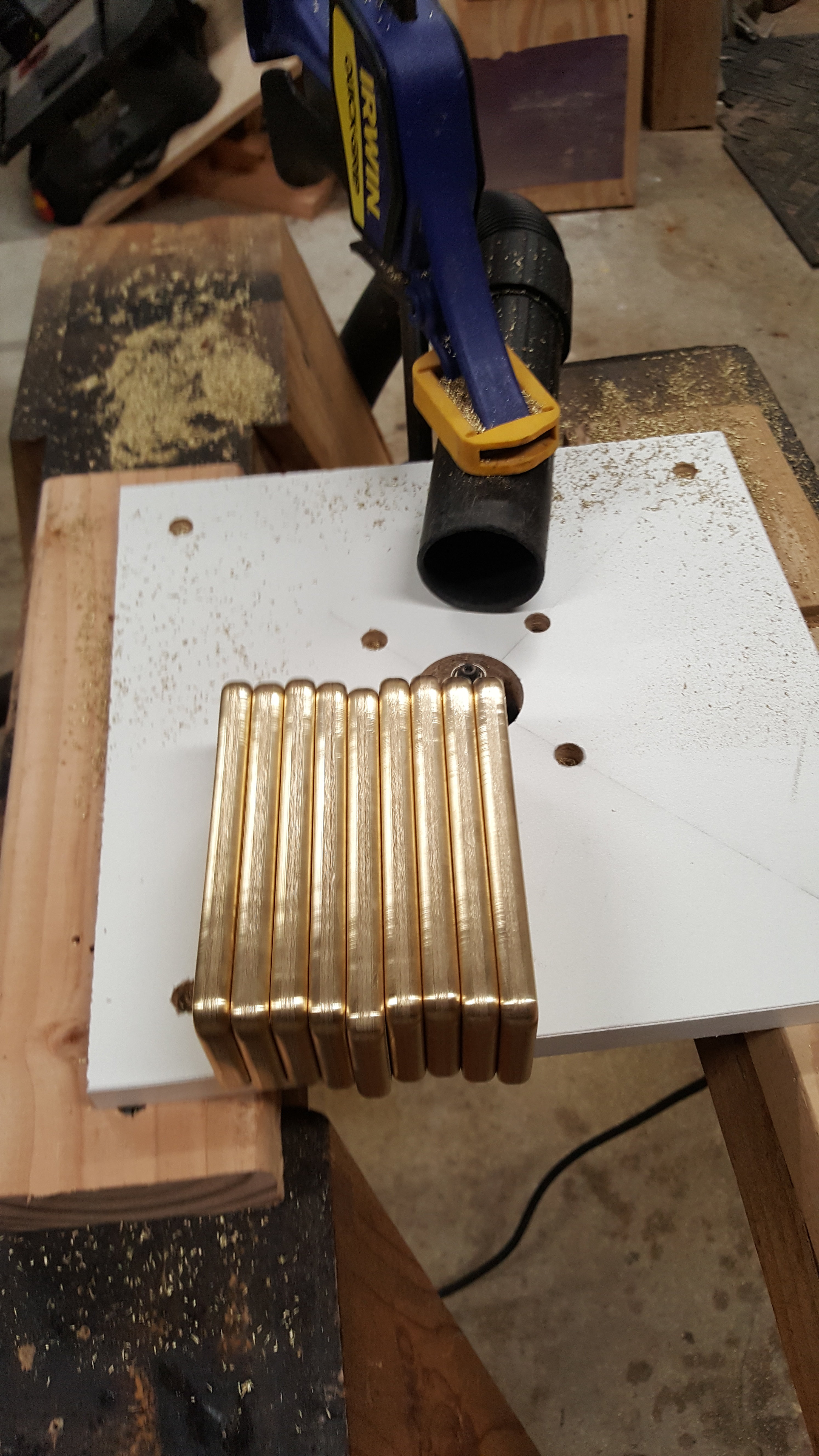

  • I need to design a better way to mount my vacuum hose. The brass chips go everywhere and I need to think up a good solution to either containing them or directing them for better cleanup. Spending more time cleaning up the shop these days than dirtying it in the first place.
Tonight's full set with my fresh new makeshift router table.
Here you can see both a gouge free edge for the router bit's bearing to slide smoothly along as well as my shop vac which seems more of a suggestion than an actual solution.

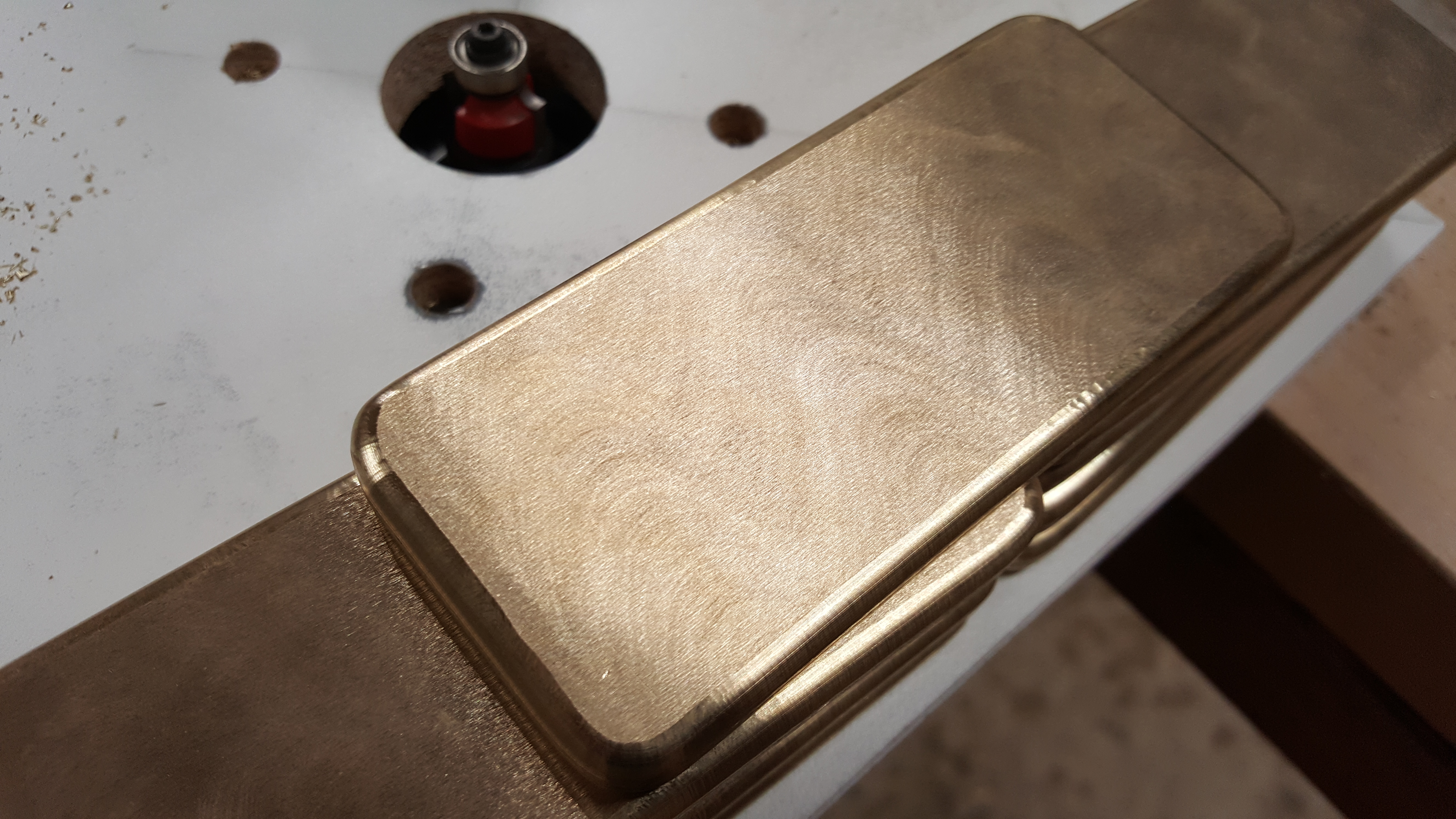

Closeup of the bars surface after initial cleanup on my spindle sander. Even though its temp, it did leave a pretty cool surface pattern.
Next step will be hand sanding stage to blend and clean the surfaces smooth and then on to masking and etching.

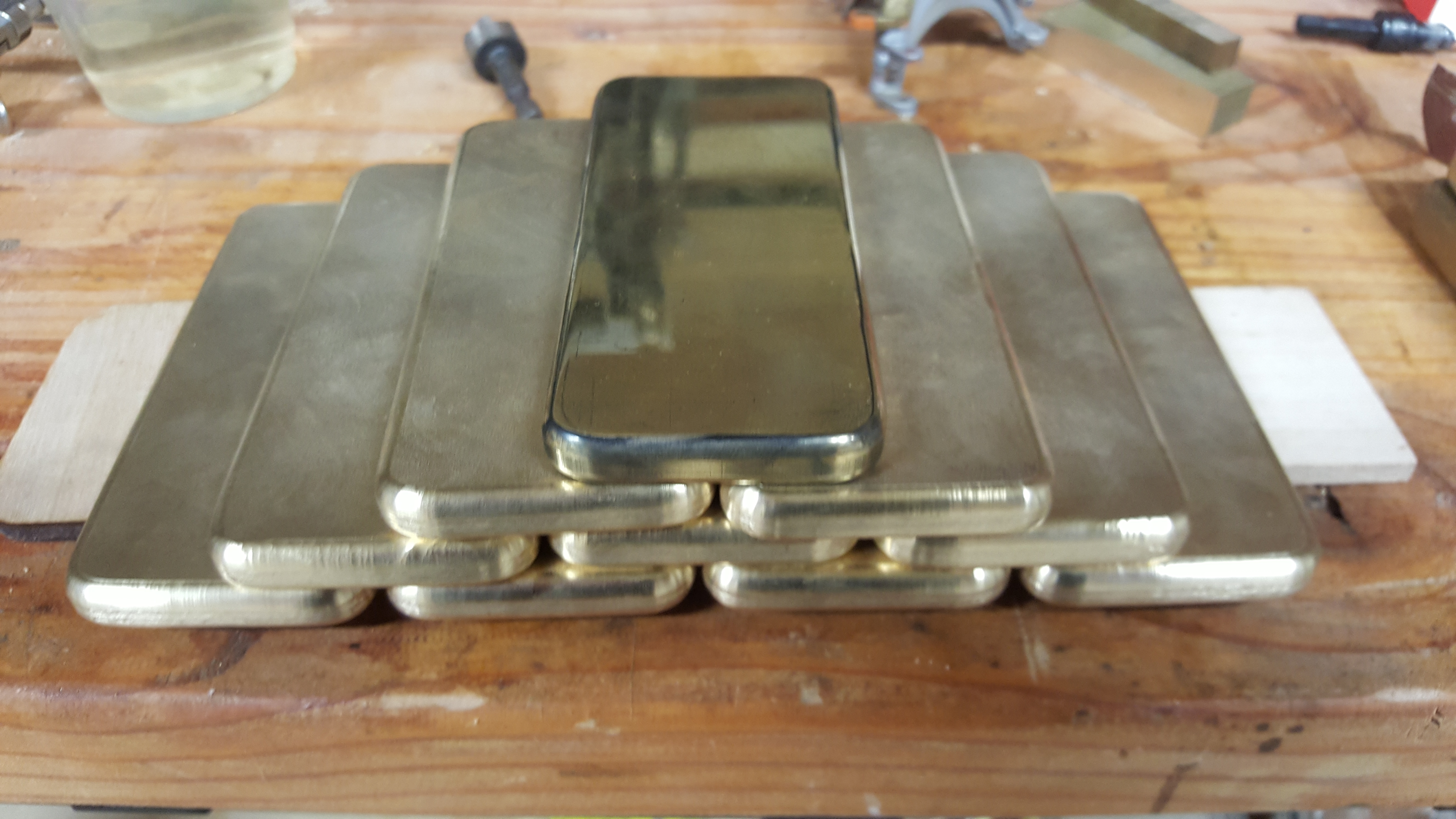

Took it to final sanding and buffed out. Now on to getting it finished with gold plating :D
