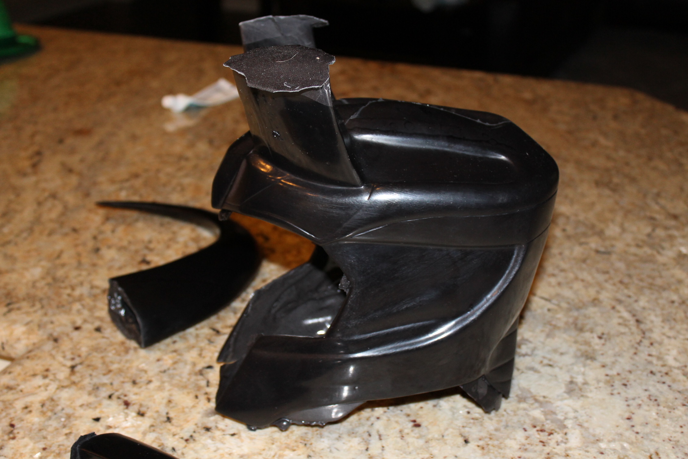

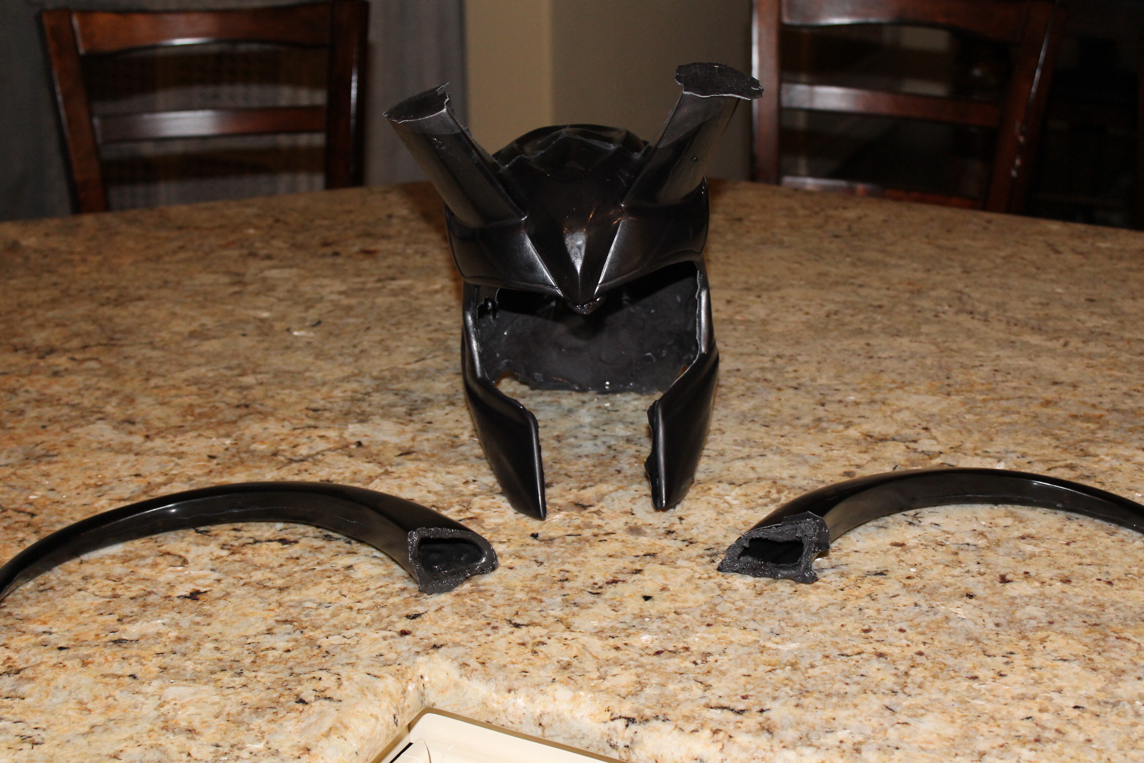

UPDATE: THESE PICTURES WERE FROM THE ORIGINAL MOLD.
Here are 2 pictures of a cast, granted each cast may have lesser or more clean up required as these are slush cast. I do my best to keep them around what you see here.

bobafett669 once the edges are cleaned up on both ends you can use any adhesive. A 2 part epoxy would be best. Once that is done use some bondo to fill all around the seam.

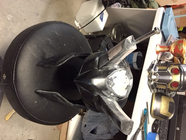

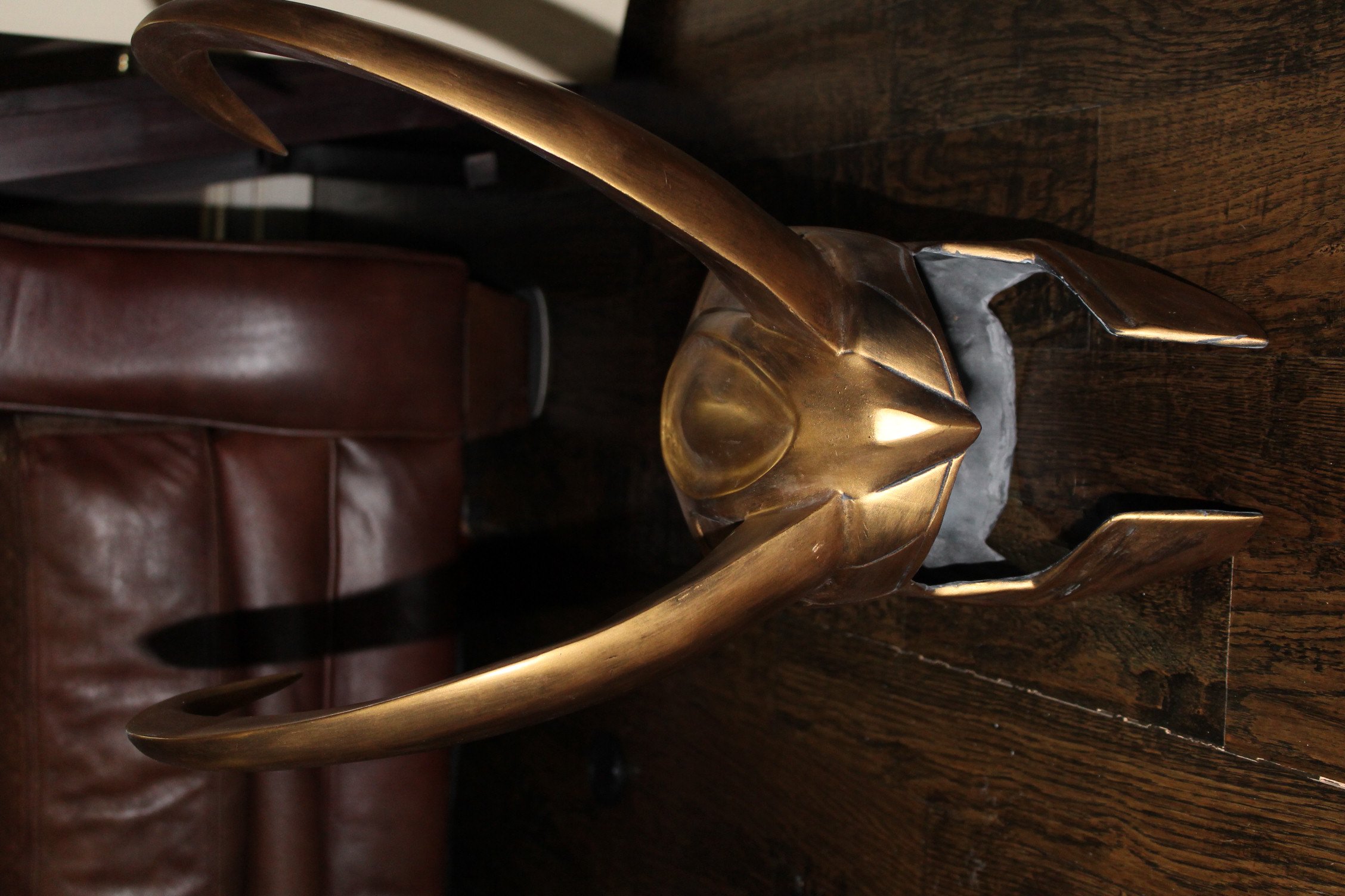

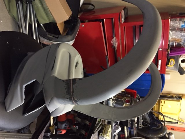

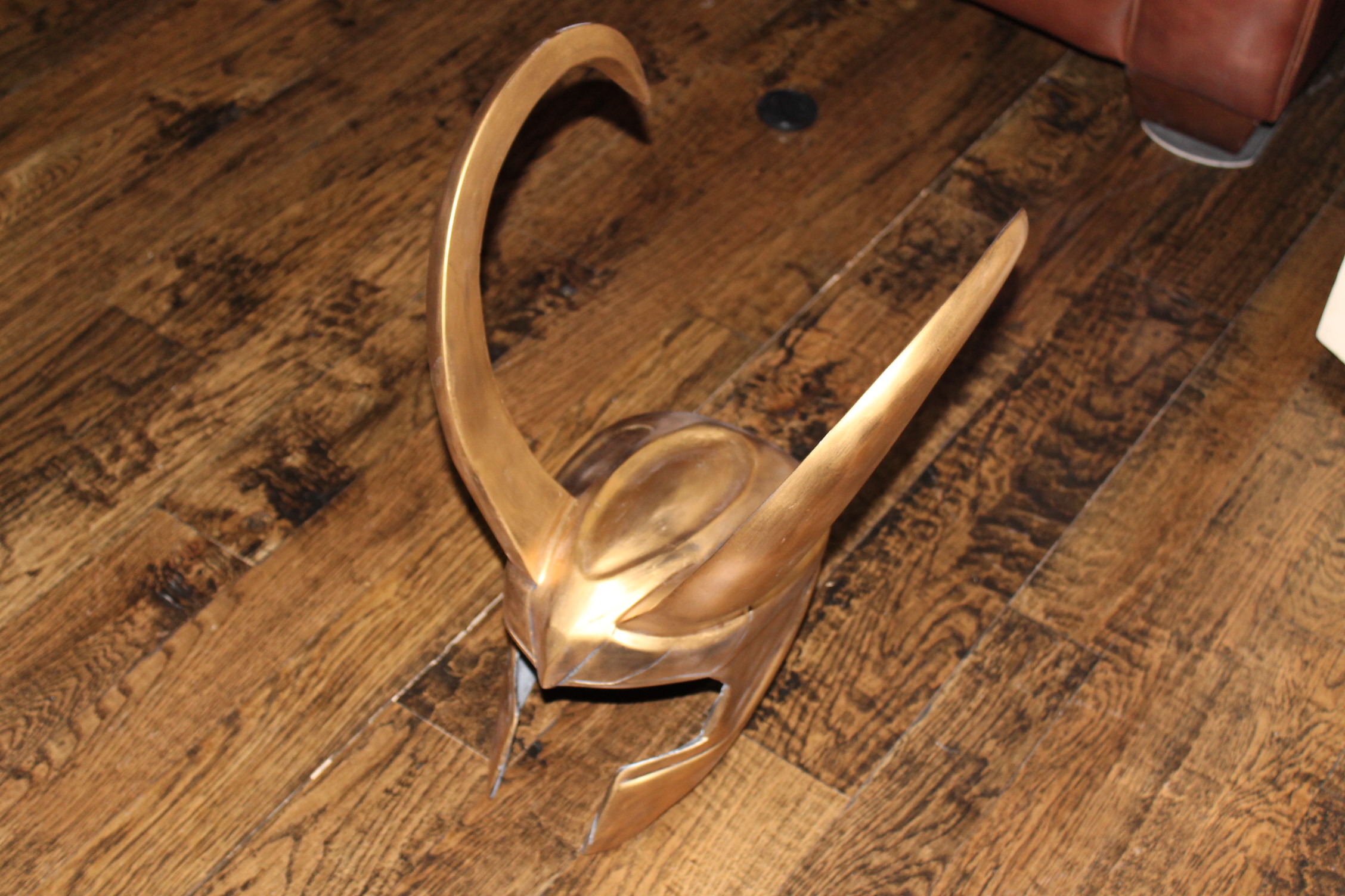

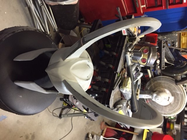

For those that are interested in his helmet, here is what I received and what I've done with it. I placed large bolts to strengthen the joints in the horns, and then I filled the lower portion of them with resin to make them extra strong. Took a good amount of prep work to get it ready, but it is an awesome helmet. The only thing I haven't added yet is the padding to help keep it steady.
Re: LOKI Helm
Looks great! Thanks for posting pics. If we ever get a chance we may revamp the mold, theres a few issues we would want to address. But you did an excellent job with it.

I am very pleased with the mold - Once finished & polished it looks like the real thing. It's a little heavy since I filled the horns with resin, but it is rock solid.
