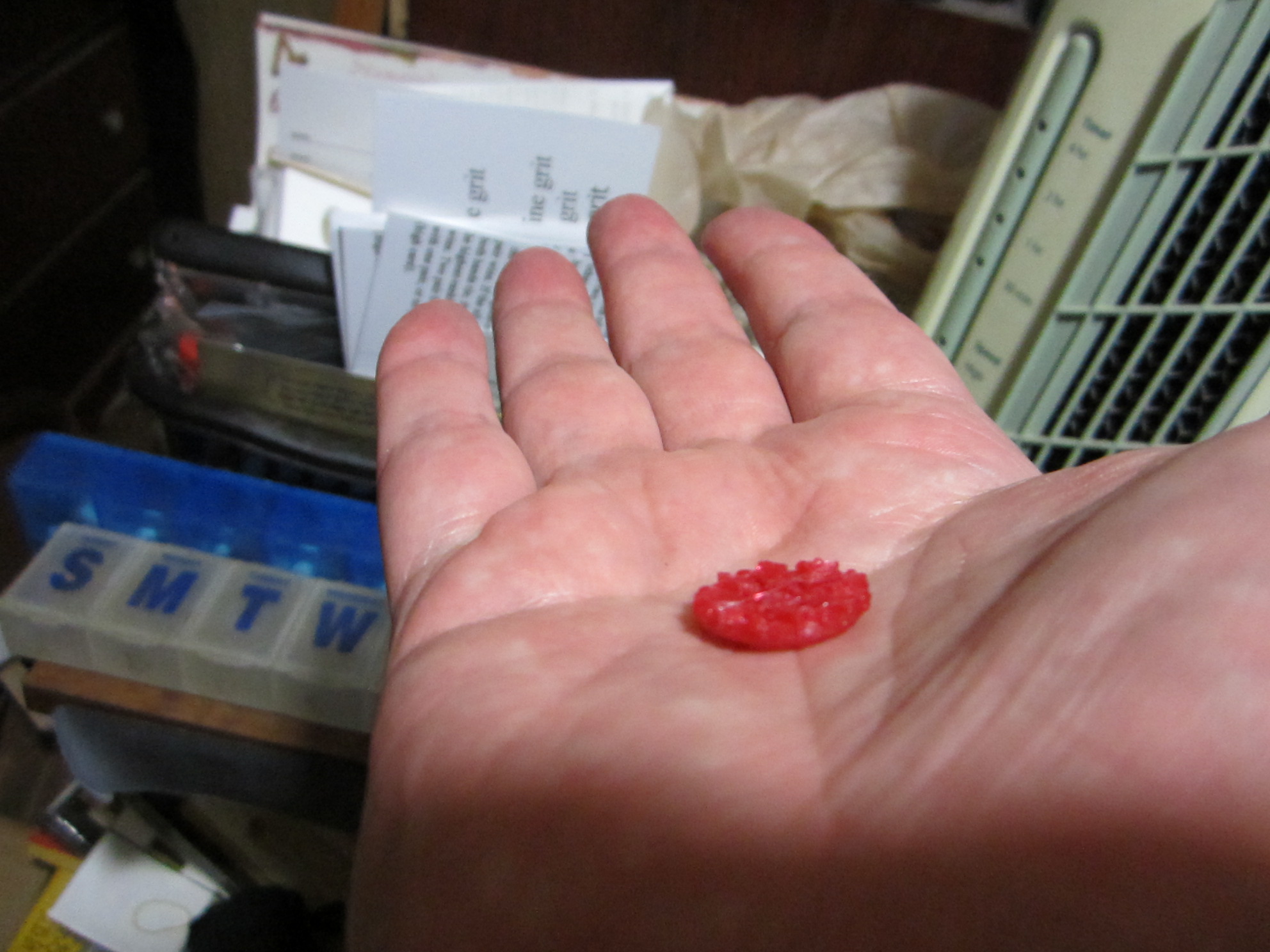

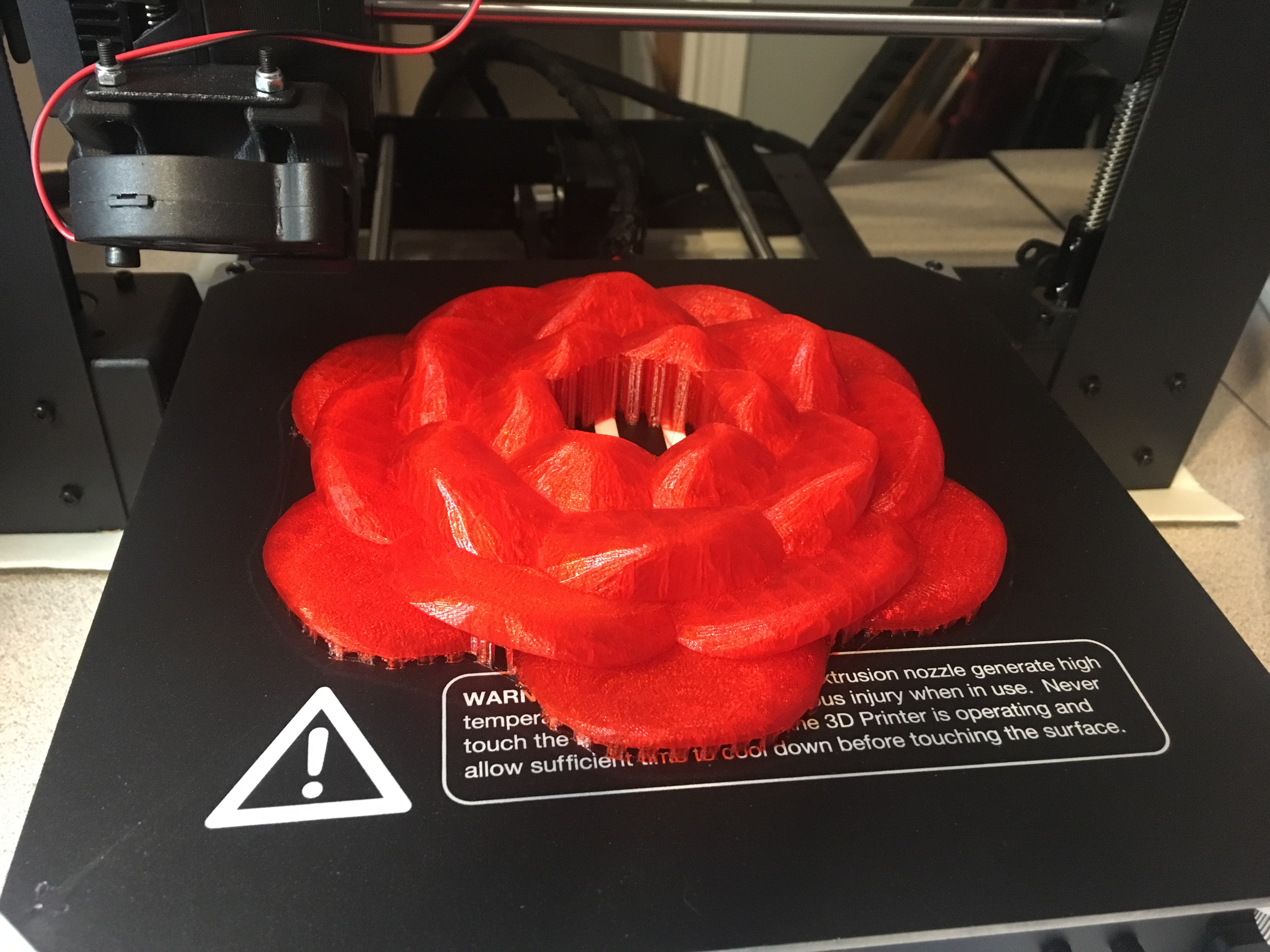

That's without cleanup. It needs some sanding to remove the print lines.
It's the new material from Shapeways that is high def and has a smooth finish.

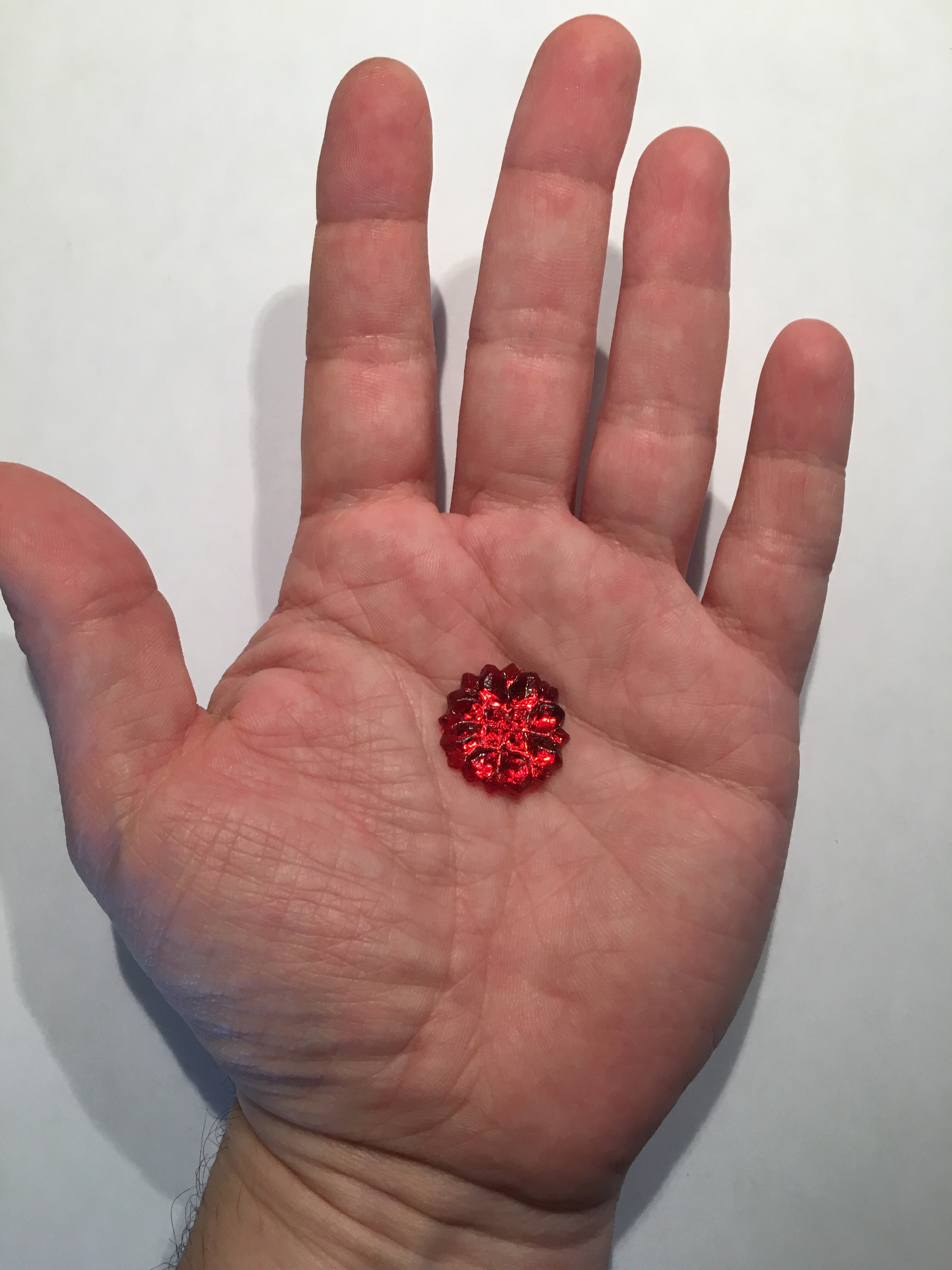

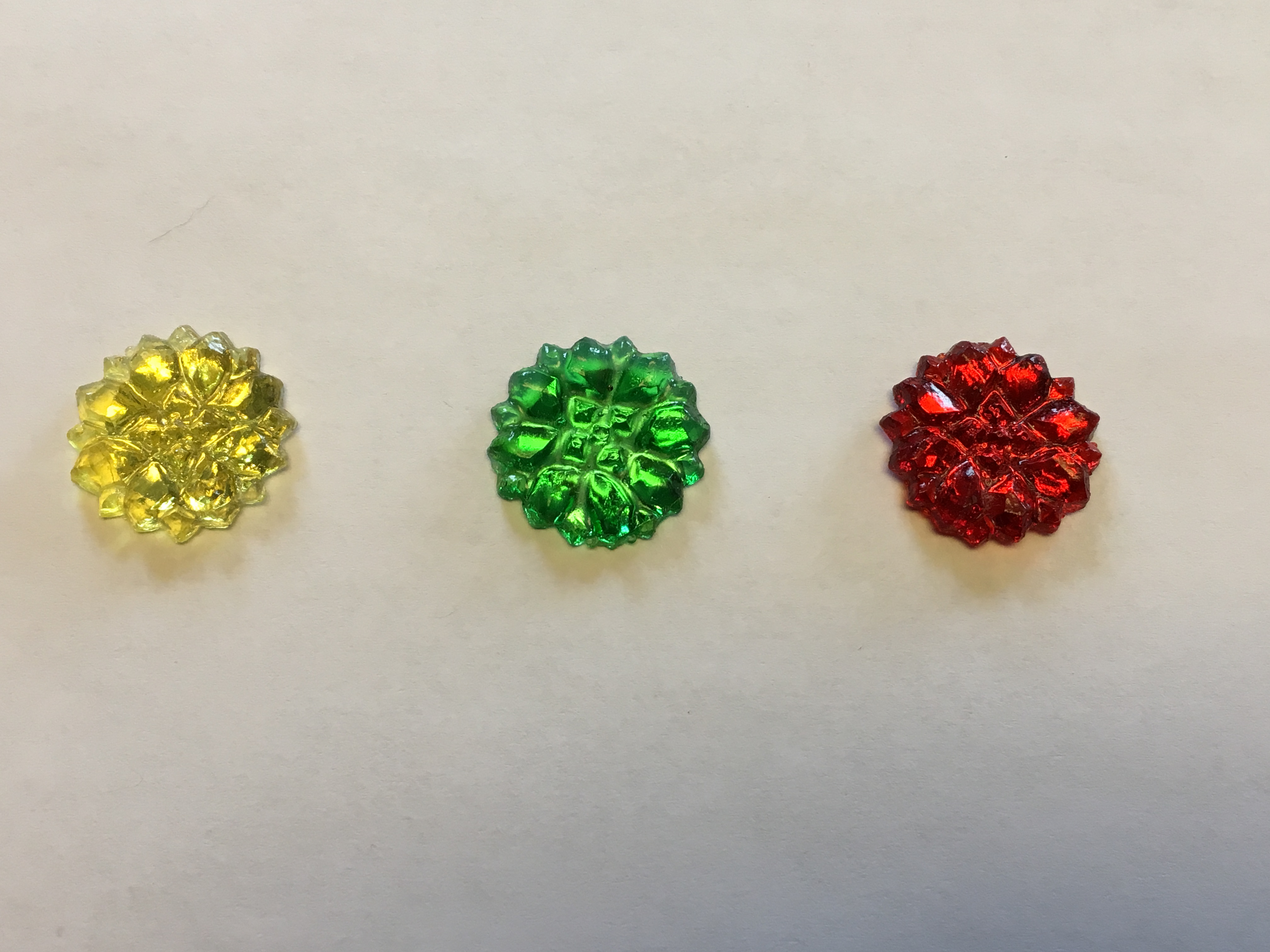

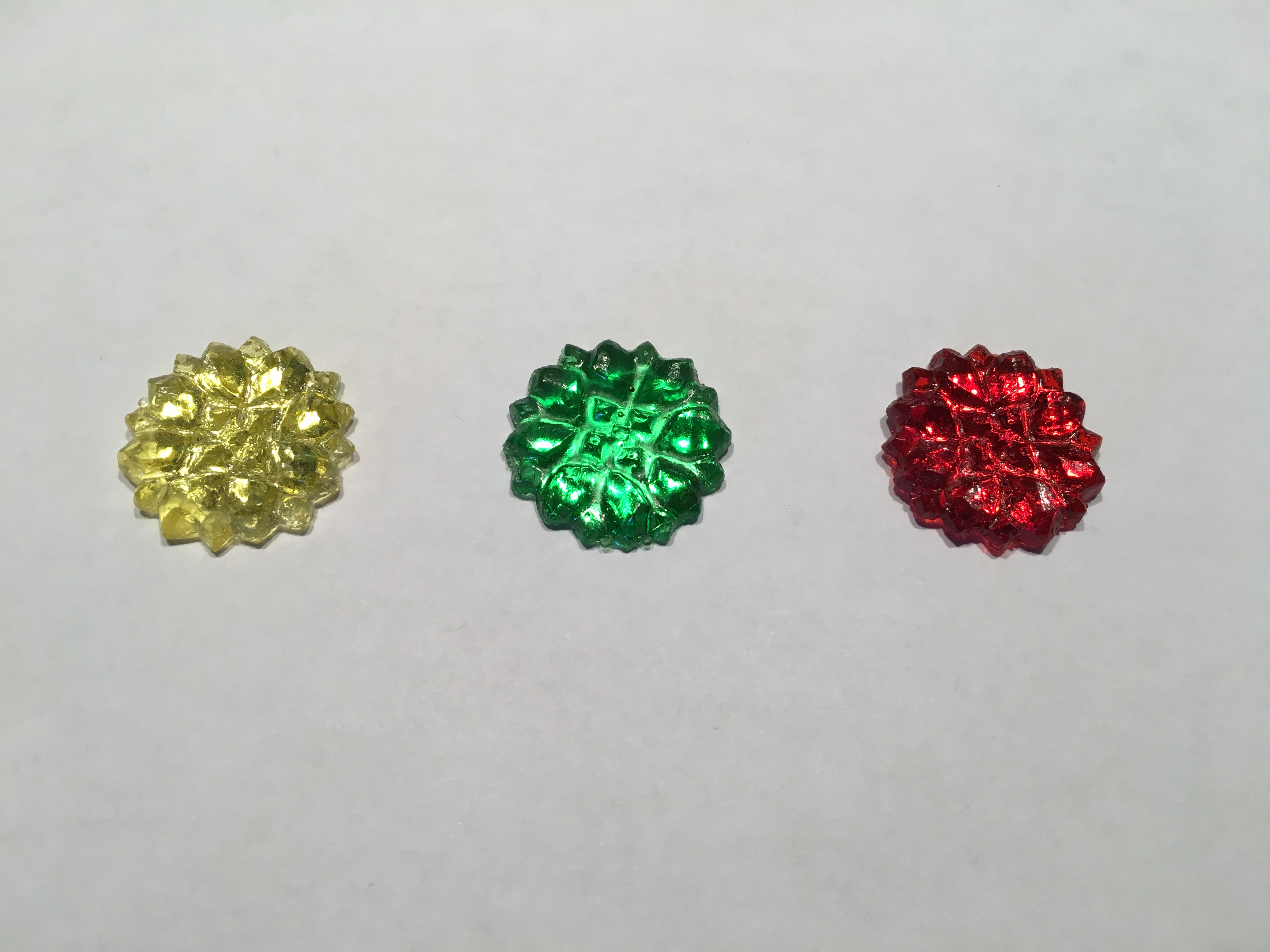

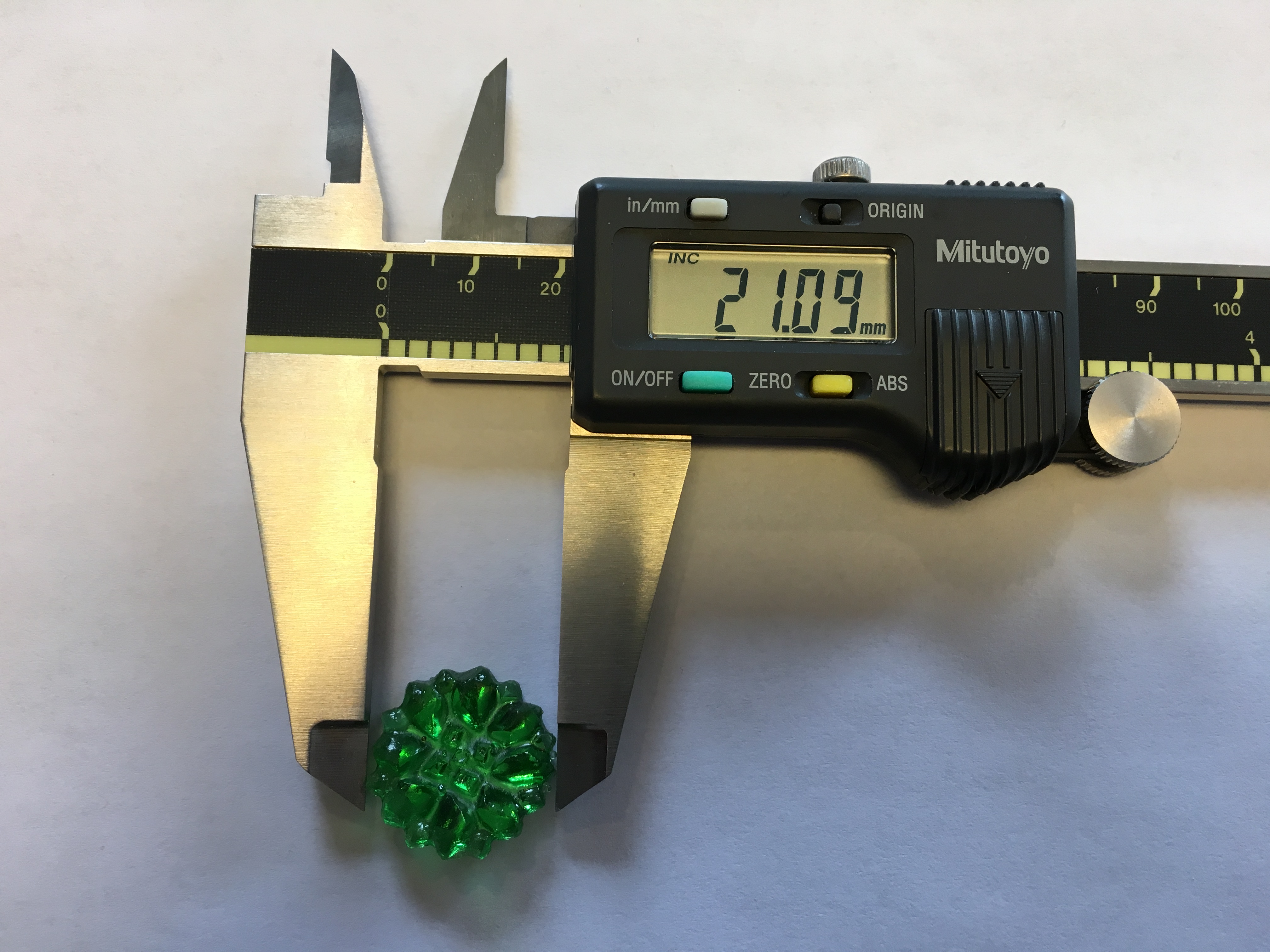

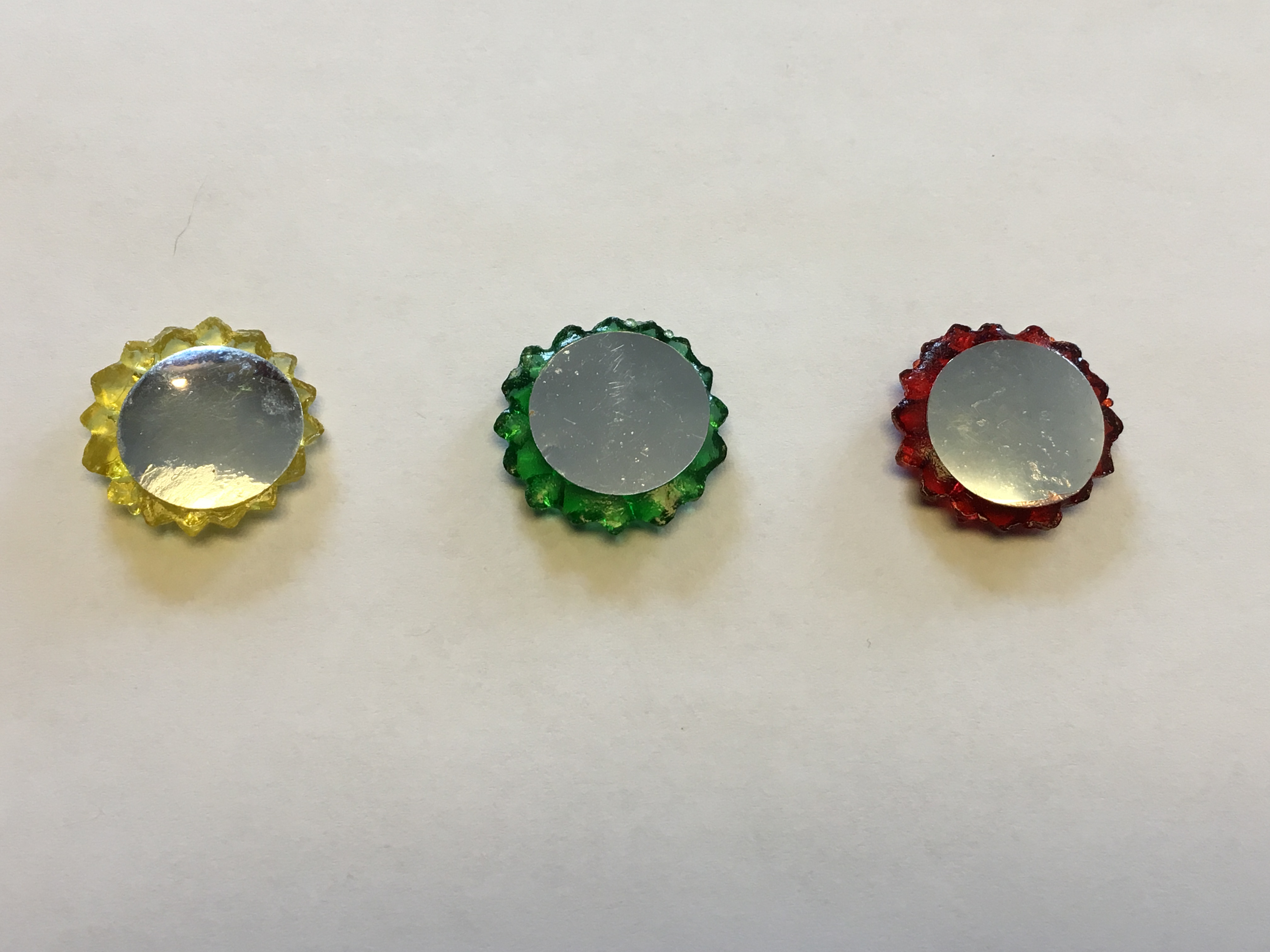

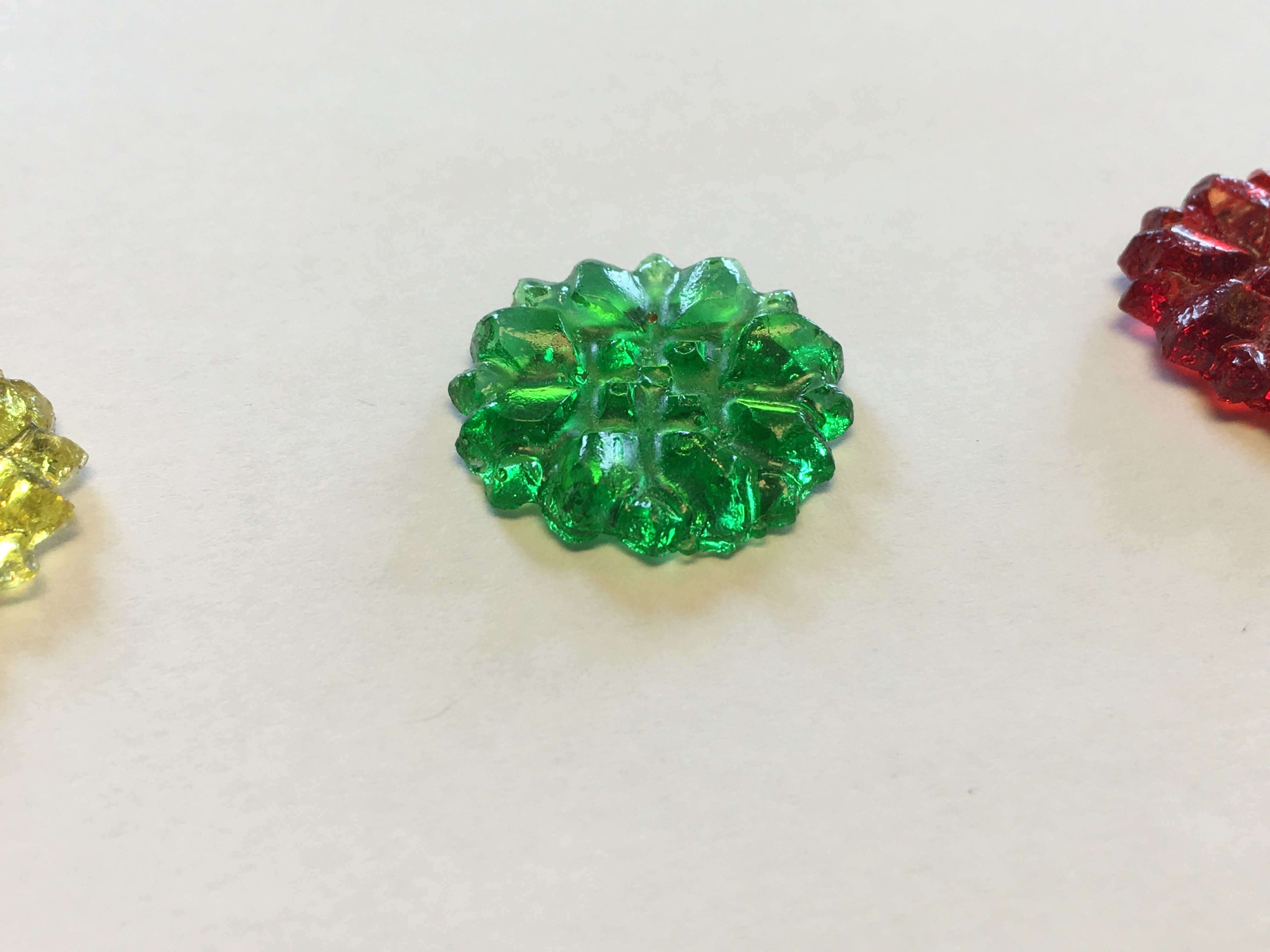

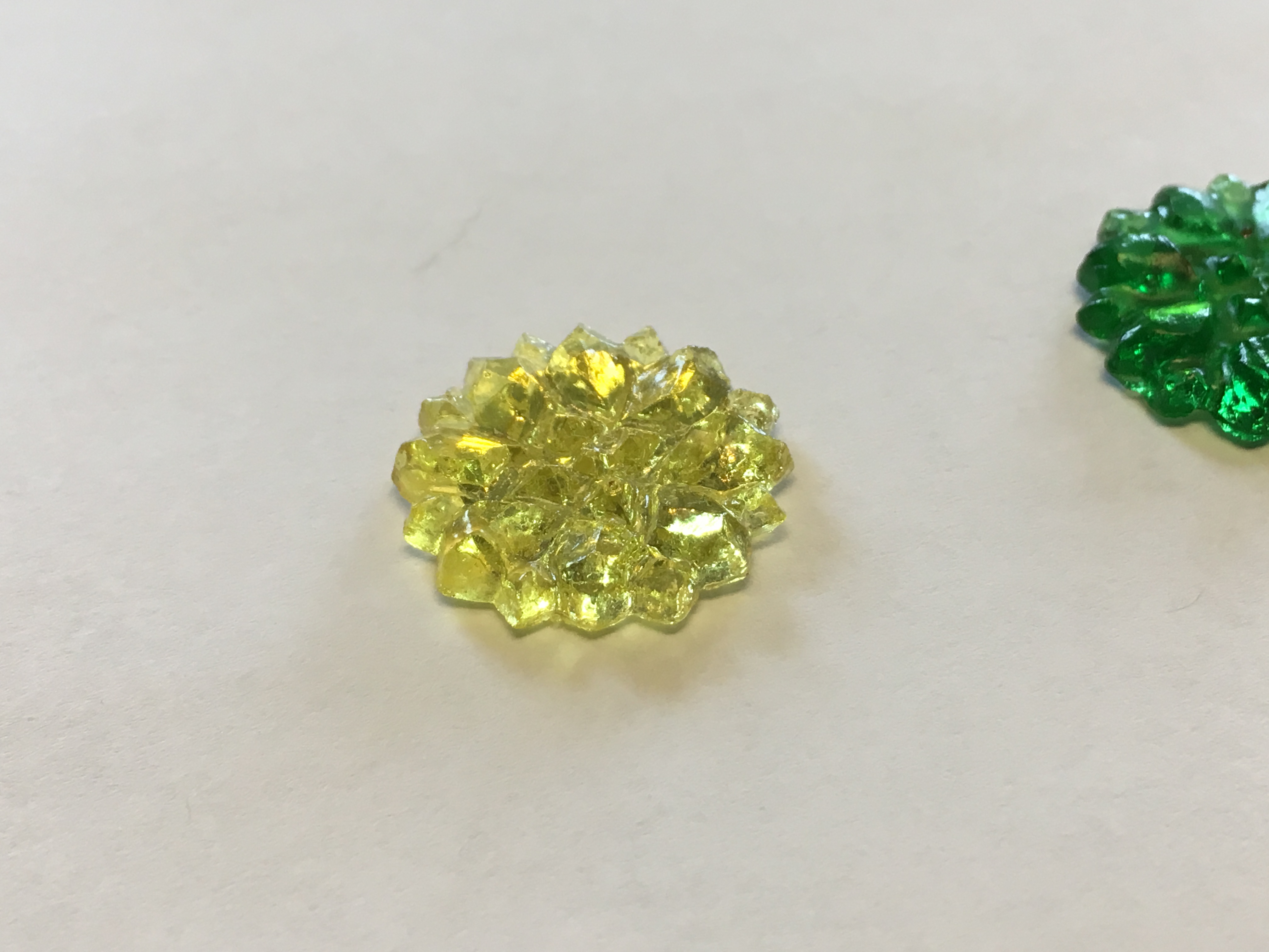

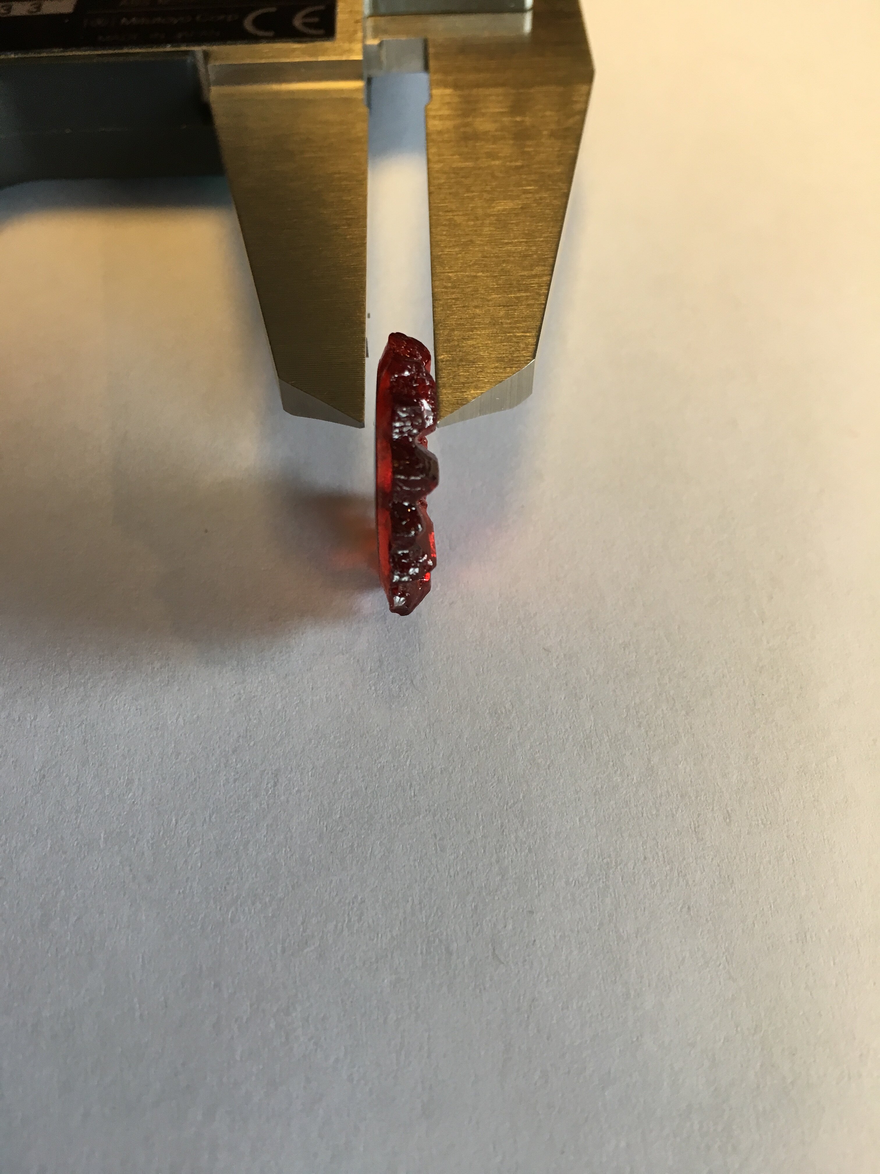

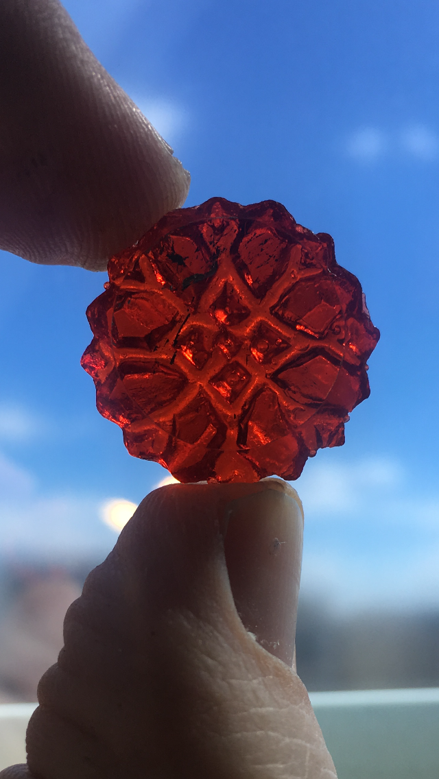

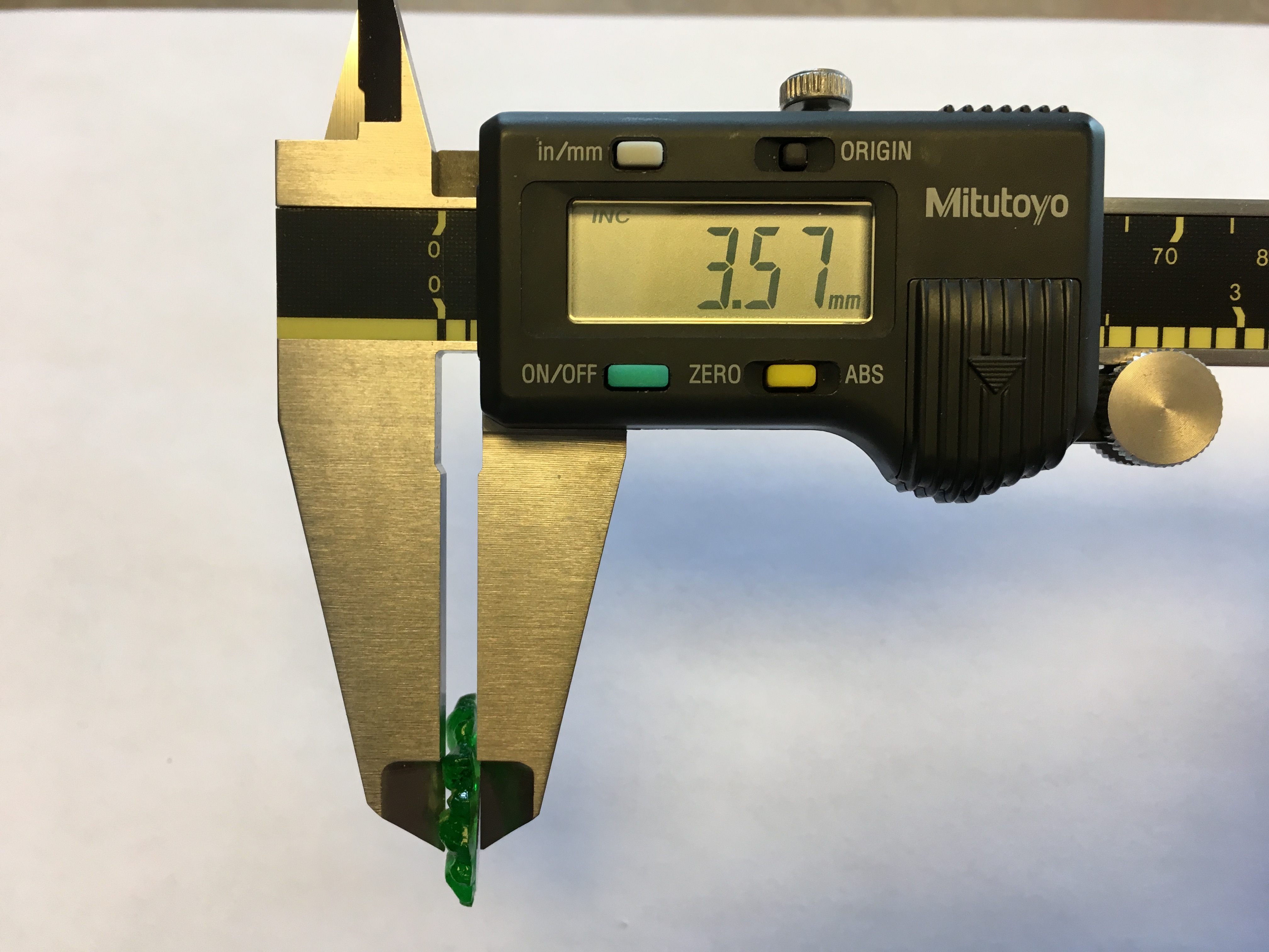

I just recently purchased some actual Logan's Run Life Clocks from an actress who appeared in a non speaking motion picture role on screen with Michael York and Jenny Agutter. I was able to verify this person is legitimate. There are not too many good photos of these close up, so I'm posting them along with the actual dimensions in mm. See photos. A few observations:
- they are quite small and light weight, but strong
- they have retained their color very well over about 40 years.
- the thickness of these is very inconsistent. Probably these were produced very quickly and without a huge concern about consistency.
- some are warped (concave) more than others. I think this is an unintentional effect of the unusual shape, thin structure, and quick production
- the silver disks on the back are extremely effective in making these "glow"
- they are hard to photograph because of the unusual pattern and transparency
- the green looks really nice, much brighter than other photos I've seen and that makes me question if those photos are originals. These here are absolutely legit.
So here's the pictures!

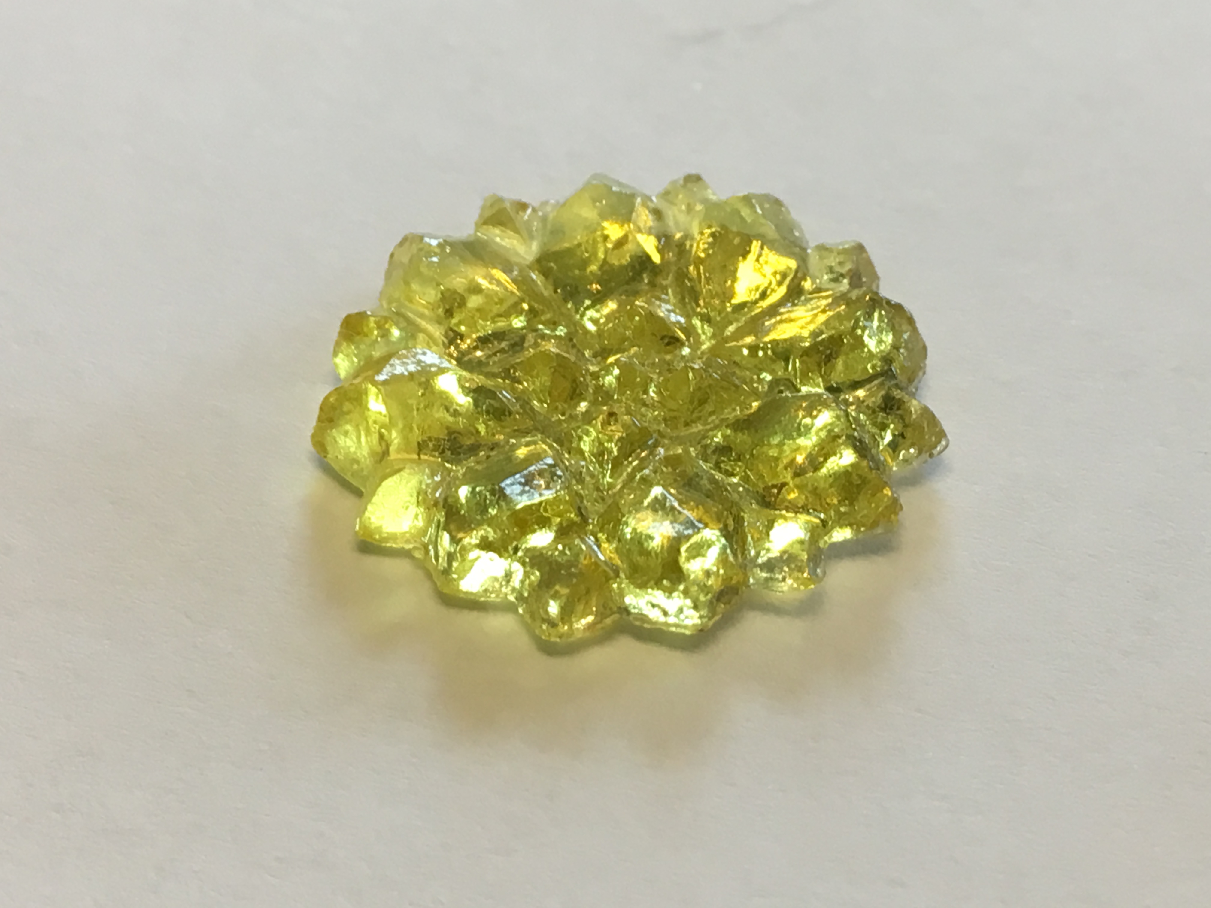

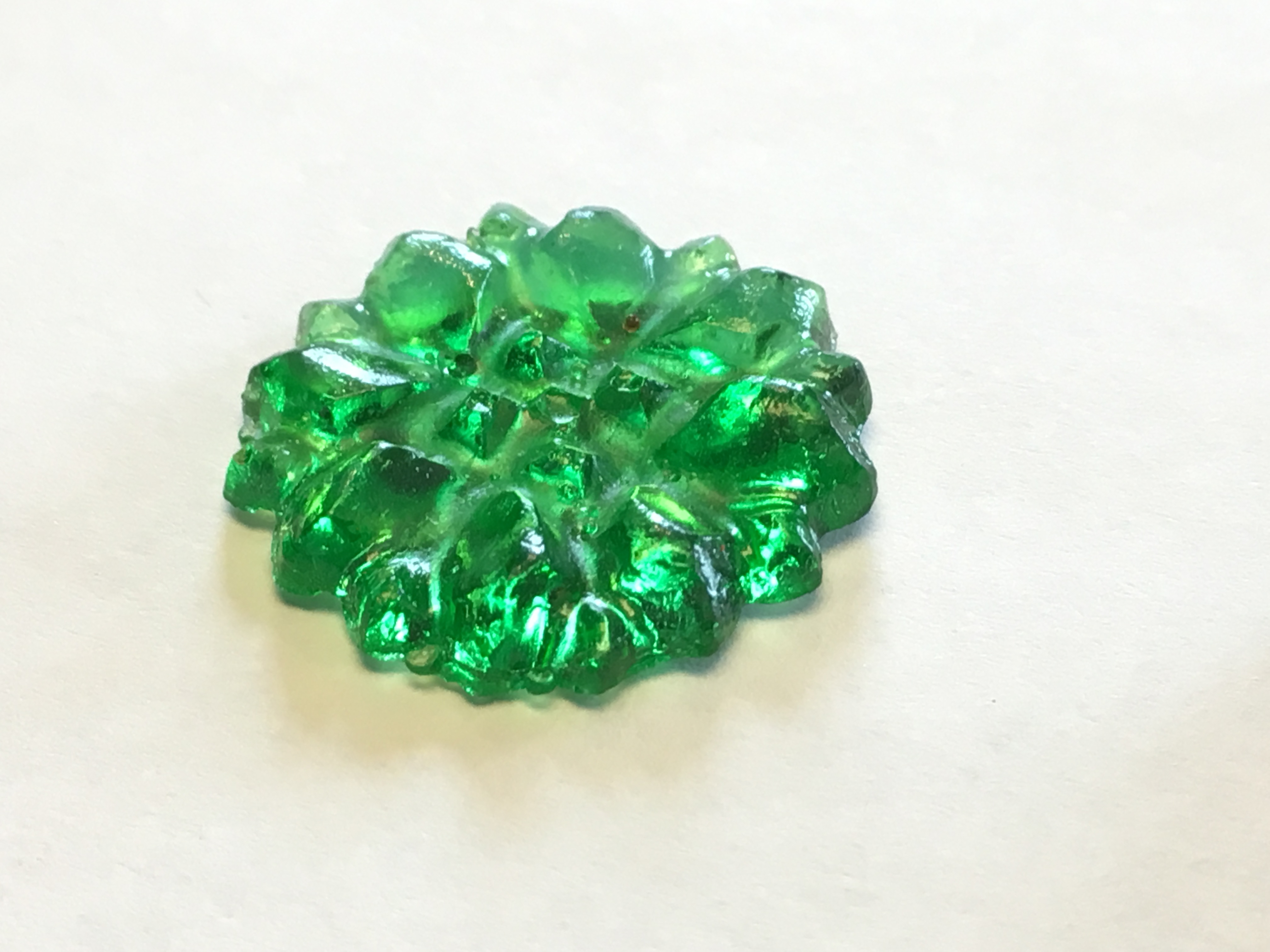

You are SOOOO Awesome !!!!
Thank you. Those are great pictures !!
Now that I've got these pictures, I'll come back to this project and see about a run. My previous crystal was too small. Those exact specs are Great !
If you folks need any other details, please let me know.
You've been great ! I had made mine more of a curved bottom. But these crystals are way more flat. I'll still do my own thing and make a version that I like, but these really help flesh it out. And the pictures showing the 3 true (ish) colors are excellent. Better pictures of the color than anything I had previously.

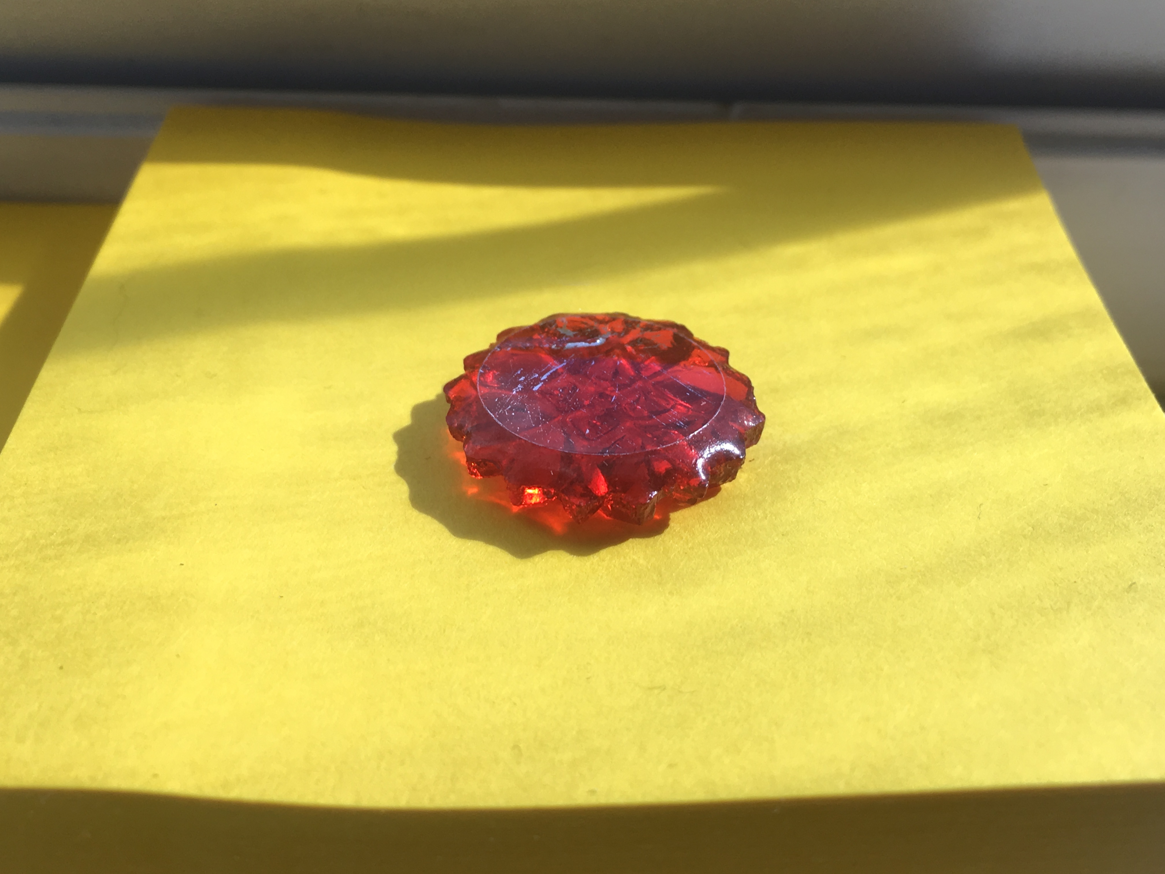

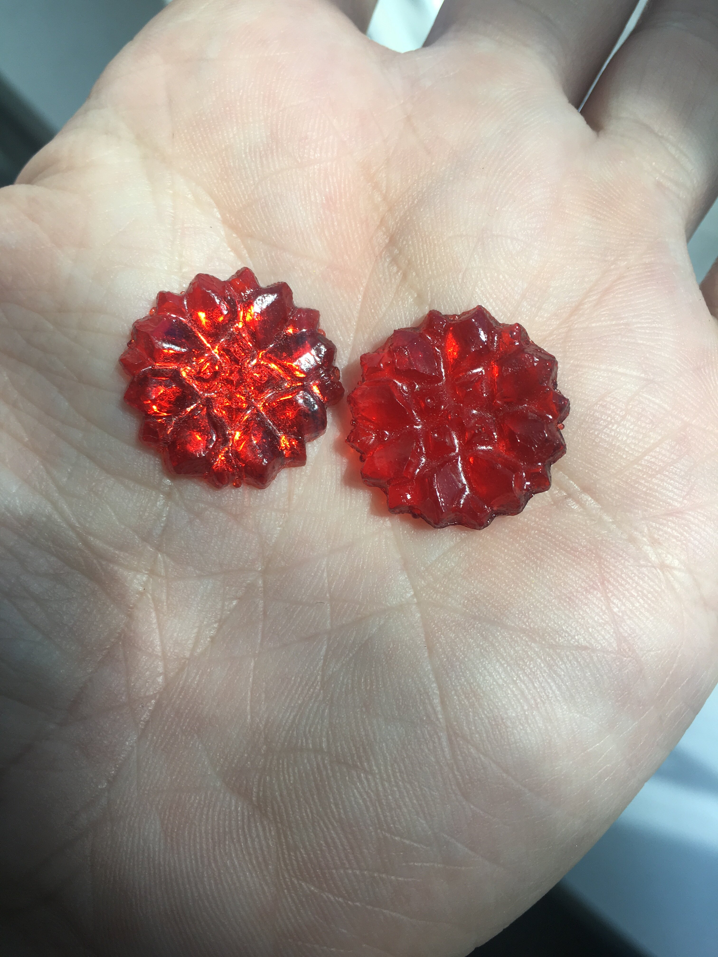

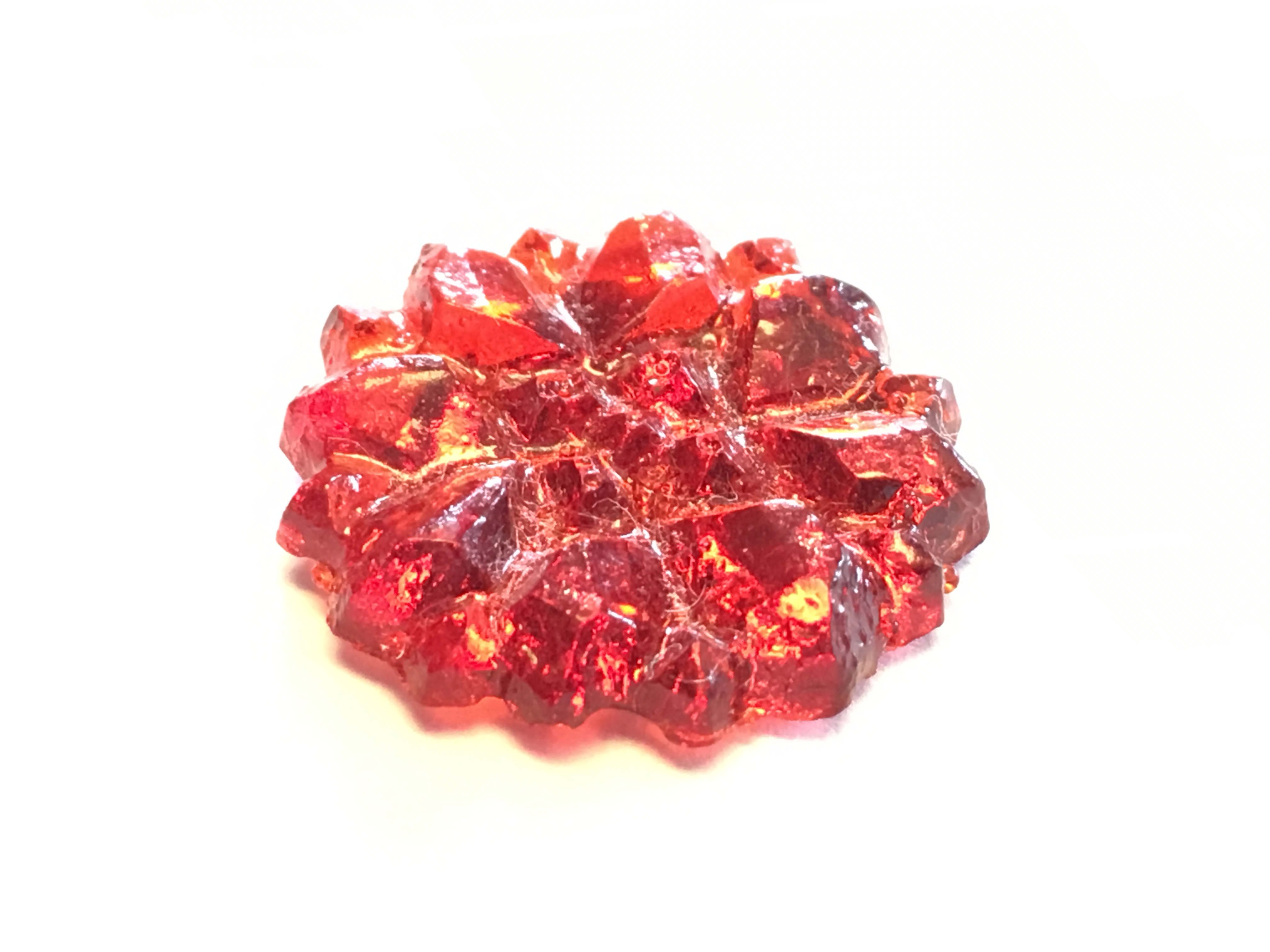

The actress who sold me the yellow, green, and red had one more to sell me - another red. I went ahead and bought it so I could remove the silver backing foil and rig it up in a display frame with a flashing light. In case you wondered what the silver backing is like, it is a fragile metalized mylar and delaminated off very quickly once I tried to get a blade under it. I took a very telling picture of the red life clock from the back side against a window so you can see through it from the back. This really shows the structure better than from the front.
Here's a comparison of the red one with silver foil (on left) vs. the one without. You can really see that it makes a big difference in the appearance. I was surprised how different.

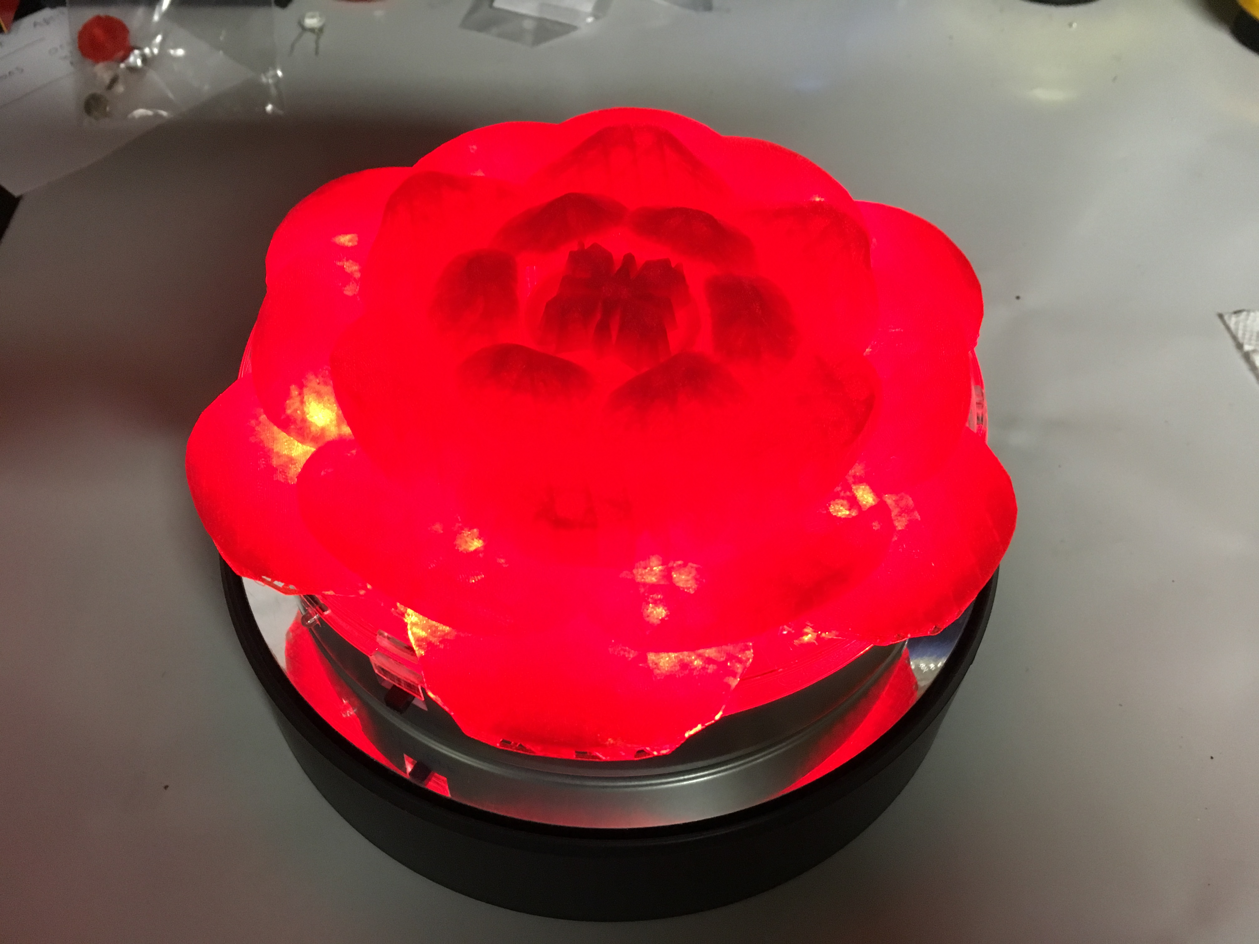

On a somewhat related topic, I've always been fascinated with the gigantic red carousel life clock that everyone floats over and gets "zapped" at the start of the movie. What a scene! I wanted to generate a desktop version of it. Using a generic lotus flower image on Thingiverse, I 3D printed one using clear red PLA plastic. Scaled it to a diameter of 6-7 inches and flattened the thickness to look more like the film prop. Interestingly, the film prop was apparently made from some sort of textured fabric that looks remarkably similar to the typical 3D printing lines we usually get. So in this case the 3D printing process actually helps the piece look the way it should. I then put it on a remote controlled LED lighting plate (battery operated) and put that on a rotating base - both from Amazon. Cue the creepy music... don't know why I made this thing.

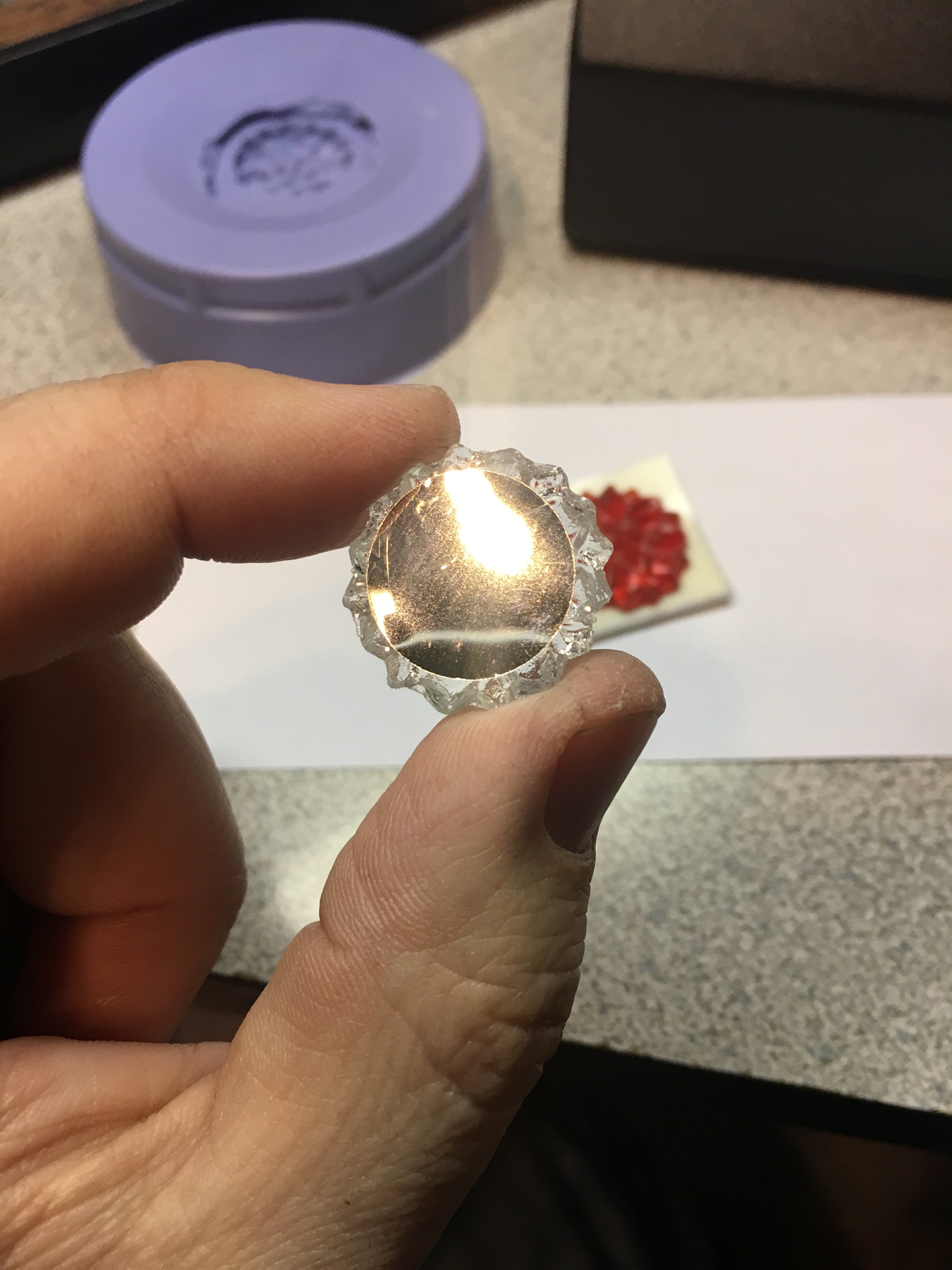

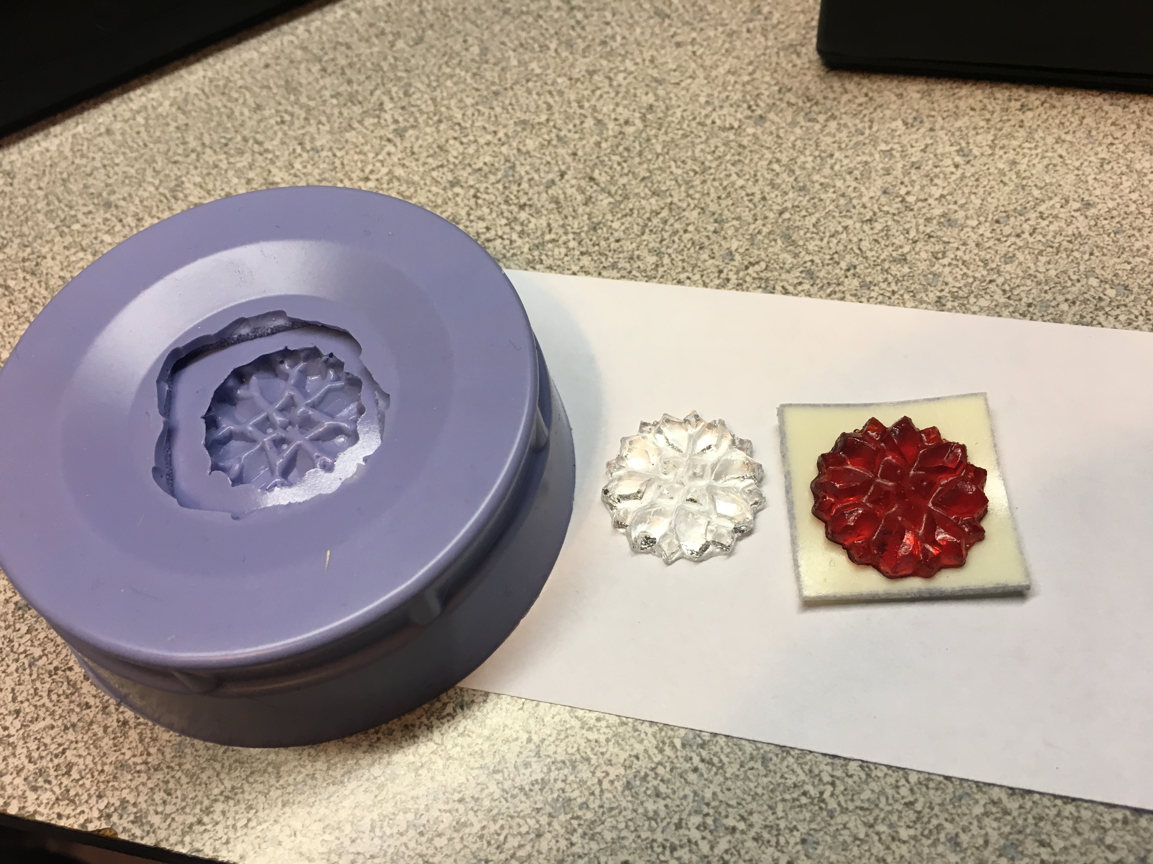

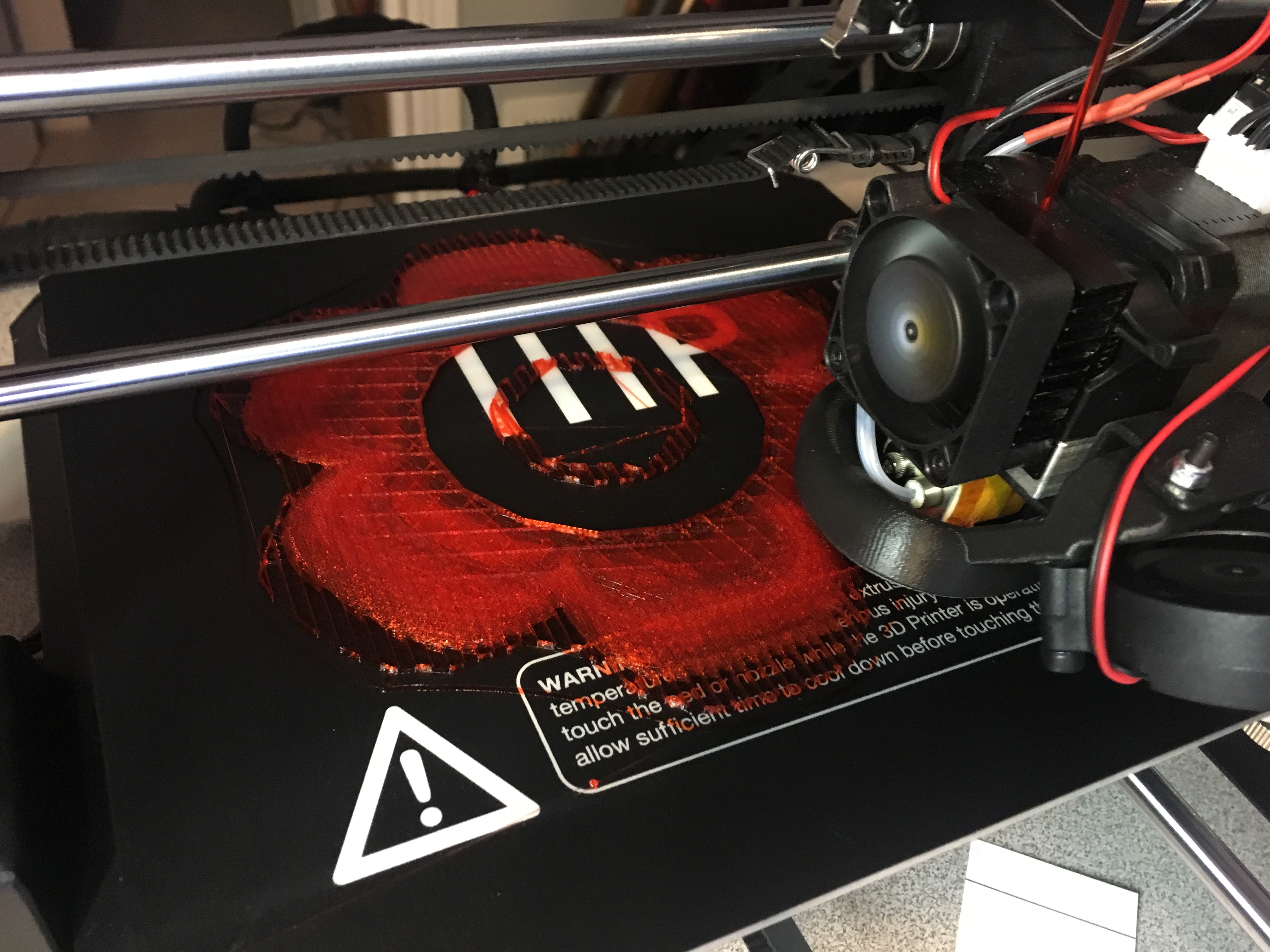

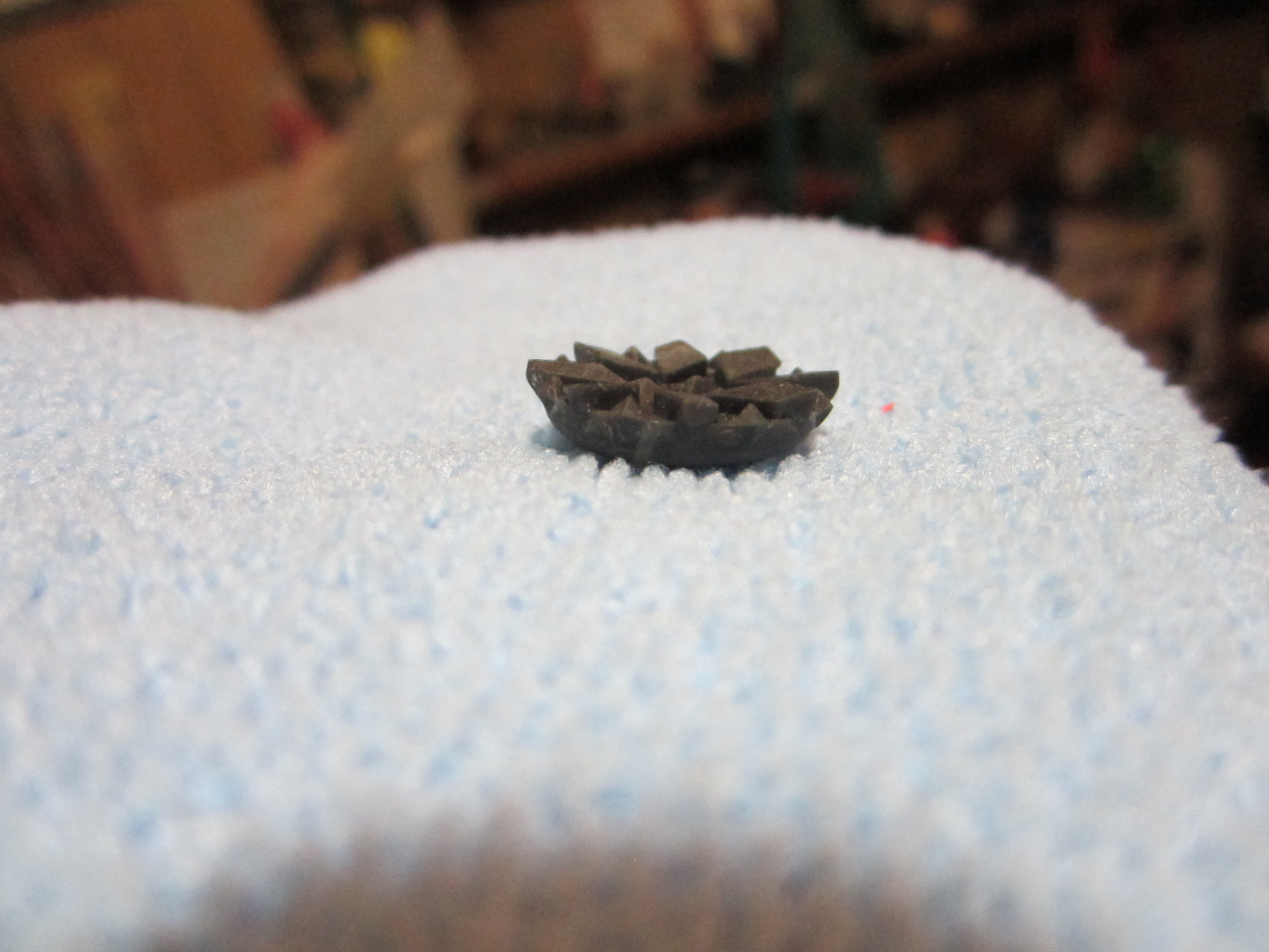

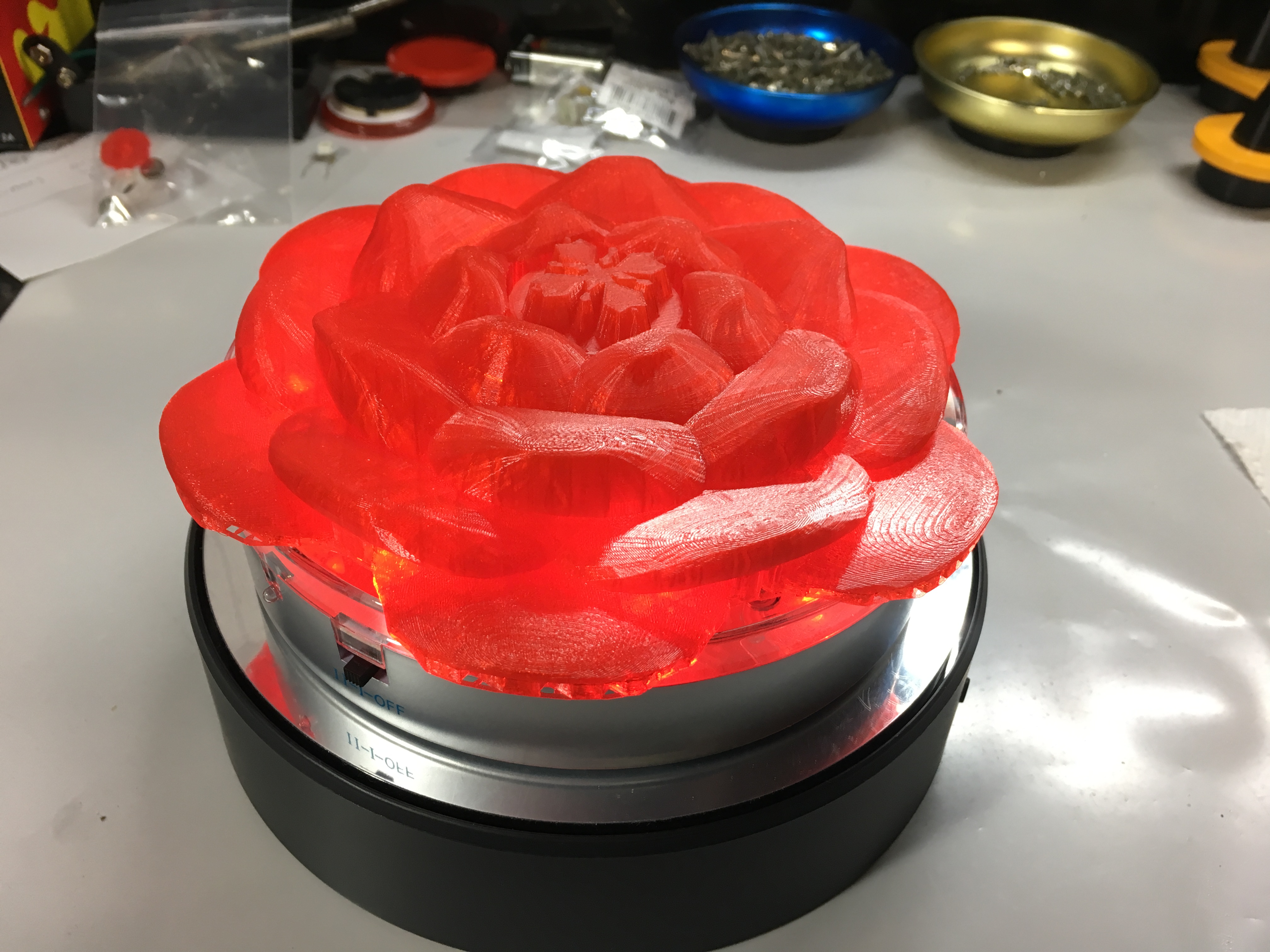

As I have the yellow, green, and reds, the one missing piece is the clear. I promised the actress I bought these from that I'm not going to start making reproductions. But for my own collection, I went ahead and tried my hand (pun?) at mold making. Using Oomoo 30 silicone from Amazon I made a mold of one of my reds. Turned out really well aside from the anxiety of having to wait for the stuff to fully cure up.
Next I used Art N Glow clear epoxy casing resin from Amazon. Again, easy enough - just a long wait for it to cure up. I was careful not to get any air bubbles in there. This made a really nice, clear, sharp colorless life clock copy.
Finally, I got a roll of "chrome" 3M tape from the craft store and a 5/8" circle punch for a few dollars. This made the exactly right silver backing. It is just tricky to punch the sticky tape, so I had to first apply the tape to release paper before punching it cleanly.
The final result is a pretty darn close to screen accurate clear life clock. It has that shiny silvery look - so either I'm an infant or I left the dome and found sanctuary : )
Now I've got the full set. Going to wire an LED to one of the original reds to make it blink. I've seen others make black life clocks and I know it was referenced in the movie, but I don't think black ones were actually made for the film.
