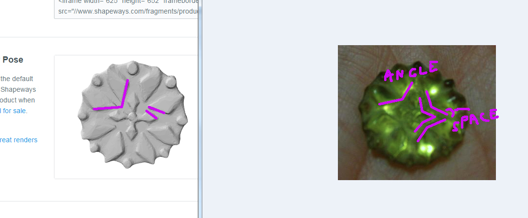

  9. nomuse
    nomuse Sr Member RPF PREMIUM MEMBER
    Trophy Points:
    1,035
    Re: Logan's Run -------------------------- Life Clock
    Looks good. I'm thinking that the smoothing is more an artifact of both whatever casting process they used on the film, and the presumed casting from a film-used (possibly stunt version) for the one we all seem to have bought at a long-ago convention (I have a red one lurking around somewhere at the bottom of a drawer). Given the uncomfortable look of some of the tech end in the movie I wouldn't be surprised if the original intent wasn't fairly defined edges.
    Anyhow. Minor quibble; to my eye, the inside edges of the "petals" on your model -- where they face the center -- are a slightly more acute angle than what is shown on the sample prop. It is closer to a straight line there...10-15 degrees maybe? Otherwise, it seems very close.

  11. nomuse
    Trophy Points:
    1,035
    Don't disagree, and don't want to quibble. But to my eye, one of the things that comes out of the overall look is the sort of two-zone definition; the core, surrounded by the petals. This look happens in the sample because of the roughly parallel lines between inner and outer elements creating a space there:
    But I totally understand if other people interpret the shapes differently! You saw a LOT more than I did when I took a first glance at is (such as the way the pair of petals are taller to the outside and taper in....)
    Daniel Nelms likes this.
  12. Jintosh
    Jintosh Master Member RPF PREMIUM MEMBER
    Trophy Points:
    2,515
    Yes, subtle. But there. The large outside petal is hard to define because all the prop petals are rounded and "soft".
    I'll have to go back to the Sharp version of my replica, make the change, and then smooth it again.
    Okay, here's the new sculpt.
    nomuse was actually very helpful. Hopefully, he'll come back and examine the new design. I need to know if any more changes need to be made before sending the new design off to Shapeways. I've got the prototype design coming on Tuesday, so I'll be able to experiment with that before the updated design arrives. (the one I haven't even sent yet.) :)

    Flat and NOT weathered ? hmmm...have to think about that. You also have to consider the concept. This is something they've worn for 30 years, and if it is some kind of acrylic (in theory) and not glass, then there could be 30 years of weathering.

    Considering the crystal he has shown is 40 years old it should be a bit worn, LOL. If you look at the images, it seems to me there could have been sharper edges on the crystal.
    Yellow lifeclock on palm small.jpg Yellow lifeclock at angle small.jpg Yellow lifeclock closeup small.jpg
    I doubt that the crystals would have worn down in the Logan's Run universe but who knows?
